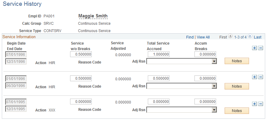

Use the Service History page (EG_SVC_HIST_FLX) to view service history information.
Navigation
Image: Service History page
This example illustrates the fields and controls on the Service History page. You can find definitions for the fields and controls later on this page.
You can make manual adjustments to history data on this page. However, you can't make adjustments during the time between when the temporary file is created in Normal Run mode and the data to history is updated in Update to History mode. During this time, the fields on this page are unavailable. After the service data is committed to history, that is, after you run the process in Update to History mode, you can manually adjust the amount fields. The dates remain unavailable.
Ordinarily, you don't change previously earned service credits except to correct an entry mistake. For example, if you forgot to give a worker a startup credit for a service type, enter the adjustment here.
Note: Manual adjustments that you entered on the Service History page are included in the next Update to History mode run.
Field or Control |
Definition |
| Begin Date andEnd Date |
Displays the service history begin and end dates that were calculated for this calendar period. |
| Service w/o Breaks (service without breaks) |
View the amount of service that was accrued without service breaks. |
| Service Adjusted |
View the amount of service that was adjusted. |
| Total Service Accrued |
View the total amount of service that was accrued for the worker. |
| Accum Breaks (accumulated breaks) |
View the total amount of breaks in service. |
| Action |
View the job action from the worker's job record, such as LOA (leave of absence), that falls within the calendar period. |
| Reason Code |
View the Reason Code that is associated with this job action that counts toward accrued service. Access the HR Action/Category page to define job actions and reasons that count toward service accrual. |
| Adj Rsn (adjustment reason) |
View the reason for manual adjustments that were made on this page. |
