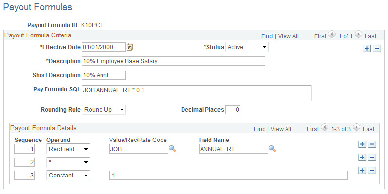

Image: Payout Formulas page
This example illustrates the fields and controls on the Payout Formulas page.

Pay Formula SQL
When you save the record, the system displays the payout formula SQL statement that you define using the following fields. The system checks the syntax of the SQL statement and lists any errors.

Sequence
(Required) This number determines the order in which the SQL generator builds the formula. Entering sequence numbers in increments of 5 or 10 gives you room to add a component to the formula without renumbering all the existing components. When you save the page, the system sorts your components according to their sequence numbers.
Insert a new row and enter a sequence number for each component of the SQL statement while you build it.
Operand
Enter an operand for the component. The operand that you select determines the other fields that are hidden or displayed on the page. This table lists the valid operand values and the additional fields displayed for each.

Payout Formula Example
To define a payout formula of 1 percent of the worker's job annual rate, select the Job record, the Annual Rate field name (on the Job record), the operator *, and the constant .01. Place the formula in parentheses so that the final formula in the Pay Formula SQL field is (JOB.ANNUAL_RT * 0.01).
