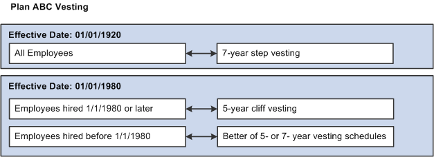

For example, assume that your plan vesting rules change from seven-year step vesting to five-year cliff vesting in 1980. Employees hired before January 1, 1980 can use the better of the two rules; those hired afterwards must use the five-year cliff vesting.
Your complete rules have two effective dates. First, from the inception of the plan until 1980, there's one rule (step vesting) available to all employees. Second, after January 1, 1980, employees hired after the change use the new rule (cliff vesting) while employees hired before the change use the better of the two rules.
You need to set up the following modules:
  • Vesting definition 1: Seven-year step vesting.
  • Vesting definition 2a: Five-year cliff vesting.
  • Vesting definition 2b: Better of the two vesting methods.
  • Group 1: All employees.
  • Group 2: Employees hired January 1, 1980 and later.
  • Group 3: Employees hired before January 1, 1980.
Note: In reality, each of these modules would reference other modules.
Your rule should look something like this, with the effective and vesting dates as in the example below:
Image: Vesting rules example with effective dates and vesting periods
This diagram illustrates the preceding scenario. There are two effective dates for vesting calculations. The first effective date has a single rule for all employees. The second effective date is the date of the rule change. It has two rules: one for employees hired before the rule change, and one for employees hired after the rule change.
