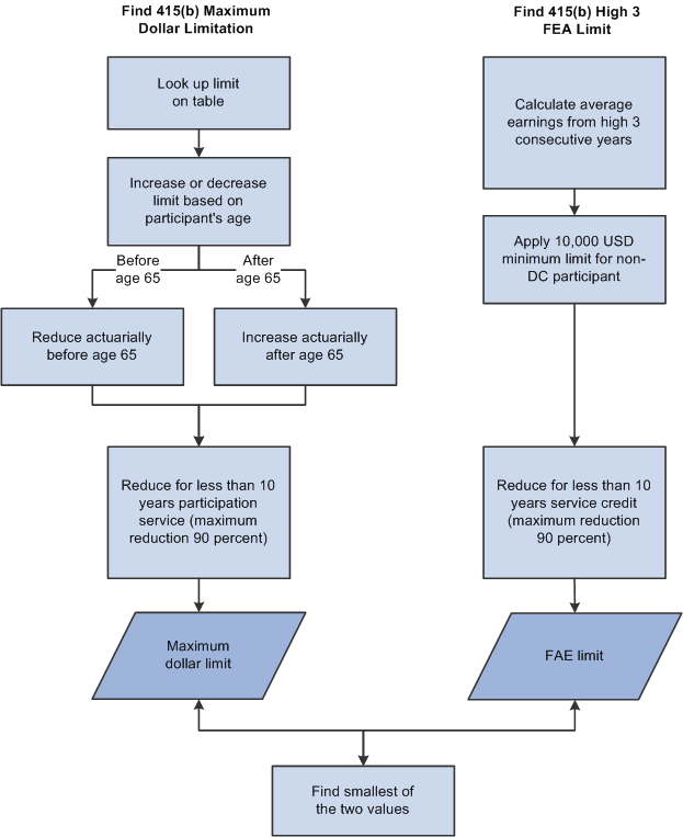

This is the most complex part of the process. You can look at the 415 pages to go through all the parameters used during this stage. The following diagram summarizes the process for determining limits. It includes steps for increasing or decreasing limits based on age, calculating average earnings, and reducing limits for service length:
Image: Illustration showing how system calculates 415 limits
This diagram shows how the system calculates 415 limits, including how the system increases or decreases limits based on age, calculates average earnings, and reduces limits for service length
Illustration showing how system calculates 415 limits, including how the system increases or decreases limits based on age, calculates average earnings, and reduce limits for service length
