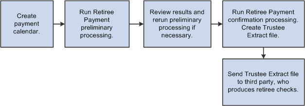

The following diagram illustrates the flow of the pension payment process from creating the payment calendar to sending a trustee extract file to a third party:
Image: Illustration of pension payment process
This diagram illustrates the pension payment process from creating the payment calendar to sending a trustee extract file to a third party.
Illustration of pension payment process from creating the payment calendar to sending a trustee extract file to a third party
