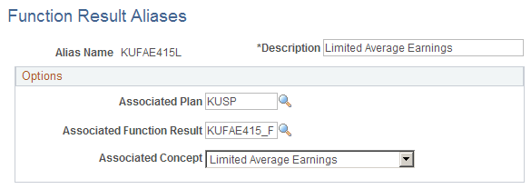

Use the Function Result Aliases page (PA_ALIAS_AUTO_ASGN) to create a function result alias.
Image: Function Result Aliases page
This example illustrates the fields and controls on the Function Result Aliases page.
Field or Control
Definition
Associated Function Result
Select the function result that produces the extra value.
Associated Concept
Select the results you want to reference:
  • Lim Cash Bal @ Lump Sum Date (limited cash balance at lump sum date).
  • Limited Average Earnings.
  • Limited Cash Balance @ BCD (limited cash balance at benefit commencement date).
  • Limited Cash Balance @ NRD (limited cash balance at normal retirement date).
  • Participation Date.
  • Unlim Cash Bal @ Lump Sum Date (unlimited cash balance at lump sum date).
  • Unlimited Average Earnings.
  • Unlimited Cash Balance at BCD (unlimited cash balance at benefit commencement date).
  • Unlimited Cash Balance at NRD (unlimited cash balance at normal retirement date).
