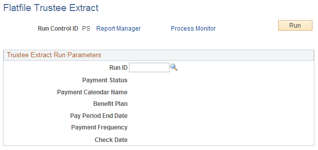

Use the Flatfile Trustee Extract page (RUNCTL_PAPP02) to run the Trustee Extract process.
Image: Flatfile Trustee Extract page
This example illustrates the fields and controls on the Flatfile Trustee Extract page.
Field or Control
Definition
Run ID
Select the run ID for the Retiree Payment process job that created the trustee extra data.
The system then displays information associated with that run ID: the payment status, payment calendar name, benefit plan, pay period end date, payment frequency, and check date.

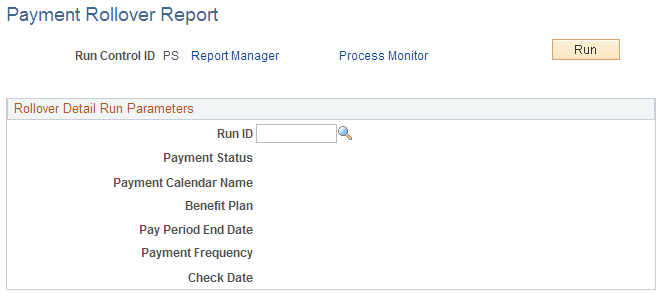

Use the Payment Rollover Report page (RUNCNTL_RO_DETAIL) to enter run control parameters for the Payment Rollover Report.
Image: Payment Rollover Report page
This example illustrates the fields and controls on the Payment Rollover Report page.
Field or Control
Definition
Run ID, Payment Status, Payment Calendar Name, Benefit Plan, Pay Period End Date, Payment Frequency and Check Date.
These fields provide summary information about the pay run that is the basis for the extract. The run ID determines the payment status, payment calendar name, benefit plan, pay period end date, payment frequency and check date.
