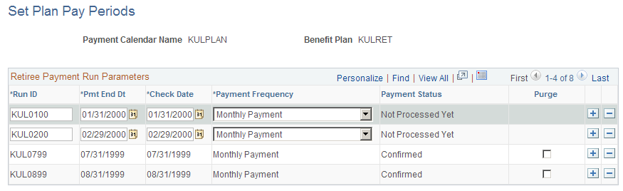

Use the Set Plan Pay Periods page (PA_RT_CALENDAR) to set up a schedule of pay periods for pension checks for a plan.
Image: Set Plan Pay Periods page
This example illustrates the fields and controls on the Set Plan Pay Periods page.
When you create a calendar, you assign a payment calendar name and specify the benefit plan that uses this calendar. If you do not specify a plan, all plans are selected by default.

Retiree Payment Run Parameters
Set up the retiree payment run parameters with one row per pay period.
Run ID
Assign a run ID to each pay period.
You associate a run ID with each pay period and benefit plan, then reference that run ID when you run the Retiree Payments and Trustee Extract processes for that pay period and plan.
Pmt End Dt (payment end date)
The payment end date is the last day in a pay period.
Check Date
The check date is the date that should appear on the actual pension check.
Payment Frequency
The payment frequency indicates how many times per year you make payments under the plan. You can select one of these values: One Time Payment, Annual Payment, Monthly Payment, Semi-Annual Payment, Semi-Monthly Payment, Biweekly Payment, or Quarterly Payment.
You typically make 12 payments for regular pension pay runs, so this is value is almost always Monthly Payment.
This field is informational only. Payment processing picks up all scheduled payments, regardless of whether the scheduled payment frequency matches the frequency of the pay run ID.
Payment Status
The status indicates the processing stage for this pay period: Not Processed Yet, Preliminary, or Confirmed.
Purge
After you confirm the retiree payments for a particular pay period, a Purge check box appears for that period.
If you select this check box, the system deletes the payment records for the run ID during the next payment processing. The system purges both payment records (created during the payment process) and trustee extract data (created when you run the Trustee Extract process). Purging does not affect the Trustee Extract file, which is saved to disk outside of the PeopleSoft system.
