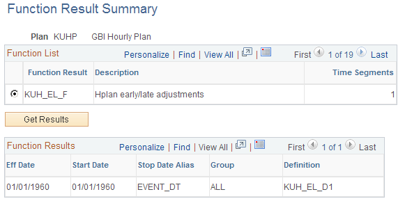

Use the Function Result Summary page (PA_FNC_RSLT_SUMMRY) to view all the function results within a plan, and navigate to see the components of each function result.
Navigation
Image: Function Result Summary page
This example illustrates the fields and controls on the Function Result Summary page.
Function List
Field or Control |
Definition |
| Function Result and Get Results |
All of the function results in the plan appear in the Function List grid; scroll to see additional function results. When you find one whose details you want to view, select the radio button next to the function result name, then click the Get Results button to populate the Function Results grid below. |
| Time Segments |
This column shows how many rows there are in the inner scroll area of the associated function result. In this case, time segments refers to a set of rules within a function result, not specifically to the time period during which those rules are effective. That is, if there are two groups in a function result, there are two time segments, even if the time periods referenced are identical. |

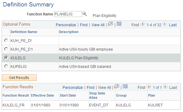

Use the Definition Summary page (PA_DFN_SUMMARY) to view where information for all the definitions is used in the system.
Navigation
Image: Definition Summary page
This example illustrates the fields and controls on the Definition Summary page.
Field or Control |
Definition |
| Function Name |
A definition always belongs to a specific function. To list the definitions for a particular function, first select a function. |
Definitions
Field or Control |
Definition |
| Definition Name and Get Results |
The grid lists all of the definitions for the function you selected. When you find one whose usage you want to review, select the radio button next to the definition name, then click the Get Results button to populate the Function Results grid below. |
Function Results
This group box lists the function results that reference the selected definition.
