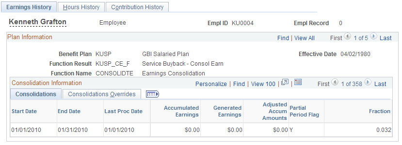

Use the Earnings History page (PA_CONS_EARNS_HIST) to view an employee's consolidated earnings.
Depending on your plan rules, the system might use these during calculations for final average earnings, social security, or cash balance accounts.
Navigation
Image: Earnings History page
This example illustrates the fields and controls on the Earnings History page.
Note: If an employee provides a social security earnings history, such as a document from the Social Security Administration or pay stubs from previous employers, you must use this earnings history for social security calculations. Rather than entering the new information as an override to the consolidated earnings (which might interfere with other calculations based on these earnings), enter the data on the Yearly Soc Sec Earnings page.
Multiple views of this page are available by clicking the tabs in the scroll area.
Common Page Information
Field or Control |
Definition |
| Function Result |
Displays the system name for the earnings consolidation rule. |
Consolidations Tab
Field or Control |
Definition |
| Accumulated Earnings |
Displays the earnings that were actually paid to the employee during a consolidation period. This is not the final earnings for the period, because the rules might require that you generate or otherwise adjust these earnings. |
| Generated Earnings |
Displays the period total after any earnings generation. The generated earnings amount is not added to paid earnings—it replaces the paid earnings. If no earnings were generated, this field displays 0. |
| Adjusted Accum Amounts (adjusted accumulated amounts) |
Displays the final earnings actually used in the calculation. In addition to including the generated earnings, this reflects minimums, maximums, and other adjustments specified in the plan rules. |
| Fraction |
Indicates the portion of the period that the employee worked. For whole periods, this is 1.000, indicating that an employee worked for 100 percent of the period. If the employee worked for 75 percent of the period, the fraction is 0.750. Depending on your plan rules, the system might use the partial period indicator and partial period fraction during final average earnings and cash balance accounts calculations. |
Consolidations Overrides Tab
Field or Control |
Definition |
| Override Earnings Amount |
Enter the new earnings data. This overrides the data in the Adjusted Accum Amounts field. |
| Partial Override |
Indicate whether this is a partial period. This overrides data in the Partial field. When you deselect this check box, the Partial field value is N. When you select this check box, the value is Y. |
| Fraction Override |
Enter the partial period fraction. Enter 1.000 for periods that are not partial periods. For periods that are partial periods, enter a decimal corresponding to the percentage of the period worked. For example, if an employee worked for 80 percent of the period, enter .8. |

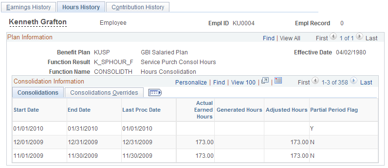

Use the Hours History page (PA_CONS_HOURS_HIST) to view an employee's consolidated hours.
Navigation
Image: Hours History page
This example illustrates the fields and controls on the Hours History page.
Field or Control |
Definition |
| Function Result |
Displays the system name for the hours consolidation rule. |
Consolidations Tab
Field or Control |
Definition |
| Actual Earned Hours |
Displays the hours that the employee actually worked during a consolidation period. This is not the final hours for the period, because the rules might require that you generate or otherwise adjust these hours. |
| Generated Hours |
Displays the period total after any hours generation. The generated hours amount is not added to the actual hours—it replaces the actual hours. If no earnings were generated, this field is blank. |
| Adjusted Hours |
Displays the final hours that are actually used in the calculation. In addition to including the generated hours, this reflects minimums, maximums, and other adjustments specified in the plan rules. |
Field or Control |
Definition |
| Override Final Cons Hours (override final consolidated hours) |
Enter the new hours data. This overrides the data in the Adjusted Hours field. |
| Partial Override |
Indicate whether this is a partial period. This overrides data in the Partial Period Flag field. When you deselect this check box, the Partial Period Flag field value is N. When you select this check box, the value is Y. |

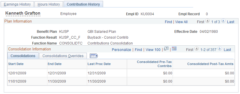

Use the Contribution History page (PA_CONS_DED_HIST) to view an employee's consolidated contributions.
Navigation
Image: Contribution History page
This example illustrates the fields and controls on the Contribution History page.
Field or Control |
Definition |
| Function Result |
Displays the system name for the contribution consolidation rule. |
Consolidations Tab
Field or Control |
Definition |
| Consolidated Pre-Tax Contribs (consolidated pretax contributions) and Consolidated Post-Tax Amts (consolidated posttax amounts) |
Display the employee's pretax and posttax contributions during the period. |
Field or Control |
Definition |
| Override Pre Tax and Override Post Tax |
Enter the pretax and posttax amounts. |
