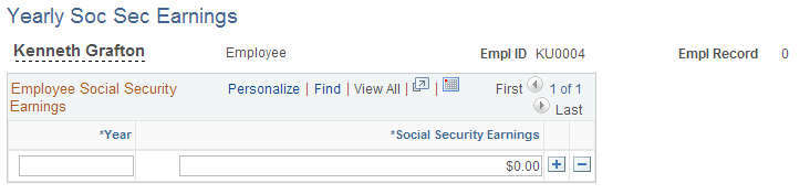

Use the Yearly Soc Sec Earnings (yearly social security earnings) page (PA_EMP_SS_EARNS) to enter an employee's actual social security earnings history.
Navigation
Image: Yearly Soc Sec Earnings page
This example illustrates the fields and controls on the Yearly Soc Sec Earnings page.
Pension plans may incorporate social security calculations in their benefit formulas or when calculating a level income option form of payment. Because you do not normally have access to social security earnings information from other employers, you usually use assumed earnings that are determined using certain assumptions.
Sometimes, however, an employee provides their earnings history—either a document from the Social Security Administration or pay stubs from previous employers. You must use this actual earnings history, rather than the assumed earnings. Entering the actual earnings data on the Yearly Soc Sec Earnings page ensures that all social security calculations use the actual earnings. At the same time, you avoid overwriting the consolidated earnings data that you might use elsewhere for final average earnings or cash balance accounts calculations.
Social security earnings are always based on calendar years. For each year of earnings, enter the year and earnings. Amounts that exceed the maximum taxable wage base are limited to the wage base amount during the social security calculations.
Only social security calculations use these earnings. Other calculations involving earnings use the consolidated earnings that are specified in the plan rules.
Note: The system does not project or regress earnings entered on this page. Be sure to enter information only when you have a complete earnings history.
