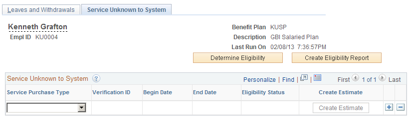

Use the Service Unknown to System page (PA_SP_STP_UNKNOWN) to enter a service purchase period that is not shown on the Leave and Withdrawals page.
Navigation
Image: Service Unknown to System page
This example illustrates the Service Unknown to System page.
Field or Control |
Definition |
| Determine Eligibility |
Click this button to run the eligibility process for each service purchase type shown in the component, including those on this page and on the Leaves and Withdrawals page. Eligibility processes for specific plans and service purchase types are defined on the Service Purchase Configuration - Eligibility Page. |
| Create Eligibility Report |
This button becomes active after you run the eligibility process by clicking the Determine Eligibility button. Click the Create Eligibility Report button to generate a letter to the employee summarizing the eligibility for the service purchase types shown in this component. The letter includes information about periods of leave, withdrawn contributions, and service unknown to the system. This letter is a report that is generated using Oracle Business Intelligence Publisher (BI Publisher). The report definition is SPELIGLTR. |
Field or Control |
Definition |
| Service Purchase Type |
Enter the purchase service type for the leave period. You can select service purchase types that are action/reason enabled, but you cannot select the delivered withdrawal contribution type. Withdrawn contributions have special processing, and this value should not be used for entries of Service Unknown to system. If you want to purchase withdrawn contributions using the Service Unknown to System option, you must create a new service purchase type for this. However, be aware that a service purchase account, not a withdrawal account, will be used to store the balance. |
| Verification ID |
Optionally identify the ID for an employment history verification record. Only records with the status Verified are available for selection. |
| Begin Date and End Date |
Enter the begin and end dates of the period for which service may be purchased. If you entered a verification ID, the begin and end date for the verified employment are used as default values for the service purchase type begin and end date. |
| Eligibility Status |
Initially, the Eligibility Status is Undetermined. When you click the Determine Eligibility button, the system changes this value to either Eligible or Ineligible. If the Eligibility Override Allowed check box is selected on the Service Purchase Configuration - Eligibility page, this field is editable. Otherwise, it is read-only. |
| Create Estimate |
If the service purchase type is determined to be eligible for service purchase, the Create Estimate button becomes active. Clicking this button creates a new service purchase record and transfers you to the Service Purchase page, where you can calculate costs and benefits and create and manage service purchase estimates. |

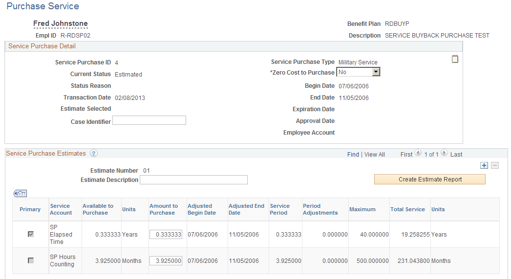

Use the Purchase Service page (PA_SP_SVC_COST_BEN) to administer a service purchase transaction.
Navigation
To create a service purchase transaction, click the Create Estimate button on the Leaves and Withdrawals page or the Service Unknown to System page.
To manage an existing service purchase transaction, select
Image: Purchase Service page (1 of 2)
This is the first of two examples illustrating the Purchase Service page.
In this example, the grid that lists service is showing all columns. However, it is a tabbed grid in default state.
Image: Purchase Service page (2 of 2)
This is the second of two examples illustrating the Purchase Service page.
Note: All fields on this page become read-only when the status changes from Estimate to Submitted.
Service Purchase Detail
Field or Control |
Definition |
| Service Purchase ID |
Displays the system-generated unique identifier for the service purchase transaction. |
| Current Status |
Displays the status of the service purchase transaction. You can manually set this status using the Status field at the bottom of this page. |
| Status Reason |
Displays the status reason for the current status. To manually assign a reason, use the enterable Status Reason field at the bottom of this page. |
| Transaction Date |
Displays the date this service purchase transaction was created. |
| Estimate Selected |
A service purchase transaction can have multiple estimates that model different options. Only one estimate, however, can be submitted. When you submit an estimate, the Estimate Selected field displays the numeric identifier of the submitted estimate. |
| Verification ID |
If the estimate includes service that you entered on the Service Unknown to System page, and if that service is associated with an employment verification record, this field displays the unique identifier for that verification record. |
| Case Identifier |
This field is visible only if the Display Case Identifier check box is selected on the Pension Installation Page. You can manually enter a case number to match this verification request with a case in your employee help desk system. The case number is informational only. |
Displays the service purchase type for the transaction. |
| Zero Cost to Purchase |
This field is visible only if the Allow Zero Cost check box is selected on the Service Purchase Configuration - Cost Page. The initial value is No, but you can change the value to Yes to reinstate service at no cost to the employee. When you select Yes, the Service Purchase Cost field on this page becomes read-only and displays a zero value. Service adjustments are automatically applied when the status of the purchase is updated to Elected, and after the service adjustments are applied, the system updates the status to Complete. |
Displays the beginning and ending date of the leave period for which the employee is purchasing service. If the service purchase type is Withdrawn Contributions, these fields are blank. |
| Expiration Date |
Displays the date when the service purchase estimate is no longer valid if it has not yet been elected. The system sets the expiration date at the time the estimate is submitted. The length of time that an estimate remains valid after submission is determined by the Expiration Duration fields on the Service Purchase Configuration - Parameters Page. |
| Approval Date |
Displays the date, if any, that the service purchase was put into Approved status. |
| Employee Account |
After the service purchase transaction is submitted, this field displays the employee account where purchase payments are entered. This account is a service purchase account or a withdrawal account, depending on the service purchase type. |
| Create Purchase Agreement |
This button is visible if the agreement is in Submitted status. Click to generate a purchase agreement letter to send to the employee. This letter is a report that is generated using Oracle BI Publisher. The report definition is SPFNLAGRLTR. |
| View Payments |
This link is visible if the agreement is in Elected status. Click to open the Review Payments Page in a modal window so that you can review payments. |
Service Purchase Estimates
A service purchase transaction can have multiple estimates that model different service, cost, and payment options.
Field or Control |
Definition |
| Estimate Number |
A service purchase transaction can have multiple estimates that model different options. This field displays the numeric identifier that the system assigns to each estimate. |
| Estimate Description |
Enter a description of each estimate. |
| Create Estimate Report |
Click this button to generate an estimate report for the employee. This report summarizes the employee’s service amount, the benefit amount with and without the service purchase, the cost of purchasing the service, and payment information for purchasing the service. This letter is a report that is generated using Oracle BI Publisher. The report definition is SPESTRPT. |
Service for Periods of Leave
If the service purchase type is for a period of leave, service information appears in a grid that, in its default state, has tabs for Service to Purchase, Service Details, and Overall Service.
The system populates this grid with a list of the service function results used for this service purchase type, as shown on the Service Purchase Configuration - Eligibility page.
Field or Control |
Definition |
| Primary |
This read-only check box is selected for the service function result that is used in the plan’s benefit calculation. |
| Service Account |
Displays the name of the service function result. |
| Available to Purchase and Units |
Displays the amount of service that is available to purchase. |
| Amount to Purchase |
Displays the amount of service to be purchased. This field is editable if the Allow Service Override check box is selected on the Service Purchase Configuration - Parameters page. If overrides are not allowed, the amount to purchase is always the same as the amount available to purchase. Changing the amount to purchase clears related information from the estimate, including cost information and the benefit amount with the purchased service. |
| Adjusted Begin Date and Adjusted End Date |
Displays the adjusted begin and end dates of the leave period. These dates might be different from the actual leave dates depending on the plan rules regarding service accrual during leave periods. For example, a plan may grant service through the end of the month when an employee goes on leave, even if the leave starts mid-month. In this scenario, the adjusted begin date is the first day of the following month, and the time from the leave date through the end of the month would not be available for purchase. |
| Service Period |
Displays the total service represented by the adjusted leave period dates for this function result. |
| Period Adjustments |
Displays the total amount of service already purchased back for this period. The system calculates this amount based on:
| Maximum |
Displays the maximum amount of service allowed by the service definition. |
| Total Service and Units |
Displays the employee’s total service for the service function result. |
Service for Withdrawals
If the service purchase type is for withdrawn contributions, the service grid has tabs for Service to Purchase and Overall Service. This grid is similar to the service grid for periods of leave. Data that is not relevant to withdrawals (such as the leave begin and end date) is not included, and these additional fields appear:
Field or Control |
Definition |
| Service Withdrawn |
Displays the amount of service that was lost as a result of the withdrawn contributions. |
| Service Buyback |
Displays the amount of lost service that was previously bought back. |
Displays the amount of service remaining for purchase. Service override parameters do not apply to withdrawn contributions, so this field is always read-only. |
Service Grid for Service Unknown to System
If the service purchase is for service unknown to the system, the service grid has tabs for Service to Purchase and Overall Service.
Field or Control |
Definition |
Enter the amount of service to purchase. Because the system cannot derive the amount of service, this information must be manually entered. |
Cost of Purchase
Field or Control |
Definition |
| Service Purchase Cost |
Displays the cost to purchase the amount of service shown in the Amount to Purchase field. The system populates this field when you click the Calculate Cost button, and clears the data if you change the amount of service to purchase. This field is editable if the Allow Cost Override check box is selected on the Service Purchase Configuration - Cost page. If the Zero Cost to Purchase field is visible with a value of Yes, the Service Purchase Cost field is read-only and shows a zero amount. |
| Datetime Updated |
Displays the date and time that the Service Purchase Cost field was last updated, either by the system or (if overrides are allowed) by manual entry. |
| Calculate Cost |
Click to calculate the cost to purchase the amount of service shown in the Amount to Purchase field. Cost is calculated using the method specified on the Service Purchase Configuration - Cost page. If the calculation method is Use Calculation, default calculation parameters come from the Cost Calculation Defaults Page. |

| Annual Salary % Increase |
This field is visible if the Allow User Salary Increase check box is selected on the Benefit Amount Calc Defaults Page. Optionally enter an assumed rate of salary increase to use in the benefit calculation. |
| Calculate Benefit |
Click to calculate the employee’s benefit with and without the service purchase. Cost is calculated using the method specified on the Service Purchase Configuration - Benefit page. If the calculation method is Use Calculation, default calculation parameters come from the Benefit Calc Defaults page. |
Service Purchase Status
Field or Control |
Definition |
| Estimate Number |
This field is visible only if the current status is Estimated. Before you update the status to Submitted, use this field to specify the estimate number that are submitting. |
| Status |
Update the status of the service purchase transaction to move the transaction through the service purchase process. The values available in the Status field depend on the current status, as described in the topic The Lifecycle of a Service Purchase Transaction. |
| Status Reason |
Optionally select a reason for the status assignment. Reasons for each status are configured on the service purchase Status Reasons Page |
| Refund Payments |
If the Allow Refund check box on the Service Purchase Configuration - Payment Options Page is selected, this field appears when you select the status Canceled for a transaction that is currently in Receiving Payments status. Before you can cancel the transaction, you must select Yes or No to indicate whether payments are to be refunded. |
