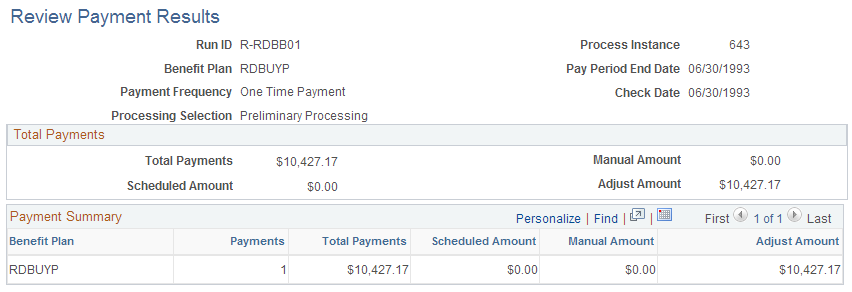

Use the Review Payment Results page (PA_RT_SUM_INFO) to view summary data about the total payments that were processed during the payment run.
Navigation
Image: Review Payment Results page
This example illustrates the fields and controls on the Review Payment Results page.
Field or Control |
Definition |
| Run ID, Benefit Plan, Payment Frequency, Pay Period End Date, and Check Date |
These fields are used in the Retiree Payment process. |
| Process Instance |
The process instance is assigned by the Process Scheduler. Use it to look up processing messages on the Review Processing Messages page. |
| Processing Selection |
The processing mode: Preliminary Processing or Confirmation Processing. |
| Total Payments |
The sum of all payments (for all plans and all payees) that are included in this payment run. This is the total of the amounts in the following fields: Scheduled Amount, Manual Amount, and Adjust Amount. |
| Scheduled Amount |
The total of all scheduled payments with payment reasons other than Manual. |
| Manual Amount |
The total of all scheduled payments with payment reasons of Manual. |
| Adjust Amount (adjusted amount) |
The total of all one-time payments entered on the Make One-Time Adjustments page. |
| Payment Summary |
This scrolling area displays a plan-by-plan breakdown of the information—each benefit plan and its associated number of payments, total payment amount, scheduled amount, manual amount, and adjusted amount. |

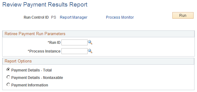

Use the Review Payment Results Report page (RUNCTL_RVWPMNT) to run a report so that you can view detailed retiree payment information.
Navigation
Image: Review Payment Results Report page
This example illustrates the fields and controls on the Review Payment Results Report page.
Field or Control |
Definition |
| Run ID |
This field is used in the Retiree Payment process. |
| Process Instance |
| Payment Details - Total |
This option displays the following information for all retirees: Payment Amount, Adjustment Amount, Payment Total, Check Date, Set ID, Vendor ID and Vendor Name. |
| Payment Details - NonTaxable |
This option displays the following information for all retirees: NT Payment Amount non-taxable payment amount), NT Adjustment Amount (non-taxable adjustment amount), NT Payment Total (non-taxable payment total), Check Date, Set ID, Vendor ID and Vendor Name. |
| Payment Information |
This option displays the following information for all retirees: Form Code, Payment Number, Guaranteed Payments, Percent to Survivor and Designated Payee. |
