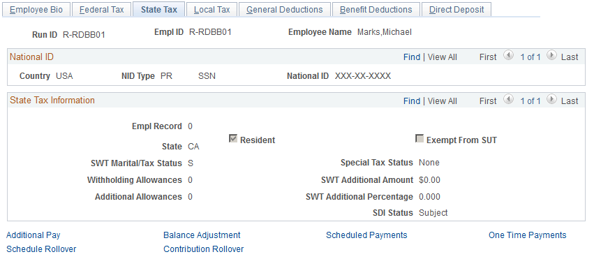

PA_TE_STX_INFO |
View a payee's state tax elections for one retiree record. A payee who is subject to withholding from more than one state can have multiple state tax records for a single retiree record. |

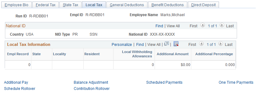

PA_TE_LTX_INFO |
View a payee's local tax elections for one retiree record. A payee who is subject to withholding from more than one locality can have multiple local tax records for a single retiree record. |

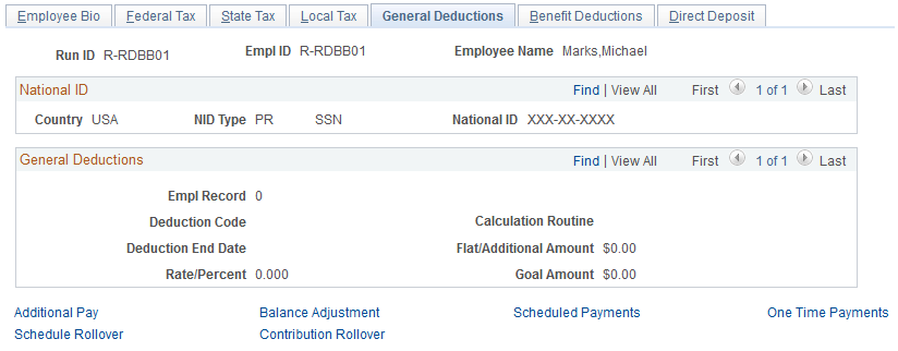

PA_TE_GDED_INFO |
View a payee's general deductions for one retiree record. Payees can have multiple deductions per job. General deductions are typically deductions for anything other than benefits, although some organizations use general deductions for benefits, as well. |

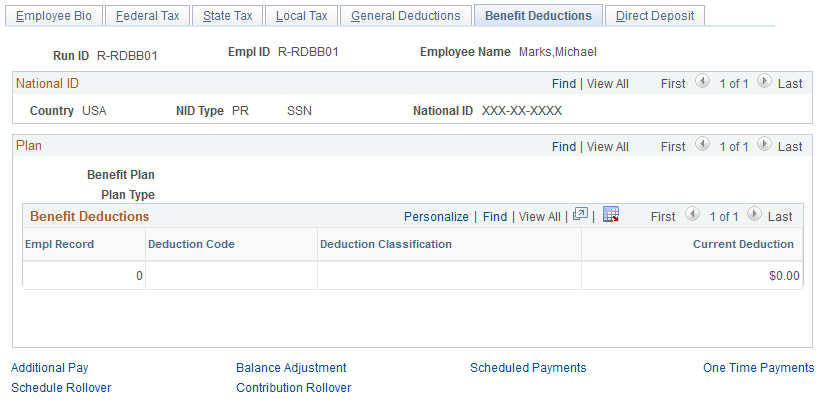

PA_TE_BDED_INFO |
View a payee's benefit deductions for one retiree record. Payees can have multiple deductions per job. |

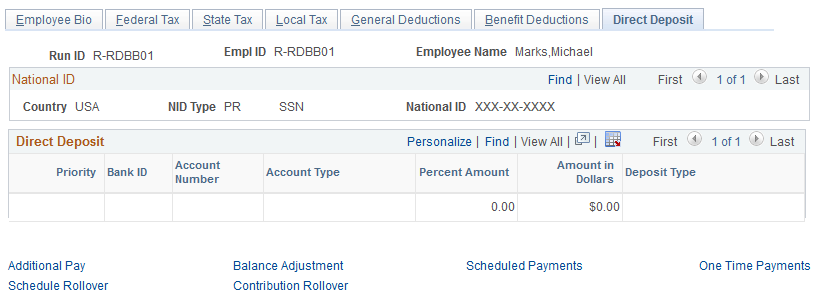

PA_TE_DDEP_INFO |
View a payee's direct deposit instructions for one retiree record. |

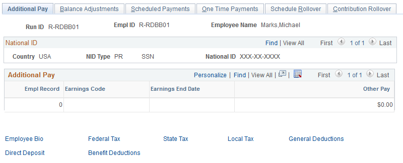

PA_TE_APAY_INFO |
View a payee's additional pay for one retiree record. Payees can have multiple additional pay records per job. |

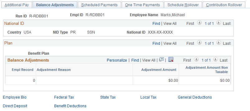

PA_TE_BADJ_INFO |
View information that can be used to adjust running payment totals for a retiree. The adjustment data is informational only; the system does not apply the adjustments to the running totals. You must make the adjustment manually. Adjustments apply to one retiree record only. Payees can have multiple balance adjustments per job. |

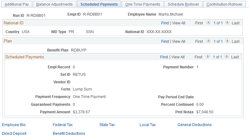

PA_TE_SPMT_INFO |
View payment amounts and descriptions for recurring payments for one retiree record. Each retiree record corresponds to a single plan, but payees can have multiple scheduled payment records per retiree record if there are multiple payment streams from a plan. |

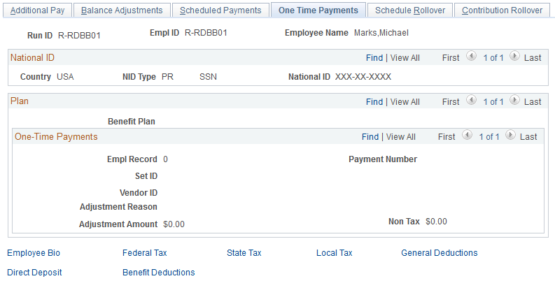

PA_TE_1PMT_INFO |
View payment amounts and descriptions for one-time payments for a single payment number under a single retiree record. One-time payments can be positive or negative. Negative payments offset any regularly scheduled payment occurring in the same period. |

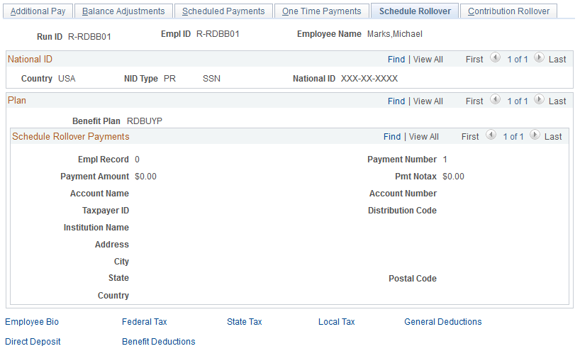

PA_TE_SCHED_RLOVR |
Displays rollover information for a particular RUN ID with regard to scheduled payments. |

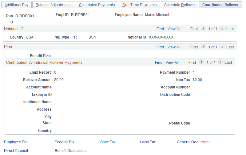

PA_TE_CTB_RLOVR |
Displays rollover information for a particular RUN ID with regard to contribution withdrawals. |

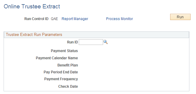

You can also review the contents of the Trustee Extract file by running the Trustee Extract reports: PAT08 - Trustee Extract Detailed Report and PAT09 - Trustee Extract Summary Report - Record Type.

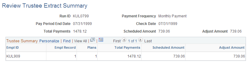

Use the Review Trustee Extract Summary page (PA_TE_SUM_INFO) to:
View a list of the employees included in a particular trustee extract run.
View summary payment information about each employee.
Navigation
Image: Review Trustee Extract Summary page
This example illustrates the fields and controls on the Review Trustee Extract Summary page.
Field or Control |
Definition |
| Run ID, Payment Frequency, Pay Period End Date, and Check Date |
These fields provide summary information about the pay run that is the basis for the extract. The run ID determines the payment frequency, pay period end date, and check date. |
| Total Payments |
This is the sum of all payments—for all plans and all payees—included in this pay run. This amount comprises the total of the scheduled amount and adjusted amount. |
| Scheduled Amount |
The total of payments scheduled on the Payee Payment Schedule and Payee Manual Schedule pages. |
| Adjust Amount (adjusted amount) |
The total of one-time payments (positive and negative) entered on the Make One-Time Adjustments page. |
Trustee Summary
This scrolling area displays a list of all employees included in the extract. If an employee is being paid based on more than one retiree job record, there is a separate row for each record.
For each retiree job record receiving payments, the page displays the EmplID and record number, the number of plans providing a benefit (typically one because you create an additional job record for each plan), and the total payments, scheduled amount, and adjusted amount for that payee.

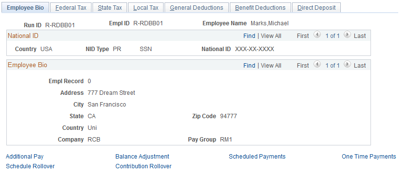

Use the Employee Bio (employee biography) page (PA_TE_BIO_INFO) to view personal information about a payee.
Navigation
Image: Employee Bio page
This example illustrates the fields and controls on the Employee Bio page.
Bio records have the record type 20.

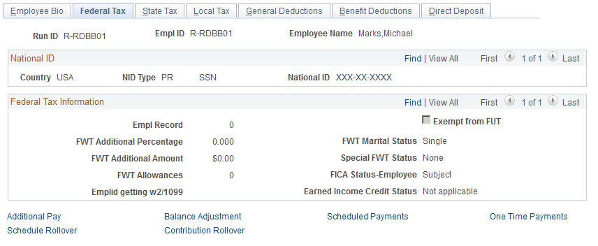

Use the Federal Tax page (PA_TE_FTX_INFO) to view a payee's federal tax elections for one retiree record.
Navigation
Image: Federal Tax page
This example illustrates the fields and controls on the Federal Tax page.
Federal tax records have the record type 30.
Federal Tax Data |
Format |
Length |
Beginning Position |
Ending Position |
Record Type |
Character |
2 |
1 |
2 |
Employee ID |
Character |
11 |
3 |
13 |
Employee Record Number |
Number |
4 |
14 |
17 |
Marital Status for Federal Withholding |
Character |
1 |
18 |
18 |
Allowances for Federal Withholding |
Number |
4 |
19 |
22 |
Additional Amount to Withhold |
Signed Decimal |
5.2 |
23 |
29 |
Additional Percentage to Withhold |
Signed Decimal |
2.3 |
30 |
34 |
Special Withholding Status |
Character |
1 |
35 |
35 |
FICA Status |
Character |
1 |
36 |
36 |
FUTA Exempt Status |
Character |
1 |
37 |
37 |
EIC Status |
Character |
1 |
38 |
38 |
Employee ID for W-2 |
Character |
11 |
39 |
49 |
Use the State Tax page (PA_TE_STX_INFO) to view a payee's state tax elections for one retiree record.
Navigation
Image: State Tax page
This example illustrates the fields and controls on the State Tax page.
State tax records have the record type 31.
State Tax Data |
Format |
Length |
Ending Position |
Record Type |
Character |
2 |
1 |
2 |
Employee ID |
Character |
11 |
3 |
13 |
Number |
4 |
14 |
17 |
State |
Character |
6 |
18 |
23 |
Resident |
Character |
1 |
24 |
24 |
Special Status for State Withholding |
Character |
1 |
25 |
25 |
Marital Status for State Withholding |
Character |
1 |
26 |
26 |
Allowances for State Withholding |
Number |
4 |
27 |
30 |
Additional Allowances for State Withholding |
Number |
4 |
31 |
34 |
Signed Decimal |
5.2 |
35 |
41 |
Signed Decimal |
2.3 |
42 |
46 |
SDI Status |
Character |
1 |
47 |
47 |
SUT Exempt |
Character |
1 |
48 |
48 |
Use the Local Tax page (PA_TE_LTX_INFO) to view a payee's local tax elections for one retiree record.
Navigation
Image: Local Tax page
This example illustrates the fields and controls on the Local Tax page.
Local tax records have the record type 32.
Local Tax Data |
Format |
Length |
Ending Position |
Record Type |
Character |
2 |
1 |
2 |
Employee ID |
Character |
11 |
3 |
13 |
Number |
4 |
14 |
17 |
State |
Character |
6 |
18 |
23 |
Locality |
Character |
7 |
24 |
30 |
Resident |
Character |
1 |
31 |
31 |
Allowances for Local Withholding |
Number |
4 |
32 |
35 |
Signed Decimal |
5.2 |
36 |
42 |
Signed Decimal |
2.3 |
43 |
47 |
Use the General Deductions page (PA_TE_GDED_INFO) to view a payee's general deductions for one retiree record.
Navigation
Image: General Deductions page
This example illustrates the fields and controls on the General Deductions page.
General deduction records have the record type 40.
General Deduction Data |
Format |
Length |
Ending Position |
Record Type |
Character |
2 |
1 |
2 |
Employee ID |
Character |
11 |
3 |
13 |
Number |
4 |
14 |
17 |
Deduction Code |
Character |
6 |
18 |
23 |
Deduction End Date |
Character |
10 |
24 |
33 |
Deduction Calculated |
Character |
1 |
34 |
34 |
Additional Amount to Deduct |
Signed Decimal |
8.2 |
35 |
44 |
Percentage Rate for Deduction |
Signed Decimal |
4.3 |
45 |
51 |
Goal |
Signed Decimal |
8.2 |
52 |
61 |
Use the Benefit Deductions page (PA_TE_BDED_INFO) to view a payee's benefit deductions for one retiree record.
Navigation
Image: Benefit Deductions page
This example illustrates the fields and controls on the Benefit Deductions page.
Benefit deduction records have the record type 41.

Use the Direct Deposit page (PA_TE_DDEP_INFO) to view a payee's direct deposit instructions for one retiree record.
Navigation
Image: Direct Deposit page
This example illustrates the fields and controls on the Direct Deposit page.
Direct deposit records have the record type 50.
Direct Deposit Data |

Use the Additional Pay page (PA_TE_APAY_INFO) to view a payee's additional pay for one retiree record.
Navigation
Image: Additional Pay page
This example illustrates the fields and controls on the Additional Pay page.
Additional pay records have the record type 60.
Additional Pay Data |
Format |
Length |
Ending Position |
Record Type |
Character |
2 |
1 |
2 |
Employee ID |
Character |
11 |
3 |
13 |
Number |
4 |
14 |
17 |
Earnings Code |
Character |
3 |
18 |
20 |
Earnings End Date |
Character |
10 |
21 |
30 |
Other Pay Amount |
Signed Decimal |
8.2 |
31 |
40 |
Use the Balance Adjustments page (PA_TE_BADJ_INFO) to view information that can be used to adjust running payment totals for a retiree.
Navigation
Image: Balance Adjustments page
This example illustrates the fields and controls on the Balance Adjustments page.
Balance adjustment records have the record type 70.

Use the Scheduled Payments page (PA_TE_SPMT_INFO) to view payment amounts and descriptions for recurring payments for one retiree record.
Navigation
Image: Scheduled Payments page
This example illustrates the fields and controls on the Scheduled Payments page.
Scheduled payment records have the record type 80.

Use the One Time Payments page (PA_TE_1PMT_INFO) to view payment amounts and descriptions for one-time payments for a single payment number under a single retiree record.
Navigation
Image: One Time Payments page
This example illustrates the fields and controls on the One Time Payments page.
One-time payment records have the record type 81.
One-Time Payment Data |
Format |
Length |
Ending Position |
Record Type |
Character |
2 |
1 |
2 |
Employee ID |
Character |
11 |
3 |
13 |
Number |
4 |
14 |
17 |
Pension Plan |
Character |
6 |
18 |
23 |
Payment Number |
Number |
4 |
24 |
27 |
SetID |
Character |
5 |
28 |
32 |
Vendor ID |
Character |
10 |
33 |
42 |
Reason for One Time Payment |
Character |
1 |
43 |
43 |
Amount of One Time Payment |
Signed Decimal |
9.2 |
44 |
54 |
Nontaxable Portion of One Time Payment Amount |
Signed Decimal |
9.2 |
55 |
65 |
Use the Schedule Rollover page (PA_TE_SCHED_RLOVR) to displays rollover information for a particular RUN ID with regard to scheduled payments.
Navigation
Image: Schedule Rollover page
This example illustrates the fields and controls on the Schedule Rollover page.
Records that contain rollover information from a Payment Schedule or a Manual Schedule have Record Type 82.
Scheduled Payment Rollover Data |
Format |
Length |
Ending Position |
Record Type |
Character |
2 |
1 |
2 |
Employee ID |
Character |
11 |
3 |
13 |
Number |
4 |
14 |
17 |
Pension Plan |
Character |
6 |
18 |
23 |
Payment Number |
Number |
4 |
24 |
27 |
Account Name |
Character |
50 |
28 |
77 |
Account Number |
Character |
17 |
78 |
94 |
Taxpayer ID |
Character |
14 |
95 |
408 |
Distribution Code |
Character |
2 |
109 |
110 |
Institution Name |
Character |
40 |
111 |
150 |
Institution Line Address 1 |
Character |
55 |
151 |
205 |
Institution Line Address 2 |
Character |
55 |
206 |
260 |
Institution Line Address 3 |
Character |
55 |
261 |
315 |
Institution City |
Character |
30 |
316 |
345 |
Institution County |
Character |
30 |
346 |
375 |
Institution State |
Character |
6 |
376 |
381 |
Institution Postal Code |
Character |
12 |
382 |
393 |
Institution Country |
Character |
30 |
394 |
423 |
Rollover Amount |
Signed Decimal |
9.2 |
424 |
434 |
Nontaxable Portion of Rollover Amount |
Signed Decimal |
9.2 |
435 |
445 |
Use the Contribution Rollover page (PA_TE_CTB_RLOVR) to displays rollover information for a particular RUN ID with regard to contribution withdrawals.
Navigation
Image: Contribution Rollover page
This example illustrates the fields and controls on the Contribution Rollover page.
Records that contain rollover information from a Contribution Withdrawal have Record Type 83.
Contribution Withdrawal Rollover Data |
Format |
Length |
Ending Position |
Record Type |
Character |
2 |
1 |
2 |
Employee ID |
Character |
11 |
3 |
13 |
Number |
4 |
14 |
17 |
Pension Plan |
Character |
6 |
18 |
23 |
Payment Number |
Number |
4 |
24 |
27 |
Account Name |
Character |
50 |
28 |
77 |
Account Number |
Character |
17 |
78 |
94 |
Taxpayer ID |
Character |
14 |
95 |
408 |
Distribution Code |
Character |
2 |
109 |
110 |
Institution Name |
Character |
40 |
111 |
150 |
Character |
55 |
151 |
205 |
Character |
55 |
206 |
260 |
Character |
55 |
261 |
315 |
Institution City |
Character |
30 |
316 |
345 |
Character |
30 |
346 |
375 |
Institution State |
Character |
6 |
376 |
381 |
Character |
12 |
382 |
393 |
Character |
30 |
394 |
423 |
Rollover Amount |
Signed Decimal |
9.2 |
424 |
434 |
Signed Decimal |
9.2 |
435 |
445 |

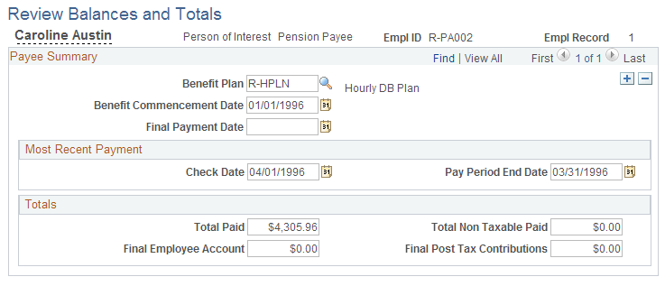

Use the Review Balances and Totals page (PA_RT_EMP_SUM) to:
Track the payment process that automatically updates information under the appropriate payee record number.
View the amount of a retiree's contributions that has been repaid.
Navigation
Image: Review Balances and Totals page
This example illustrates the fields and controls on the Review Balances and Totals page.
Note: The payment summary does not adjust running totals based on scheduled balance-only adjustments. When you schedule a balance-only adjustment, you should manually update the payment summary information.
Field or Control |
Definition |
| Benefit Plan |
The benefit plan is the plan paying the retirement benefits for the specified record number (job number). Remember, a payee has separate jobs for separate plan benefits. |
| Benefit Commencement Date |
The benefit commencement date is the effective date of the first active payment record on a payee's payment schedule. This gets set after the first payment. |
| Final Payment Date |
The final payment date is the date of the last payment. This is set during the payment period after the last payment. |
Most Recent Payment
The Most Recent Payment group box provides information about the most recently processed pension payment.
Field or Control |
Definition |
| Check Date |
The check date of the most recently processed pension payment. |
| Pay Period End Date |
The pay period end date of the most recently processed pension payment. |
Totals
The Totals group box contains several running totals for the payments.
Field or Control |
Definition |
| Total Paid |
The total amount paid is the sum of all payments. This amount is updated each time a person is paid. |
| Total Non Taxable Paid |
When the total nontaxable amount paid is equal to the final posttax contributions, the system automatically overrides instructions to treat any part of a recurring or one-time payment as nontaxable. You can still, however, make an adjustment to the nontaxable balance with a one-time balance adjustment. If such an adjustment leaves room for additional nontaxable payments, the system once again permits them. The total nontaxable amount paid is the portion of the total paid amount that was treated as nontaxable. This amount is updated each time a person is paid. |
| Final Employee Account |
The final employee account amount is the final value of employee contributions (including interest) at the benefit commencement date. This amount includes taxable and nontaxable components. When a payee dies, you can compare this amount to the total paid amount to determine whether the payee recovered the entire value of the account. |
| Final Post Tax Contributions |
The Final Post Tax Contributions field provides the nontaxable component of a final employee account. You can use this to track total nontaxable payments. When the total nontaxable amount paid is equal to the final posttax contributions amount, the system automatically overrides instructions to treat any part of a recurring or one-time payment as nontaxable. You can still, however, make an adjustment to a nontaxable balance with a one-time balance adjustment. If such an adjustment leaves room for additional nontaxable payments, the system once again permits them. |
Use the Online Trustee Extract page (RUNCNTL_PMTDTL) to:
Print the details of the information on the Trustee Extract file (PAT08 - Trustee Extract Detailed Report).
List the participants receiving payments from a particular pay run, and provide summary totals for the pay run (PAT09 - Trustee Extract Summary Report - Record Type).
Navigation
Image: Online Trustee Extract page
This example illustrates the fields and controls on the Online Trustee Extract page.
