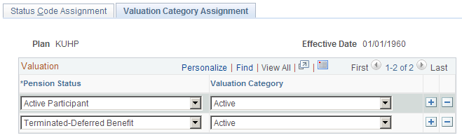

Valuation Category Assignment Page
PA_PEN_VAL
Map the appropriate valuation categories to a participant's pension statuses.
You must first assign the status codes on the Status Codes - Status Codes Assignment page.

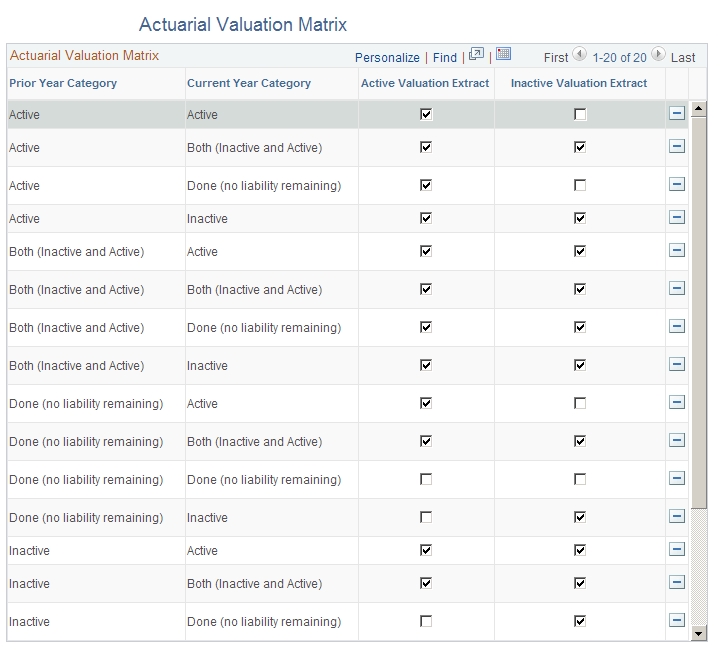

Actuarial Valuation Matrix Page
PA_PEN_VAL_MTX
Specify how to treat combinations of valuation categories.

Use the Valuation Category Assignment page (PA_PEN_VAL) to map the appropriate valuation categories to a participant's pension statuses. You must first assign the status codes on the Status Codes - Status Codes Assignment page.
Image: Valuation Category Assignment page
This example illustrates the fields and controls on the Valuation Category Assignment page.
Field or Control
Definition
Pension Status
Insert a row for each of the system's 21 pension status codes.
Valuation Category
For each status, identify one of the following valuation categories:
Active: Participants who still accrue benefits.
Inactive: Participants who are no longer accruing benefits, but have not yet been completely paid.
Both: Participants who fall into both the active and inactive categories—for example, a rehired retiree who is receiving pension payments and is also continuing to accrue additional benefits.
Done: Participants who have received their entire benefit. The plan no longer owes them anything.
No Record Exists: You do not assign this value; the system sets it as the prior-year valuation category when an employee appears in the system for the first time.
Use the Actuarial Valuation Matrix page (PA_PEN_VAL_MTX) to specify how to treat combinations of valuation categories.
The Actuarial Valuation Extract uses a combination of the current and prior years' valuation categories to determine how to create the extract files. You use the Actuarial Valuation Matrix page to specify how the system should treat combinations of these valuation categories. The information that you set up on this page applies to all plans.
Image: Actuarial Valuation Matrix page
This example illustrates the fields and controls on the Actuarial Valuation Matrix page.
Field or Control
Definition
Active Valuation Extract and Inactive Valuation Extract
For each combination of prior year and current year valuation categories, select:
  • Active Valuation Extract to include participants with this combination of categories in the active extract file.
  • Inactive Valuation Extract to include participants with this combination of categories in the inactive extract file.
The delivered values appear by default, but be sure to conduct your own analysis.
Note: You must scroll to review all of the possible combinations.
