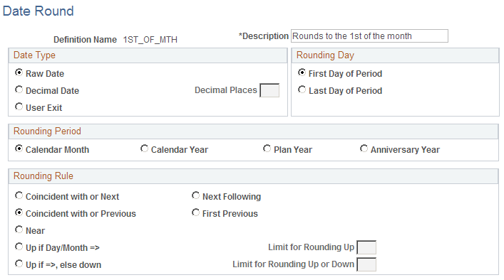

Use the Date Round page (PA_DATE_ROUND) to set up date rounding rules.
Pension plans frequently round dates. For example, if normal retirement date (NRD) is the first of the month after a participant's 65th birthday, you create an NRD alias by applying a rounding option to the date representing the birthday.
Navigation
Image: Date Round page
This example illustrates the fields and controls on the Date Round page.
Date Type
Field or Control |
Definition |
| Raw Date, Decimal Date, or User Exit |
Select Raw Date to use the raw date format. You can assume that you are using a raw date unless you use the date conversion option specifically to create a decimal date. Select Decimal Date to use the decimal date format, and enter the number of decimal places. Select User Exit to set up your own date rounding method. |
Rounding Day, Rounding Period, and Rounding Rule
A date rounding definition consists of three parts: the rounding date, the rounding period, and the rounding rule. These are illustrated in the following examples:
Rounding Day |
Rounding Rule |
Rounding Period |
First day of |
the previous |
month |
Last day of |
the current |
calendar year |
First day of |
the next |
plan year |
When you round to the last day of a period, you do not have to specify the rounding rule. In this case, the date is always rounded to the last day of the current period. For example, if you round to the last day of the calendar month, August 8, 2008 becomes August 31, 2008. If, however, you round to the first day of a period, you must select a rounding rule.
Basic Rounding Rules
There are five basic rounding rules:
Coincident or Next
Next
Coincident or Previous
Previous
Near
The following table illustrate how each of these options works. In all cases, the date is being rounded to the first of the month.
Rounding Rule |
Base Date |
Rounded Date |
Coincident or Next |
May 1, 2005 |
May 1, 2005 |
May 2, 2005 |
June 1, 2005 |
Next |
May 1, 2005 |
June 1, 2005 |
Coincident or Previous |
May 1, 2005 |
May 1, 2005 |
Previous |
May 1, 2005 |
April 1, 2005 |
Previous |
May 2, 2005 |
May 1, 2005 |
Near |
May 3, 2005 |
May 1, 2005 |
Rounding Rules with Thresholds
There are also two rounding rules that incorporate thresholds:
Up if Day/Month => rounds up if the day or month is greater than or equal to the threshold you set in the Limit for Rounding Up field.
Up if =>, Else Down rounds up if the day or months is greater than or equal to the threshold you set in the Limit for Rounding Up or Down field, otherwise it rounds down.
With both of these options, you specify the threshold number of days in a month (if the rounding period is months) or months in a year (if the rounding period is any type of year). Both options round up after the specified number of days or months. However, the first option leaves dates under the threshold unrounded, whereas the second option rounds down.
Note: The threshold options do not apply if you round decimal dates.
Threshold Rounding Rule |
Base Date |
Threshold |
Rounded Date |
Up if Day/Month => Threshold No. |
May 17, 2005 |
15 |
June 1, 2005 |
May 17, 2005 |
20 |
May 17, 2005 |
Up if Day/Month => … Else Down |
May 17, 2005 |
15 |
June 1, 2005 |
May 17, 2005 |
20 |
May 1, 2005 |

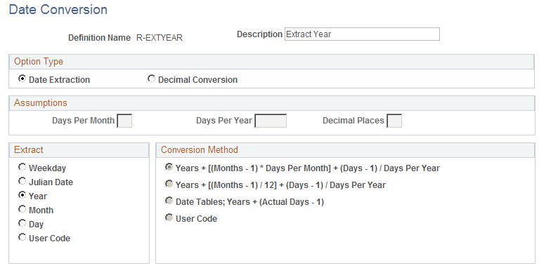

Use the Date Conversion page (PA_DATE_CONV) to establish methods for converting raw dates to decimal dates and vice versa, and for extracting data elements from raw dates.
Navigation
Image: Date Conversion page
This example illustrates the fields and controls on the Date Conversion page.
Option Type
Field or Control |
Definition |
| Date Extraction or Decimal Conversion |
Select one of these options:
Assumptions
Field or Control |
Definition |
| Days Per Month and Days Per Year |
When you convert days, you can either convert the days to months and then the months to years, or you can convert days to years in a single step. In the first case, you have to specify how many days per month to assume; in the second case, you have to specify the assumed days per year. |
| Decimal Places |
There are always twelve months in a year, so converting months is straightforward: each complete month equals .083333 years. The decimal is carried out to the number of places that you specify. |
Extract
Sometimes a calculation needs the year, month, or day of a date, but not all three. For example, suppose your employees' periodic earnings consolidations are based on compensation rate on each anniversary of their hire dates. You need date aliases that determine the month and the day of hire. This means that if an employee is hired on March 17, 2007, the month extraction alias resolves to 3, and the day extraction alias resolves to 17.
Field or Control |
Definition |
| Weekday, Julian Date, Year, Month, Day, or User Code |
Select the element you want to extract. The Julian date represents the number of actual calendar days in the year, up to and including the date. For example, January 31 is 31 days, and February 1 is 32 days. All extraction results are decimals, including month and weekday extractions. For example, when you extract the month from June 30, 2005, the result is 6. When you extract the weekday from a Sunday date, the result is 1. You can only apply date extraction options to raw dates, not to decimal dates. |
