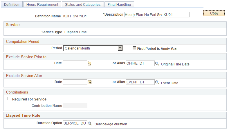

Use the Service-Elapsed Time - Definition page page (PA_SVC_DEFINIT_TM) to set up basic information about your service definition. This includes a service period to be used in the elapsed time computation, any periods to exclude from service, and whether contributions are required.
Image: Service-Elapsed Time - Definition page
This example illustrates the fields and controls on the Service-Elapsed Time - Definition page.
Field or Control
Definition
Copy
This is a shortcut you can use to copy a similar definition. Establish the first definition, click the Copy button, enter a new name and description, and the system clones the original definition using the new name. You can then make whatever minor adjustments you need to the new definition. If you have to make major adjustments, consider creating the new definition from scratch instead of copying an existing definition.
Service
Field or Control
Definition
Service Type
When you access this page through the Service-Elapsed Time component, the type is always Elapsed Time.
When you access this page through the Service-Hours Counting component, the type is always Hours Counting.
When you access this page through the Service-Hours Equivalence component, the type is always Hours Equivalence.
Computation Period
Field or Control
Definition
Period
An elapsed time service definition specifies how to measure the duration between two dates, typically the hire date and the event date. When Pension Administration calculates elapsed time, however, this time is broken into computation periods. Total elapsed time is then the sum of the service credit for each period.
Select one of the following period types:
  • Calendar Month: If you select this period, service is expressed in years. For example, an employee can get .083333 years of service in a month (1/12 year).
  • Anniversary Year: If you select this period, the anniversary year begins on the employee's date of hire. For other computation periods, an employee's first period is typically a short period.
  • Calendar Year or Plan Year: If you select one of these periods, you can give employees the benefit of a full-year first period by selecting First Period is Anniv Year. Then, your adjusted first period overlaps with the second period, as shown below.
    Image: Illustration of an employee's computation period where the first period is the anniversary period
    This diagram shows the unadjusted first period and the adjusted first period when your computation period is Calendar Year or Plan Year and you select the First Period is Anniv Year check box. The unadjusted first period ends when the second period starts, but the adjusted first period overlaps continues into the second period.
    Note: Under this option, the employee receives double service credit for the period of time that falls in both the first and second periods.
Exclude Service Prior to and Exclude Service After
Field or Control
Definition
Date and Alias
If you want to exclude service before or after a particular time, such as the participation date, enter a constant date or alias in the Exclude Service Prior to and Exclude Service After group boxes.
Contributions
Field or Control
Definition
Required for Service
Select this check box if employees must contribute to the plan in order to receive service credit.
Contribution Name
Enter the name of the employee accounts function result that keeps track of employee contributions.
The employee accounts function creates a period-by-period history. If an employee makes contributions at any time during a period, the service function grants the employee service for that period.
Note: The best practice is to use an employee accounts period identical to or shorter than the service computation period in order to more accurately align employee contributions to service periods.
Elapsed Time Rule
Field or Control

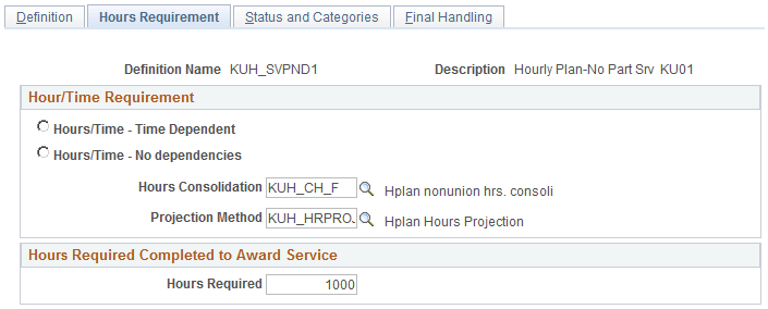

Use the Hours Requirement page (PA_SVC_TIME_HRS) to set up hours thresholds that employees must meet before getting service credit for a computation period. For example, if your computation period is a calendar year, you can require employees to have at least 500 hours of service within a year before getting service credit.
Image: Hours Requirement page
This example illustrates the fields and controls on the Hours Requirement page.
Hour/Time Requirement
Field or Control
Definition
Hours/Time - Time Dependent and Hours/Time - No dependencies
Select Hours/Time - Time Dependent if the service requirement depends on the participant meeting an hours threshold.
Select Hours/Time - No dependencies it service credit is not dependent on an hours requirement. If you select this option, you can make no further entries on this page.
Hours Consolidation
This directs the system to the appropriate hours history for determining whether an employee meets the threshold requirements.
Projection Method
This provides instructions for projecting hours, if necessary.
Hours Required Completed to Award Service
Field or Control
Definition
Hours Required
Enter the number of hours that an employee must work before getting service credit.

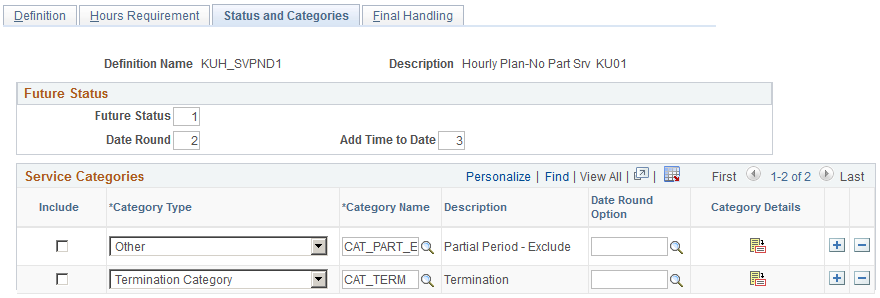

Use the Status and Categories page (PA_SVC_STATUS) to establish which employee action and reason codes turn service accrual off and which turn service accrual on.
Note: This page is used when defining elapsed time service, hours counting service, and hours equivalence service.
Image: Service-Elapsed Time - Status and Categories page
This example illustrates the fields and controls on the Service-Elapsed Time - Status and Categories page.
Future Status (Status Adjustment Order)
An employee's HR status determines whether or not the employee accrues service. Status changes are reflected in the employee's action and reason history in the PeopleSoft Human Resources job records: hires, leaves, returns from leave, terminations, and any other action and reason codes you choose.
Sometimes you need to adjust the effective date of a status change. For example, if your plan gives service credit for the first 30 days of a leave, you need to indicate that the effective date of the leave must be adjusted by 30 days before service accrual ends. Further, you can indicate that this adjustment only occurs if the employee returns to work within a year.
Because you can make multiple adjustments to the effective date of a status change, you need to indicate the order in which adjustments are made. For example, you can indicate whether to round a date before or after adding time.
Note: You use the Service Category Detail page to add time to the effective date or to set up adjustments based on future status codes; you enter the rounding method on this page.
Field or Control
Definition
Future Status, Date Round, and Add Time to Date
To indicate the order in which the system should apply the adjustments, enter 1, 2, and 3 next to the three adjustment types.
Add Time to Date has no effect for hours counting service.
Note: If an adjustment causes a date to overlap with the date of another status code, then calculations fail.
Service Categories
Field or Control
Definition
Include
Select this option if actions in the category start an include service segment. If the actions in the category start an exclude service segment, leave that option deselected. Actions not specifically included in any of the categories on this page do not affect service status.
Warning! Be sure to include both events that start and stop service. For example, if you stop service for a leave, be sure to start service for a return from leave.
Category Type
Set one of the following category types: Hire Category, Termination Category, or Other. The system uses this information when you set up adjustments that add time to a period. You specify whether the adjustments apply to hire periods, termination periods, or all periods.
Category Name
In the Service Categories grid, select each HR action and reason category name that the service definition needs to look for. This includes reasons for starting include service segments and for starting exclude service segments.
Date Round Option
If you round the effective dates within a category of action and reason events, enter the rounding method next to the category. For example, you might round all hire and rehire dates to the first of the month.
category details
Click the Category Details icon to access the Service Category Detail page, where you set up category-specific rules, including action/reason effective date adjustments, future status code adjustments, and service limits (minimums and maximums).

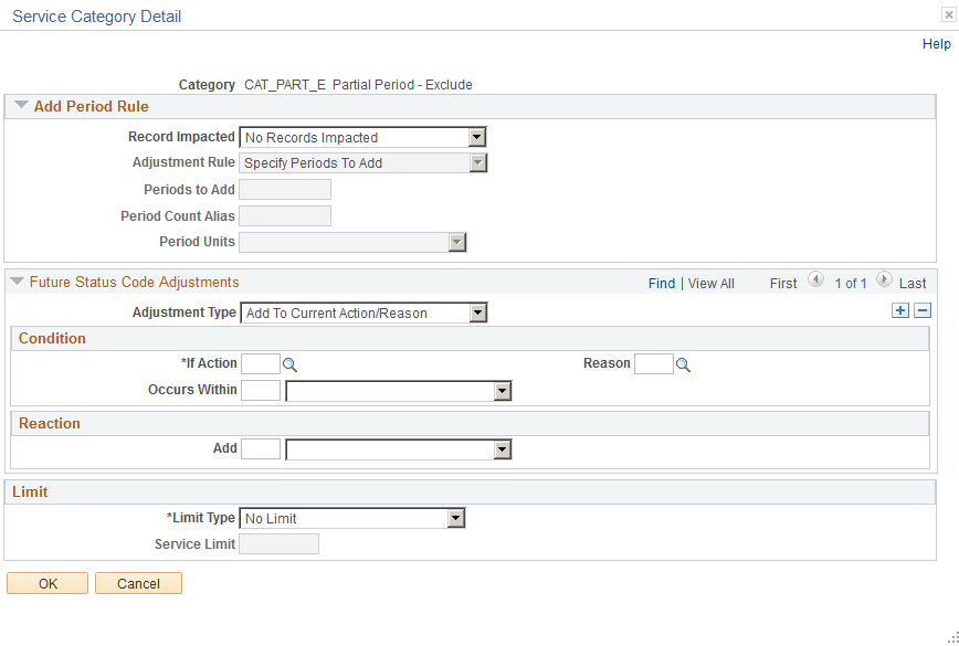

Use the Service Category Detail page (PA_SVC_CAT_SEC) to set up category-specific rules in service definitions. These rules can include action/reason effective date adjustments, future status code adjustments, and service limits (minimums and maximums).
Image: Service Category Detail page
This example illustrates the fields and controls on the Service Category Detail page.
Add Period Rule
Sometimes you may want to delay the effective date of an action and reason event. For example, if your employee can continue to accrue service for the first month of a leave, you need to adjust the effective date of any leave action by adding a month. Use the Service - Elapsed Time - Add Periods Rules page to add time periods to action and reason effective dates.
Field or Control
Definition
Record Impacted
Indicate which instances of a new status receive the adjustment by selecting one of the following: No Records Impacted, All, All But First, All But First and Last, All But Last, First Only, or Last Only,
When you add time to an action and reason effective date, you give additional service or break-in-service time by delaying the impact of the change. You may not want to do this for each occurrence of an event. For example, you could grant the 30-day leave of absence adjustment only for the first leave and not adjust any subsequent leaves.
If you selectNo Records Impacted, you can make no further entries in this group box.
Adjustment Rule
Select Specify Periods to Add to use the fields on this page to define the adjustment rules.
Select User Code to perform adjustments using your own custom code. If you selectUser Code, you can make no further entries in this group box.
Periods to Add, Period Count Alias, and Period Units
In the Period Units field, select Days, Weeks, Months, or Years. Then enter either a fixed number of days, weeks, months, or years to add, or enter an alias that provides that number.
Future Status Code Adjustments
The way you treat service for a particular HR status may depend on an employee's subsequent status. For example, employees on leave might accrue service only if they later return to work. You can choose to adjust a current event, based on a future event—or you can adjust a future event, based on a second future event.
Field or Control
Definition
Adjustment Type
For each adjustment, select one of the following types:
  • Add to Current Action/Reason Select this option to delay an effective date, based on other events occurring within defined periods of time afterward. For example, you can direct the system to adjust the effective date of a leave of absence by one month (to grant one month of extra service) only if an employee returns within one year.
    Use the fields in the Condition group box to indicate the conditions under which to make the adjustment.
    Use the fields in the Reaction group box (which appears when you select this adjustment type) to indicate the number of Days, Weeks, Months, or Years to add to the effective date of the current action/reason. Select User Code to use your own custom code to calculate the adjustment.
  • Ignore Current Action/Reason: Select this option to ignore the original HR status change, based on other events occurring within defined periods of time afterward. For example, you can choose to ignore a leave of absence if an employee returns within one month.
    Use the fields in the Condition group box to indicate the conditions under which to ignore the current action/reason.
  • Ignore Future Action/Reason: Select this option to ignore subsequent status changes if a specific event occurs within a defined period of time from the original status change. For example, if you terminate an employee on leave, but rehire that employee within a year of the original leave date, you can ignore the termination so that it appears that the employee was on leave the entire time.
    Use the fields in the Ignore Future Action/Reason group box (which appears when you select this adjustment type) to select the action and reason to be ignored.
  • Insert: Select this option to insert an action and reason event, based on another event's not occurring within a defined period of time afterward. For example, when a leave action occurs, you might insert a termination action if a return from leave does not occur within one year of the leave.
    Use the fields in the Insert Action/Reason group box (which appears when you select this adjustment type) to indicate the future event to be inserted. The future event is inserted on the same day as the initial action—in the example, on the same date that the leave started.
If Action, Reason, Occurs Within, and Does Not Occur Within
Indicate the action and reason codes of the future event in the If Action and Reason fields.
In the Occurs Within fields, enter a numeric value and then select Days, Months, Years, Weeks, or User Code to indicate how far in the future to look for the action and reason codes.
Note: If the Adjustment Type is Insert, the condition is that the action/reason does not occur within the given time period. For all other adjustment types, the condition is that the action reason does occur within the given time period.
Limit
The service function breaks computation periods into segments, based on HR status changes. For example, within a single year-long computation period, an employee might have a ten-month segment of active employment and a two-month segment of leave.
Some HR statuses might have associated minimum or maximum service accruals. For example, employees may be limited to a maximum of one year of service accrual while on leave. You need to set these limits.
Field or Control
Definition
Limit Type and Service Limit
In the Limit Type field, Indicate whether there is a limit on the service accrued for an employee who has the include status category by selecting No Limit, Minimum, or Maximum.
If you select Minimum or Maximum, enter the minimum or maximum amount of service credit in the Service Limit field.
Examples of Adjustments
