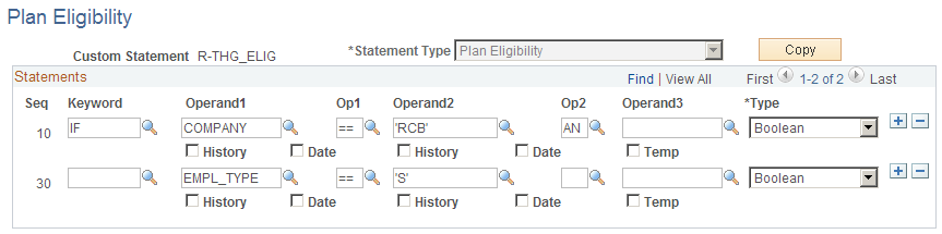

When you use the Custom Statement page to set up groups, you set up IF statements comparing employee data, referenced by aliases, to specified values. You have to enclose a value in single quotation marks to indicate that it is a literal value, rather than an alias.
For example, the following custom statement checks whether the Company is RCB and whether the employee type is S (salaried). If both conditions are true, the employee is in the group; otherwise, the employee is not.
Image: The Plan Eligibility page showing a group statement
This example illustrates the Plan Eligibility page showing a group statement.
You can enter AND and OR connectors in the Op2 field to string together multiple conditions.
