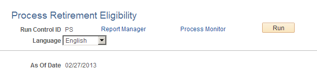

Use the Process Retirement Eligibility page (ST_RUNCTL_STFS016) to run the Stock – Retirement Eligibility (ST_RET_ELIG) Application Engine process to update optionee retirement eligibility information.
Navigation
Image: Process Retirement Eligibility page
This example illustrates the Process Retirement Eligibility page.
