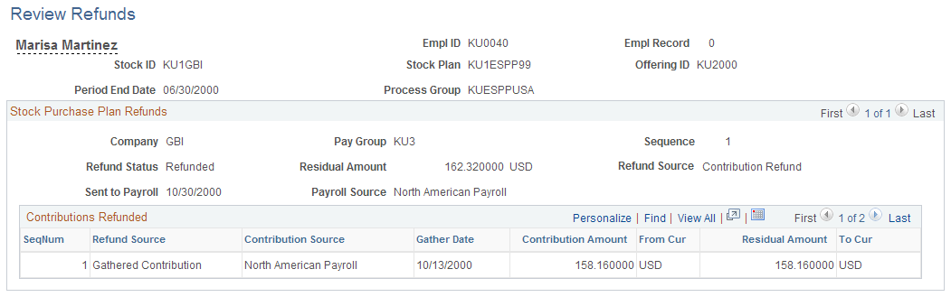

Use the Review Refunds page (ST_REFUND_ESPP) to view the results of the Refund process.
Navigation
Image: Review Refunds page
This example illustrates the Review Refunds page.
Field or Control |
Definition |
| Refund Status |
Displays Reversed or Refunded. |
| Residual Amount |
Displays the amount remaining after a previous purchase. |
| Sent to Payroll |
Displays the date on which the refund was sent to payroll. |
