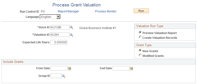

The Process Grant Valuation process executes the Black-Scholes Pricing model for the grants that you select. You can run the process in preview or confirmation mode.
To run the process:
Access the Process Grant Valuation page.
Specify the stock ID, valuation ID, and expected life years for the grants to be valued.
Indicate whether you want to preview or confirm a valuation.
Select the grants to include in the process.
Run the process.
Use the Process Grant Valuation page (ST_RUNCTL_VALUE) to run the Process Grant Valuation (Black Scholes) process.
Navigation
Image: Process Grant Valuation page
This example illustrates the Process Grant Valuation page.
Field or Control |
Definition |
| Expected Life Years |
Enter the expected remaining life that you deem appropriate for the group of options you're valuing. (You can use the Expected Life Year Analysis report to help determine this number.) The figure you enter determines which set of variables the system retrieves from the Estimate Table for use in the Black-Scholes Model. The system rounds up if you enter a number with a decimal that equals or exceeds .50. For example, 3.5 and 3.6 are rounded up to 4. If the Valuation ID represents the multiple valuation method, the Valuation process automatically adds the number you enter in this field to the length of each vesting period. The expected life must extend beyond the first vesting date but cannot extend beyond the last expiration date. For example, assume today is 07/01/2001, the first vesting date is 07/01/2003, and the last expiration date is 07/01/2011. In this case, the expected life years can be between 2 and 10. |
Valuation Run Type
Field or Control |
Definition |
| Preview Valuation Report and Create Valuation Records |
You can preview the valuation for a group of grants before you create it. Previewing prints the Valuation Detail report without saving the valuation records to the database. This report details the valuation calculation results for each grant processed. You can preview a valuation, change the values on the Valuation Table and run the preview process again. When you create a valuation record for each grant processed, the system also prints the Valuation Detail report. Once you create a Valuation ID for a given run, you cannot modify it unless you first reverse all valuation records for that Valuation ID. |
GrantType
Field or Control |
Definition |
| New Grants and Modified Grants |
Select the grants to include in the process. |
Include Grants
Enter selection criteria in the Include Grants group box.
Specify the Stock ID, Valuation ID, and expected life years for the grants you want to value and whether you want to preview or confirm a valuation.
