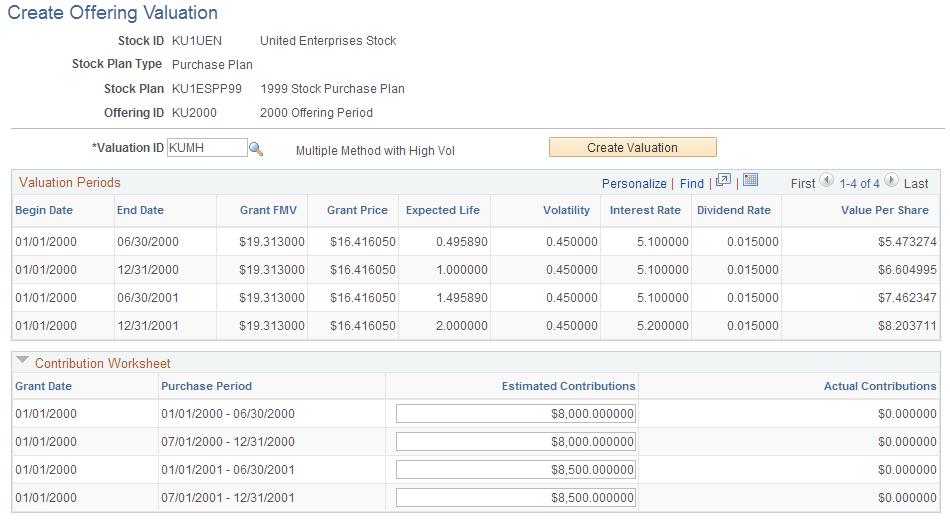

Use the Create Offering Valuation page (ST_OFFER_VALUE) to run the valuation process.
Navigation
Image: Create Offering Valuation page
This example illustrates the Create Offering Valuation page.
To run the Valuation process for a stock offering:
Select the Valuation ID.
Enter the estimated contribution for each purchase period.
The Contribution Worksheet group box lists, for each grant date with an offering, the purchase periods to be processed. At the beginning of an offering, enter the total estimated contributions for each purchase period that is associated with the grant. You can use the Estimate Contributions report to help determine the figures that you enter. The Actual Contributions field displays any actual contributions that have been made for each grant date/purchase period combination that is confirmed.
Click the Create Valuation button to begin the process.
The Valuation Periods group box displays the results of the Valuation process.
