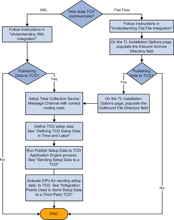

Image: Integrating Time and Labor with third-party TCDs
This diagram is provided as a guide for integrating third-party TCDs with Time and Labor

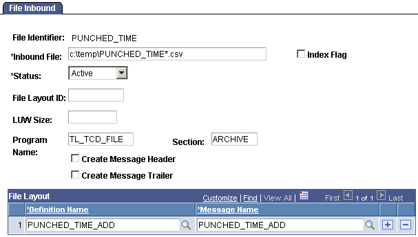

Set up the inbound file rule on the File Inbound page (Enterprise Components, Integration Definitions, Inbound File Rule).
On the Time and Labor Installation page, set up the File Dest for TCD Integration section.
Make sure that the selected directory will contain the elapsed or punch time files.
Your inbound file publish rules should look similar to the following:
Inbound File for Punched Time: c:\temp\PUNCHED_TIME_ADD*.csv. File Layout ID: Blank, LUW Size: Blank, Application: TL_TCD_FILE, Section: Archive, File Layout Name: 1 PUNCHED_TIME_ADD, Message Name: PUNCHED_TIME_ADD.
Image: Using File Inbound page to set up flat file integration
This graphic shows an example of the File Inbound page used to set up flat file integration
The comm server attached to your TCD creates and continually appends to a file of the form [message name]-[comm server]. csv. For example, comm server cs1 would create and append onto a file named PUNCHED_TIME_ADD-cs1.csv for its punch time message. The directory containing the comm-server-generated files should correspond to the directory in the Inbound File Rule.
