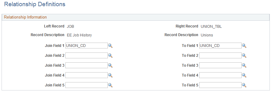

Use the Relationship Definitions page (TL_RELATIONSHIP) to create relationships between tables.
Navigation
Image: Relationship Definitions page
This example illustrates the fields and controls on the Relationship Definitions page. You can find definitions for the fields and controls later on this page.

| Join Fields 1-5 |
Enter the fields from each table that the system must use to create a relationship between the tables. |
Define a relationship definition when you use a condition that references a field that is not part of the updated record.
