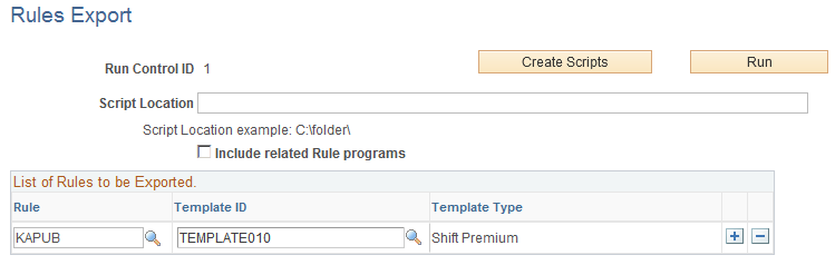

Use the Rules Export page (TL_EXP_RULE) to lists all of the rules that are to be exported from a source database and initiates the processes that select the listed rules and create a DataMover DAT file for exporting the rules.
Image: Rules Export page
This example illustrates the fields and controls on the Rules Export page. You can find definitions for the fields and controls later on this page.
Rules Export page
Field or Control
Definition
Include related Rule programs
Select this check box to include the most current effective-dated rows for the Rule Programs associated with the selected rules in the export file. If you do not select this field, then you must manually associate each imported rule to the corresponding rule program.
Create Scripts
Click to perform the following steps:
  1. Verify that the indicated script location path is correct, and Process Scheduler has write access to the desired output location.
  2. Analyze the content of each row in the Rules Export area of the page, resolve the selection of rules and store the results.
  3. Write the DataMover scripts for both the Export and Import rules processes.
Run
  1. Initiate a DataMover process scheduler request to generate the rules DAT file based on the Export script created by the Create Scripts process.
  2. List each rule that is selected and processed in the message log file and indicate the completion of the DataMover process.
Script Location
Enter the location used by the system to store the DataMover scripts and DAT file created by the Export process.
Rule ID
Enter a specific rule to include in the exported rules file.
Template ID
Enter a Rules Template name to select all of the rules associated with that template for export
Template Type
Select a Template Type to specify that all of the rules associated with all of the rules templates for the specified template type are selected for export.
