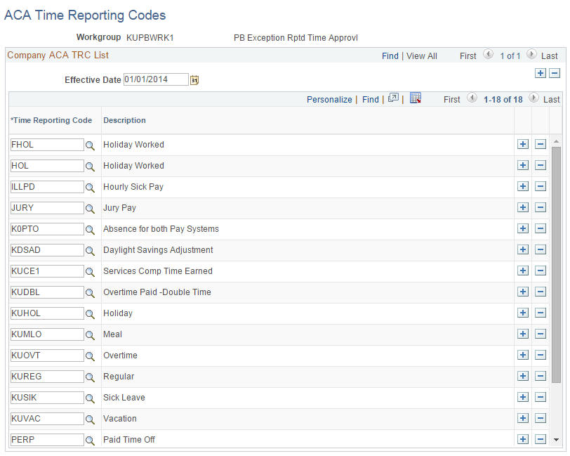

Use the ACA Time Reporting Codes page (ACA_TL_TBL) to define the Time Reporting Codes (TRCs) that are used to calculate the average number of hours for ACA eligibility.
Navigation
Image: ACA Time Recording Codes Page
This example illustrates the fields and controls on the ACA Time Recording Codes Page. You can find definitions for the fields and controls later on this page.
Field or Control |
Definition |
| Workgroup |
Specify a workgroup that the employee population uses which is subject to the ACA regulations. You need to define TRCs for all applicable workgroups. |
| Effective Date |
The effective date of the defined group of TRCs. |
| Time Reporting Code |
Specify all of the TRCs for calculating ACA eligibility for employees belonging to the workgroup. |

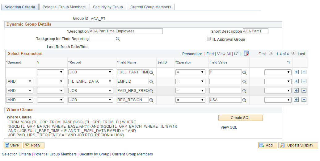

Use the Time and Labor Groups (TL_GROUP_D1) page to segregate your employee categories to which different measurement and stability periods are applied.
Note: Both static and dynamic groups have to be set up according to the need. This page description explains how to set up the dynamic groups.
Navigation
Image: Dynamic Group - Selection Criteria page
This example illustrates the fields and controls on the Dynamic Group - Selection Criteria page.

| Group ID |
| Taskgroup for Time Reporting |
This allows the separation of employee populations using the following categories:
salaried employees and hourly employees
employees whose primary places of employment are in different states
collectively bargained employees
non-collectively bargained employees
each group of collectively bargained employees covered by a separate collective bargaining arrangement.
