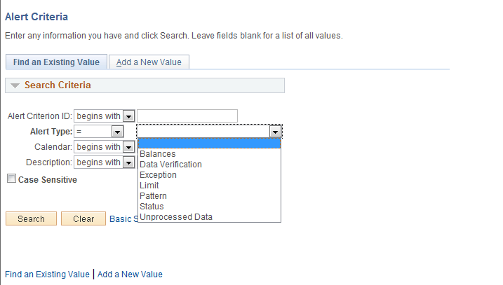

Use the Alert Criteria page (TL_ALRT_CRT) to define the circumstances that require an alert.
Image: Alert Criteria page
This example illustrates the fields and controls on the Alert Criteria page.
Alert Criteria Page
  • Defines whose data is subject to what checks and who gets notification if there is a violation.
  • Decides the type of Alert, its source and associate it with a given period.
  • Qualify and quantify the data and criteria setting for acceptable limit or boundary for the data that meets criteria.
  • Using the alert criteria, you can configure the criteria of each alert. The source of the alert criteria defines the data which has to be monitored. Also, you can set the criteria based on a defined calendar period.
Type
Source
Balances
Compensation Leave/ Leave Plan table
Exceptions
Exceptions
Limit
Absence Event, Payable Time, Reported Time
Pattern
Absence Event, Reported Time
Status
Unprocessed Data
Data Verification

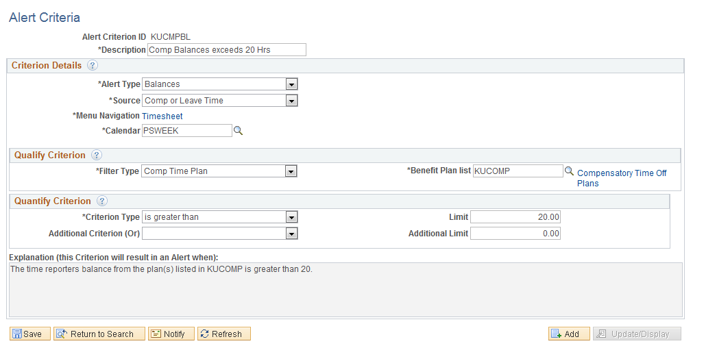

Image: Alert Criteria-Balances
This example illustrates fields and controls on the alert criteria for balance type.
Alert Criteria - Balances
Field or Control
Definition
Criterion Details
Specify the type of Alert, its source and associate it with a period.
Qualify the criterion by further refining what data should be reviewed. Quantify the criterion by setting the acceptable limit or boundary for the data that meets the criteria; for example the maximum hours of overtime reported for a week before an alert should be triggered
Portal Target
Select the common page within the portal where the recipient of the alert should be directed when reviewing the data that triggers this type of alert.

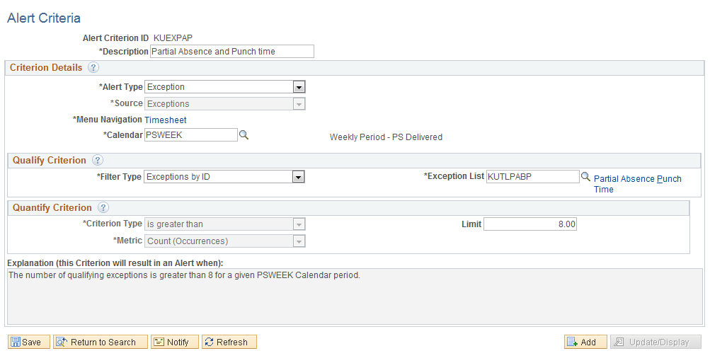

Image: Alert Criteria-Exception
This example illustrates fields and controls on the alert criteria for Exception alert Type.
Alert Criteria - Exceptions
Field or Control
Definition
Quality Criterion
Specify additional parameters for the data to be considered when validating this criterion, like a set of Time Reporting Codes or a set of Status codes
Quantify Criterion
Define the boundary (or boundaries) outside which this criterion should trigger an alert, such as the minimum and / or maximum hours generally allowed.

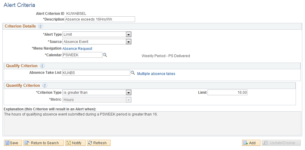

Image: Alert Criteria-Limit
This example illustrates fields and controls on the alert criteria for Limit.
Alert Criteria - Limit
Limits do not require value list to be entered. It may be sufficient to express the limit without specifying a set of TRC’s or Absence codes. This particularly rings true in terms of limits such as estimated gross on payable time.

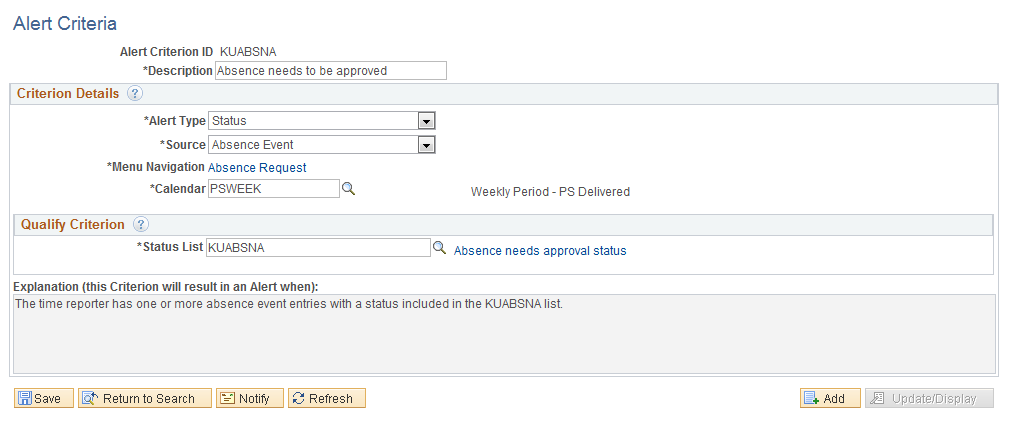

Image: Alert Criteria-Status
This example illustrates fields and controls on the alert criteria for Status
Alert Criteria:Status page
Status check alerts are provided against Absence Events, Payable Time and Reported time.

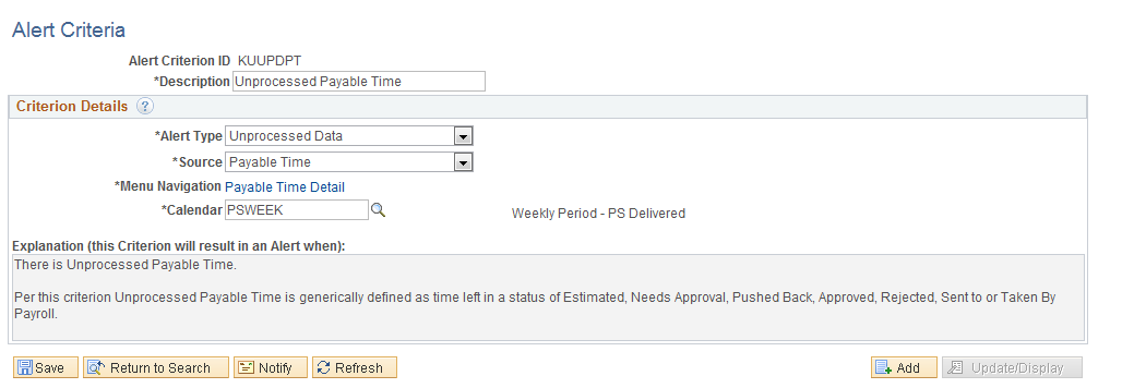

Image: Alert Criteria-Unprocessed Time
This example illustrates fields and controls on the alert criteria for unprocessed time.
Alert Criteria - Unprocessed Data
Unprocessed time is expressed in the explanation when the criterion is defined.

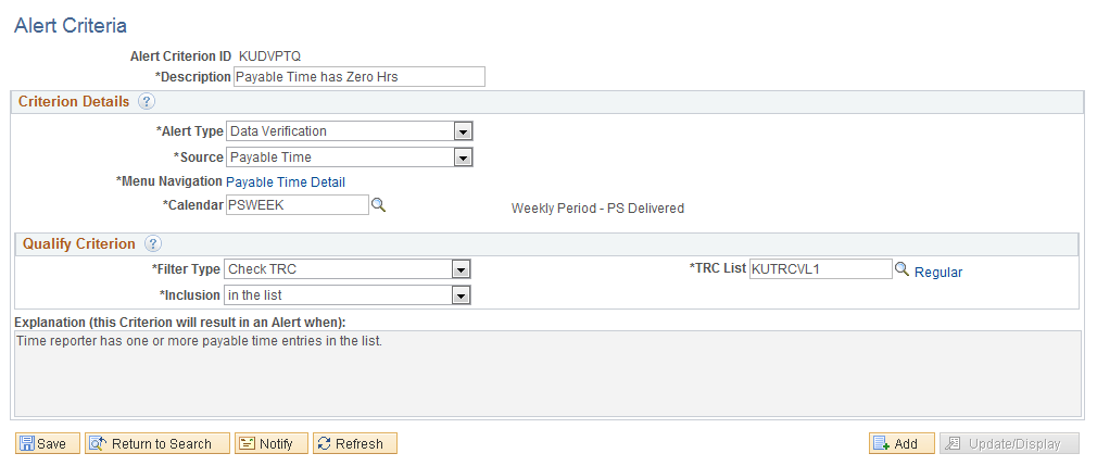

Image: Alert Criteria-Data Verification
This example illustrates fields and controls on the alert criteria for Data Verification.
Alert Criteria - Data Verification
Payable time filter type is only Check TRC. Filter type for reported time is Quantity is not positive, Zero and Check TRC

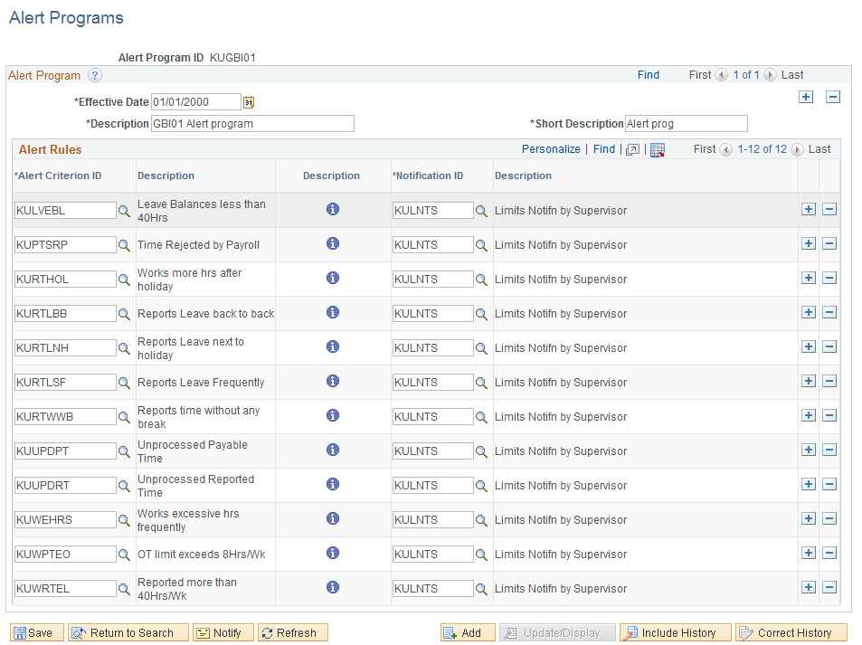

Use Alert Program Page (TL_ALRT_PGM) to define a set of alert rules which decides the set of people to be notified according to the met conditions.
Image: Alert Program
This example illustrates the fields and controls on the Alert Programs page.
Alerts Programs page
Field or Control
Definition
Alert Program
An alert program defines a set of Alert Rules. It provides - at the rule level - the link up to identify the person(s) to alert when the conditions of the rule is met.

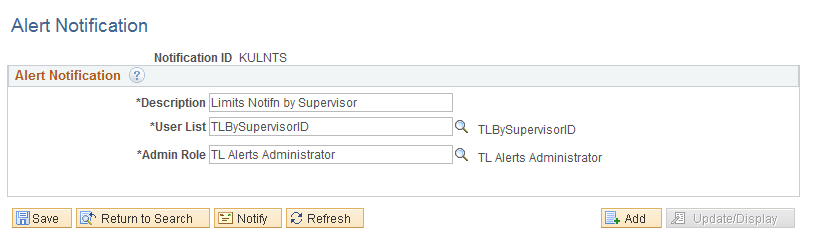

Use Alert Notification Page (TL_ALERT_NOTIFY) to decide whose details to be routed to whom.
Image: Alert Notification page
This example illustrates the fields and controls on the Alert Notification page.
Field or Control
Definition
Alert Notification
Specify a target audience for alerts, and how that audience should be notified. The routings are used when defining an alert program to control the recipients of each alert listed in that program. The Admin Role serves as a back-up assignment for when the selected user list fails to return any reviewer for a given alert.

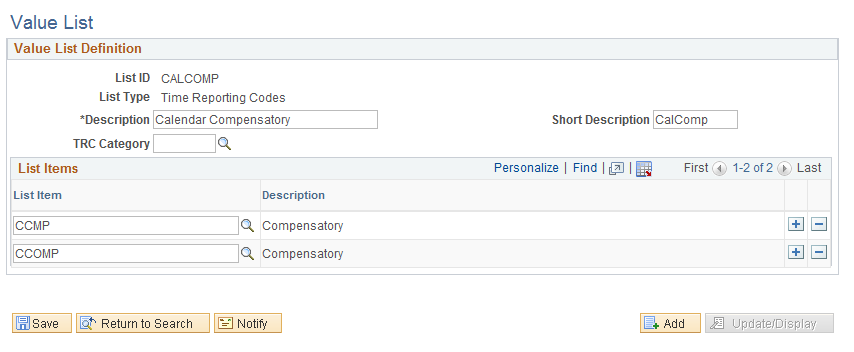

Use Value List Page (TL_VAL_LIST_PNLGRP) to filter or select limited Time Reporting codes for processing alerts or reports.
Image: Value Lists page
This example illustrates the fields and controls on the Value List page.
Value List
Value List is created for the following list type:
Absence Status, Absence Take, Attendance Violations, Benefit Plan, Company, Compensatory Time off Plan, Department, Employee Status, Employee Type, Exception, Grade, Job code, Payable Status, Paygroup, Position Number, Punch Type, Reported status, Severity, Shift, Step, TCD Group, Task Group, Time Reporting Codes, Union Code, Work Group.

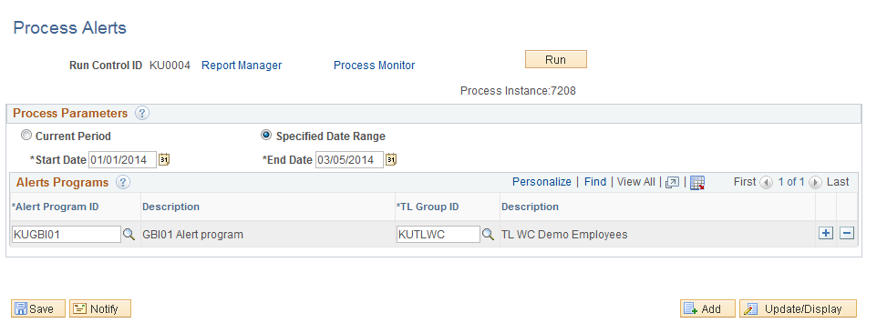

Use Process Alert page (TL_ALERTS_PROCESS) to execute the data checking at a given time and frequency.
Alert processing is done by managers and Time and Labor Administrators.
Image: Process Alert page
This example illustrates the fields and controls on the Process Alert page.
Process Alerts
Field or Control
Definition
Process Parameters
Select the time frame to be covered and the alert programs to be run. The Current Period option will cover the current period (according to each time reporters Workgroup setting). The process will dynamically determine the current period based on the date when the process is run.
Alerts Programs
Grid label on the Process Alerts page.
There are two modes for running a selection of alerts:
  • Run control Current Period option: This covers the current period according to each time reporters’ workgroup setting. The process determines the current period based on the date when the process is run
  • Run Control From and To dates specified
    • In this case ONLY Alert criteria time period will be considered. . The process compares the time and labor calendar in sync with this period specified in the Alert criteria (other than NONE).
    • For NONE- purely from and to dates will be considered.
    • Alert process allows mapping of the same program against more than one group or subject the same group to more than one program.

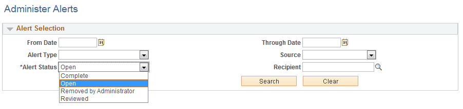

Use Administer Alerts Page (TL_VAL_LIST_PNLGRP) to update the alerts.
Image: Administer Alert
This example illustrates the fields and controls on the Administer Alert page.
Administer Alerts page
The administrator’s involvement is different from that of the manager. It serves two main purposes:
  • Complete; Completed alerts by the admninistrator.
  • Open; All open alerts
  • Removed by Administrator; outdated, created from a poorly defined criterion or any other reason. This is generally about rectifying mistakes and getting rid of outdated entries
  • Reviewed; perhaps specifically those sent to the administrator as a default recipient when the user list failed to identify anyone else. There are no restrictions to which the administrator can re-direct an alert.
