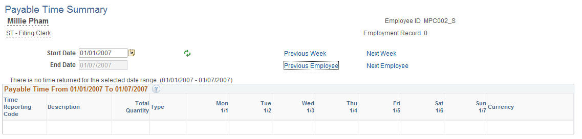

Use the View Payable Time Summary page (TL_TM_MPAY_SUMM) to view the week-by-week summary of payable time by TRC using this display-only page.
Navigation
Image: Payable Time Summary page
This example illustrates the fields and controls on the Payable Time Summary page. You can find definitions for the fields and controls later on this page.
The View Payable Time Summary page displays one week's payable time. The time is allocated by date, by TRC, and then by task. For example, if your task profile specifies that your time should be allocated 50 percent to one task and 50 percent to another, then you would see two rows for the same date and TRC. However, on the Payable Time Details page, you can view the details of how it is allocated.
Field or Control |
Definition |
| Start Date |
Seven days are displayed by default. |
| Pending Exceptions |
This button appears if exceptions were generated. Click to access the Manage Exceptions page. Note: If you have multiple jobs and on a given date there is an exception for EMPL_RCD=0, then Payable Time is not created for any of the multiple jobs in that workgroup for that date. |
| Previous Week and Next Week |
Click to view a different week's summary of payable time. |
| Detail Page |
Click this link to access the Payable Time Details page. |
Note: Time that has generated exceptions with a "High" severity level will not appear on this page because it is not considered payable time. Time that has generated exception with a "Low" or "Medium" severity level will appear on this page and is considered payable time.

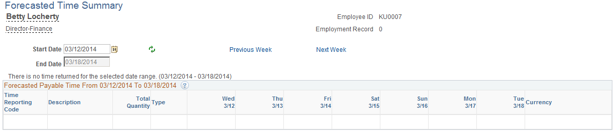

Use the Forecasted Time Summary page (TL_TM_MPAY_SUMM) to view forecasted payable time in summary.
The View Forecasted Payable Time Summary page shows the forecast time by employee and by TRC.
Navigation
For manager access:
For employee access:
Image: Forecasted Time Summary page
This example illustrates the fields and controls on the Forecasted Time Summary page. You can find definitions for the fields and controls later on this page.
The Forecast Payable Time feature enables you to estimate what your payable time is for the current period or for a future time period. It looks at reported time and scheduled time, and calculates what the payable time would be for a specified time period using that information. By using the Forecast Payable Time feature, you can look at how many hours you have reported to date in the period, and what the remaining scheduled hours are. The Forecast Payable page shows you your estimated payable time.
There are four ways to forecast payable time:
Forecast time for a month or for a specific day using the Time and Labor Launch Pad.
Forecast time for the time period associated with the Process Date by clicking the Forecast Payable Time button on the Time Administration Run Control page.
Note: Forecasted Payable Time is not actual Payable Time. To generate Payable Time, you must use the processes for creating Payable Time.
The View Forecasted Payable Time Summary page displays one week of payable time. The system allocates time based on the TRC, and displays the total quantity of hours for each TRC to which time was reported within the specified date range.
Field or Control |
Definition |
| Start Date |
| Detail Page |
Click this button to access the Forecasted Time Details page. |
Note: The Forecasted Time Detail page is similar to the Payable Time Detail page.
