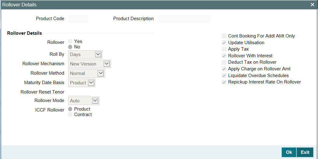

9.2 Features of the Product Roll-over Details Screen
When defining a product, you have to specify whether loans involving the product can be rolled-over. If rollover has been allowed for a product, all the loans involving the product can, by default, be rolled-over.
Note
However, a loan involving such a product is rolled-over only if it is not liquidated, on its Maturity Date. You can choose not to rollover a loan involving a product with the rollover facility. This can be indicated when processing the loan.
Note
If you want contingent entries to be posted, then select 'Cont Booking For Addl Amt Only' check box. This is applicable only if the 'Rollover Mechanism' is 'New Version' and 'Rollo­ver Method' is 'Normal'. If contingent entries are booked for a contract, the system does not allow VAMI, PYMNT, and REVN events.
The rollover details for the product that you are defining can be specified in the Product Roll-over details screen. Click ‘Rollover Details’ button in the Product Preferences screen to invoke this screen.
The following are the features of the product roll-over details screen.
9.2.1 Specifying whether Rollover is Applicable
Select the option ‘Yes’ in the section ‘Rollover’ to indicate contracts booked under this product can be rolled over. Select the option ‘No’ to indicate contracts under this product cannot be rolled over. You can, for a contract, change this preference. This can be done while entering a contract in the OL Contract Online screen.

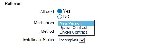

9.2.2 Specifying the Rollover Mechanism
You can indicate whether rolling over a loan contract using the product must create a new version of the original contract, a spawn contract, or a linked contract.
Note

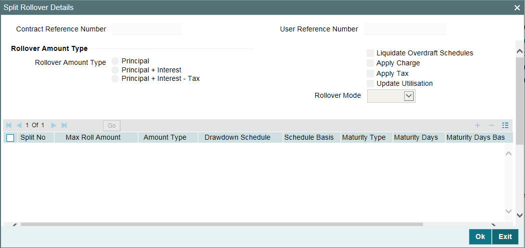

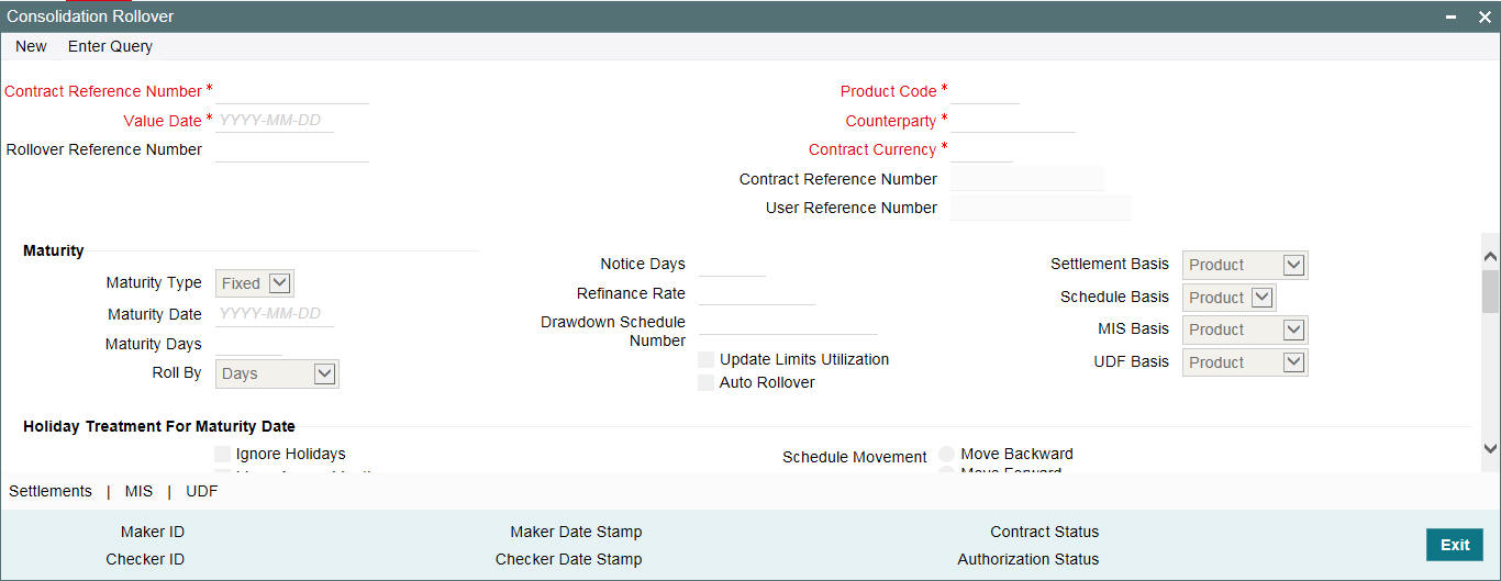

Whether the original contract must be split into multiple contracts, or consolidated with other contracts into a single new contract, when rolled over using the rollover operation. Accordingly, select any of the options, ‘Normal’, ‘Split’, or ‘Consolidated’, in this field, as applicable.
If you indicate the ‘Split’ option, you can specify the preferences for the split, when you enter the borrower draw down contract using the product.
If you indicate the ‘Consolidate’ option, you can specify the other draw down contracts with which the original contract must be consolidated into a single contract, when you enter the borrower draw down using the product.

9.2.5 Roll-over of Interest, Charge and Fee Components
The interest, charge and fee components of the new (rolled-over) loan can be picked up, either from the old loan or from the product involving the old loan. The following example illustrates this point:
Example
When defining a product you specified that all loans involving it have an interest schedules every month and an annual fee.
Assume that you have processed a loan, involving this product, with the following attributes:
When rolling-over this loan, you have two options:
9.2.6 Maturity Date Basis
Select the Maturity Date basis for a rolled over contract. Select the option ‘Product’ if you want the tenor of the rolled over contract to be the default tenor maintained for the product. Select the option ‘Contract’ if you want the tenor of the rolled over contract to be the one currently applicable for the contract.
9.2.7 Updating Credit Limit Utilization
This function indicates whether the credit limit utilization is to be updated, when a loan is rolled-over. That is, the interest that has been accrued on a loan is also considered, as a part of the utilized amount for the purpose of risk tracking.
Note
This option applies only if you want to rollover a loan with interest.
9.2.8 Applying Tax on Roll-Over
For tax to be applicable on a rolled-over loan:
You have to indicate whether tax has to be applied, on the rolled-over loan also.
9.2.8.1 Rolling-over with Interest
You have to specify whether the loan that you are rolling-over, should be rolled-over along with the outstanding interest. If you so specify, the principal of the new loan, is the sum of the outstanding principal and the outstanding interest on the old loan. This applies only to loans with a bearing (add-on) method of interest liquidation.
If all the outstanding interest has been paid, then the loan can be renewed without the interest. If not, it is rolled-over with the interest that is still outstanding on it.
A loan is rolled-over with only the main interest that is outstanding. It is that interest component, which you specify as the main interest in the ICCF Product Details screen (this will be displayed in the Contract Main screen). Other interest components and the penalty interest, if there are any, are not rolled-over.
The following example illustrates how this concept works.
Example
Consider the example of Ms Yvonne Cousteau, who has taken a loan of USD 10,000 under the Short Term Loans for Individuals scheme,
If you roll it over without interest, the new principal is USD 10,000. The accrued interest on this loan is liquidated. The loan is rolled-over, only if the interest can be liquidated. If there are no funds in the repayment account, there can be no rollover.
If you roll the old loan over (renew it), along with the unpaid interest, the principal of this renewed loan is USD 1, 1167 (USD 10,000 + USD 1,167) as of 31 December 1997. The interest on the new loan is applied on a principal of USD 11,167.
9.2.9 Deduct tax on Roll-Over
When a loan is initiated, tax is applied on the principal of the loan. When this loan is rolled-over or renewed, you have two choices (depending on the tax laws of your Country):
This option applies only to tax on principal and not to tax on interest.
This field assumes importance, when:
If this tax is not waived for the old loan, it is applied on the new loan. If it is waived on the old loan it is not applied on the renewed loan.
Choose Deduct Tax on Rollover, if tax on the old loan has to be liquidated before it is rolled-over.
9.2.10 Contingent Entries for Additional Amount
Select the ‘Cont. Booking For Addl Amt Only’ check box to indicate contingent entries for the additional rollover amount must be passed when the child rollover contract is booked, for contracts using the product. If you select this check box, contingent entries for the additional rollover amount are passed. If you do not select this option, contingent entries are passed for the total principal amount of the child rollover contract.
9.2.11 Applying a Charge on the Roll-Over Amount
Select the ‘Apply Charge on Rollover Amt’ check box to indicate a charge is applied on the amount being rolled over.
9.2.12 Liquidating Overdue Schedules
Select the ‘Liquidate Overdue Schedules’ check box to indicate schedules for the original deal that are overdue on the day of rollover should be liquidated before the deal is rolled over. If you have selected this check box but the overdue schedules cannot be automatically liquidated, the deal is not rolled over and it is reported as an exception condition in the Daily Exception Report.
9.2.13 Interest Rate on Rollover
Select the ‘Repickup Interest Rate on Rollover’ check box to indicate the interest for the rolled over contract should be picked up again on rollover of the contract. If you do not select this box, the interest for the rolled over contract is the latest interest applicable for the contract.
9.2.14 Indicating the Values to be Re-keyed during Authorization
You can specify the fields whose values have to be rekeyed at the time of authorizing rollover contracts. The re-key option serves as a means of ensuring the accuracy of inputs. The fields that have to be rekeyed during the authorization of rollover contracts are specified in the Authorize Rekey Fields screen. Click ‘Rekey Fields’ in the ‘Preferences’ screen to invoke this screen.
In this screen, you can specify any or all of the following re-key fields:

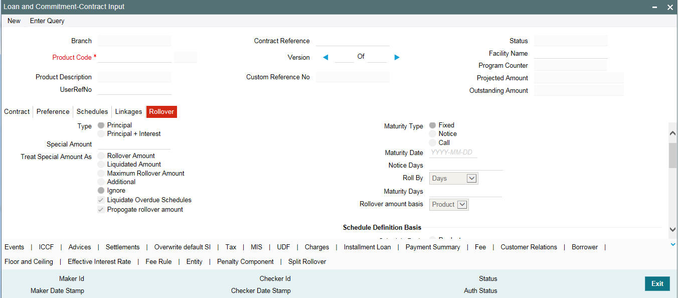

9.3 Specifying Contract Roll-Over Details
Instead of liquidating a loan on maturity date, you can renew it into a new contract. As part of rolling over a contract, the original contract should be liquidated and a new contract should be initiated. In Oracle Lending, these two processes are done in a single step.
9.3.1 Rollover Preferences for a Loan Contract
To recall, when a loan is rolled-over (renewed), it is processed in the following manner, depending upon the rollover mechanism and rollover method specified:
The rollover method indicates:
The rollover method specified for the product used by the contract is defaulted, and you can change it when you enter the contract, if required.
9.4 Specifying Details for Normal Rollover
If you have chosen the rollover method as “Normal”, then you must enter the corresponding details for the rollover, in the Rollover tab in the Loan and Commitment- Contract Input screen.
In the case of normal rollover, the system either creates a new draw down contract with a new contract reference number for the original one being rolled over (if the rollover mechanism specified is ‘New Contract’), or a new version of the original contract, with the same reference number (if the rollover mechanism specified is ‘New Version’).
You can rollover a loan in the ‘Loans and Commitment – Contract Input’ screen. In the ‘Loans and Commitment – Contract Input’ screen, click ‘Rollover’ from menu.
At the time of contract creation, you can maintain/change the rollover instructions. Click ‘Rollover’ tab to rollover a contract maintain/change the rollover instructions. You can specify the rollover instructions for the rolled over contract. After specifying the rollover details, you need to save the contract.
When you rollover the contract, the system completes the rollover process with the specified rollover instructions and a new version is created for the event ROLL.
To authorize the rolled over contract, both the versions created during rollover have to be authorized simultaneously.
By default, a contract is rolledover with all the terms of the original contract. However, you can change certain terms by specifying them in the Rollover Details screen while creating and modifying a contract.
The following are the features of the contract rollover screen:

9.4.3 Specifying the Roll-Over Amount
When you roll-over a loan you can roll-over:
You can indicate for the product that a loan is to be rolled-over with interest. Then at the time of loan processing, you can specify that only the outstanding principal has to be rolled-over.
However, only when all the outstanding interest is paid (liquidated manually or automatically), can the loan be renewed without the interest.
If you have specified for the product that only the outstanding principal should be rolled-over, and you find that the outstanding interest has not been liquidated on this particular loan under process. Then you can specify through this screen that the rollover be made along with the outstanding interest.
The special amount is:
Ms Yvonne Cousteau has taken a loan of USD 10,000 under the Short Term Loans for Individuals scheme:
Since Ms Cousteau is unable to repay the loan you decide to renew the loan (roll it over).
You have two options:
If you roll it over without interest, the principal of the new loan will be USD 10,000. The accrued interest on this loan is liquidated. If you roll the old loan over (renew it), along with the unpaid interest, the principal of this renewed loan is USD 1, 1167 (USD 10,000 + USD 1,167) as of 31 December 1997.
Ms Cousteau decides to pay back USD 1,000 on 31 December 1997, the Maturity Date of the old loan. A part of the interest is thus, be liquidated. The new outstanding interest (USD 167), will be rolled-over with the outstanding principal USD 10,000 and the principal of the rolled-over loan is USD 10,167. This is what is termed a Special amount. Interest is calculated on this principal for the renewed loan.
Note
If the rollover amount that you enter, is lesser than or greater than the outstanding princi­pal amount of the contract being rolled over, the system displays a configurable override.

9.4.4 Specifying the Manner in which the Special Amount should be Treated
If you specified that the principal of the new loan is meant to be a special amount you also have to indicate the manner in which the special amount is to be treated. You can choose any one of the following options:
The amount that is rolled-over depends on the treatment that you specify. You can choose not to treat the special amount in a specific manner by choosing to ignore this option.
Rollover Amount
If the outstanding amount is 20,000 and the special amount is given as 25,000 the additional 5000 gets added to the loan.
If the outstanding amount is 30,000 and the special amount is given as 25,000 the additional 5000 gets liquidated.
Note
The Outstanding Amount is the sum of all the components put together.
Liquidation Amount
If the outstanding amount is 20,000 and the special amount is given as 25,000 you are not allowed to rollover.
If the outstanding amount is 30,000 and the special amount is given as 5,000 the additional 5000 gets liquidated and only 25,000 is rolled over
Additional Principal Amount
Additional Principal Amount option can be selected only if the rollover is by special amount.
Note
Individual components are liquidated in the liquidation order.
Maximum Rollover Amount
If the outstanding amount is 20,000 and the special amount is given as 25,000 you can rollover the entire outstanding amount.
If the outstanding amount is 30,000 and the special amount is given, as 25,000 only 25,000 will be rollover and the remaining 5000 is liquidated.

9.5 Specifying Details for Rollover Split
If you have chosen the rollover method as “Split”, then you must enter the corresponding details for the split, in the Split Rollover Details screen. Click ‘Spilt Rollover’ in the Contract Online screen to invoke this screen.
You can only split loan contracts:
You can specify the following general rollover details for rollover splits, just as you would for a normal loan contract (as explained in previous sections):
9.5.1 Specifying Details for Rolled Over Contracts
When you indicate the rollover method as “Split”, the system creates multiple draw down contracts out of the original draw down contract. For each rolled over contract, the system generates a split number.
You must indicate preferences for these rolled over contracts in the Split Rollover Details screen.
You must indicate the following details:
Each of the split contracts inherits the interest components defined for the original contract. All the rate details defined for these interest components, in the original contract, such as the rate type, rate code (for floating rate components) interest basis, margin and spread, are inherited by the split contract.
9.6 Specifying Details for Rollover Consolidation
If you have chosen the rollover method as “Consolidation”, then you must enter the corresponding details for the consolidation, in the Consolidation Rollover screen.
You can invoke ‘Consolidation Rollover’ screen by typing ‘OLDCOROL’ in the field at the top right corner of the Application tool bar and clicking on the adjoining arrow button.
In this screen, you must specify the reference number of the loan contract (commitment) which you want to consolidate with other loan contracts, as part of the rollover operation.
You can only consolidate loan contracts:
When you select the loan reference number, the product code for the loan is displayed. You can select the other loan contracts to be consolidated.
You must specify the following details for the consolidated rolled-over contract:
Maturity Details
You can indicate whether the consolidated contract has a fixed maturity date, or matures at call or notice. For contracts maturing at notice, you can indicate the applicable notice days.
For fixed maturity type contracts, you can specify the maturity date.
For fixed maturity type contracts, you can specify the number of days to be added to the value date to arrive at the maturity date.
Schedule Basis
You can indicate whether the repayment schedules for the consolidated contract must be defaulted from the loan product or from the driver contract.
The Mode of Rollover
You can indicate whether the rollover consolidation must be initiated automatically for the selected contracts. The mode of rollover also depends on whether the mode of liquidation of the loan is automatic or manual. This preference can be set just as you would do for a normal rollover, as explained in previous sections.
You can indicate whether the credit limit utilization is to be updated, when the consolidation operation is performed. That is, the interest that has been accrued on a loan is also considered, as a part of the utilized amount for the purpose of risk tracking.
Note
Settlement Basis
You can indicate whether settlement details for the consolidated contract must be defaulted from the loan product, or the driver contract
MIS Basis
You can indicate whether MIS details for the consolidated contract must be defaulted from the loan product, or the driver contract,
UDF Basis
You can indicate whether user-defined fields for the consolidated contract must be defaulted from the loan product, or the driver contract.
Refinance Rate
You must indicate the refinance rate for the consolidated contract.
Holiday Treatment
You can indicate whether the system must check for maturity dates of the consolidated contract falling on holidays.
If the holiday check is indicated, you can also specify whether maturity dates falling on holidays must be moved forward to the next working day, or backward to the previous working day. You can also indicate whether the moved maturity date is allowed to cross over months.
Interest Components for the Consolidated Contract
You can define the interest components to be applicable for the consolidated contract.
The interest rate can be defaulted from either the loan product, or the driver contract, or a special rate can be entered. If a special rate is to be entered, you can specify the required rate in the Rate field.
Consolidation Preferences for Driver Contracts
As part of the preferences for the consolidation contract, you can identify contracts from which information such as settlement details, schedules, MIS details and so on, can be defaulted. These contracts are called driver contracts. You can select the contracts to be used as driver contracts, in the Participant Ref No field.
You must specify the following details for the driver contracts:
