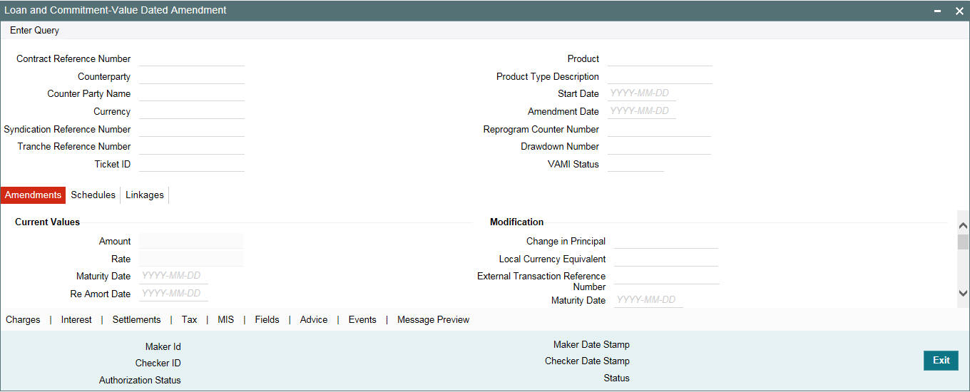

You can invoke the ‘Loan and Commitment - Value Dated Amendment’ screen by typing ‘OLDVAMND’ in the field at the top right corner of the Application tool bar and clicking the adjoining arrow button.
Enter the reference number of the loan to which you want to make amendments. The main details of the loan is displayed in the screen.

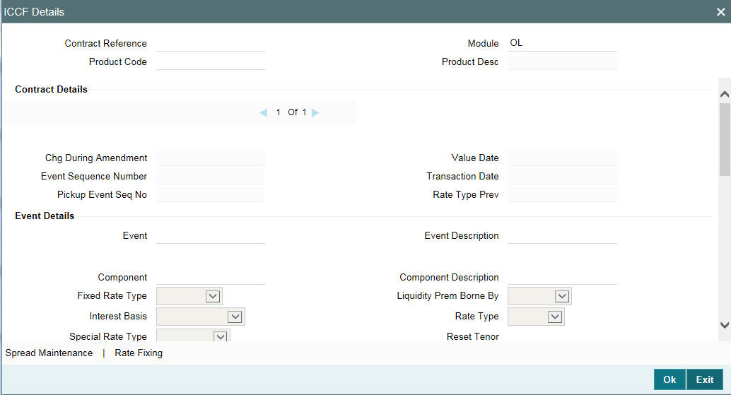

However, if you want to change the interest rate, the rate code, the
spread or the interest amount, you have to invoke the Contract ‘ICCF
Details ‘screen of the ICCF module through the ‘Loan and
Commitment Value Dated Amendments’ screen. Click the’Interest’ to invoke this screen.
You can make Value Dated Amendments only to the following components in the Contract ICCF screen.

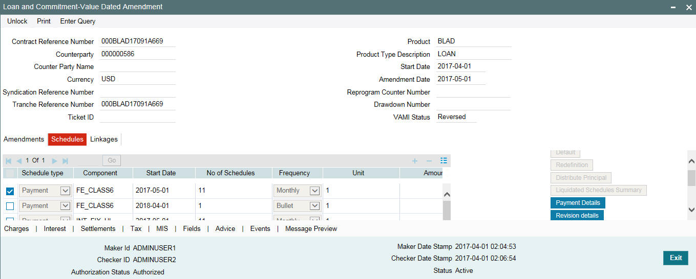

If there is any principal amount increase or maturity date change in the contract, you can distribute the amount equally among all the schedules and redefine the schedules from the amendment date till maturity date. You can do this using 'Distribute Principal' and 'Redefinition' button in 'Schedules' tab of 'Loan and Commitment Value Dated' screen.
In addition, you can use 'Default' button to default back to the original schedules as in contract and 'Liquidate Summary Schedule' button to view the overdue or liquidated schedules.
Note
Schedule amendments are not allowed for non-bearing, commitment, call, notice maturity type contracts. They are applicable only for loans.
If there is any principal increase or maturity date change, then the system performs the following:
Note
In case of reversal of VAMI, the system brings the original amount due before VAMI.

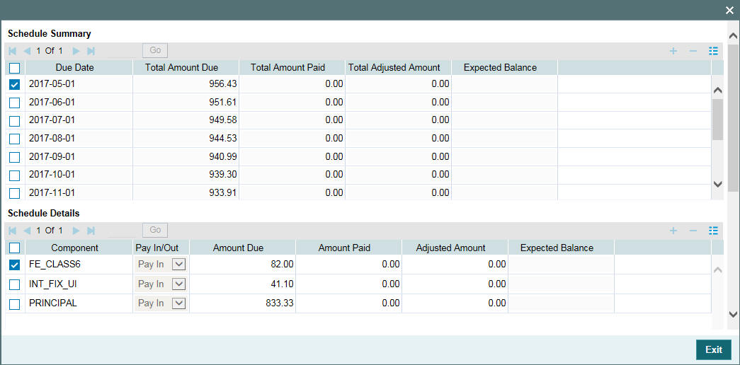

When you click ‘Payment Details’ button in this screen, you can see the ‘Payment Schedule Details screen’ similar to ’Loan and Commitment - Contract Input’ screen. Here you can view the details of the schedules for a particular contract. For more information, refer to ‘Revision and Repayment Schedules’ sub-section in Processing Repayments section.
When you click ‘Revision Details’, the changes made in the ’Loan and Commitment - Contract Input’ screen are displayed. For more information, refer to ‘Revision and Repayment Schedules’ sub-section in Processing Repayments section.

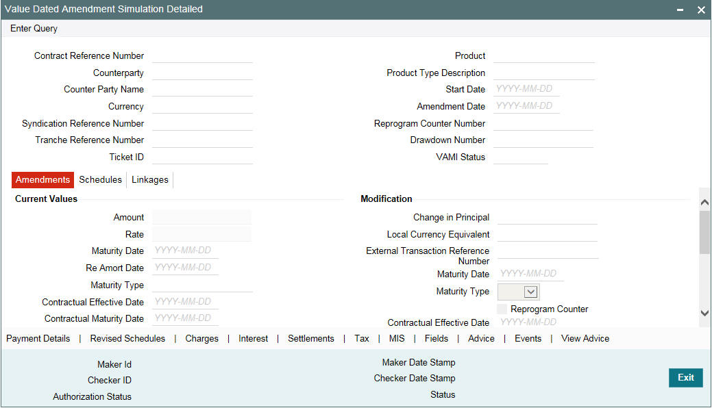

The value dated amendment simulation screen is similar to ‘Loan and Commitment - Value Dated Amendment’ screen. Once the VAMI is saved in this screen, you can view the revised schedules and view the advice.
Value Dated Amendment simulation is used to view the impact on repayment schedules, tenor and maturity date after the VAMI.
You can invoke the ‘Value Dated Amendment Simulation Detailed’ screen by typing ‘OLDVAMSI’ in the field at the top right corner of the Application tool bar and clicking the adjoining arrow button.

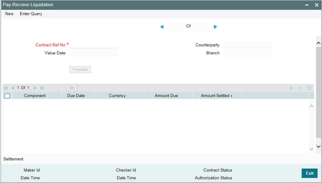

You can track and liquidate the differences in the settled amount using ‘Pay – Receive Liquidation’ screen.
You can invoke the ‘Pay - Receive Liquidation’ screen by typing ‘OLDPRLIQ’ in the field at the top right corner of the Application tool bar and clicking the adjoining arrow button.

Contract Reference Number
Specify the contract reference number whose list of components you want to display in this screen.
The following fields are displayed
Value Date
Specify the value date of the payment for the selected component. The value date of the payment can be either backdated or current dated.
Amount Settled
Specify the amount to be liquidated for the selected component.
