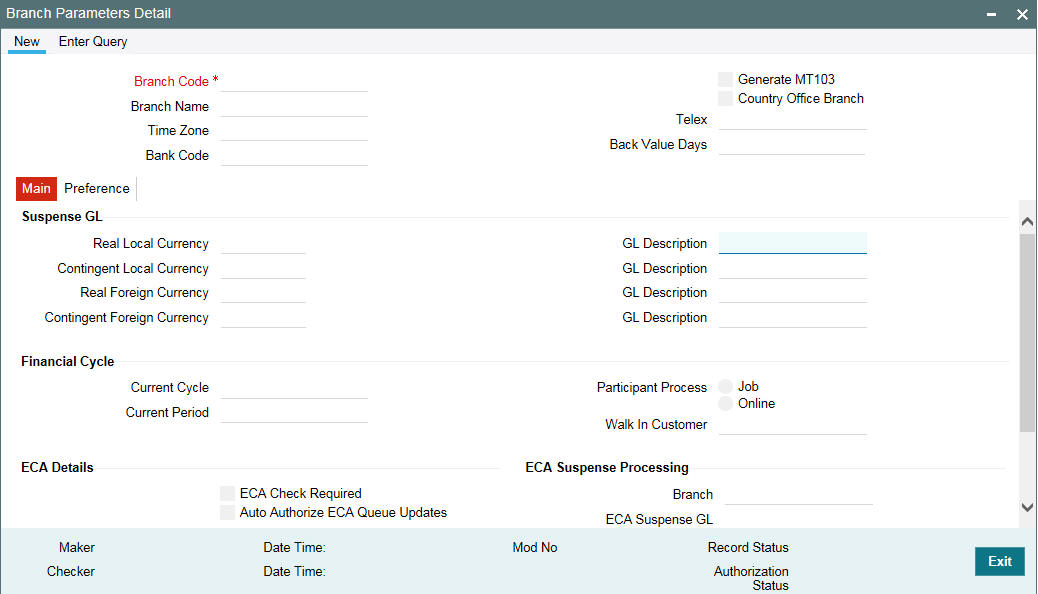

A set of rules that govern the loans that you disburse in a particular branch (of your branch) are defined through the Branch Parameters screen.
You can invoke the ‘Branch Parameters Detail’ screen by typing ‘OLDBRMNT’ in the field at the top right corner of the Application tool bar and clicking the adjoining arrow button.
