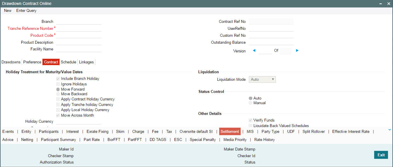

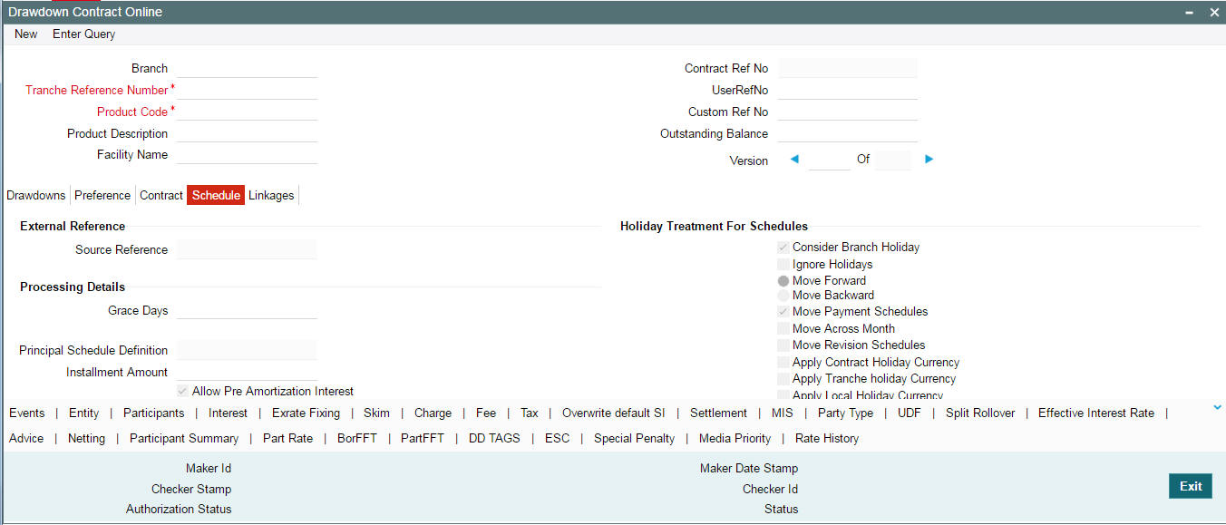

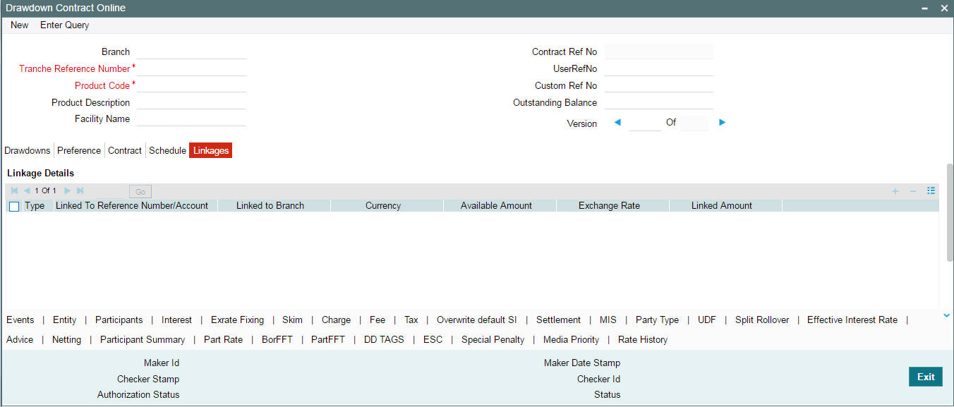

You can process a drawdown contract in the ‘Drawdown Contract Online’ screen. You can invoke the ‘DrawDown Online’ screen by typing ‘LBDDDONL’ in the field at the top right corner of the Application tool bar and clicking the adjoining arrow button.
The screen is displayed with details of an existing drawdown contract, as shown below.
When you are capturing a new drawdown, Oracle FLEXCUBE validates the following:
You can capture a drawdown contract either by:
For more details, refer the heading ‘Entering the facility details’ in this chapter.
You can capture the following in for a drawdown:
You capture information pertaining to the drawdown in the following tabs of the screen:
In addition, a vertical toolbar provided in the screen, may be used to invoke other sub-systems meant to capture important information for the drawdown.
These buttons are same as the ones available for the ‘LB Tranche Contract Online’ screen, except for the following:

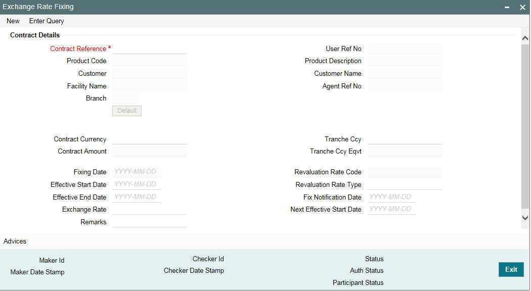

‘Exrate Fixing |
Click this tab to fix the exchange rate for a cross currency drawdown |

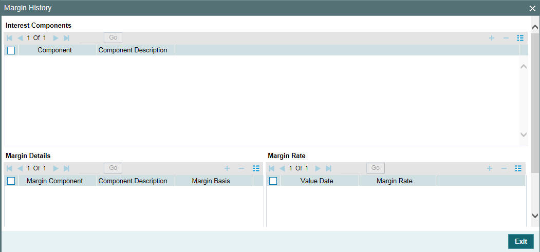

‘Interest’ |
Click this tab to view the interest and margin components |

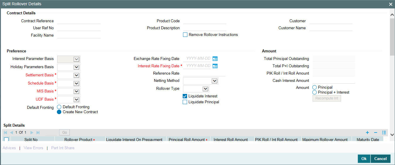

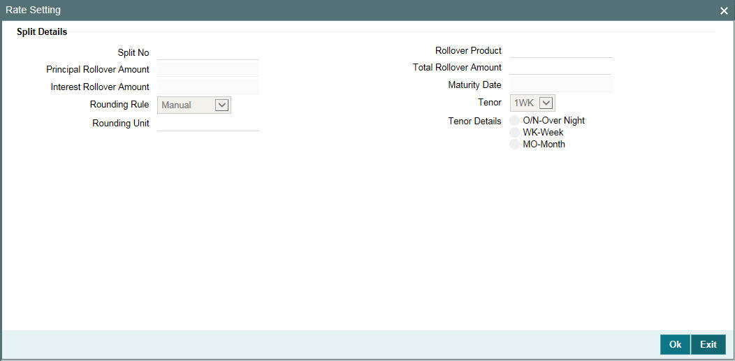

Split Rollover |
Click this tab to specify the spilt rollover details if applicable for the drawdown |

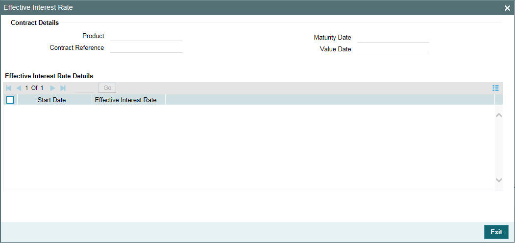

‘Effective Interest Rate’ |
Click this tab to view the Effective Interest (EI) rates for the drawdown |

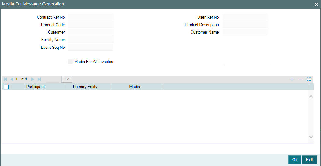

‘Media Priority’ |
Click this tab to specify the media for message generation |
To capture a new drawdown, click New from the menu.
The ‘Drawdown Type’ is displayed as ‘New’. The contract inherits the details of the template. Alternatively, you can also select the following details to capture a new drawdown:
Branch
Branch for which the drawdown is processed. You can process inter-branch contracts too.
Tranche Ref No
You have to select the reference number of the tranche under which you want to book a drawdown. The option list displays all active and authorized Tranche contracts. When you select the tranche, the system also displays the Tranche User Reference Number and the tranche borrower. In addition, the reference number of the borrower facility contract is also displayed.

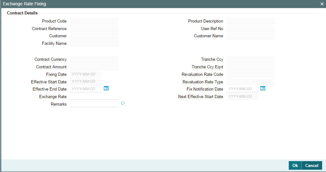

Exchange Rate needs to be fixed!
The ‘Exchange Rate Fixing Date’ displays the current system date (booking date of the drawdown).
Note
If the drawdown currency is different from the tranche currency and the ‘Exchange Rate Code’ that defaults from the product is not maintained for the currency pair (tranche and drawdown currencies), the system displays an error message.
For more details on exchange rate fixing, refer the heading ‘Fixing exchange rate for the DD currency’ in this chapter.

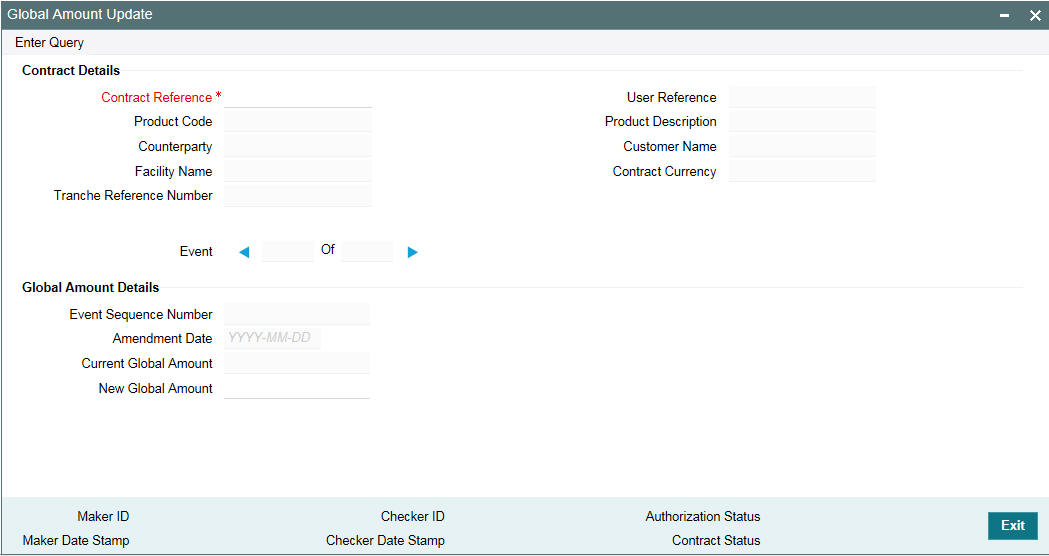

Global DD Amount
The Global Drawdown amount is computed and populated during new drawdown booking based on the Tranche, Global Tranche, and Drawdown amounts. The Global Drawdown Amount is computed as follows:
Global Drawdown Amount = (Global Tranche Amount / Tranche Amount) * Drawdown Amount.
You can amend this amount only for non-lead drawdowns and only if the corresponding Tranche has ‘Cascade Participation’ set to ‘No’. You cannot amend this amount if the underlying Tranche has ‘Cascade Participation’ set to ‘Yes’. The latest Global Amount as on the date of handoff is used for handoff of the Commitment Reduction to the Loans QT system.
However, only those Drawdown Global Amounts, with cascade participation set to N, can be amended using the new screen Global Amount Update/Amendment screen.
Note
The Global Drawdown amount cannot be updated during drawdown amendments.

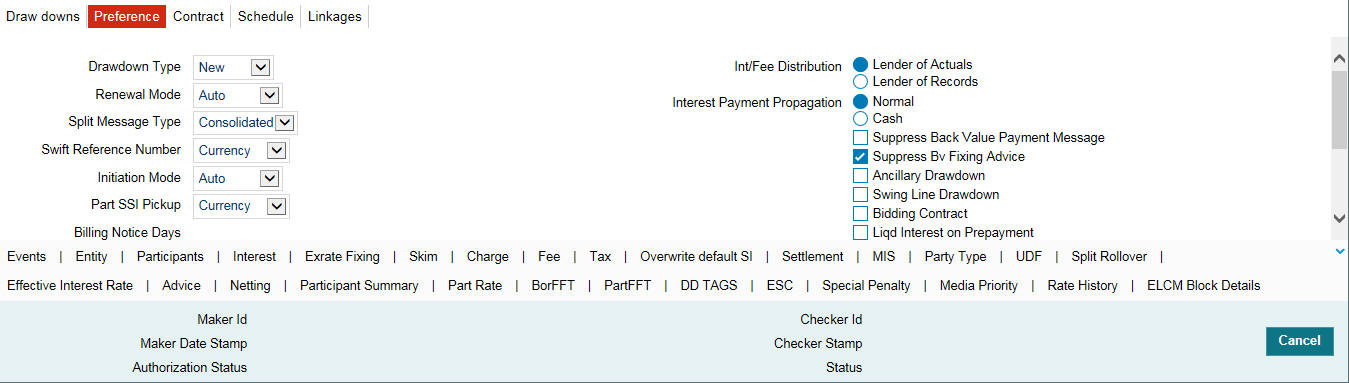

Drawdown Type
This indicates whether you are defining a new drawdown or renewing an existing drawdown. For a new drawdown, ‘New’ is displayed and you cannot change it.
Renewal Type
The ‘Rollover Method’ you specify for the drawdown product will default here. You can change it at the drawdown level. Specify the manner in which the drawdown should be renewed/rolled over. The options available are:
Note
Irrespective of the type of renewal you select here, the system allows you to capture instructions for any one of the renewal types mentioned above. Depending on the type of instructions you capture, the system automatically updates the ‘Renewal Type’ with the latest value when you save the instructions.
Split Message Type
You can select this message type only if the ‘Renewal Type’ is specified as ‘Split’. The message types available are:
INIT Mode
This specification defaults from the tranche. You can change it for the drawdown, if required. This will indicate the mode of initiating the drawdown in the system. The following options are available:

Suppress B.V Fixing Advice
You can check this option to stop the generation of payment messages when back valued schedules for a back-dated drawdown (with initiation date before today’s date) is liquidated.
Ancillary Drawdown
Oracle FLEXCUBE allows you to process Ancillary drawdowns under a tranche. Check this option to indicate that you want to process an Ancillary Drawdown.
This check box is enabled under the following conditions:
A pro-rata tranche is converted to a ‘Non-Cascade’ type once you save the drawdown and it remains as Non-Cascade even on repayment of the drawdown. You can send out participant FFT messages to all the lenders in the syndicate in case of ancillary drawdowns and amendments of the same. You need to maintain a separate advice template for this which you can choose in the FFT screen.
Note
Swing Line Drawdown
You can check this option while booking the new drawdown to identify a swing line drawdown. You cannot make any changes to this during the amendments of the drawdown at the contract level.

Interest Payment Propagation
Select the interest payment for the drawdown from the below two options:
Cash payment can be processed as part of manual payment, split rollover and consolidated rollover processing. The field value for the child contract gets defaulted from parent contract during split rollover processing. During consol rollover processing, the value gets defaulted to child contract from the driver contract.
You cannot book drawdown booking with ‘Interest Payment Propagation’ as ‘Cash’ if below mentioned existing flags are checked for drawdown contract
You cannot book drawdown under lead tranche with ‘Interest Payment Propagation’ as ‘Cash’.
After the drawdown is authorized, amendment of interest payment propagation is allowed under the below validations:
For the drawdowns under lead tranches, the value is ‘Normal’ always. All the existing lead and non lead tranches, the ‘Interest Payment Propagation’ gets updated as ‘Normal’.

You can capture the other contract details in the ‘Contract’ tab of the screen.
The following contract details applicable for drawdowns are explained below:
Mode of liquidation of interest and fee components associated with the drawdown defaults from the drawdown product.
At the drawdown level, you can change the mode to any one of the following methods:
For more details on ‘Contract Payment’ screen, refer the heading ‘Processing Repayments Manually’ in the ‘Processing Repayments’ chapter of this User Manual.
For more details on ‘Fee Liquidation’ screen, refer the heading ‘Liquidating Fee Components’ in the ‘Processing Charges and Fees’ chapter of this User Manual.
For more details on this screen, refer the heading ‘Forward processing of events’ in this chapter.
The statuses - for example, Active, Past Due Obligation, Non-Accrual Basis, and Write-Off , and so on. defined for the product in the ‘Status Maintenance’ screen is applicable for the drawdown. You have to indicate the mode of status change for a drawdown.
The options are:
For details on the ‘Status Maintenance’ screen, refer the heading titled ‘Maintaining status rules for a syndication product’ in the ‘Reference Information for Loan Syndication’ chapter of this User Manual.

You can capture the details pertaining to the drawdown schedule in the ‘SCEHDULE’ tab.
The information available in this screen is discussed below:
The holiday treatment you specified for the DD product defaults to the drawdown. However, you can change the details, if required.
Note
The system redefines the future schedule dates for Principal, Fees, and Interest components based on the changes made.
For details on the available options, refer the heading ‘Specifying Additional Preferences for Loan Syndication’ in the ‘Defining Products for Loan Syndication’ chapter of this User Manual.
Grace Days
For drawdown contract, system defaults the value maintained for ‘Grace Days’ at the borrower drawdown product level. However, you can edit the default value of grace days during contract input or contract amendment. During contract amendment, the amended value is applicable only to future calculations of late payment charges. While saving the drawdown, system displays the following override message:
‘Grace Days for drawdown is defaulted from the tranche contract, do you wish to continue?’
You can accept the override message by clicking the ‘Ok’ button to continue with the save process. In this case, system defaults the value for grace days from linked borrower tranche contract. If you reject the override, then system defaults the value of ‘Grace Days’ from the drawdown product.
The repayment schedule definition for the drawdown is based on the repayment processing rule specified at the tranche level. The available rules are:
For more information on the above rules, refer the heading ‘Specifying processing rules for the tranche’ in this chapter.
Further, it also depends on the ‘Auto Repay Schedule’ option defined for the tranche (in the ‘Schedule’ tab of the ‘LB Tranche Contract Online’ screen).
Note
The drawdown repayment schedules are determined by the reduction schedules only for drawdowns with the following attributes which are defined as part of drawdown product preferences.
The repayment schedule details include the following:

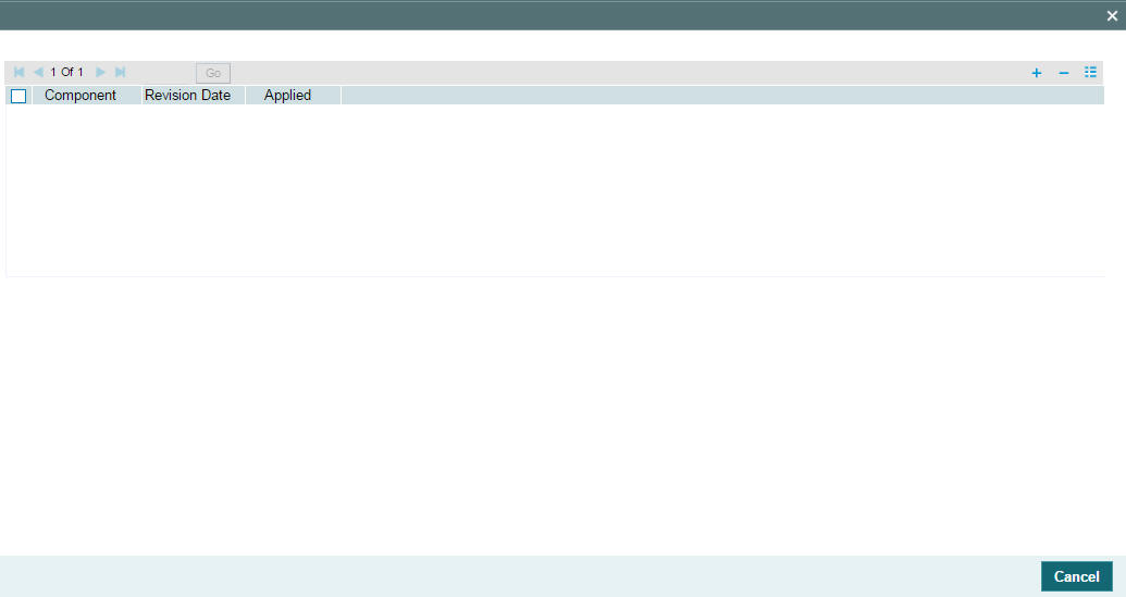

To view the rate revision schedules, click the ‘Revision Schedule’ button. The ‘Revision Schedule Details’ screen appears.
The following details are displayed in this screen:
In the Instance of Rate change, differential amount will be adjusted against the Bullet schedule without modifying the existing Installment constant amount. On ‘REVN’ or ‘VAMI’ either increase or decrease in the rate increases or decreases the bullet schedule amount without affecting EMI or Tenor. As a result, the EMI of the bullet schedule can be less or more than the other schedules.
The main interest component amount of each installment is re-computed in usual way based on the principal balance and the new rate. The prevailing EMI (EMI present in the current schedule of the transaction – System does not consider EMIs of previous schedules) will be kept constant.
The iteration of reducing Principal balance with above Principal component of EMI continues until the bullet schedule is reached. The last EMI have the remaining Principal amount and the interest as the EMI.

In the ‘Linkage Details’ section of the screen, you can view the details of the tranche under which the drawdown is processed. The following details are displayed here:

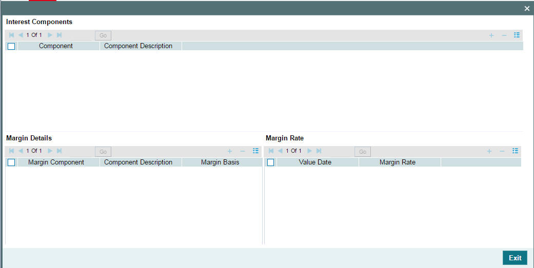

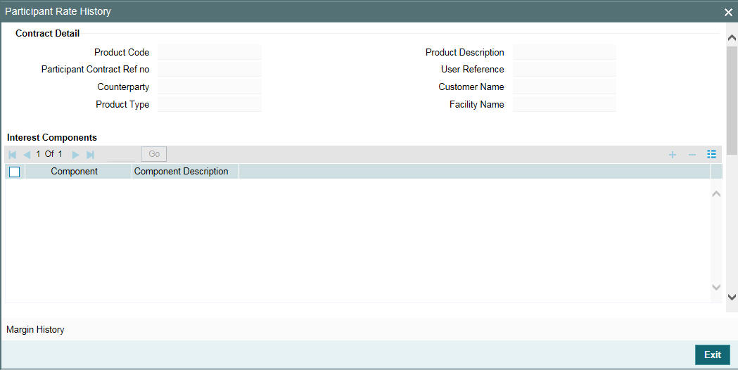

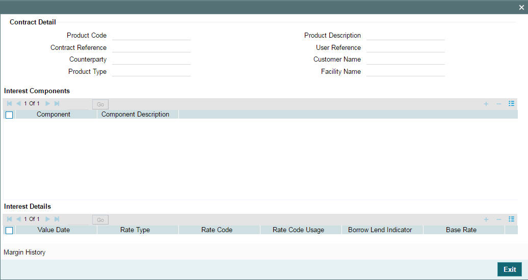

You can view the Interest rate and margin rate history for each drawdown in the ‘Rates History’ screen. This screen holds the history of interest rate and margin changes that have happened for the drawdown. Click ‘Rate History’ tab to invoke this screen.
In this screen,
you have to select the interest component to view the corresponding interest
and margin details. To view the margin rates for the components, click
the ‘Margin History.

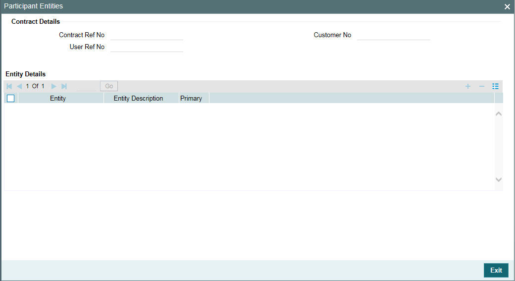

You can view the borrower entity details in the ‘Borrower Entities’ screen. These details default from the tranche associated with the drawdown. Click the ‘Entity’ tab to invoke this screen.
You can modify only the following parameters:
SSI Counterparty
By default, the drawdown borrower is displayed here. You can change the counterparty if the borrower requests to process the settlements through another account. The option list displays the names of all the customers maintained in Oracle FLEXCUBE.
SSI Mnemonic
SSI Mnemonics are maintained in the ‘Settlement Instructions’ screen for a Counterparty, Module, Currency, Product and Branch combination. The same is available for the counterparty/borrower of the drawdown. The Mnemonic selected here obtains the settlement details for the borrower of the contract and the same defaults to the ‘Settlement Message Details’ screen.
If you do not select the SSI Mnemonic, system defaults the SSI Mnemonic for the counterparty and contract currency when you exit the screen.
Note
Note the following:
Select the appropriate ssi mnemonic applicable for the selected currency

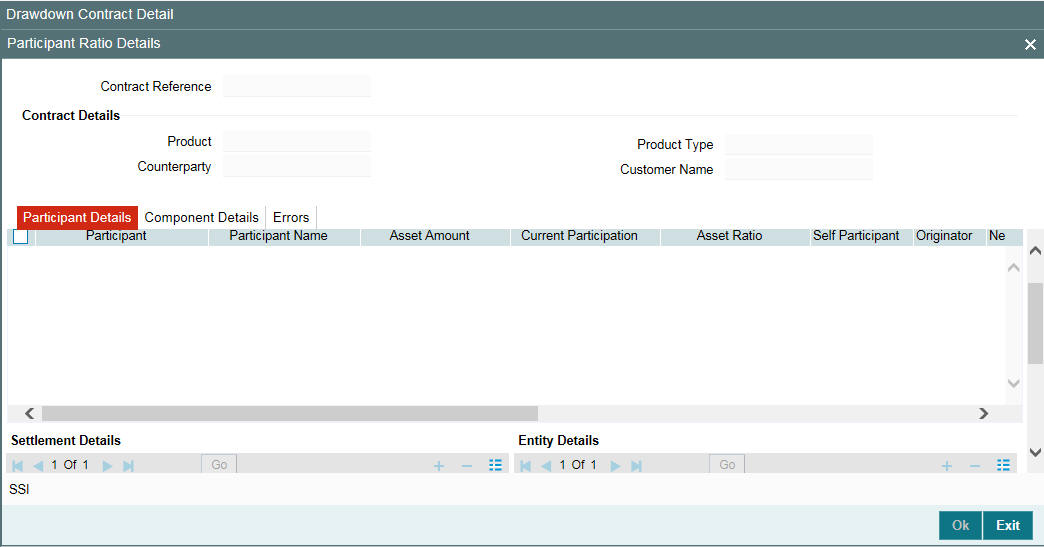

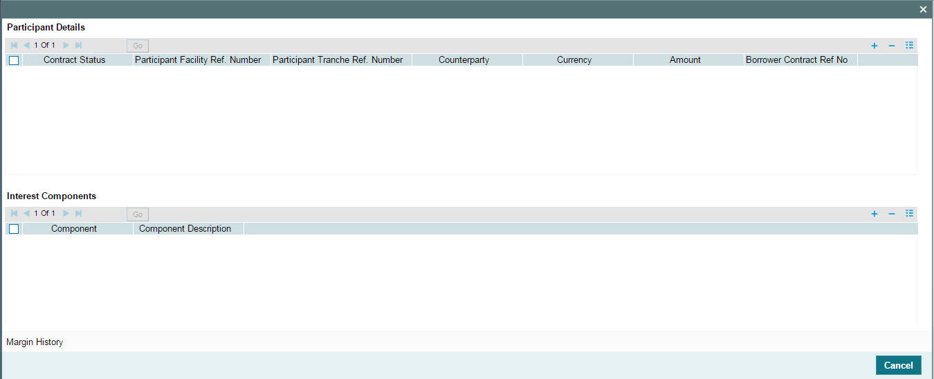

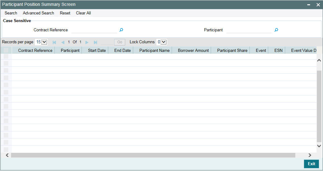

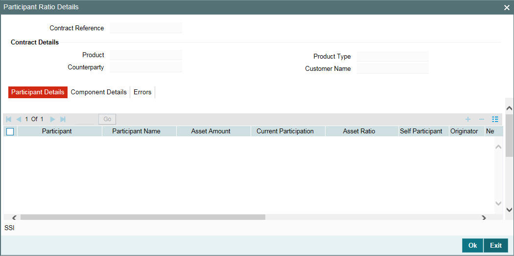

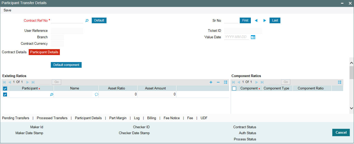

You must also identify the participants who contribute to the amount being disbursed under the drawdown. A borrower drawdown contract inherits the participant details defined for the borrower tranche under which it is entered. You can make changes to the defaulted participant details when you enter a borrower drawdown. To view the details in the ‘Participant Ratio Details’ screen, you have to click the ‘Participants’ tab.
Based on the drawdown amount, the system computes the contribution of each participant towards the drawdown as per the ‘Asset Ratio’ maintained for the tranche.
You can change the default participant details in this screen. Upon change of participants, the system automatically convert a ‘Cascade Participation’ type of tranche to a ‘Non Cascade Participation’ type. The ‘CASC’ event is triggered to indicate the change in the attribute and the ‘Cascade Participation’ option for the underlying tranche (in the ‘CONTRACT’ tab of the ‘LS Tranche Contract Online’ screen) is deselected. If changing the participant details is possible, you can specify the following details for each participant, for the drawdown schedule:

You can change the asset sharing ratio for participants on a non proportionate basis using the ‘Contract Payment’ screen.
For more information on this, refer the section ‘Processing Repayments Manually’ in the ‘Processing Repayments’ chapter of this User Manual.
For details on fields available in this screen, refer the heading ‘Maintaining participant details for the tranche’ in this chapter.

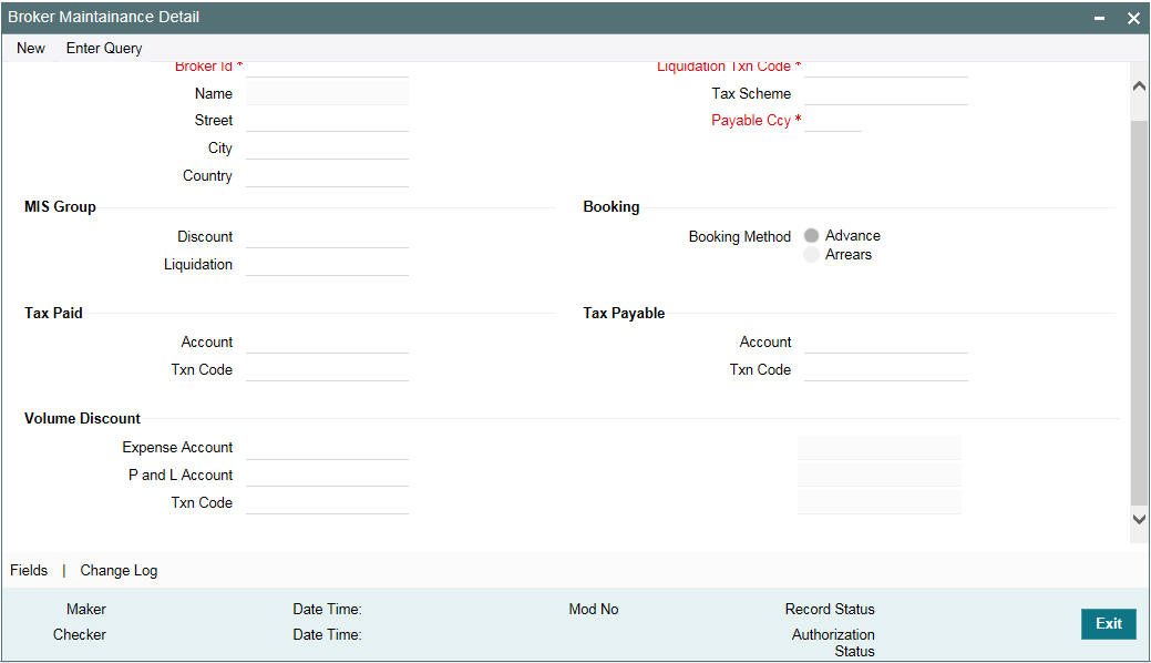

Broker BA Product
You can select BA broker product from the list of values. These values are maintained the ‘Static Maintenance’ screen.

You can view margin details maintained for participants of the drawdown contract, using the ‘Participant Rate Summary’ screen. To view this screen, you have to click the ‘Part Rate’ tab.
Here you can view the following details.
The system displays the following participant details:
The system displays the following component details.
The system displays the following interest details.
The system displays the following margin details.
You can view margin details of all participants including the margin history by clicking the ‘Margin History’ button on the ‘Participant Rate Summary’ screen.
The system displays the following details.
The system displays the following margin rate details.
The margin rate maintained for the individual participant is considered while calculating the interest due on the participant side, during contract booking. This is applicable for current dated/back dated/forward dated drawdown bookings.
You will need to fix the exchange rate for drawdowns only if the drawdown currency is different from the tranche currency. The exchange rate fixing days refers to the number of business days before the value date of the drawdown or the new rate fix period. Exchange rate fixing for the new drawdown or the new rate fix period is done on this day.
To fix the exchange rate for the drawdown currency, click ‘Exrrate Fixing’ tab. The ‘Exchange Rate Fixing’ screen is displayed, as shown below:
The system arrives at the exchange rate fixing date for the drawdown currency based on the exchange rate fixing days maintained at the tranche level and the holiday validation currencies specified for the drawdown currency.
For more details, refer the heading ‘Specifying currency details for the tranche’ in this chapter.
You can specify the following details in this screen:
Effective End Date
You have to specify an end date for the new rate to be effective in the system. The start date will be equal to the drawdown date. You have to capture the date in ‘DD-MMM-YYYY’ format.
Exchange Rate
The default exchange rate is displayed here. The system picks up this rate from the ‘Currency Rates Maintenance’ screen. You can change the rate, if required. You can enter upto 15 decimal points.
Remarks
You can also capture additional information, if required. This is used only for information purposes.
Note
It is not mandatory for you to fix the exchange rate before you fix the interest rate.
Click ‘Ok’ button to save and exit the screen. When you save the drawdown, the system triggers the ‘EXFX’ event with the exchange rate fixing notice. For future dated drawdowns, you need to fix the exchange rate before the value date of the drawdown.
Subsequently, you have to manually fix the exchange rate for the drawdowns. You have to fix the rate for the next period before the end of the current period. However, if you do not do the rate fixing for the subsequent periods, Oracle FLEXCUBE applies the latest fixing rate for the rest of the period.
Note
For more information, refer the heading ‘Fixing Exchange Rate after drawdown booking’ in this chapter.

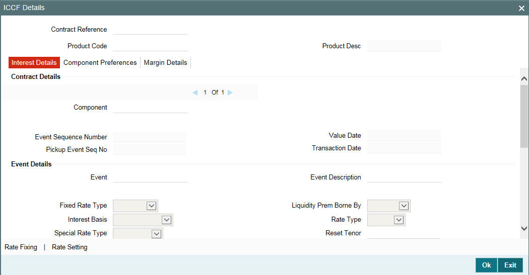

You can view the interest and margin components, if applicable to the drawdown, in the ‘ICCF Details’ screen. These details default from the tranche under which the drawdown is being processed. Click ‘Interest’ tab to invoke this screen.
The interest basis defaults from the product level. However, you can change the default value anytime during the lifecycle of the contract except for contracts with interest capitalization type of renewal instructions. When you change the day basis, the system re-computes the schedule interest amount from the start date of the component. The amendment becomes applicable from the value date of the contract. Note that the system considers the margin rates maintained for each participant while re-computing the interest.
The interest for each currency is calculated using the interest basis, which you select:
Note the following:
You can use the navigation buttons -
to view the interest components associated with the drawdown.
Amortization Constant Component
The default value from the product gets defaulted here. The check box is selected if this is an amortization constant component. You cannot change it in the contract level.
Compensatory Component
The corresponding compensatory component is displayed from the product for the main interest component.
Note
The billing preferences maintained at the product level defaults to the contracts. You can amend these preferences at the contract level only if you have specified the same at the product level.
Billing Notice Required
Select this check box to indicate that you would like to send a billing notice for the interest component.
No of Days
Specify the number of days prior to the billing date that the billing notice needs to be sent.
Note
You can not amend these values if the Billing Notice Required option is deselected at the product level.
For details on the above screen, refer the heading ‘Specifying Interest Details for a Contract’ in the ‘Processing Interest’ chapter of the Interest User Manual.

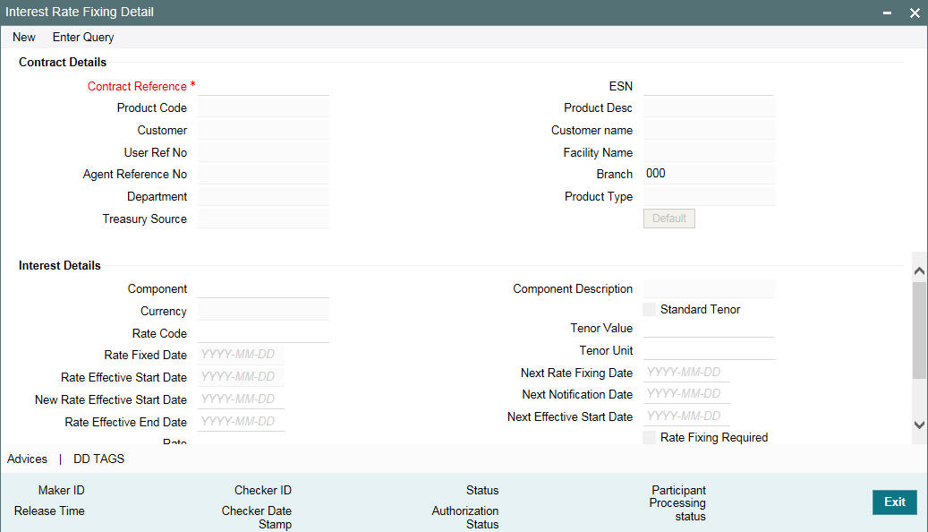

Just as you fix the exchange rate for the drawdown currency, you can also fix the interest rate for a predefined period. The Interest rate fixing days refers to the number of business days before the value date of the drawdown or the new rate fix period. Interest rate fixing for the new drawdown or the new rate fix period is done on this day.
Note
Note
For main interest component if ‘Rate Type’ is 'Fixed', then you can enter rate fixing details in 'Rate Fixing' screen. In addition, you can enter the 'Spread' and 'Margin Details'.
For more details regarding dual authorization, refer the heading titled ‘Authorizing Overrides’ in the chapter titled ‘Loan Syndication Contracts - Part 1’ of this User Manual.
The system arrives at the Interest rate fixing date for the drawdown currency based on the Interest rate fixing days maintained at the tranche level and the holiday validation currencies specified for the drawdown currency.

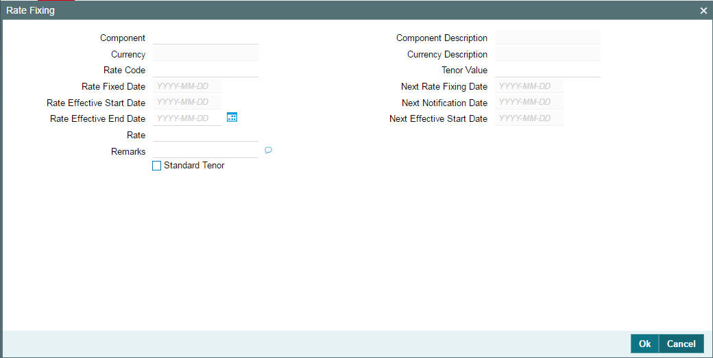

To fix the interest rate for the drawdown currency, click the ‘Rate Fixing’ tab in the ‘ICCF Details’ screen and invoke the ‘Rate Fixing Details’ screen, as shown below:
Note
Rate Fixing button gets enabled in ‘ICCF Details’ screen only if rate fixing is selected at the product level.
You can specify the following details in the ‘Rate Fixing Details’ screen:
Rate Code
You have to specify the floating rate code based on which you can specify the interest rate fixing tenor and the default fixing rate.
Tenor Value
You can specify the rate fixing period by specifying a ‘Tenor Value’ or the ‘Rate Effective End Date’. If you are specifying a tenor, you can select a value from the option list which displays the tenor values associated with the rate code you select. This is based on your maintenance in the ‘Floating Rate Code Definition’ screen. Upon choosing a value, the following details are also displayed:
If you do not want to specify a ‘Tenor Value’, you have the option to capture the end date of the rate fixing period. This date should not be less than or equal to the ‘Rate Effective Start Date’. The system displays the following after you specify the end date:
Rate
The system defaults the interest rate based on the rate code and the tenor value/effective end date you specify for the drawdown. You can change the default rate, if required.
If the base rate is changed or new rate is added or the floating rate codes are changed, the system recalculates the interest. Note that it considers the margin rates maintained for the participants while recalculating the interest due for the participants.
For more details on negative rate processing, refer the title ‘Maintaining Loans Parameters Details’ in the chapter ‘Bank Parameters’ in Core Services User Manual.
Remarks
You can also capture additional information, if required. This will be used only for information purposes.
Click the ‘Ok’ button to save and exit the screen.
Note
On click of unlock button you are allowed to capture the value date by altering the rate effective start date.
Note
The following actions should be performed automatically on click of ‘OK’ button in the ‘value date’ field.
For more information on bidding refer ‘Bidding Contract’ section in ‘Interest’ manual in ‘Modularity’ module.
For details on the ‘LB Interest Rate Fixing’ screen, refer the heading ‘Fixing Interest Rate after drawdown booking’ in this chapter.
To set the rate setting rules for the borrowers drawdown, click the ‘Rate Setting’ in the ‘ICCF Details’ screen and invoke the ‘Rate setting’ screen, as shown below:
Specify the following details.
Product code
The system displays the product code.
Contract Ref number
The system displays the contract ref number.
User ref number
The system displays the user ref number.
Customer
The system displays the customer name.
Facility name
The system displays the facility name.
The system displays the split number.
Principal roll amount
The system displays the principal roll amount.
Interest roll Amount
The system displays the Interest roll amount.
Roll Product
The system displays the roll product.
Total roll amount
The system displays the total roll amount.
Maturity date
The system displays the maturity date.
Rounding rule
Select the rounding rule from the adjoining drop down list. Select one of the options listed below:
Rounding Unit
The rounding unit enables only if the you have selected the ‘rounding rule’ as ‘Down’ and ‘Upto’
Interest rate period
Select one of the interest rate periods from the options given.

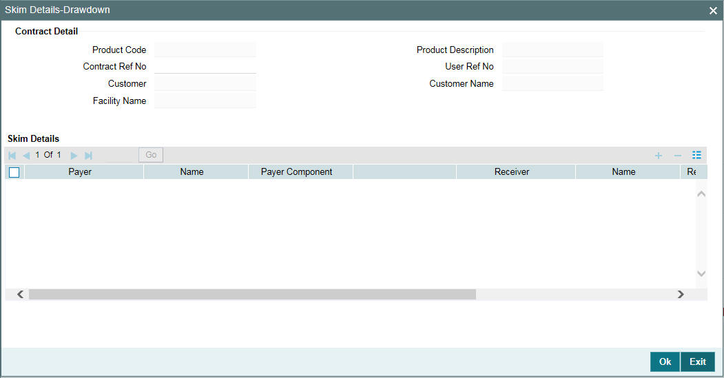

The SKIM details captured for the tranche gets propagated to the drawdown contract. You are allowed to amend the details at the drawdown level. To view and amend the details, if needed, click the ‘Skim’ tab. The ‘SKIM Details – Drawdown’ screen is displayed.
The details of the payer and receiver of Skim and the Skim rate gets defaulted to the respective participant contracts for processing. The accounting entries are also passed in the corresponding participant contracts.
Note
If SKIM details are not maintained for the tranche, you cannot define them afresh at the drawdown level. Atleast one combination of Skim should be defined for the tranche.
For details on the fields in this screen, refer the heading ‘Defining SKIM details for tranche participants’ in this chapter.
For details on the accounting entries defined for the Skim components, refer the heading ‘Maintaining Skim components for participants’ in the ‘Defining Products for Loan Syndication’ chapter of this User Manual.
Note

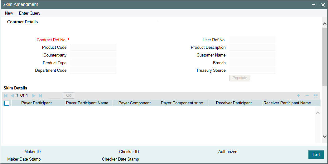

You have the option to amend the Skim details for a drawdown through the ‘Skim Amendment’ screen.
For more information on this screen, refer the heading titled ‘Amending drawdown SKIM details’ in this chapter.

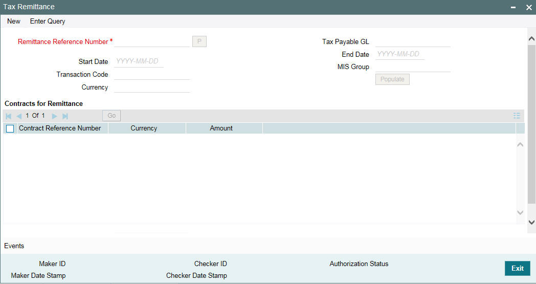

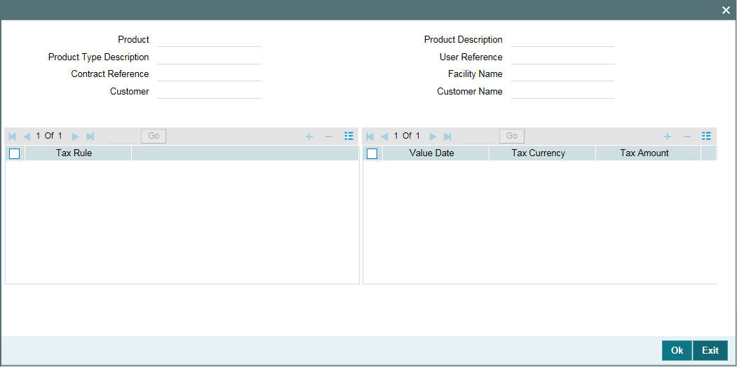

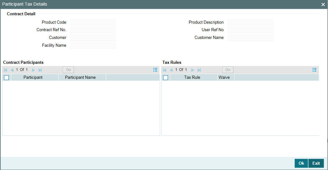

You can collect withholding tax on the fee/interest collected by the participants of a drawdown. However, tax is not applied on the fee collected from the participants. The tax details, if applicable for the participant product (linked to the drawdown through the facility product) is applied on the drawdown. To view the details, click the ‘Tax’.
This screen displays the tax rules for each participant based on which withholding tax is computed on the fee or interest components. Tax rules associated with the drawdown product defaults to the drawdown. You can waive the subsequent tax to be applied for a participant and tax rule combination.
The system passes the entries for tax based on the event you specify in the ‘Product Tax Linkage’ screen. Typically, tax on fee is calculated upon liquidation of the fee (event ‘FLIQ’ will be associated with the rule) and tax on interest is computed on interest liquidation (event ‘LIQD’ is associated with the rule).
For details on associating tax with a product, refer the heading titled ‘Specifying tax details for a participant product’ in the ‘Defining Products for Loan Syndication’ chapter of this User Manual.
For more information on the Tax sub-system of Oracle FLEXCUBE, refer the Tax User Manual.

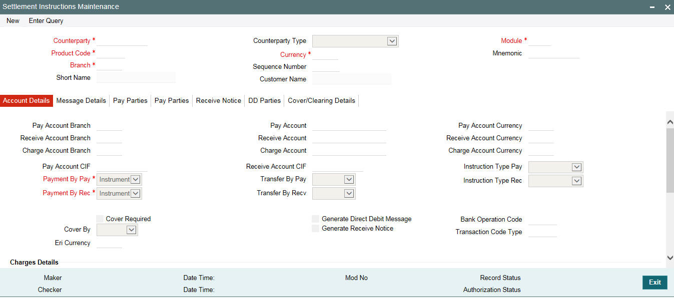

You can maintain settlement instructions for various components such as fees, charges, tax, principal, interest, and so on, using the ‘Overwrite Settlement Instruction Details’ screen. Using this screen, you can post liquidation entries into an Internal GL account instead of the customer account at the time of rollover. Click ‘Overwrite default SI’ in the ‘Drawdown Contract Online’ screen to invoke the following:
Enter the details as specified below:
Component
This screen displays the all the components displayed in the Settlement Message Details screen.
Internal GL
Specify the Internal GL accounts into which you want to post the liquidation entries for the components.
Overwrite Default Settlement Instruction
Select the ‘Overwrite default settlement instruction’ check box to confirm that the liquidation entries should be posted into the Internal GL account. System posts the entries to the Internal GLs only if you check this box. Otherwise, system posts the entries as per the settlement instructions specified for the component of the contract.
Note
You need to perform dual authorization, if you have selected the Overwrite SI option for any of the following events:
For more details, refer to the section ‘Authorizing the overrides for tranche’ in the same chapter.
You can view the settlement instructions for the drawdown in the ‘Settlement’ screen. Click the ‘Settlement’ tab to view the details.
The system obtains the settlement account for each drawdown component based on the SSI Mnemonic selected for the component.
If the ‘Chinese Characters in Payment’ box is checked in the ‘Loan syndication- Branch Parameters’ screen, then only you can enter the Chinese characters in the field 57, 59, and 70 for foreign currency and local currency settlement instructions / accounts and there are no validations in the system. You need to operationally control it.
You are allowed to enter the information in Chinese or English or a combination of both in this field. If it is a combination, then the system considers it as Chinese and allow up to 35 characters.
Note
This is applicable only for ASPAC region.
For more details about the ‘Settlement Message Details’ screen, refer the Settlements User Manual.

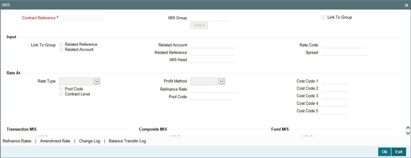

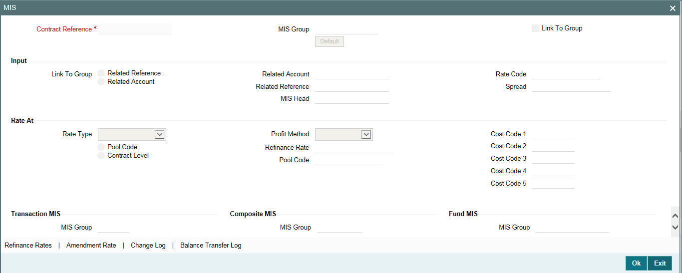

If you have maintained MIS details for the DD (drawdown) product, the same will default to the drawdown. To view the details, click the ’MIS’ tab.
For details on the ‘Transaction MIS Details’ screen, refer the MIS User Manual.

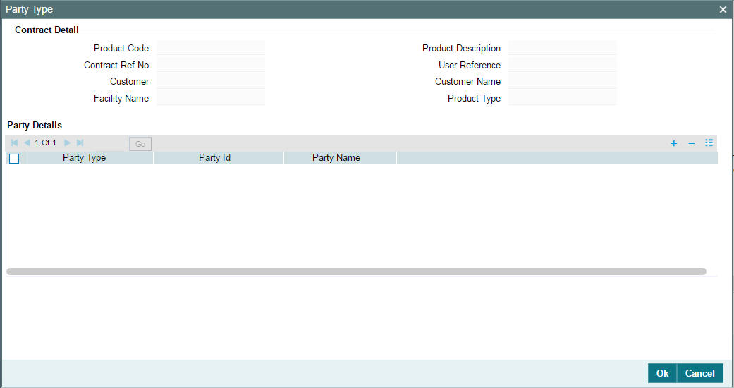

You can also specify different entity or party types that would be applicable for the borrower drawdown as well as the applicable parties belonging to the selected party type. This is done in the ‘Party Details’ screen. Click ‘Party Type’ in the ‘DrawDown Contract Online’ screen. The party types associated with the drawdown product defaults to the drawdown. You can change the defaulted values, if required.
For more details on the above screen, refer the heading ‘Specifying parties for the facility’ in this chapter.

After capturing the drawdown details, you have to save the same and have it authorized by your supervisor.
After you save the drawdown, you can view the following details of the contract:
This section explains only those details that are unique to a drawdown. For details on the other options (Diary Events, Netting Cash Flow Summary, Message Preview, Participant Summary, Events), refer the following sections in this chapter:
You can view the effective interest (EI) rates applied on the drawdown through the Effective Interest Rate details screen. Click the ‘Effective Interest Rate’ to invoke this screen.
In this screen you can view the ‘Effective Interest Rate’ and the ‘Start Date’ from which interest rate is effective in the system.

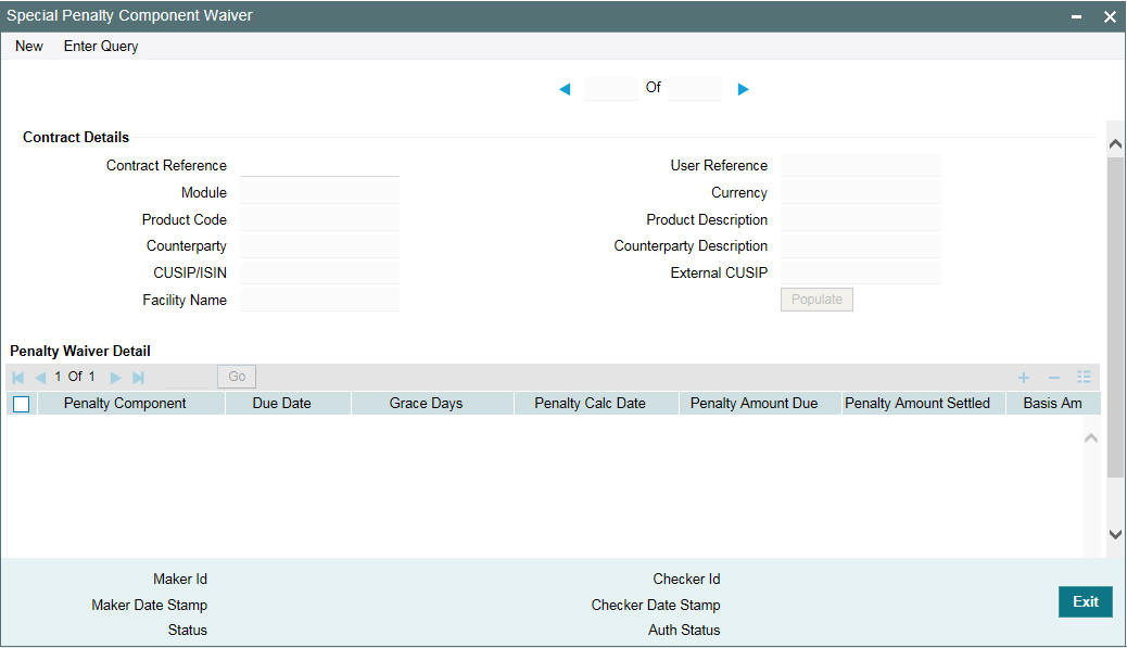

Apply Special Penalty
Select this check box to indicate that system should apply special charges to the penalty component.
System identifies the loan contracts where grace period has expired and tracks due date, amount paid and amount settled for each component of the loan. If late payment charge component has been defined for a loan contract, that is,. if the ‘Special Penalty Component’ is selected for a component in a contract, then system does the following:
You can specify the media for the message generation in ‘Media for Message Generation’ screen. You can invoke this screen by clicking ‘Media Priority; tab. This button is enabled only if the ‘FpML Type’ option is unchecked and the ‘Media Priority’ option is checked at the product level.
The system displays the following details:
You can specify the following details:
Media for All Investors
Select this check box to indicate that the media is applicable for all the investors.

You need to do the following set ups at the contract level for amortization schedule type contracts.

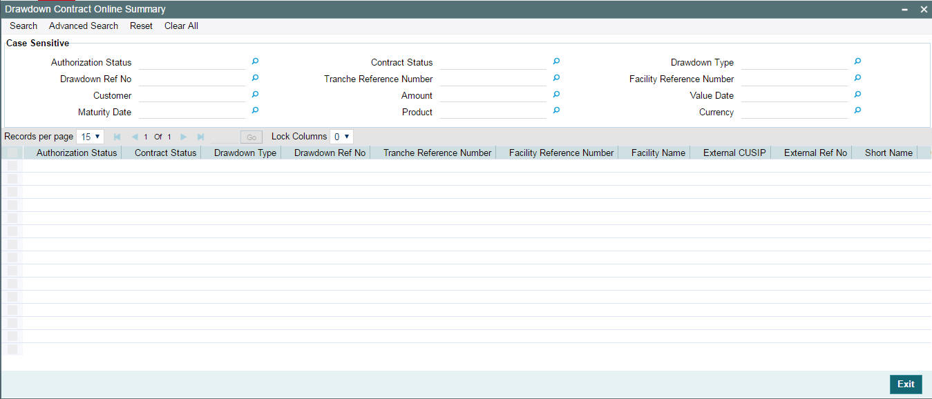

You can view the drawdown details using the ‘Drawdown Summary’ screen. You can invoke the ‘‘Borrower Drawdown Summary’ screen by typing ‘LBSDDONL’ in the field at the top right corner of the Application tool bar and clicking the adjoining arrow button.
You can view the following fields:
You can perform a case independent search only if the parameter, ‘CASE_SENSITIVITY’ in cstb_param, is set to ‘Y’.
If you do not fix the exchange rate during drawdown booking (the event ‘EXFX’ is not fired for such drawdowns) you have the option to fix the same after the booking event. This is applicable if the drawdown currency is different from the tranche currency. You can invoke the ‘Exchange Rate Fixing’ screen by typing ‘LBDEXRFX’ in the field at the top right corner of the Application tool bar and clicking the adjoining arrow button.
All subsequent exchange rate fixing after the drawdown booking is done through the above screen. Through this screen, you can fix the exchange rate for the current period (before the effective start date) as well as specify a rate for a new period. These options are discussed below.
You can use the unlock option to fix the exchange rate before the effective start date of the exchange rate fixing period. If you attempt to fix the exchange rate after the effective start date, the following message is displayed:
Exchange rate already fixed
To amend the exchange rate for the current fix period (i.e. before the effective start date), do the following:
Note
‘Advice for event EXFX is suppressed for the product, Do you want to continue?’
Advice for event ROEX is suppressed for product, Do you want to continue?
Advice for event CREX is suppressed for product, Do you want to continue?
You can use the ‘New’ option to fix the exchange rate for the next period. Follow the steps given below to fix the exchange rate using this option:
For the first time, you can fix the interest rate as part of drawdown booking through the ‘Rate Fixing Details’ screen. Subsequent rate fixing should be performed through the ‘LS Interest Rate Fixing’ screen. You can invoke the ‘Interest Rate Fixing’ screen by typing ‘LBDIRTFX’ in the field at the top right corner of the Application tool bar and clicking the adjoining arrow button.
You can view the agent reference number in this screen.
For interest rate fixing also you have the ‘Unlock’ (to fix the interest rate before the effective start date) and ‘New’ (to fix the interest rate after the effective start date) option. For more details on negative rate processing, refer the title ‘Maintaining Loans Parameters Details’ in the chapter ‘Bank Parameters’ in Core Services User Manual. For details on the two options, refer the heading ‘Fixing exchange rate after drawdown booking’ in this chapter.
For more information on the editable fields in the above screen, refer the heading ‘Fixing interest rate for the drawdown’ in this chapter.
‘Media’ tab. This tab is
enabled only if the ‘FpML Type’ option is deselected at the
contract level and the ‘Media Priority’ option is checked
If this tab is enabled, then the system displays an override message saying to view the ‘Media for Message Generation’ screen. If not, the system handoffs the message as per the details maintained in the ‘Customer Entity Maintenance’ screen.
For more information on the ‘Media for Message Generation’ screen, refer the heading ‘Specifying Media for Message Generation’ in this chapter.
You can amend the Skim details maintained for a drawdown in the ‘Skim Amendment’ screen.
For details on maintaining SKIM for a tranche, refer the section titled ‘Defining SKIM details for tranche participants’ in this chapter.
You can invoke the ‘Amending Drawdown SKIM Details’ screen by typing ‘LBDSKMAM’ in the field at the top right corner of the Application tool bar and clicking the adjoining arrow button.
You can use the ‘New’ option for amending the Skim details for an authorized drawdown. The ‘Unlock’ option is available only if the drawdown is unauthorized.
Note
During amendment:
When you ‘Unlock’ or select the ‘New’ option, as the case may be, do the following as part of amendment:
For more details on the ‘Skim Details – Drawdown’ sub-screen, refer the heading titled ‘Specifying drawdown SKIM details’ in this chapter.
In the ‘Value Date Wise Skim History’ section of the ‘Skim Amendment’ screen, you can view the history of modifications/amendments made till date for a payer and receiver combination. The following details are displayed here:
In the ‘Skim Rate History For:’ section of the screen, you view the latest values associated for a payer and receiver combination, prior to the amendment. If only a single amendment is processed for the drawdown, both the history sections will display the same details.

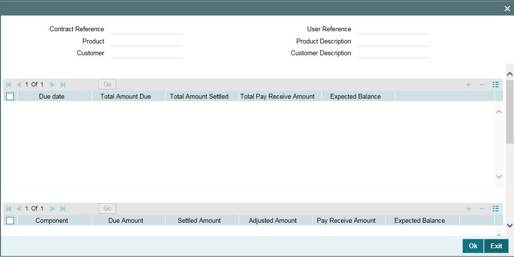

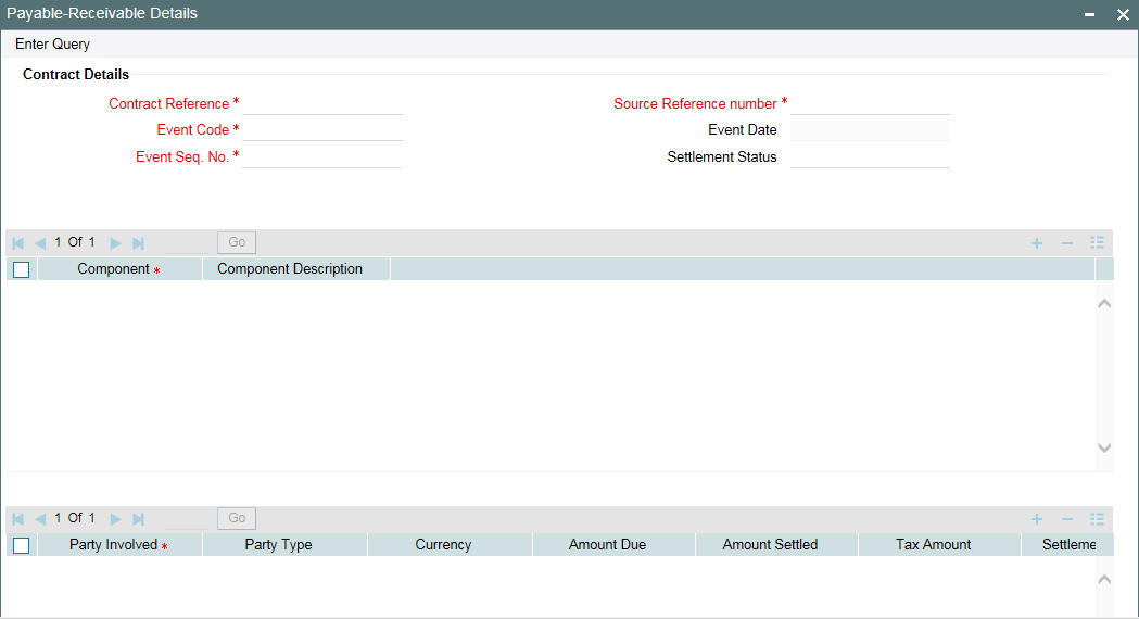

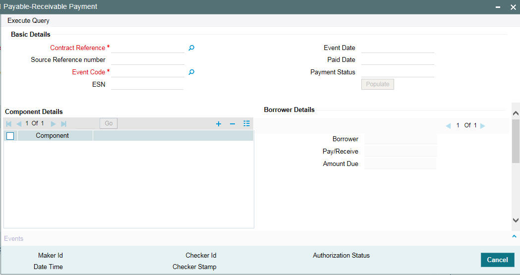

The following points are noteworthy with respect to payable/ receivable tracking:
Note
You can reverse a payment of a payable/receivable by clicking the ‘Reverse’ option . This option is enabled only if you access the above screen directly from the Application Browser (to do this, you need to choose LS Operations and double-click on the Payment option under Receivable Payable).

You can specify the Global Tranche or Global Drawdown amounts in the ‘Tranche Online’ and ‘Drawdown Online’ screens respectively during contract booking. Any amendment to the Global Tranche or Global Drawdown amounts is done in the ‘Global Amount Amendment’ screen.
Using the ‘Global Amount Amendment’ screen, you can amend all non-lead Tranches; however, you can only amend those non-lead Drawdowns where the Cascade Participation is set to ‘No’.
You can invoke the ‘Global Amount Update’ screen by typing ‘LBDGLAMT’ in the field at the top right corner of the Application tool bar and clicking the adjoining arrow button.
To amend the Global Tranche or Drawdown amounts, do the following:
The system automatically updates the Global Amount for non-lead Tranches or Drawdowns in the following scenarios:
The latest Global Amount for tranche as on the date of handoff is used for handoff of the Commitment Reduction to the Loans QT system.
Note
The following for the global amount for tranche:
Note
The following for the global amount for drawdown:

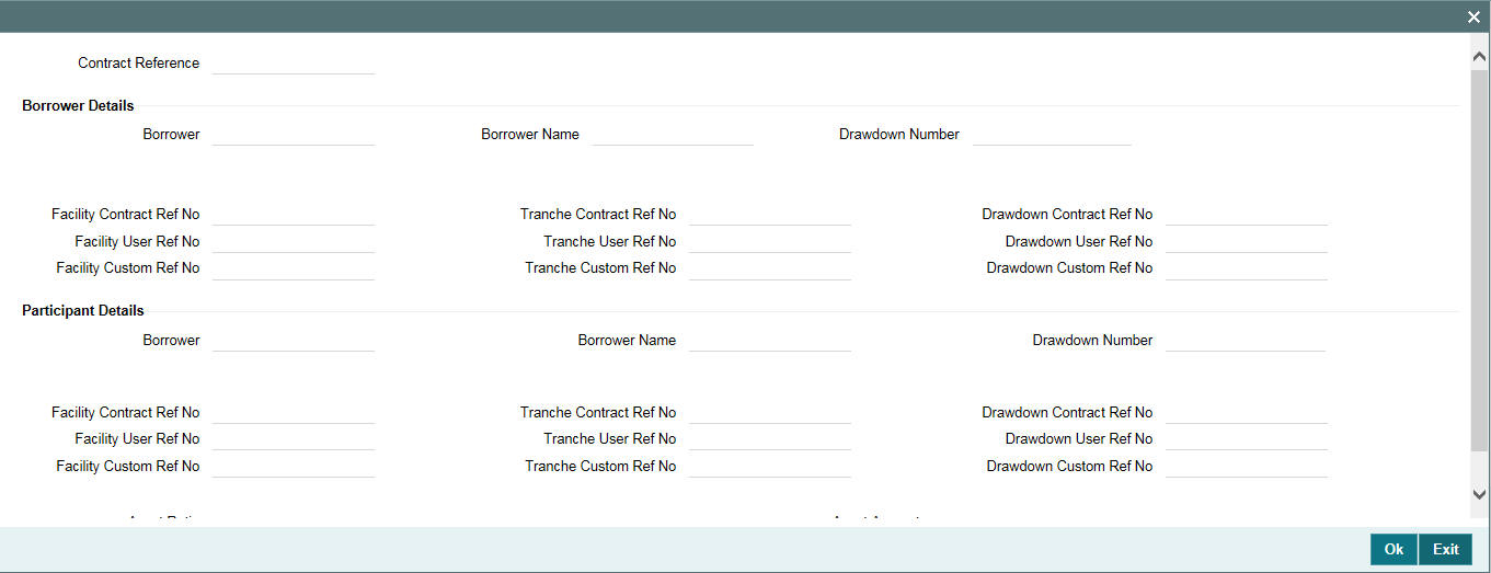

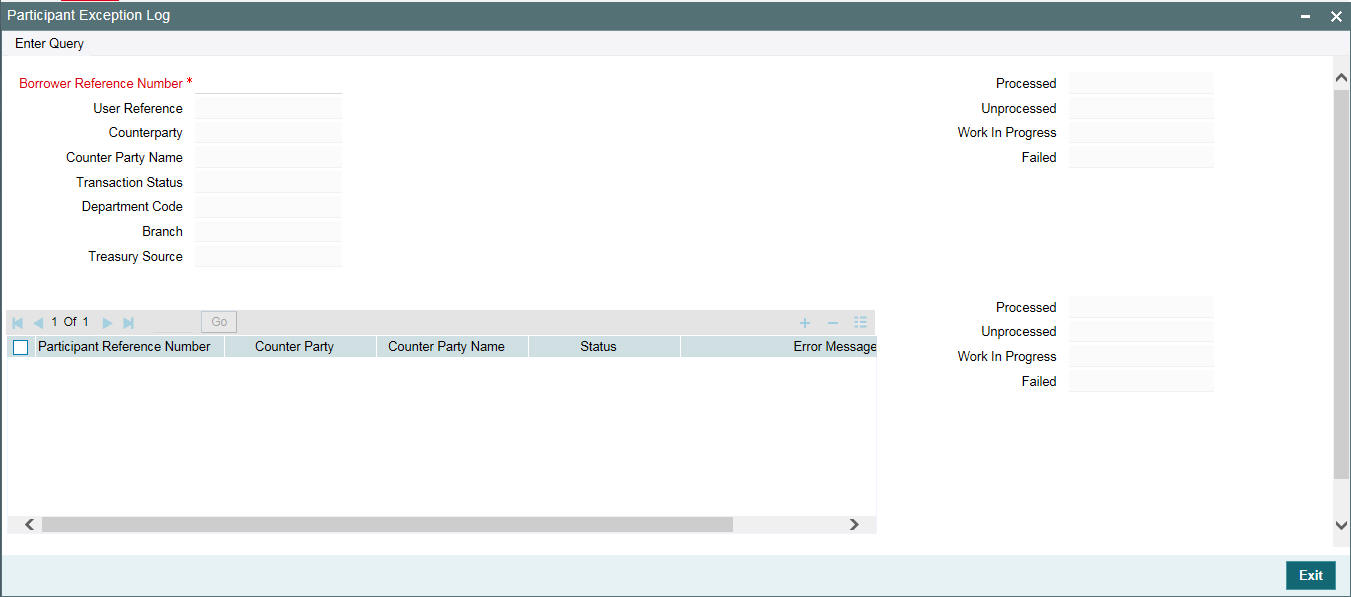

You can also view the details of borrower and participant contracts processed in Oracle FLEXCUBE in the ‘JOB PROCESS STATUS’ screen.
For more details on the above screen, refer the heading ‘Viewing borrower/ participant contract processing status’ in this chapter.

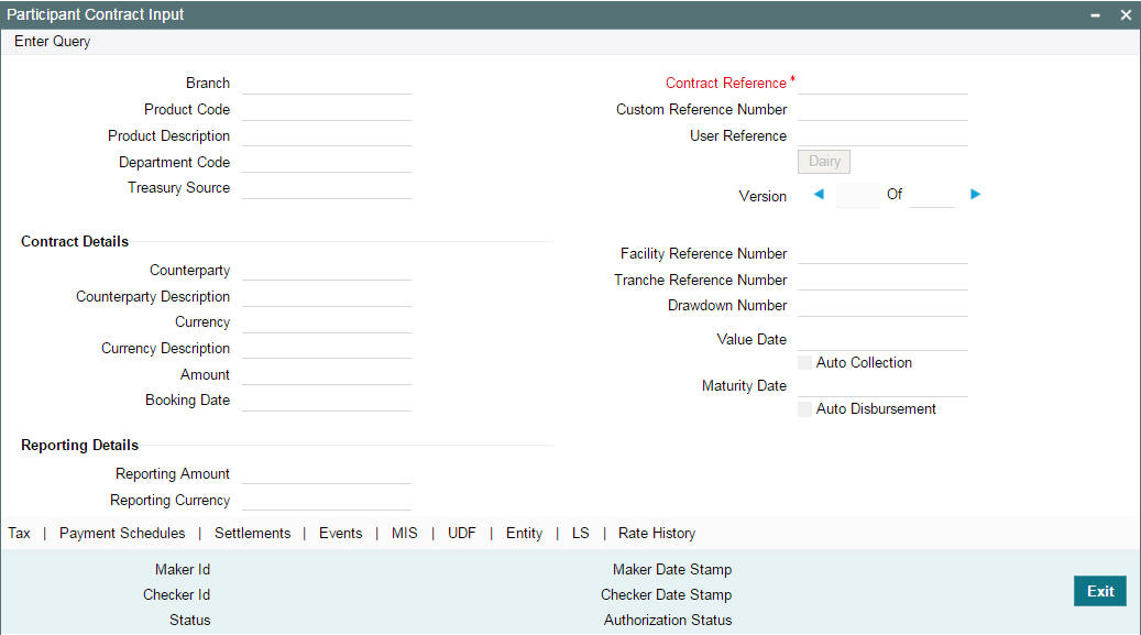

You can invoke the 'Participant Contract Input’ screen by typing ‘LPDCOMNT’ in the field at the top right corner of the Application tool bar and clicking the adjoining arrow button.
In the above screen, you can view the following details about the contract:
In addition, a vertical toolbar is also provided in the screen. These buttons are used to invoke other sub-systems required for processing a participant contract. These buttons have been described briefly below:

You can view the participant entity details in the ‘Participant Entities’ screen. These details are defaulted from the participant details maintained for borrower facility/tranche/drawdown associated with the participant facility/ tranche/drawdown. Click the ‘Entity’ tab to invoke this screen.
You can add or delete entities and also assign a different primary entity for the participant, if required. You can view the position identifier description in case the participant is self participant.
For more details on the options available in this screen, refer the heading ‘Specifying drawdown entity details’ in this chapter.
You can view the settlement instructions for the contract in the ‘Settlement Message Details’ screen. Click the ‘Settlements’ tab to view the details. The details are defaulted based on the SSI Mnemonic selected for the participant in the borrower tranche/drawdown.
If you have maintained MIS details for the participant tranche/drawdown product, the same will default to the participant tranche/drawdown. To view the details, click the ‘MIS’ tab.

You can collect withholding tax from participants on the interest and fee components. If you have associated tax rules with the participant tranche/drawdown product, the same is become applicable to the contract. You can view the tax details for the contract in the ‘Tax Details’ screen.
Click the ‘Tax’ tab to invoke the screen.
For details on maintaining tax rules and schemes, refer the Tax User Manual.

To view the margin rate history, click the ‘Rate History’ tab. The ‘Rates History’ screen is displayed, as shown below:
The following details are displayed on this screen.

You can view the participant’s margin details that are applicable for the contract, by clicking the ‘Margin History’. The ‘Rates History’ screen is displayed, as shown below:

You can view the participant position summary in the Participant Position Summary screen.
You can invoke the ‘Participant Position Summary’ screen by typing ‘LBSPTPSN’ in the field at the top right corner of the Application tool bar and clicking the adjoining arrow button.
You can view the position details of the participants, for different dates, using this screen. To view details, query using any of the following fields in the Participant Position summary screen:
The following fields are displayed in this screen
You can use this screen to query the details for self-participants and also for external participants.

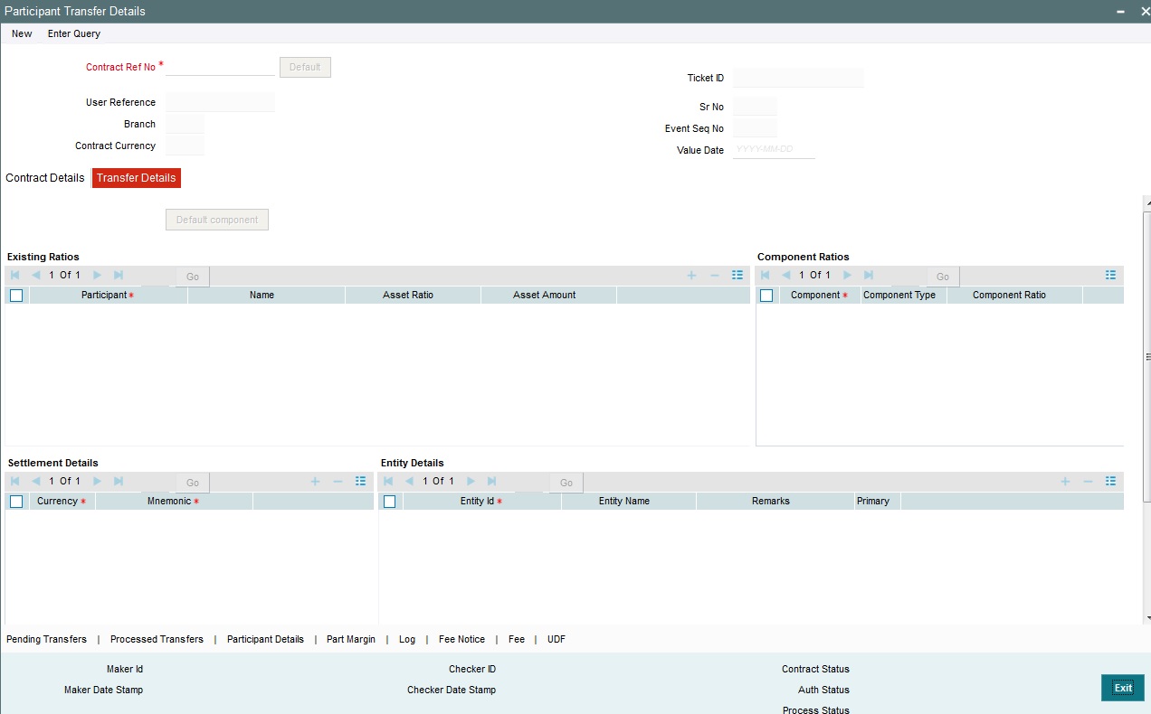

If you want to make changes in the asset ratio of participants for a borrower tranche or drawdown, use the ‘Participant Transfer Details’ screen. You can invoke the ‘Participant Transfer Details’ screen by typing ‘LBDPTFR’ in the field at the top right corner of the Application tool bar and clicking the adjoining arrow button.
The specification for ‘Cascade Participation’ (whether checked or not) defaults from the contract . When you execute a participant transfer at the tranche level and the ‘Cascade Participation’ option is selected for the tranche, the impact of the transfer automatically affects all the drawdowns under the tranche. However, if the option is not selected, you are required to update the underlying drawdowns manually. In this case, only new drawdowns, processed subsequent to the transfer will reflect the changes.
When you specify the transfer percentage for a transfer instruction, the system arrives at the transfer amount based on the existing actual balance as on the value date of the instruction. In this case, it does not consider the impact of the unauthorized PRAM instructions. You cannot authorize a transfer instruction if there are other unauthorized events like CAMD, LIQD, and so on under the tranche/drawdown.

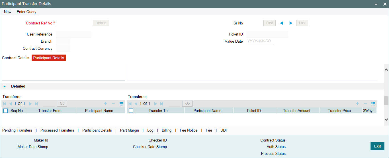

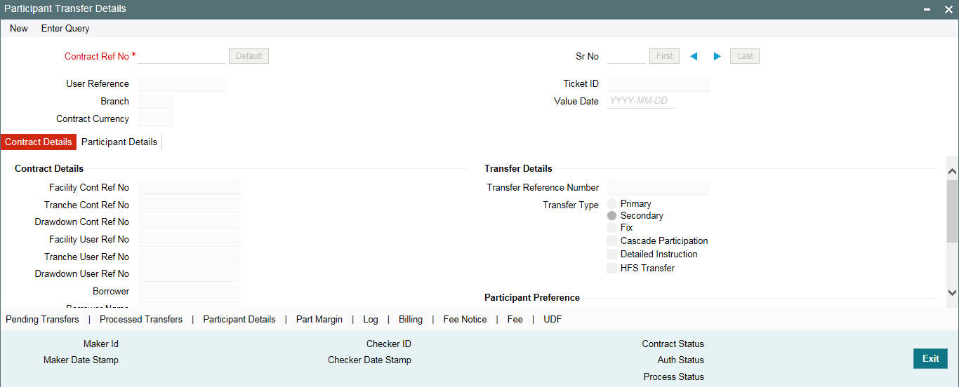

You can perform participant transfers between the booking date and value date of drawdowns under ‘Non- Cascade Participation’ type of tranches. In this case, the value date of the transfer instruction is equal to the value date of the forward dated drawdown. In this screen, you can amend the participant details for a borrower drawdown only if the ‘Cascade Participation’ option has not been set for the underlying tranche. If this option is not selected, you cannot choose the contract reference number of such contracts in this screen, and amendment is not possible.
In case of participant amendments involving PIK components, only the Principal amount should be considered for transfer and the calculated PIK margin should be apportioned among the participants based on the resultant ratio. If you amend the participant details for a borrower tranche that uses a product for which the ‘Cascade Participation’ option has been selected, the changes are applied to all active drawdowns under the tranche. The ‘Cascade Participation’ option is available as part of additional preferences for a borrower product.
In case Sighting Funds is applicable for the contract, then the system does not allow transfer between investors who have pending funding for any of the underlying drawdowns. In addition, the system does not allow participant transfer beyond the latest actual receipt date for any of the underlying drawdowns for the investors involved in the transfer. However, future dated Participant Transfer is allowed on sighting funds enabled tranches only if ‘Part Transfer for FD VAMB/INIT on SF DD’ check box is selected in the ‘Loans Parameters’ screen, and the existing participants in that tranche involved in the participant transfer must be funded till the application date.
For details on participant transfer for sighting funds enabled tranches, refer section ‘Participation Transfer for Sighting Funds’ in this User Manual.
You can differentiate primary transfer and secondary transfer for a participant transfer by selecting the option provided here. In case of Primary Transfer, Transfer fee screen gets disabled in the Participant Ratio Amendment screen and in the Draft Transfer. Transfer Fee Billing screen gets incorporated in the Draft Transfer, however the fee billings or ledger entries will be processed only upon the confirmation of Draft Transfer.
The ledger entries and the corresponding Payment messages are applicable only for the Primary transfers if it is selected for the applicability of ledger entries and the payment messages.
The system triggers the ‘PRAM’ event to propagate the change.
Oracle FLEXCUBE allows you to change the participation ratio at tranche/DD level beyond the liquidation of schedules when there is transfer of shares between participants. If you do any changes to back valued Participant Ratio beyond the last liquidation/schedule date, it results in the change of the scheduled amounts for the affected participants. You need to track the Payables and Receivables for the difference between the old and new amounts for those participants.

You can use the ‘Participant Transfer Details’ screen for the following purposes:
Addition of new participant is allowed from a facility and is available for the tranches and drawdowns processed under it. When you invoke the screen, the following contract details are available:
When you perform a back value participant transfer and when tranches for which ‘Cascade Participation’ is selected, the following happens:
When you perform a back value participant transfer and when tranche contracts for which ‘Cascade Participation’ is not selected following happens:
You can perform future dated participant transfers for pro-rata tranches. You can specify a future date as the value date for the transfer.
The following table lists out the events associated with future dated participant transfer.
Event |
Description |
PAMB |
Future dated PRAM instruction booking |
PAMI |
Future dated PRAM instruction Initiation (will happen on value date) |
PAMA |
Modification of future dated PRAM instruction |
PAMC |
cancellation of future dated PRAM instruction |
If any back/current dated activity is performed on a tranche and underlying drawdowns before the value date of the future dated Participant Transfer instruction, the system rebuilds the asset ratio for the future dated transfer.
The following events result in a change in the asset ratio of FD PRAM:
The following events are impacted by future dated Participant Transfers:
If the future dated Participant Transfer instruction is unauthorized you are allowed to perform activities like LIQD, VAMI, and PRAM. If an unauthorized FDPRAM exists along with other unauthorized current/back dated PRAM instructions, authorizationis allowed for the earliest instruction based on the value date.
Note
Future dated participant transfer is allowed on sighting funds enabled tranche when any of the following future dated events exist for Drawdowns under the tranche:

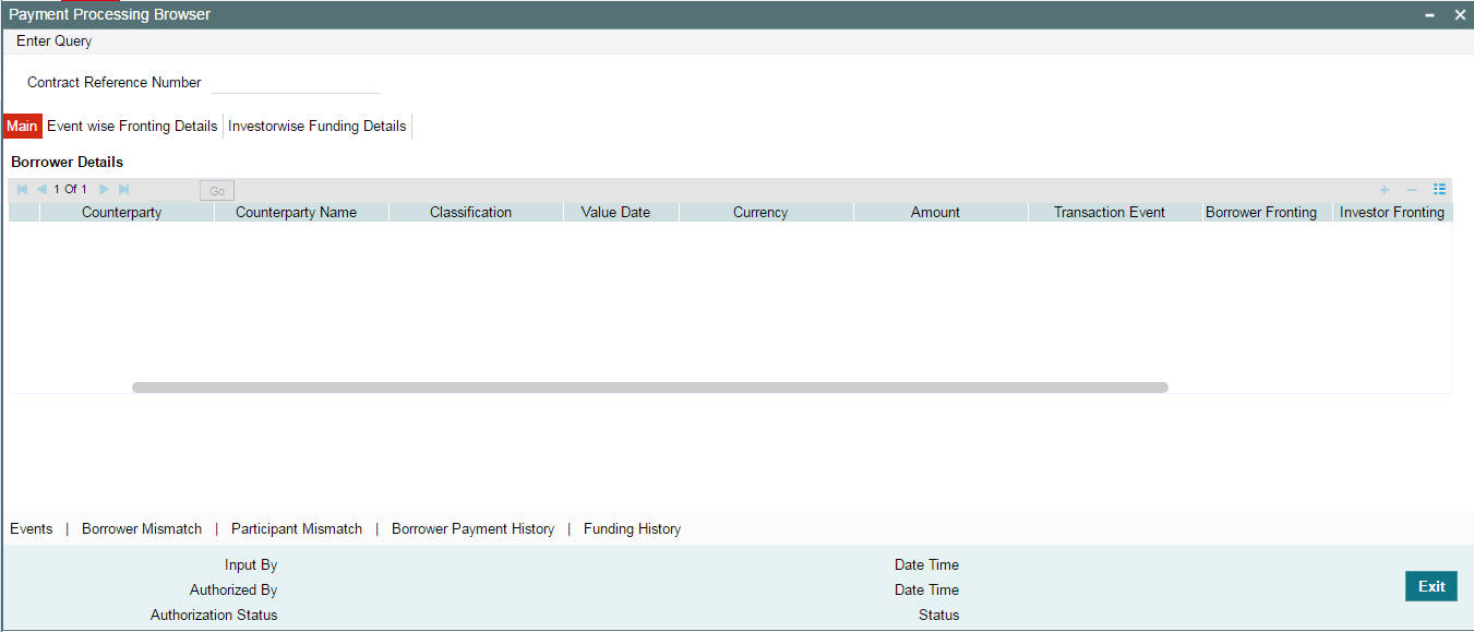

In the ‘Payment Processing Browser’ (LBDMTPRC) screen, the following details are updated for participant transfer with existing participants during participant transfer authorization based on the latest ratio for future-dated events:
For participant transfer with new participants, system adds the new participants to the existing list of participants in the ‘Payment Processing Browser’ screen. The fronting value is defaulted as follows:
For more details, refer section ‘Processing the Release of Payment Messages’ in this User Manual.
To transfer assets from one participant to another, you have to select the reference number of the contract for which you want to initiate the asset transfer amongst the participants.
You can either click ‘Add Row or ‘Delete Row’ to add or delete participants. The ‘Participant Selection’ screen is displayed.
In this screen, you can view the existing participants of the contract.
The ‘Participant Transfer Details’ screen displays the following details:
You have the option to capture a consolidated type of transfer instruction or a detailed instruction for each participant. By default, the system takes you to the ‘Consolidated’ tab of the ‘Participant Transfer Details’ screen.
The system ensures the following when you capture the transfer instructions:
Select the name of the participants between whom you want to asset transfer in the ‘Consolidated’ tab of the ‘Participant Transfer Details’ screen. For a given value date, you can capture the net amount transferred to and from each participant.
For the participant who is the transferor, specify the amount with a negative sign (to indicate that the transfer is ‘From’ the participant).
Note
The sum of the transfer amount across all participants should be zero.
While maintaining the consolidated transfer instruction, you cannot visit the ‘Detailed’ section of the screen. The system displays the following error message:
Transfer Instruction Type is consolidated. Cannot enter detailed transfer instructions.
Click ‘Save’ to save the transfer details.
To capture individual participant transfer details, check the ‘Detailed ’ section.
Click Participant Details tab and check the Detailed section
To transfer assets between participants, you have to select the participants from the ‘Participant Selection’ screen and then specify the following for each:
Transferor/Transfer From
You have to select the participant from whom the asset should be transferred. Upon selection of the participant, the name is displayed in the adjacent text box. The system also assigns a sequence number ‘1’ to the first transferor and this number automatically increments by 1 for every subsequent addition of a transferor.
Transferee/Transfer To
You have to select the participant who is receiving the transfer amount. Click ‘Add Row’ button to enable the selection of a transferee. Select a participant from this list.
You may delete a participant(s) if you do you want to include it as a transferee(s). To delete, click ‘Delete Row’ button. However, atleast one transferee is mandatory for a transferor.
Transfer Amount
If you specify the transfer amount, the system computes and display the transfer ratio.
Send Message
Select this check box to indicate if the fax messages have been generated for this participant with the details of the transfer.
For consolidated type billing instruction, you have to define the transfere fee amount against each participant. Transfer Fee amount defined at the Tranche Level is applicable only for the Detailed Transfer Instruction type and not for the Consolidated Transfer Instruction type.
Accounting Entries and messages for the Transfer Fee Billing goes with the Participant Tranche contract Reference number. Accounting Entries and messages for the ledger Entries goes with the Participant Drawdown contract Reference number.
Payment message generation at the tranche level for Transfer fee Billing goes with the settlement days defined for the Transfer fee Settlement currency.
Note
Click ‘Add Row’ button to select the next transferor from the option list provided.
After specifying the changes, click ‘Save’ button to confirm the transfer details. The system arrives at the net of the transferor/transferee amount for each participant and you can view it in the ‘Consolidated’ tab of the screen.
On save of Participant Transfer of a contract, if funding is pending (Fund sighted is No) for any participants involved in transfer, the system provides an override message as shown below.
‘Funding from Participant(s) is pending. Do you want to continue?’
The following details the updated:

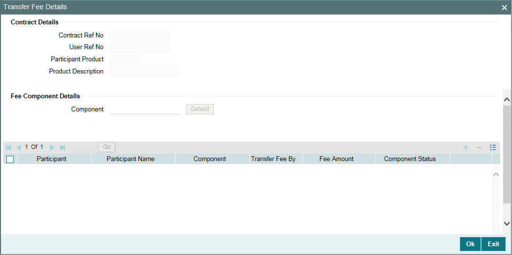

You, as the lead agency, have the option to collect transfer fee for the asset transfer between participants. The fee can be charged to both the transferor and the transferee.
You can collect fee from participants only if fee components are associated with the participant product involved in the contract. In addition, the fee components should be defined with the following attributes:
For details on defining product level fee components, refer the heading ‘Specifying fee components with the product’ in the ‘Defining Products for Loan Syndication’ chapter of this User Manual.
You can capture the fee details in the ‘Transfer Fee Details’ screen. Click ‘Fee’ tab to invoke this screen.
You can capture the following transfer fee details in this screen:
Component
The applicable fee components defined for the participant product is available in the option list. You can select one of them to collect the transfer fee. After you select the component, the following details are displayed:
Fee Amount
Specify the amount to be collected as fee. The fee is expressed in the contract currency. This is collected as one time fee and hence requires no schedule definition.

The ‘Participant Transfer Details’ screen looks as shown below:
After capturing the necessary details, save and authorize the record. You can then select the tranche processed under the facility (to which new participants have been added) and transfer the assets appropriately between the existing and new participants.

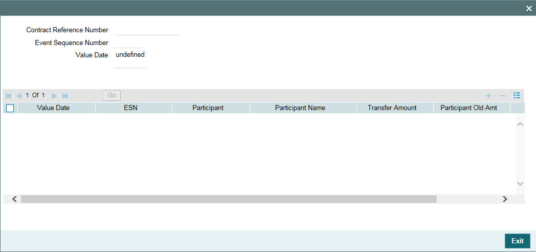

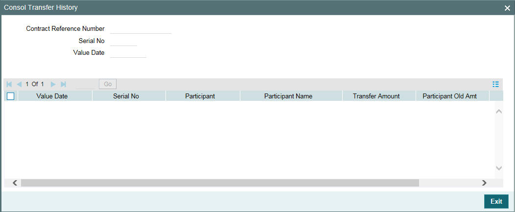

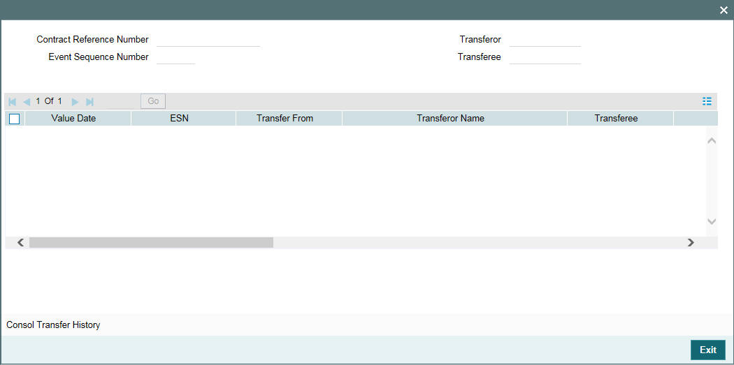

You can view all ‘Detailed’ authorized transfer instructions in the ‘Processed Transfer Details’ screen. To invoke this screen, click ‘Processed Transfer’ tab.
In this screen, you can view the following details of a transfer transaction:
You can also view the net amount transferred from/to each participant (for ‘Consolidated’ transfer instructions) in the ‘Processed Transfers - Consolidated’ screen. To invoke this screen, click ‘Console Transfer History’ button.
The ‘Transfer Amount’ with a negative sign indicates that the transfer is ‘From’ the participant. If the transfer is ‘To’ the participant, the amount will be shown with a positive sign.

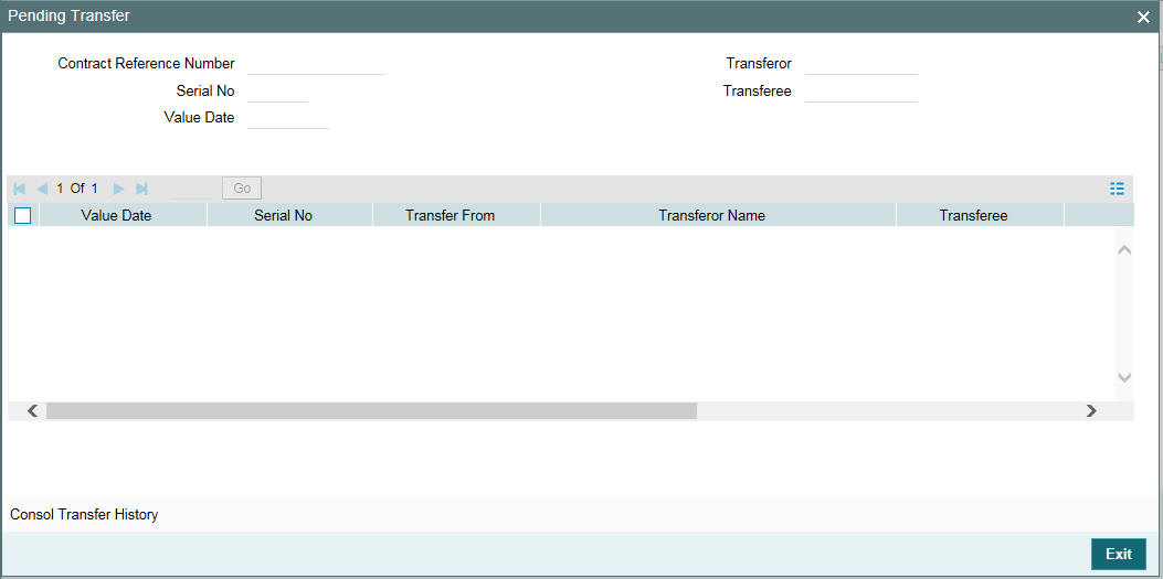

You also have the facility to view details of all pending transfer instructions in the ‘Pending Transfer’ screen. To invoke this screen, you have to click ‘Pending Transfer’ tab in the ‘Participant Transfer Details’ screen.
For each pending transfer, you can also view the net amount transferred from/to each participant in the ‘Pending Transfers - Consolidated’ screen. To invoke this screen, click ‘Console Transfer History’ button.
You can view margin details maintained for participants of the drawdown contract, using the ‘Participant Margin Maintenance’ screen. To view this screen, you have to click the ’Part Margin’ tab.
All details captured in the ‘Margin Maintenance’ screen are defaulted here.
For a given effective date and currency, you can view the margin maintained for the borrowers and participants.
To add a new participant, click ‘Add Row’ and click ‘Default Components’.
The system displays all participants linked to the tranche. You can specify the margin rate applicable for the required participants from the required effective date.
Note that you can maintain margin rates for participants only for margin components of the main interest components of the Tranche’s Drawdown products.
Place your cursor on a participant and click the ‘Delete Row’ button to delete that participant.
the details and exit the screen.
The system will ensure that the total margin rate of all the participants is the same as the borrower margin rate for the effective date for which margin rate is captured/ amended. It will also check the rates for each participant, margin component, currency, effective date and amount slab combination. You should have computed the required margin rates prior to capturing or amending the margin rate using this screen. If the validation for margin rates fails, the system will display an error message and will abort the transaction. You will have to correct the margin rates and then proceed.
If base rate is negative or borrower margin rate is negative then system will not allow user to maintain participant margin. If user has captured positive margin rate for borrower and participant then system will not allow user to amend the margin rate from positive to negative.
The system displays the below error:
Borrower margin is lesser than 0, hence participant margin cannot be captured.

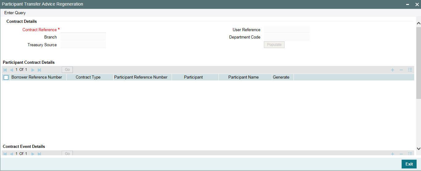

Oracle FLEXCUBE enables you to send faxes to all the participants on Participant transfer (Assignment) Processing with the following details:
After the Participant Transfer is authorized, an override message gets generated for regeneration of Pending Advices. Regeneration of pending advices/notices is for the existing participants with event based notices, event based rate fixing advices and event based payment notices. You can view the list of existing affected participants and advices for the existing affected participants with Pending Status in the ‘Participant Transfer Advice Regeneration’ screen.
You can invoke the ‘Participant Transfer Advice Regeneration’ screen by typing ‘LBDPTADV’ in the field at the top right corner of the Application tool bar and clicking the adjoining arrow button.
You can view the following details here:
Generate
The generate check box is selected for all the investors and the events for regeneration. However, you can also clear the check box.
After the generation of selective advices, the status gets updated to ‘Regenerated’ from pending.
Note
Regeneration of Free format is possible only when billing date is in future. The contracts which got the cascade participation are applicable for regeneration. Advices are also regenerated for new participants added as part of participant transfer. The system identifies the events for which advices have to be regenerated based on the advice events whose value dates are greater than the system date. Event value date should be greater than or equal to assignment date for the events other than NOTC and for NOTC it should be greater than the assignment date.
Oracle FLEXCUBE enables you to remit the withheld tax amount that was not remitted for a period, to the Central Bank. The tax administrators will review the tax withholdings of all participants at regular intervals. They will select the tax withholdings that need to be sent to the internal Treasury Tax Loan (TTL).
Tax is remitted to the Central Bank using the ‘Tax Remittance’ screen. You can invoke the ‘Tax Remittance’ screen by typing ‘LBDTARMT’ in the field at the top right corner of the Application tool bar and clicking the adjoining arrow button.
Enter the following details:
Remittance Ref No
For any remittance, you need to click ’New’ from menu. System generates a unique 16 digit reference number and populate the same here. For example, the format of the reference number will be as follows - CT4ZTRM043660065 where;
You can query the remittance made in the past using the remittance reference number.
Tax Payable GL
The tax remitted amount will be credited into this GL account. The option list will display all internal GLs of the branch.
Start Date
Select the date from when you want to remit the tax withholdings. The drop-down list will display all the withholding tax have been booked from this date.
End Date
Select the date till when you want to remit the tax withholdings. The drop-down list displays all the withholding tax have been booked till this date.
Transaction Code
The transaction code you specify here will be used to pass liquidation entries. The option list displays all transaction codes maintained in the ‘Transaction Code Maintenance’ screen.
For more details on transaction codes, refer the chapter ‘Transaction Code Maintenance’ in the Core Services (CS) User Manual.
MIS Group
Select the MIS Group from the list of values. The accounting entries are posted with MIS details associated with the MIS group.
Currency
This is the currency in which the tax that has been withheld needs to be remitted.
Note
System does not post accounting entries or fire events after remitting tax for any LS contract.
Once you enter the above details, click the ‘Populate’ button to view details under ‘Contracts for Remittance’. Here, system will display all the withheld tax entries for the specified period in the currency you have selected.
If you change the Start Date, End Date or Currency, you will need
to click the ‘Populate’ button
to update the details displayed under ‘Contracts for Remittance’.
Contract Ref No.
The reference number of the facility, tranche and drawdown contracts against which the tax was withheld is displayed here.
System displays the tax currency and the total tax amount that was withheld against the participants of the contract. Click ‘Events’ to view the ‘Event Log Details’ screen.
For more details on the ‘Event Log Details’ screen, refer the section titled ‘Viewing events for the facility’ in the ‘Loan Syndication Contracts’ chapter of this User Manual.
You can execute the following operations in the ‘Tax Remittance’ screen:

Click ‘Media Priority’
button to invoke the ‘Media for Message Generation’ screen.
You can specify the media for the message generation in this screen.
This buttonis enabled only if the ‘FpML Type’ option is unchecked
at the contract level and the ‘Media Priority’ option is
If this button is enabled, then the system displays an override message saying to view the ‘Media for Message Generation’ screen. If not, the system handoffs the message as per the details maintained in the ‘Customer Entity Maintenance’ screen.
For more information on ‘Settlement Message Details’ screen, refer the Settlements User Manual.
For more information on the ‘Media for Message Generation’ screen, refer the section ‘Specifying Media for Message Generation’ of this chapter.

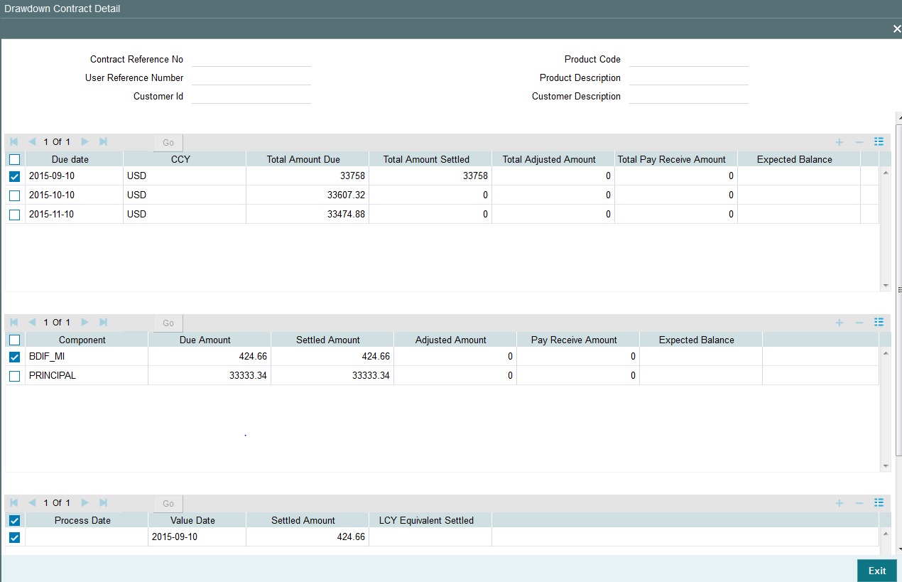

In Oracle FLEXCUBE, you have the ‘Payment–Receivable Details’ screen through which you can view the receivable/payable amounts for a drawdown. You can invoke the ‘Payable-Receivable Details’ screen by typing ‘LBDPRDET’ in the field at the top right corner of the Application tool bar and clicking the adjoining arrow button.
For a drawdown/tranche, this screen displays the receivable/payable amounts for each component and the associated event. Based on the last event which has occurred in the life cycle of the contract, the corresponding event sequence number gets defaulted in the ‘Event Seq No’ field. Once the payable and the receivable amounts are settled across all the components for a particular contract, the system updates the ‘Settled Status’ field to ‘Settled’.
All the components for a contract are displayed in the ‘Component Details’ section.
For each component of the drawdown/tranche, the system displays the following details:
Note
If the tax rules are tagged to the components and if the tax is applicable, the system also passes the necessary accounting entries for tax.
You can use the navigation buttons - provided in the toolbar to scroll through the tranches and drawdowns.
You can process settlement of a payable/receivable amount in the ‘Payable – Receivable Payment’ screen. Click the ‘Payment’ button to access this screen. This screen shows the amounts payable and receivable for the contract chosen in the ‘Payable – Receivable Details’ screen.
Note
You also have the provision to invoke the ‘Payable-Receivable Payment’ screen directly from the Application Browser. To do so, choose LS Operations and double-click on the Payment option under the Payable Receivable sub-menu. In this case, you need to select the tranche/drawdown from the option list provided. In addition, you need to select the relevant event from the ‘Event Code’ option list provided. The corresponding event sequence number gets defaulted in the ‘Event Seq No’ field here.
To view the components due for the selected contract, click “Populate’ button. The following details are displayed:
Liqd Reqd
By default, this option is checked for all the participants. However, you can choose to liquidate the payable/receivable amount for selective participants only. To do so, you need to check this option against the appropriate participant (s) and uncheck the same for the others.
Note
The receivables from any party (participant or borrower) should be liquidated in a single instance. For instance, if the amount receivable from a borrower is USD 6000, the same has to be settled entirely including the settlement of individual participant share. Likewise, the amount receivable from participants can be settled individually or with other participants. However, you are not allowed to do a partial liquidation within the individual participant amount.
Apply Tax
Tax is calculated upfront based on whether tax is applicable for the contract. However, at the time of payment, you can check this option to apply tax on the receivable/payable amount. To waive tax, uncheck this option. Your selection here is updated in the ‘Payable-Receivable Details’ screen.
Click button to move between the ‘Component Details’ and ‘Participant Due Details’ sections of the screen.
After capturing the amounts to be settled against the components,
click ‘Save’ to save the payment. Click ‘Exit’ button to exit the screen
and return to the ‘Payable-Receivable Details’ screen. The
‘Amount Settled’ field in this screen is updated accordingly.
Note
You can reverse a payment of a payable/receivable by clicking the ‘Reverse’ from the menu. This option is enabled only if you access the above screen directly from the Application Browser (to do this, you need to choose LS Operations and double click on the Payment option under Receivable Payable.

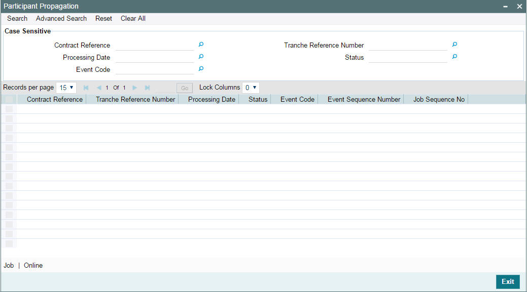

You can view the processing status of both borrower and the resultant participant contracts in the ‘JOB PROCESS STATUS’ screen. You can invoke the ‘Participant Exception Log’ screen by typing ‘LBDBPCNT’ in the field at the top right corner of the Application tool bar and clicking the adjoining arrow button.
This screen displays all the borrower side contracts (facility, tranche and drawdowns) and the corresponding participant contracts for each borrower side contract.
The following details are displayed for a borrower contracts:
The following details are displayed for a participant contract:
In addition, the ‘Borrower Contract Process Summary’ section of the screen displays the following details:
For each borrower contract, the above details are displayed for the corresponding participant contracts, in the ‘Participant Contract Process Summary’ section of the screen. You can double-click on any contract to view the contract details in the respective contract online screen.
Note
The system displays the processed contracts in ‘Green’ while the contracts that fail are displayed in ‘Red’.

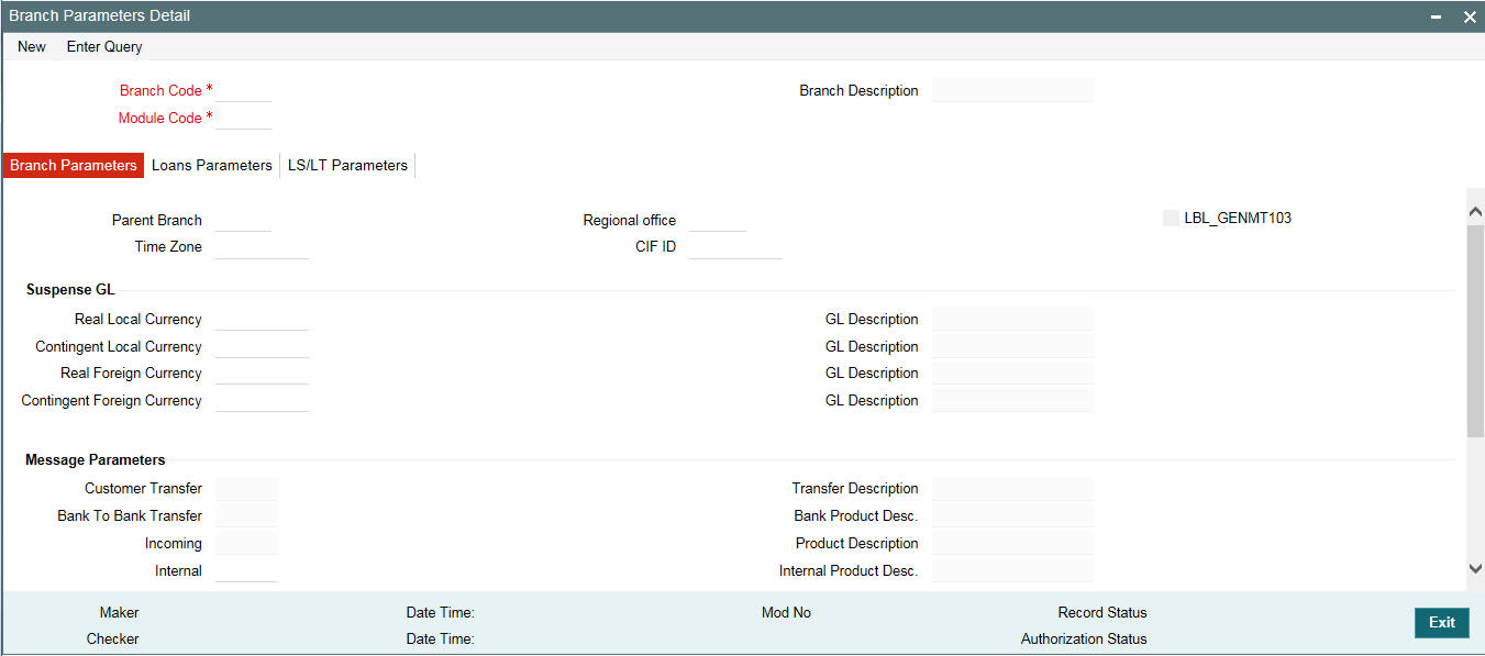

You have the option to reinitiate the ‘Background Job’ on an adhoc basis. This option is available only if the ‘Participant Process’ mode is set to ‘Job’. You have to specify this as part of defining parameters for your branch in the ‘Branch Parameters – Detail View’ screen.
For more details on maintaining branch parameters, refer the heading ‘Creating branches and maintaining branch level parameters’ in the ‘Branch Parameters’ chapter of the Core Services (CS) User Manual.
You can also use the reinitiate Background Job to process the failed
contracts after making the necessary corrections. To re-execute the job,
you have to click on the ‘Re-Run’
button in the ‘JOB PROCESS STATUS’ screen. The contracts
may be processed successfully.
You cannot use the reinitiate option if the ‘Participant Process’ mode is set to ‘Online’ for the branch.
You can waive late payment charge schedule(s) for a component using ‘LS Special Penalty Component Waiver’ screen.
You can invoke the ‘Special Penalty Waiver’ screen by typing ‘OLDPNWVR’ in the field at the top right corner of the Application tool bar and clicking the adjoining arrow button.
Specify the following details:
Contract Ref No
Specify the reference number of the contract for which the late payment charge schedules should be waived.
System displays the following details based on the specified contract reference number:
Penalty Comp
Select the penalty component from the adjoining option list. This list displays all the late payment charge schedules for the contract which are not fully paid of waived.
Due Date
System displays the due date for the penalty component selected. However, you can edit the due date.
System displays the following details based on the selected penalty component:
Remarks
Specify a brief description regarding the waiver for late payment charges for a schedule.
Waive
Select this check to indicate that the late payment charge schedule should be waived for a component. You can save the waiver operation only if the ‘Waive’ box is checked for all schedules.
You can waive a partially paid late payment charge schedule. In this case, the unpaid amount is treated as waived and the already paid amount is treated as settled. No further dues are tracked for this schedule.
Before allowing the waiver of each schedule, system checks that all preceding schedules have been paid or waived. If there are any unpaid schedules preceding this schedule, then system displays the following override message:
‘Prior schedules are unpaid for this component. Please pay/waive all such schedules before proceeding’
On waiving a late payment charge, the previously calculated charges are no longer be due.
The accounting entries are posted against the event ‘SPWV’ (Special Penalty Waiver). If multiple schedules are waived as part of the same waiver operation, then system triggers a single ‘SPWV’ event with separate accounting entries for each schedule. The accounting entries are posted for information and tracking purposes only.
You can reverse the waiver of late payment charges by selecting the original waiver record using the ‘Special Penalty Component Waiver Reversal’ screen. You can invoke this screen by clicking the ‘Reversal’ button in the ‘LS Special Penalty Component Waiver’ screen.
If multiple schedules are waived as part of the original waiver operation, then system allows you to select any or all of such waived schedules for waiver reversal and deselect the ‘Waive’ box. Reversal can be done only if the ‘Waive’ box is unchecked for at least one schedule.
System allows you to undo the waiver operation only if the basis component for the late payment schedule is unpaid/partially paid. If basis component for the late payment charge schedule is fully paid, then you cannot undo the waiver operation.
On waiver reversal, system re-computes late payment charges using values of basis component, grace days and late payment charge fixed rate/flat amount as on the current date. Calculation date is the original schedule due date.
Waiver reversal accounting entries are posted against the event ‘RSPW’ (Reversal of special penalty waiver). If waiver reversal of multiple schedules is performed simultaneously, then system triggers a single RSPW event with separate accounting entries for each schedule. The accounting entries are posted for information and tracking purposes only.
Accrual entries are not passed and late payment charges are booked to P&L only upon liquidation.
Note
At the loan product level, system validates to check that event ‘SPWV’ is mandatorily maintained for a component for which ‘Special Penalty Component’ is checked. System also validates to check that no accounting entries are maintained for the event ‘RSPW’ at the loan product level. System automatically associates the reversal event ‘RSPW’ for such products.
You can view current status of all unpaid late payment charge components for a contract using ‘Special Penalty Component Waiver Summary’ screen.
You can invoke the ‘Special Penalty Component Waiver Summary’ screen by typing ‘OLSPNWVR’ in the field at the top right corner of the Application tool bar and clicking the adjoining arrow button.
In this screen, you can view the following details:

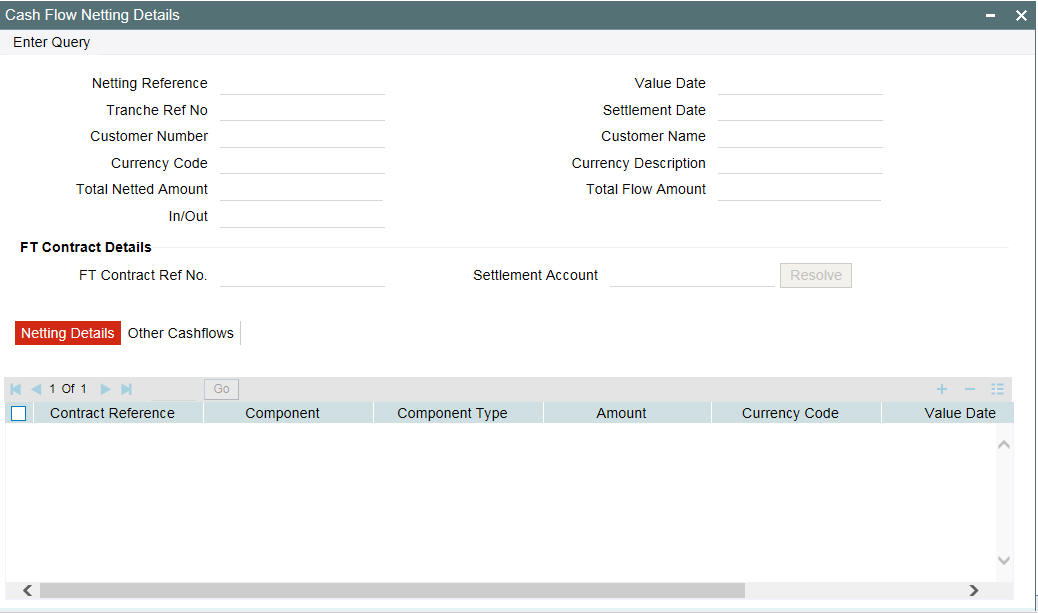

You can maintain netting preferences for borrowers and participants of a tranche in the ‘Borrower Details’ sub-screen and the ‘Participant Ratio Details’ sub-screen of the ‘LS Tranche Contract Online’ screen.
For a borrower, you can choose one of the following as the netting preference (in the ‘Borrower Details’ sub-screen of the ‘LB Tranche Contract Online’ screen):
Similarly, for a participant, the following options are available for netting (in the ‘Participant Ratio Details’ sub-screen of the ‘LB Tranche Contract Online’ screen):
You can view the borrower and participant side contracts for a tranche, for which netting is applicable, in the ‘Loans Syndication Netting Cash Flow Summary’ screen.
Netting takes place only if the following parameters for a cash flow are same:
In this screen, you can specify the following to view:
To net the components for a contract, select the contract from the summary screen and double-click on it. The ‘Cash Flow Netting Details’ (LBDNETCF) screen is displayed, as shown below:
You can view the following details in the ‘Netting Details’ tab of this screen:
The ‘Other Cashflows’ tab of the screen displays all contracts till date which need to be netted.
You can check the ‘Netted’ option for these contracts if you want to net them along with the current contracts.
After selecting the contracts for netting (in the ‘Netting Details’
tab of the screen), you have to click the
‘Resolve’ button to continue. If pending cashflows are present
in the ‘Other Cashflows’ tab, system will display a message
to indicate the same. The system will display a message to seek confirmation
to resolve the selected contracts. Select ‘OK’ in the message
window to continue.
If netting is successful, system will update the ‘FT Contract Details’ section of the screen with the following details:
You can also view the events and messages triggered for the contracts after netting the contracts. Click the ‘Events’ from LB Tranche Contract Online screen to view the events Click ‘Messages’ from ‘Events’ screen to view the messages.

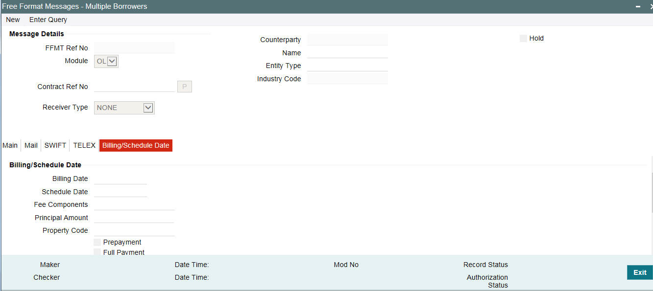

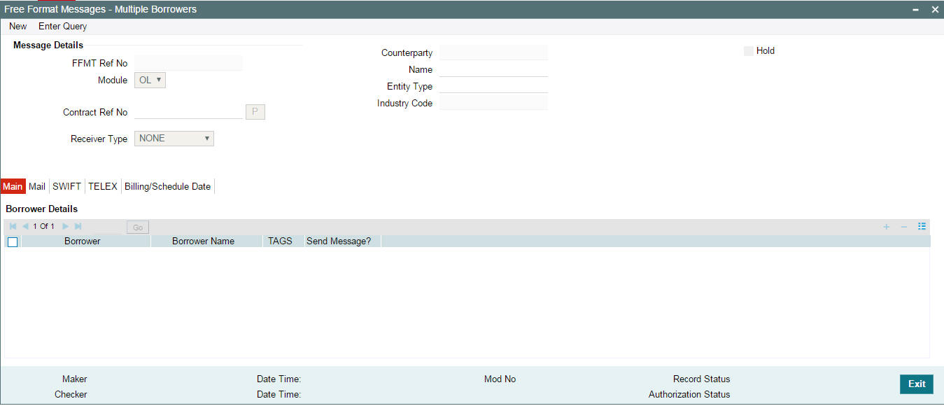

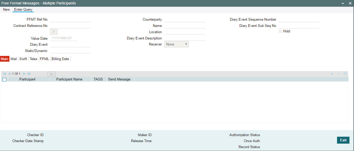

You can enable the system to generate free format messages with respect to loan syndication contracts, by using either of the following options:
You can generate free format for multiple participants or borrowers.
You can invoke the ‘Free format message’ screen by typing ‘OLDFFMSG’ in the field at the top right corner of the Application tool bar and clicking the adjoining arrow button.
Thereafter, select ‘New’ from the menu. The Free Format Message screen is displayed without any details. Alternatively, you can also select invoke this screen by clicking the ‘PartFFT in the ‘Contract Diary Event’ screen.
When you click on the ‘New’ button, system automatically generates a unique ‘FFMT Reference No’ for the free format message.
You have to specify the following in the ‘Message Details’ section of the screen:
Contract Ref No
Select the reference number of the loan syndication contract (facility/tranche/borrower) in respect of which you want to generate free format messages. Upon selection of the contract, system displays the counterparty code and name of the customer involved in the contract. The system also displays the names of participants involved in the contract.
Hold
You have the option to place the free format message on hold. To do this, check this option.
If you have indicated that messages should be generated on-line the free format message is displayed in the ‘Outgoing Message Browser’ once it is saved. You can generate it from the browser. If you indicate that the message should be put on hold, you first have to release the message before you generate it from the ‘Outgoing Message Browser’.
Receiver
You have to select the recipient of the message. The available options are:
Entity Type
If you select the receiver as ‘ENTITY TYPE’, you have to select the type here. The entity types defined for the participants are displayed in the option list. You can select the required type from this list.
The message is sent to only those entities of the selected entity type linked to participant at the facility level.
When you select a syndication contract, the associated participants gets displayed in the ‘Participant Details’ section of the screen. Here, you can select the participant(s) to whom you would like to send the free format message. To indicate you want to send a message to a participant, check ‘Send Message’ against the required participant(s).
By default all the participants are marked for sending the message. However, it is mandatory to capture the message that has to be sent in the ‘Message’ section at the bottom of the screen.
If you specify the ‘Receiver’ as ‘ENTITY’, the entities linked to each participant are displayed in the ‘Entity Details for Participant’ section of the screen. You can indicate the following for the entities:
Media
Indicate the media through which the free format message should be transmitted. The media through which you can channel a free format message depends on the media types that you have maintained for your branch in the ‘Media Maintenance’ screen. You can choose a media code from the option list that is available. For each customer, you can maintain a default media in the ‘Customer Address Maintenance’ screen. The default media is applicable for all the entities under that participant. Hence, you can send the message through different media for each participant simultaneously.
A participant entity for which ‘Send FPML’ option has been selected in ‘Customer Entity Details’ screen, will have the media defaulted as ‘FPML’.
Depending on the media selected, you can capture the message details in the ‘SWIFT’, ‘MAIL’ , ‘TELEX’ and ‘FpML’ tab of the screen.
Primary
By default, one of the entities are designated as the primary entity based on the specification for the participant. You can designate a different entity as the primary entity to receive the message.
Send Message
To instruct the system to send the free format message to the selected primary entity, you have to check the ‘Send Message’ option against the primary entity. However, if the participant of the entity is not marked for sending the message (the ‘Send Message’ option against the participant should be checked), you cannot send a message to the entity.
In this case, system displays the following message:
Since participant is not marked for sending the message, cannot mark entity/entity type for sending the message.
You have to indicate the type of free format message that has to be sent to the receiver. The available options are:
You can enter the free format message to be sent to the recipient in the ‘Message’ section of the screen. You have the option of using one of the templates that you have maintained in the ‘Message Format Template Maintenance’ screen. To do this, right-click on the screen. The following two choices appear:
Select the option ‘Template Code’.
You can select the template you would like to use. Upon selection of the template, the message is displayed in the box. You can amend the message that gets defaulted from the template. The code of the selected template is displayed in the ‘Template Code’ field.
Note
Although you are allowed to make changes to the message defaulted form the template, these changes does not affect the template itself. You can make changes to a template through the ‘Message Format Template Maintenance’ screen alone.
You can capture the details of messages in FpML format in the ‘FpML’ tab. For FpML messages, you need to select the message template in the ‘MAIL’ tab inititally. The FPML template to which the MAIL template is mapped gets automatically updated in the ‘FpML’ tab. This value also gets displayed in ‘FpML Template’ field.
Note
If a participant has only ‘FpML’ messages enabled, then you won’t be able to select the message template using ‘MAIL’ tab. In such cases you need to select the FpML template in ‘FpML’ tab.
The following options are available only if the ‘Message Type’ is ‘Custom’:
Related Event
You have to select the event for which the message should be generated. The events at the product level are displayed in the option list provided. Select an event from this list. When you select the event code, the description is displayed alongside.
If the Message Type is ‘Custom’, you can include free format message tags for the message, right-click on the ‘Message’ section of the screen.
When you select the ‘TAGS’ button, a list of pre-defined loan syndication module tags will be displayed as shown below:
From this list, you can select the required tags one by one, to be included in the message.
You can specify the message tag details for participants only if the following criteria are met:
You can specify the tag details in the ‘Participant TAG Details’ screen. Click the ‘Tags’ button to invoke this screen.
You can enter the values for the tags that you have already selected from the TAG List screen.
Note
Only those Tag IDs that you have defined for the Message Type ‘Custom’ in the ‘Free Format Message Tags’ screen is available for use.
If the ‘Message Type’ is ‘Custom, the screen appear, as shown below:
For a ‘Custom’ Message Type, you also have the following option:
After capturing the required message details, you can preview the message. To do this, click the ‘Message Preview’ button.
This screen displays the following details:
Through this screen, you also view the actual format of the message
that would be generated. To do this, click the ‘View Message’ button.
Note
In the free format messages for the primary entity, first line of the message will display the borrower/participant name and the second line displays the entity name. In the case of free format messages for non-primary entity, the first line of the message displays ‘Copy - Avoid Duplication’. The second line displays the borrower/participant name and the third line will display the entity name. These positions are fixed and you are allowed to change them.
To generate the ‘Custom’ message, click the ‘Generate’ button in the ‘Free Format Messages – Multiple Participants’ screen.
You can modify the advice details, if required. Click the ‘Ok’ button to generate the message.
After you opt to generate the message, you have the option to cancel the generation of the message. To do this, you have to click the ‘Undo Generate’ button in the ‘Free Format Messages – Multiple Participants’ screen.
Note
For entities having the media as ‘FPML’, FpML notices also get generated in addition to the MAIL notices.
While generating the free format messages for participant, If the ‘FpML Type’ option is checked for borrower tranche / drawdown then the system will do the following:
If the ‘FpML Type’ is not checked, then for free format message, the system does not check the media priority setup.

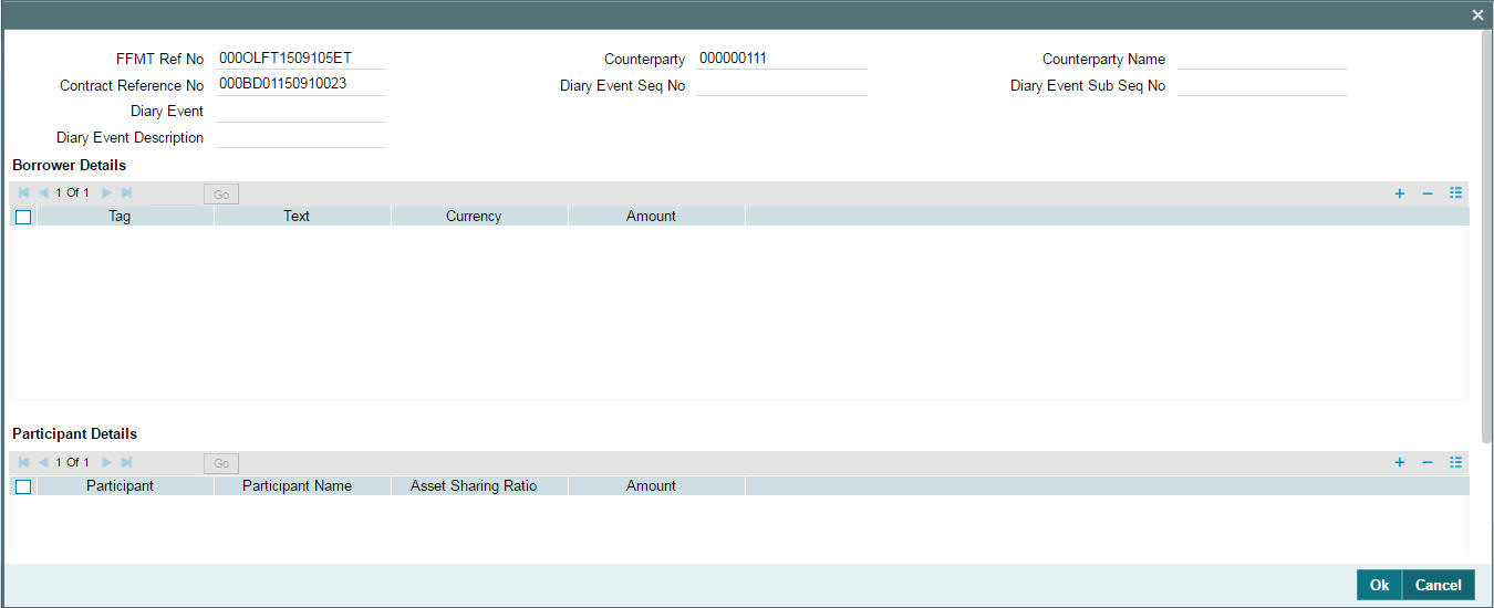

If you select the ‘Message Type’ as ‘ProRata’, you have to specify the pro-rata tag values. To do this, click the ‘Prorata Tag Values’ button in the ‘Free Format Messages – Multiple Participants’ screen. However, you can enter the tag values only if the message is specified in the ‘Message’ section of the screen. If not maintained, the system displays an override to indicate the same.
You can use a template to capture the message format. Refer the heading ‘Capturing the free format message’ in this chapter for details on the same.
When you right-click on the ‘Message’ section of the screen. When you select the ‘TAGS’ option, a list of pre-defined loan syndication module tags will be displayed as shown below:
You can select the required tags one by one, to be included in the message. After selecting the tags, you have to specify the values for the same.
Note
Only those Tag IDs that you have defined for the Message Type ‘ProRata’ in the Free Format Message Tags screen is available for use.
You can specify the tag values in the ‘ProRata TAG Values’ screen. To invoke this screen, click the ‘Prorata Tag Values’ button.
Specify the following details in the screen:
The system automatically computes the breakup details of the components for the participants based on the amount you enter and the asset sharing ratio. The following details are displayed in the ‘Participant Details’ section of the screen:
Click the
button to move from one
section of the screen to the other.
You can enable the system to generate a normal advice, as well as custom messages to borrowers through the ‘Free Format – Multiple Borrowers’ screen. You can invoke the ‘Free Format Messages - Multiple Borrowers’ screen by typing ‘OLDFFMBR’ in the field at the top right corner of the Application tool bar and clicking the adjoining arrow button.
The details to be captured for ‘Normal’ and ‘Custom’ message types are as explained under ‘Generating Free Format Messages for multiple participants’, the only difference being that you will be capturing the details for ‘Borrowers’ this time. In addition, you have to select the following:
Module
You have to select the module for which the free format message details are being captured. The available options are:
Select ‘LS’ (Loans Syndication) option here to indicate that the messages are being maintained for loan syndication contracts. When a free format message specification is authorized, the pre-defined event for free format messages (ZFFT) is triggered for the contract. The pre-defined tags available for the Loan Syndication module are:
You can specify the billing date in the ‘Billing Date’ screen. You can invoke this screen by clicking the ’Billing/Schedule Date’ in the ‘Free Format Messages – Multiple Borrowers’ screen.
Billing Date
Specify the date on which the free format message needs to be generated.
Cash Interest Amount
Specify the cash interest amount. If cash interest amount is not zero, then it is mandatory to input cash interest amount at participant level.

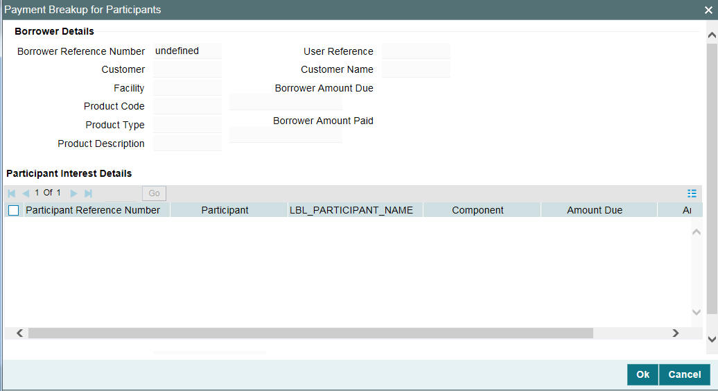

Click ‘Part Int share’ button to invoke the screen, ‘Payment Breakup for Participants’(LBDPYMNT) with details of all the participants under the drawdown and outstanding interest (Cash Interest) for each participant under the field ‘Amount Due’.
Refer the section, ‘Specifying Payment Breakup for Participants’ in the Repay Chapter
for more details.
Amount Paid
Specify the individual participant share amount for the interest being paid.
Existing participant free format advices having interest payment details can include cash interest payment that is captured by user during free format message generation (for interest liquidation and principal + interest liquidation).
Rollover notification advices that are generated systematically during rollover booking, can include cash interest payment that is captured by user during rollover booking (for interest liquidation and principal + interest liquidation).
Specify the proper cash amount for borrower and participant during free format message generation and payment should be processed for the same amount which is operationally controlled by user.

You can invoke the ‘Payment Processing Browser’ screen by typing ‘LBDMTPRC’ in the field at the top right corner of the Application tool bar and clicking the adjoining arrow button.
You can specify the following fields in this screen:
Contract Reference Number
Specify the borrower contract reference number to capture the fronting/funding details for the disbursement/payment activities of the contract.
The system displays the event wise borrower details for the disbursement and payment events in the Borrower Details frame of this screen.
Borrower Fronting
Select the fronting for the borrower, in case of payment activities, from the following options.
Investor Fronting
Select the fronting for the investor, in case of disbursement activities, from the following options.
Actual Receipt Date
The date on which the borrower is funding for the payment is displayed in this field; however, you can choose to modify this date.
Note
Funds Sighted
Select ‘Yes’ if the fund is sighted for the borrower repayment; otherwise, select ‘No’.
The following fields are displayed in this screen.
Eventwise Fronting Details
You can capture the investor fronting details for each event in this frame.
Default Investor Fronting

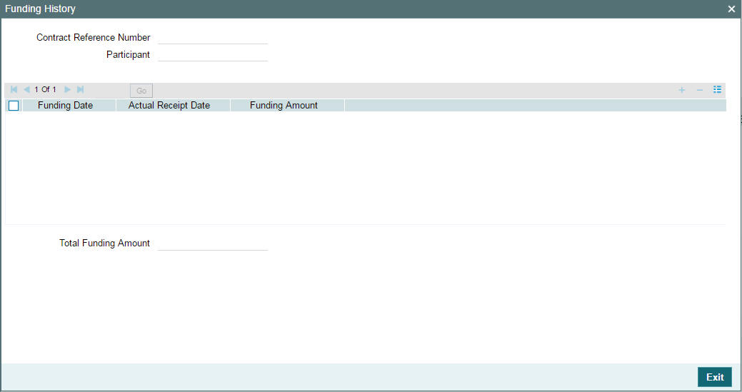

Click ‘Funding History’ to display the funding history for the chosen investor in the ‘Funding History’ screen.

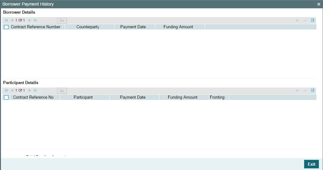

Click ‘Borrower Payment History’ to display the borrower payment details for the chosen borrower contract for the past disbursement events based on investor funding.
The following fields are displayed in this screen:
On authorization of disbursement events, the system defaults the Payment Processing Browser with the following values:
You have to capture the Fronting Details of Borrower and Participants before proceeding with any other activity. You can query for the borrower contract and unlock it to capture the Fronting and Funding details.
Investor Fronting field in borrower details has the options, Fronting All, Fronting Partial and No Fronting for Disbursement Events. Borrower fronting flag is not applicable for disbursement events. Payment date, funds sighted flag and actual receipt date in Borrower details is not applicable for Borrower disbursements
Default Investor fronting flag is enabled only if investor fronting is selected as ‘Fronting partial’ in the borrower details. It have the three options, Fronting, Seek Approval and No Fronting
Fronting flag is enabled for Disbursement events and it will have the three options, Fronting, Seek Approval and No Fronting.

You can view the funding details for each investor by clicking ‘Funding History’ in the Investor

You can maintain settlement instructions in the Settlement Instruction Maintenance screen.
You can invoke the ‘Settlement Instructions Maintenance’ screen by typing ‘LBDINSTR’ in the field at the top right corner of the Application tool bar and clicking the adjoining arrow button.

You can capture the basic details of brokers with whom your bank deals with in the ‘Broker Maintenance Detail’ screen. In this screen, you can specify the following:
You can invoke the ‘Broker Maintenance Detail’ screen by typing ‘BKDMASTE’ in the field at the top right corner of the Application tool bar and clicking the adjoining arrow button.
Note
In case of data masking, if ‘PII Allowed’ check box is not selected in ‘User Maintenance screen’, then ‘Name’, ’Street’, ‘City’ and ‘Country’ field value is masked. For more information, refer to Common Core - Security Management System User Guide.

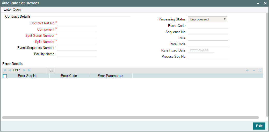

You can invoke the ‘Auto Rate Set Browser’ screen by typing ‘LBDRSBRW’ in the field at the top right corner of the Application tool bar and clicking the adjoining arrow button.
The system automatically process the rate set events for the following events on authorizing the following operations:
While authorizing the future dated transactions, the Rate set browser gets populated with future dated event details with processing status as ‘Unprocessed’.On the Rate Fixing Date, the Rate set event gets processed and the processing status is updated as ‘Processed’/’Failed’ based on the event processing.
If the Rate Set Event is successfully processed, then
The IRAM/ROIX/CRIX/SPIX event is auto authorized if the flag Auto auth Rate fixing events is checked.
The IRAM/ROIX/CRIX/SPIX event is not authorized if the flag Auto auth Rate fixing events is not checked. User have to manually authorize the event
If the Rate Set Event processing is failed, then
The Re-processed event have maker/checker id as below
If Auto Auth Rate Fixing event is Yes, then the User id of who is reprocessing the event is displayed as Maker/Checker ids
If Auto Auth Rate Fixing event is No, then the User id of who is reprocessing the event is displayed as Maker id. Checker will be the approver id
For example,
The USER1 books future dated drawdown and USER2 approves it. On authorization of the future dated drawdown, rate set browser is populated with below details:
If the Rate fixing event is processed automatically on the rate fixing date, below details are updated for the drawdown ref no. and for the main interest combination
The IRAM gets authorized when the flag ‘Auto auth Rate fixing events’ is checked. Else IRAM gets unauthorized and checker id is blank in this case.
In the above example, the USER1 is allowed to delete the unauthorized IRAM event from Interest Rate Fixing Screen when the flag ‘Auto auth Rate fixing events’ is not checked.
Note that on click of ‘Select All’ checkbox. all the unprocessed or Failed records are selected and user is allowed to reprocess all the selected records
You are not allowed to amend the fields in the browser, except the check box to select the event for reprocessing
All the processed records are removed from the browser to history data store. This is a daily activity which is done as part of End of Day process

Split Rollover (LBCSPROL)
In Split Rollover screen, the ‘Rate Fixing Days’ is defaulted from the ‘Interest Limits Detail’ screen.
