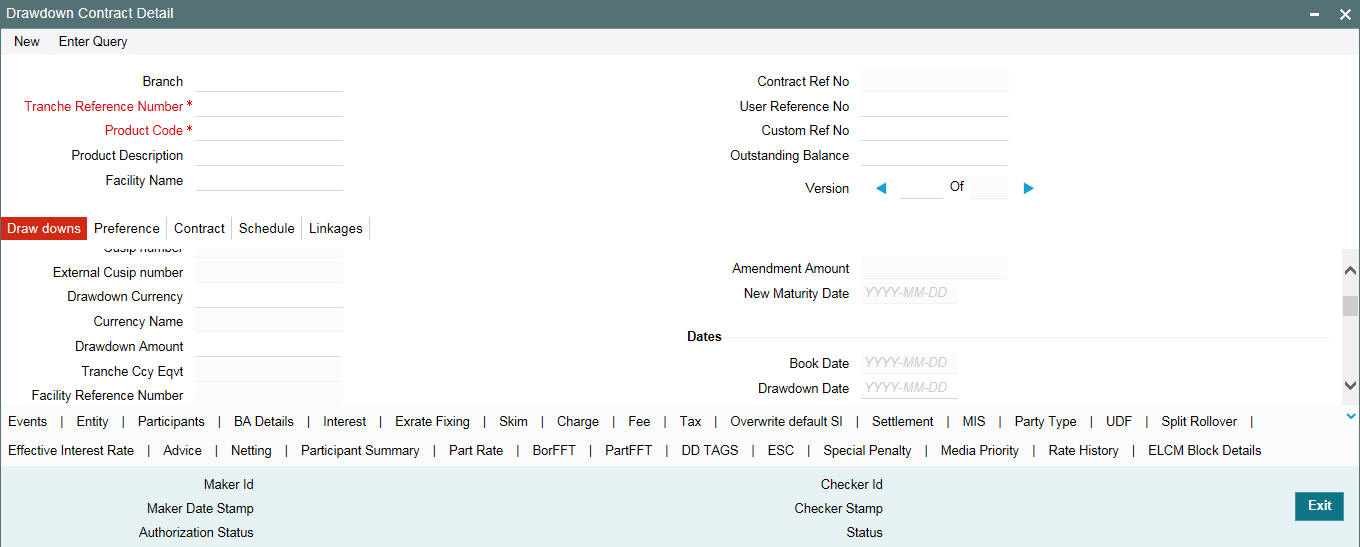

You can capture Drawdown contract details in the in the ‘DRAWDOWN’ tab of the ‘Drawdown Contract Online’ screen.
You can invoke the ‘Drawdown Contract Online’ screen by typing ‘LBDDDONL’ in the field at the top right corner of the Application tool bar and clicking the adjoining arrow button.
Special Amount
Specify the special amount for swing line draw down, in case you want to do a special swing line disbursement.
Note
The value of the special amount can be positive or negative or it can be zero.

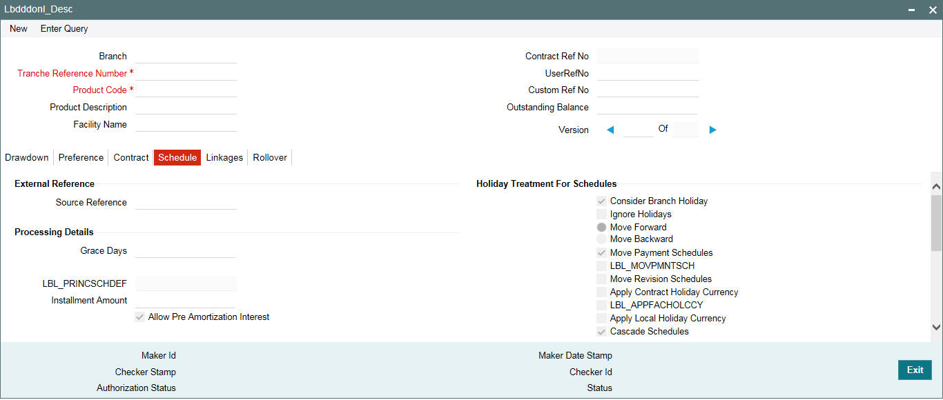

Schedule dates for a drawdown could fall on holidays defined for your branch or on holidays defined for the drawdown currency. In addition, schedules may also fall due on the other currencies, as per your specification in the ‘SCHEDULE’ tab of the ‘Drawdown Contract Online’ screen.
In the Product Preferences for the borrower facility product, you can specify whether the system should check for schedule dates falling on holidays, and how such schedule dates must be handled. These specifications would default to any borrower facility using the product. It will also default to underlying borrower tranches or drawdowns that are opened under the facility if you specify the ‘Holiday Default Basis’ as ‘Facility’ when maintaining a Borrower/Tranche product (in the ‘Additional Preferences for Loans Syndication’ screen).
You can specify that any of the following:
You can specify the holiday treatment type for schedules falling due on holidays in the ‘Holiday Treatment for Schedule’ section of the ‘SCHEDULE’ tab of the ‘Drawdown Contract Online’ screen. The Holiday Treatment Type is the parameter that defines how the system checks for schedule dates falling on holidays. You can specify one of the following options:
Ignore Holidays
You have to check this option to instruct the system to ignore the holiday. Payment schedules are processed as per the due date even if the schedule falls due on a holiday.
Include Branch Holiday
Select this option to indicate that you want the system to check whether a schedule date falls on a local holiday defined for the branch.
The system checks the holiday table for your branch. If it encounters a contract entered in your branch, with a schedule date falling on a branch holiday, the holiday is handled according to the holiday-handling preferences you specify.
Holiday Currency
You can also select a currency for the holiday check. The system checks the holiday calendar maintained for the selected currency before arriving at the schedule due date.
The system checks the holiday table for the currencies you have specified. If it encounters a contract using any of the specified currencies, with a schedule date falling on a holiday for any of the currencies, the holiday is handled according to the holiday-handling preferences you specify.
Move Backward or Forward
You can indicate whether the schedule date falling on a holiday must be moved forward to the next working day, or backward to the previous working day.
Move Across Months
If you have indicated either ‘Forward’ or ‘Backward’ movement of a schedule date falling due on a holiday, and the moved schedule date crosses over into a different month, you can indicate whether such movement is allowable; it is allowable only if you check this option.
Cascade Schedules
If one schedule has been moved backward or forward in view of a holiday, cascading schedules would mean that the other schedules are accordingly shifted. If you do not want to cascade schedules, then only the schedule falling on a holiday is shifted, as specified. The other schedules remain unaltered.
Move Payment Schedules
You may check this option to indicate that the holiday processing rule should be applied on repayment schedules as well. This is applicable only to drawdown products.
Move Revision Schedules
You may check this option to indicate that the holiday processing rule should be applied to interest rate revision schedules as well.
Use Tranche Currency
If you choose this option, the system checks whether the schedule date falls on a holiday defined for the currency of the tranche (borrower), if this currency is different from the holiday currency you have indicated.
Use Contract Currency
If you choose this option, the system checks whether the schedule date falls on a holiday defined for the currency of the drawdown contract, if this currency is different from both the holiday currency and the facility currency (if any) you have indicated.
Use Local Currency
If you choose this option, the system checks whether the schedule date falls on a holiday defined for the local currency, if this currency is different from the holiday currency, facility currency and contract currency you have indicated.

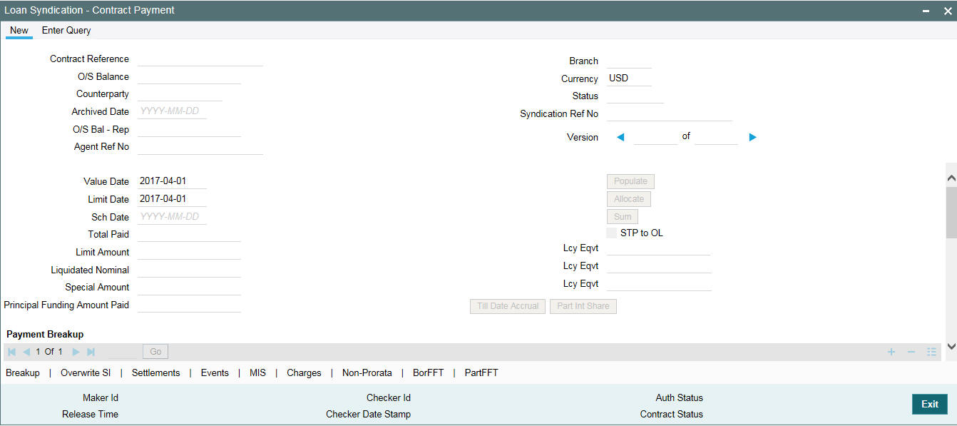

You process payments through the ‘Contract Payment’ screen.
You can invoke the ‘Loan Syndication - Contract Payment’ screen by typing ‘LBDPYMNT’ in the field at the top right corner of the Application tool bar and clicking the adjoining arrow button.
The manner in which you perform manual liquidation for a drawdown in the ‘Contract Payment’ screen is the same as for a normal loan contract.
Special Amount
Specify the special amount in case you want to do a special payment or to facilitate the special amount disbursal. The value of the special amount can be positive or negative or it can be zero. You are allowed to make special payment even for future value dated payments.
Note
Principal Funding Amount paid
Specify the principal (funded) amount to be liquidated.
Based on this amount and the total funded amount for the contract, the system arrives at the actual amount to be liquidated. This actual amount is used for the subsequent payment processing.
Example
The logic to arrive at the actual amount for which the payment is being processed has been explained below:
Consider a contract booked with amount of 2M with participants P1, P2, and P3 having asset sharing ratios as 30, 20 and 50 respectively.

Total funded amount for the contract is 1.4 M and Total unfunded amount for the contract is 0.6 M
For a borrower repayment of 1M, 1M should be entered in the new field ‘Funding amount paid’ in the manual payment screen.
Actual amount to be liquidated = Funding amount paid * Contract Outstanding amount /Total Funded amount
In this case, actual amount = (1M * 2M) / 1.4M = 1,428,571.43M
This amount is used for all the subsequent payment processing.

Tranche Repayment Rule
Select the redefinition rule for tranche repayment schedule applicable for the prepayment amount. The possible options are LIFO, FIFO, and PRO-RATA.
At the time of manual payment of schedules, a borrower may want to prepay a part of the payment to the participants involved in the drawdown. Occasionally, in such a scenario, one or more participants may refuse to accept the prepayment.
Hence, the prepaid amount have to be:
If the prepaid amount is distributed among the remaining participants, the asset sharing ratio at the drawdown level need to be modified. This in turn affect the availability amount at the tranche level. This is applicable only if the tranche is of revolving type.
If payment is done without sending the participant faxes system displays the following override message:
Participant Share amount not matching with the fax send. Do you want to continue?
Click ‘OK’ to proceed with the repayment. On authorization of the contract the following error message will be displayed:
Contract authorization possible only after authorizing the overrides
You are allowed to authorize the repayment of the contract only if you authorize the override in the ‘Credit Authorization Outstanding’ screen.
After specifying the Limit Date and Value Date, click ‘Pop till Dt Accrual’ and the following details get displayed. The system displays the interest amount accrued till the least of value date and limit date in the ‘Amount Due’ column. Only main interest component is displayed in the ‘Payment Breakup’ screen.
Note
Principal and non main interest components cannot be paid along with main interest component when this button is pressed. You can specify the borrower ‘Amount Paid’ which can be lesser than or equal to the ‘Amount Due’.

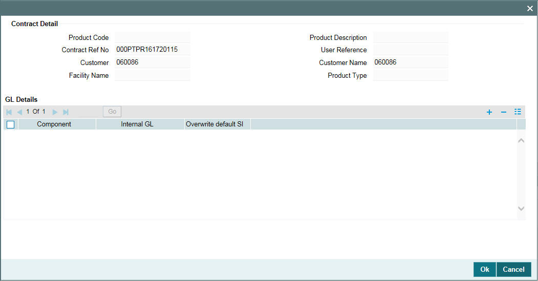

You can maintain settlement instructions for various components such
as fees, charges, tax, principal, interest, and so on, using the ‘Overwrite
Settlement Instruction Details’ screen. Using this screen, you
can post liquidation entries into an Internal GL account instead of the
customer account at the time of rollover. Click ‘Overwrite SI’ in the ‘Loan Syndication - Contract
Payment’ screen to invoke the following:
Component
This screen displays the all the components displayed in the Settlement Message Details screen that is, fees, charges, principal, interest, and so on.
Internal GL
Specify the Internal GL accounts into which you want to post the liquidation entries for the components.
Overwrite Default Settlement Instruction
Select the ‘Overwrite default settlement instruction’ box to confirm that the liquidation entries should be posted into the Internal GL account. System posts the entries to the Internal GLs only if you check this box. Otherwise, the system posts the entries as per the settlement instructions specified for the component of the contract.
Note
You can maintain the Internal GL account anytime during the life cycle of the contract.

Selection’ screen that is displayed, the names of all the participants
of the drawdown are listed. Select the participants you want to include
for payment processing. Click ‘Ok’ button to save the details and return to the ‘Participant
Ratio Details’ screen. The system displays the selected participants’
names and the relative payment distribution ratio (in the ‘Component
Ratio’ field of the screen) arrived at based on the asset sharing
ratio of each participant. You cannot amend the ratio that is displayed
here.
Click ‘Ok’ button to return to the ‘Contract Payment’ screen. In this screen, you have to specify the ‘Amount Paid’ which is distributed amongst the selected participants as per the relative distribution ratio.
