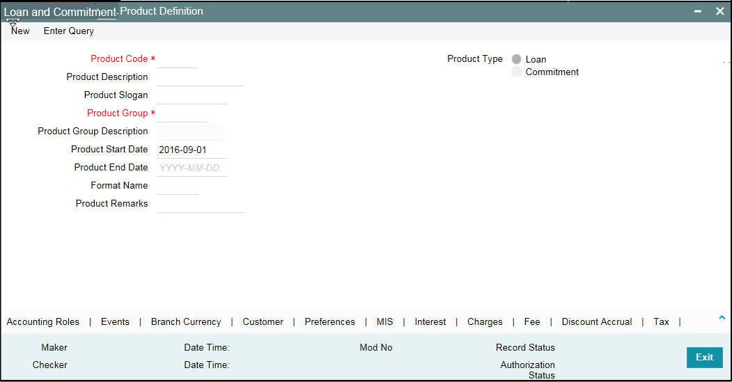

2.2 Creating a Product
In the Product Definition screen of every module, you can enter basic information about a product such as the Product Code, the Description, and so on. The Product Definition screens of the various modules of Oracle Lending are invoked from the Application Browser.
You can invoke the ‘Loans and Commitment Product Definition’ screen by typing ‘OLDPRMNT’ in the field at the top right corner of the Application tool bar and clicking the adjoining arrow button.
Note
Product Definition screen is specific to a module. To create an LD product, for an instance, invoke the ‘Loans and Commitment Product Definition’ screen from the Application Brows­er. Similarly, to create an LS product, invoke the LS Product Definition screen from the Ap­plication Browser.
In a Product Definition screen, you should specify the following details for the products you create:

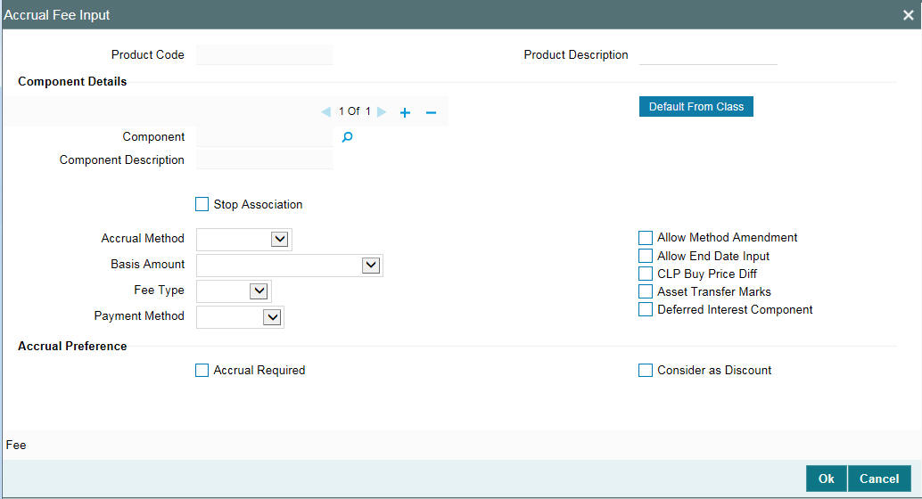

2.6 Associating the Fee Component with a product
In Oracle Lending, you have the option to collect and accrue a certain amount as fee, upfront at the time of booking a contract. These are the steps involved in processing contracts in Oracle Lending, for which the fee components need to be accrued:
After defining a fee component, you need to link the fee component to a product in Oracle Lending. Consequently, you can collect and accrue fees on all contracts associated with that product.
Click ‘Fees’ in the ‘Loans and Commitment Product Definition’ screen of the (for which the fee accrual functionality is applicable) to invoke the ’Fee Details’ screen to link the fee components to a product.
For details relating to upfront fee collection, refer the Processing Upfront Fee Collection and Accruals section in the relevant modules.
For more information about fee component, refer to the Charges and Fees User Manual.

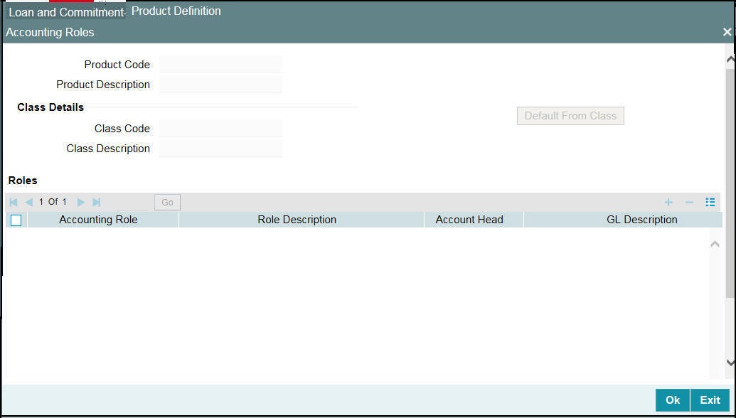

Before you define the accounting details for a product, you should define the various components of the contracts involving the product such as interest, charges, tax, and so on.
In the ‘Accounting Roles’ screen, a list of accounting roles are automatically generated based on the components you define for the product. You should map all the accounting roles that are available with the appropriate accounting heads.
You can invoke the ‘Accounting Roles’ screen by clicking ‘Accounting Roles’ in the ‘Loans and Commitment Product Definition’ screen.
Adopting either of the following procedures, you can specify the accounting roles and heads for a product:
Using a Class
Click Default From Class’ in the ‘Accounting Roles’ screen to associate the product you are maintaining with a class of mapped roles and heads. A list of the classes that you have defined specifically for the module is displayed. Choose a class with the requisite accounting heads and roles mapped.
The procedure for setting up an Accounting Roles to Head Mapping classes is similar to mapping accounting roles and accounting heads specifically for a product.
Mapping Accounting Roles to Heads specifically for a product
If you do not use a class to define accounting role and heads for a product, in this screen, you can define them specifically for the product you are creating.
  1. In the ‘Accounting Role’ column, click and then click to select an Accounting Role from the drop-down list .
  2. In the ‘Account Head’ column, clickand select an accounting head from the drop-down list that is displayed.
  3. Click ‘Ok’ to map the role with the corresponding head in the Accounting Head column.

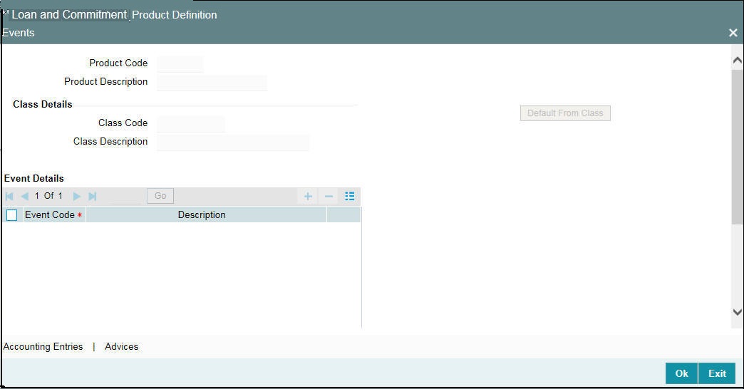

2.7.2 Specifying Events and Accounting Entries
A contract goes through different stages in its life cycle. In Oracle Lending, the different stages a contract passes through in its life cycle are referred to as “events”.
At an event, typically, if you want to post the accounting entries to the appropriate account heads and generate the required advices. When setting up a product, you can define the accounting entries that have to be posted and the advices that have to be generated at the various events in the life cycle of contracts involving the product. To do this, click ‘Events’ in the ‘Loans and Commitment Product Definition’ screen.
The ‘Events’ screen is displayed.
You can define the accounting entries and advices for events using either of the following methods:
2.7.2.1 Defining transaction types for reversal
You can invoke the ‘Reversal Type Maintenance’ screen by typing ‘OLDREVTP‘ in the field at the top right corner of the Application tool bar and clicking the adjoining arrow button.
In this screen to capture the list of allowed transaction types for the product in case of a reversal.
After you invoke this screen, you can associate new transaction codes for each transaction type. During reversal of events, the system replaces the old transaction codes with the corresponding (new) transaction codes. In case no new transaction codes are associated for the old transaction code, the entries are passed with the old transaction code.
2.7.2.2 Using a class
Click ‘Default From Class’ in this screen to associate the product you are maintaining with an Events class. A list of the Events classes that you have defined specifically for the module is displayed. Choose a class with the requisite events and accounting details maintained. The product acquires the accounting entries and advices defined for the Events class you choose.
The procedure for setting up an Events class is similar to defining events and accounting details for a product.
2.7.2.3 Defining Events and Accounting Details specifically for a Product
If you do not use an events class, you should define event details specifically for the product.
Click ‘Add row’ to invoke a list of events pertaining to the module. Select an event from the list by double-clicking on it.

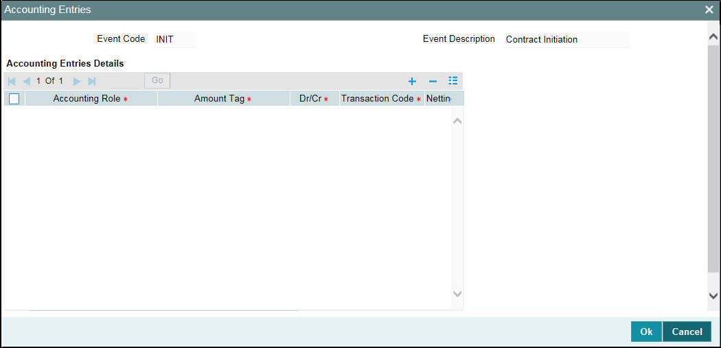

For every event you select, you should specify the accounting entries that should be passed and the advices that should be generated.
Click ‘Accounting Entries’ in the ‘Events’ screen to specify the accounting applicable to the event.
For an each event, you have to maintain the following accounting entries information.
Specifying the Accounting Role
Specify the accounting role that should be used at the event. The drop-down list displays all the accounting roles specified for the product in the Accounting Role Definition screen.
Specifying the Amount Tag
Specify the tag, which identifies the component that has to be posted to the account head.
Indicating a debit or credit
Indicate whether the accounting role you specified is for the debit or credit leg of the contract event.
Indicating the Transaction Code
Every accounting entry in Oracle Lending is associated with a Transaction Code that describes the nature of the entry. Specify the transaction code that should be used to post the accounting entry to the account head.
Indicating if accounting entries can be netted
Specify whether accounting entries should be netted at an event. You can net the accounting entries that are generated at an event if the set of entries satisfy the following criteria:
If you want a particular leg of an accounting entry to be considered for netting (subject to the above criteria), select ‘Yes’ from the drop-down list in the Netting field against this leg.
You should define details for both the legs of an accounting entry. For each accounting entry, you should specify the details of the debit and the credit leg. Thus, the first two specifications are for one entry, the next two for another, and so on. The Transaction Code for the entry should be specified for both legs of the entries.
This netting of accounting entries is only for processing and not for message generation.
Netting outgoing payment instructions
You can net multiple entries posted into the same account for processing. Independent of this, you can net entries posted into the same account with a view to sending out netted payment instruction messages.
If you want a particular leg of an accounting entry to be considered for netting for messaging purpose, select ‘Yes’ from the drop-down list in the Msg Netting field against this leg.
For sending out payment instructions, the system identifies the netted amount based on entries in the Msg Netting field, and not based on entries in the Netting field. Therefore, you can specify an accounting entry to be considered for Msg Netting and not for Netting.
The validation criteria mentioned for the Netting field is same for the Msg Netting field also.

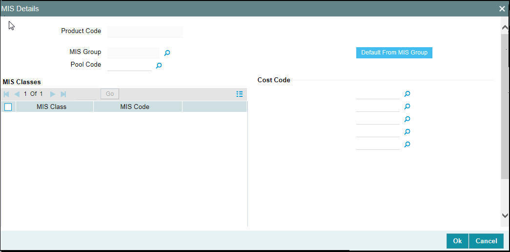

MIS Head
The MIS details for the online revaluation leg are taken from the MIS group maintained at the revaluation setup. Enabling online revaluation of GLs.
Online Revaluation refers to revaluation done on transaction amounts during transaction posting, and not as part of an end-of-day process. You can choose for online revaluation by selecting the ‘Revaluation Required’ option at the product event accounting entry maintenance for each accounting entry.
The Revaluation profit /loss is booked to the Online Profit GL or Online Loss GL that you have maintained in the revaluation set-up for the GL being revalued. If you have maintained no specific setup for the GL, then the profit/ loss is booked to the respective Profit or Loss GLs mentioned below:

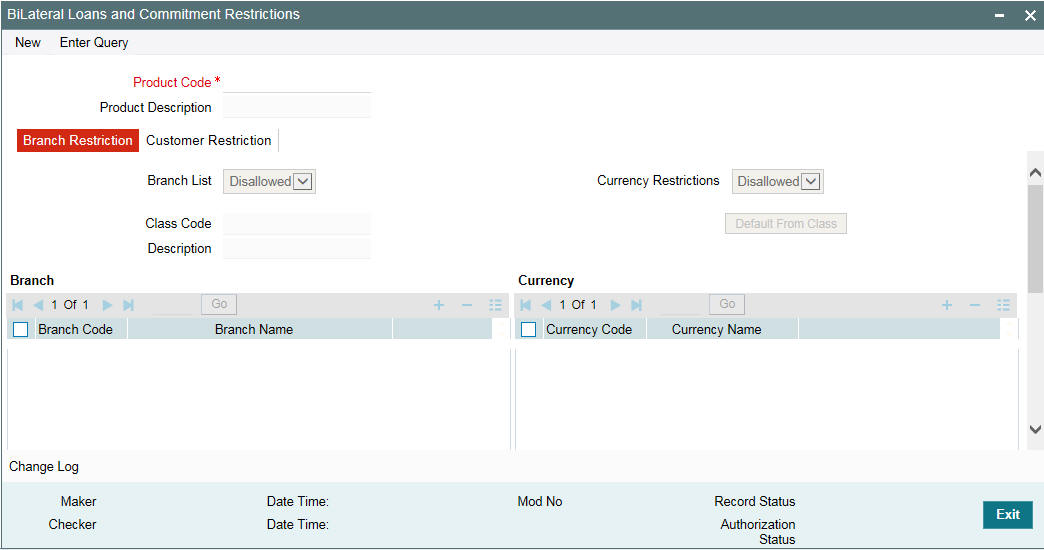

2.8 Specifying Branch, Currency, and Customer Restric­tions
From the head office of your bank, you may want to establish certain controls or standardize operations across the branches of your bank. For instance, you may want to restrict the products you offer to select branches and currencies, or allow specific branches to offer products only to a specific set of customers. You can achieve these controls by maintaining restriction lists when creating a product. When you create a product, you can specify the branches of your bank that can offer it, the currencies that are allowed or disallowed for it, and the customers who can avail it.
Note
When you create a product, it is, by default, available to all the branches of your bank, in all currencies, and for all customers.

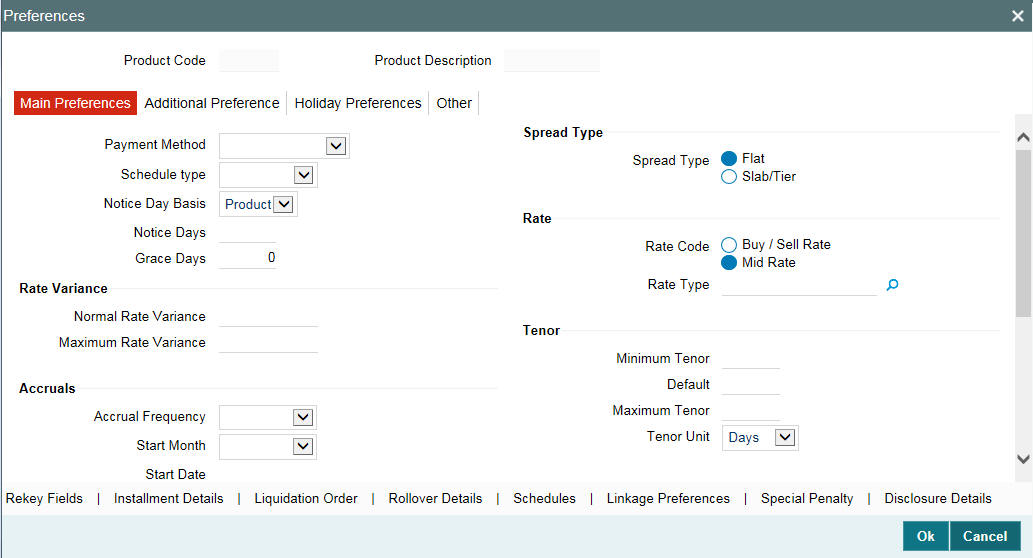

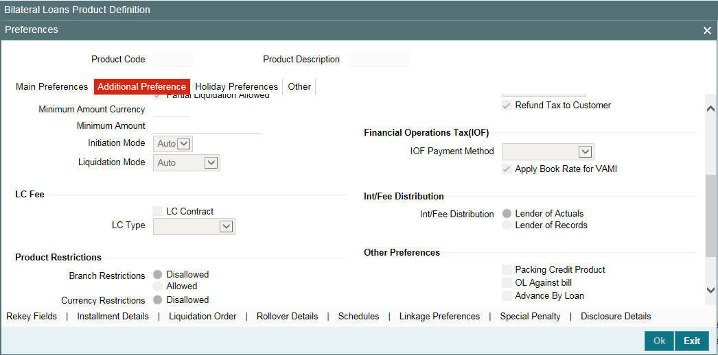

2.8.1 Specifying Product Preferences
‘Preferences’ are options that you can choose to give shape to a product. You can specify your preferences for the products you create in the Product Preferences screens of the respective modules. Click ‘Preferences’ in the ‘Loans and Commitment Product Definition’ screen to invoke the Product Preferences screen.
2.8.1.1 Maintaining Financial Operation Tax
IOF Payment Method
You can either select ‘Advance Payment’, ‘Capitalization’ from the drop-down list. By default, nothing is selected.
If you have selected ‘Advance Payment’ option, then IOF is collected upfront when loan is disbursed.
If you have selected ‘Capitalization’ option, then IOF is capitalized along with the principal amount.
Note
Apply Book Rate for VAMI
If this check box is selected, then contract booking rate it taken instead of VAMI maintained rate.
For more information about Financial Operation Tax, refer to Bilateral Loans User Manual.
2.8.1.2 Defining Branch and Currency Restrictions specifically for a product
If you do not use a class to indicate branch and currency restrictions, you should define these restrictions specifically for the product in the ‘Product Preferences’ screen.
You can indicate whether you are maintaining an allowed or a disallowed list type by choosing the appropriate option. You can select either ‘Allowed’ or Disallowed’ option. These values are defaulted to the ‘Bilateral Loans and Commitment Restrictions’ screen.

2.8.2 Maintaining Branch and Currency Restrictions
You can maintain a list of allowed/disallowed branches and currencies in ‘Bilateral Loans and Commitment Restrictions’ screen.
You can invoke the ‘Bilateral Loans and Commitment Restrictions’ screen by typing ‘OLDPRDRS’ in the field at the top right corner of the Application tool bar and clicking the adjoining arrow button.
When defining a product, you can choose to specify Branch and Currency, and Customer Restrictions either by:
2.8.2.1 Using a Branch and Currency Restrictions Class
In Oracle Lending, you can define a set of branch and currency restrictions as a Branch and Currency Restrictions Class. You can maintain several restriction classes of branches and currencies.
When creating a product, you can associate it with a branch and currency restrictions class that best suits your requirement.
The manner of creating a branch and currency restrictions class is similar to defining Branch and Currency Restrictions specifically for a product.
If you want to associate a branch and currency restrictions class to a product, click ‘Default From Class’ in the ‘Bilateral Loans and Commitment Restrictions’ screen. The product acquires the restrictions defined for the class.
2.8.2.2 Defining Branch and Currency Restrictions specifically for a product
Branch List and Currency Restrictions
The ‘Branch List’ and ‘Currency Restrictions’ values are defaulted from the ‘Product Definition’ screen. You are not allowed to modify these values.
Branch and Currency section
You can specify branch and currency restrictions in the form of allowed lists or disallowed lists.
If you have selected ‘Allowed’ in ‘Product Definition’ screen, the product can only be offered in those branches and currencies that are part of the respective allowed lists. On the other hand, if you have selected ‘Disallowed’ lists, the product cannot be offered by the branches and currencies on the respective disallowed lists.
If you choose to maintain an allow/disallow list of branches, the column would display the branches that you opt to allow/disallow respectively.
The branch and currency codes of all the branches and currencies maintained at your bank are displayed. Using the ‘Add Row’ or ‘Delete Row’ buttons, you can modify a branch or currency to the corresponding allowed/disallowed column that you have maintained.
Example
You have a network of twenty branches. You want to exclude six branches from dealing in loans You want all other branches to deal in loans.
Since there are more branches that can offer the facility than those that cannot, you can choose to maintain a disallowed list, and include the six disallowed branches in it.
Confirming your specifications
After you maintain branch and currency restrictions for a product, click ‘Ok’ to confirm your specifications. Click ‘Exit’ to delete your specifications.

2.9 Specifying MIS Details for a Product
Click ‘MIS’ in the ‘Loans and Commitment Product Definition’ screen to define the MIS details for the product you are creating.
In this screen, you should capture the following MIS details for a product.
You can link a product to an MIS Group. (If you do not want to link a product to an MIS Group, you can define the individual entities under which the product should be reviewed). If you link the product to an MIS Group, the entities defined for the group is displayed; you can change these entities. For a product, only the transaction type of MIS Class applies. The specific MIS entity (in the form of an MIS Code) is picked up, by default, only if you have defined them for the group. If not, you have to indicate the appropriate MIS code for each applicable MIS class.
If an MIS Group is linked, you can indicate whether the linkage with the group should always be maintained. If so, any change done to the MIS Group is automatically be applied to the product. If not, the entities defaulted for the product is continued even if they are changed subsequently for the group.
The details defined for the product is picked up for the contracts processed under it.
The Pool Code to which the product belongs should be defined.
Note
You need to maintain ‘Ref Rate Code’, ‘Fixed Rate Type’, ‘Fixed Rate Code’ in Bilateral Loans Product Definition- MIS’ screen and the same rate codes are defaulted to Loan and Commitment-Contract Input -MIS screen. Based on these rates, ‘Refinance Rate’ will be fetched from the ‘Treasury Floating Rate Maintenance’ screen.
Identifying the Operations MIS Group
While performing revaluation you have apportion the profits between the treasury and the respective Operations department in your bank. This internal apportioning of profits requires an Operations MIS Group to be specified at the product level.
For more information, refer to the MIS and Core Services User Manuals.

2.13 Specifying accrual fee details of a product
After defining a fee component, you need to link the fee component to a product in Oracle Lending. Click ‘Accrual Fee Details’ in the ‘Loans and Commitment Product Definition’ screen.
Click ‘Add Rows’to add fee components. Click ‘Default From Class’ to associate the required fee component with the product. System defaults the parameters of the selected fee component. However, you can change the parameters according to your requirements.
You need to specify the following details:
Accrual Method
Specify the accrual method from the adjoining drop-down list. This list displays the following values:
Basis Amount
Select the basis amount on which the fee component should be calculated from the adjoining drop-down list. This list displays the following values:
Fee Type
Specify the fee type from the adjoining drop-down list. This list displays the following values:
Payment Method
Allow Method Amendment
Select this box to indicate that the amendment method is allowed for the accrual fee component.
Allow End Date input
Select this box to indicate that the fee component (if applicable for the product involved in the contract) will cease to be associated with a contract on the contract ‘End Date.
CLP Buy Price Diff
Select this box to indicate that the difference between the PAR price (100%) and actual buy price is booked as fee against that component.

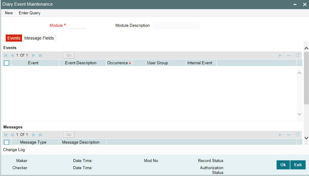

2.14 Associating diary events of a product
In the ‘Diary Event Maintenance’ screen, you can also specify the different diary events that would need to be processed for loan contracts using a product.
You can invoke the ‘Diary Event Maintenance’ screen by typing ‘OLDDIAEV’ in the field at the top right corner of the Application tool bar and clicking the adjoining arrow button.
In this screen, select the ‘Event’ of the diary event that you want to associate with the product, in the ‘Event Code’ field.
For more information on fields, refer to Bilateral Loans User Manual.

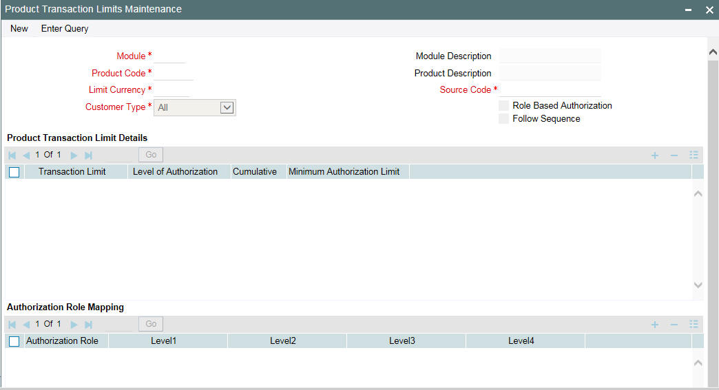

Using 'Product Transaction Limits Maintenance' screen (OLDPLMNT) and 'Multiauth Authorization Details' screen (OLDOVDEF), you can perform the following:
2.15.1 Product Transaction Limits maintenance
In ‘Product Transaction Limits’ screen, you need to maintain specific combination of fields so that the transactions belonging to this combination can be authorized based on the authorization hierarchy. The specific combination of fields are 'Module', 'Product', 'Limit Currency', 'Customer type' and 'Source Code'.
In ‘Product Transaction Limit Details’ section, you can specify transaction limit and authorization levels based on that authorization hierarchy.
In ‘Authorization Role Mapping’ section, you can define the user roles involved in authorizing the transaction. Role details should be provided for ‘primary rule’. Optionally, an ‘alternate rule’ can also be set up for the combination.
You can invoke the ‘Product Transaction Limits’ screen by typing ‘OLDPLMNT’ in the field at the top right corner of the Application tool bar and clicking the adjoining arrow button.
You need to specify the following:
Module
Specify the module for multi-level authorization. The list displays all the modules maintained in the system which require multilevel authorizations.
Product Code
Select the product code from the option list. The list displays all the product codes maintained in the system which require multilevel authorizations.
Limit Currency
Select the limit currency from the option list. The list displays all the limit currency maintained in the system which require multilevel authorizations.
Customer Type
You can select the customer type either as ‘ALL’, ‘Corporate’, ‘Individual’, or ‘Bank Customer’.
Module Description
The module description appears based on the module selected.
Product Description
The product description appears based on the product selected.
Source Code
Specify the source code as 'FLEXCUBE' in case of external system then source code is 'EXTSYS'.
Role Based Authorization
If this check box is selected, then ‘Level 1’, ‘Level 2’, ‘Level 3’, or ‘Level 4’ should be selected.
Follow Sequence
This option is applicable only if role based authorization is selected. When this option is selected, the system allows you to authorize the transaction only in sequence with the roles are specified.
Product Transaction Limit Details section
Transaction Limit
If the transaction is booked in excess of the maintained transaction limit then an appropriate message indicating the levels of authorization appears
Level of Authorization
Indicates the number of users to be involved in the contract authorization.
Cumulative
Select this check box to indicate whether shared authorization to be allowed for a contract’s transaction amount.
Minimum Authorization Limit
This field is applicable only when the 'Cumulative' check box is selected. The amount cannot be greater than the transaction limit. This amount is used to validate authorizer limit while authorizing the contract.
Select the role as 'Primary' or 'Alternate'. In case of three level of authorization, you authorize only 2 level.
The other authorization has to be done in the main contract screen.
Authorization Role
This is applicable only role based authorization is selected, you can select either ‘Primary’ or ‘Alternate’.
Level1 to Level4
System allows you to fetch the role maintained in the 'Role Maintenance' (SMDROLDF) screen.

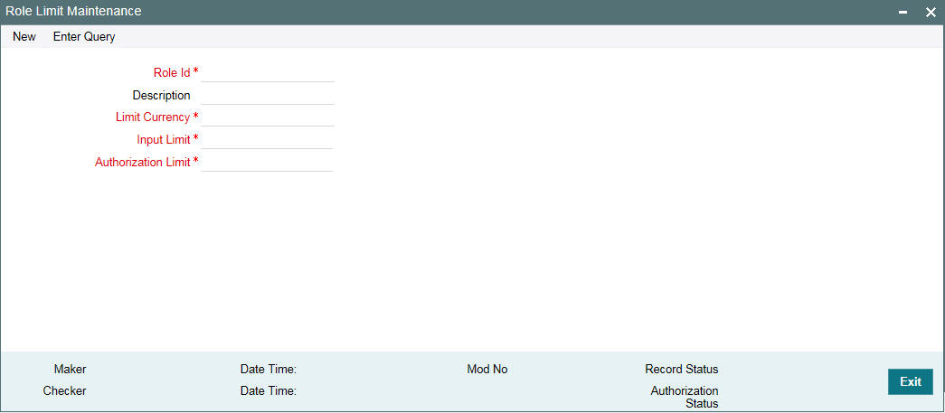

2.15.2 Role Limit Maintenance
You can invoke the ‘Role Limit Maintenance’ screen by typing ‘OLDRLLMT’ in the field at the top right corner of the Application tool bar and clicking the adjoining arrow button.
Role ID
Specify the role ID, which has to be mapped in the screen 'User Limits Maintenance' screen.
Role Description
Specify the corresponding description.
Limit currency
Specify the Limit currency which can be fetched in the corresponding LOV.
Input limit
Specify the transaction input limit for role.
Authorization limit
Specify the authorization limit for the role.

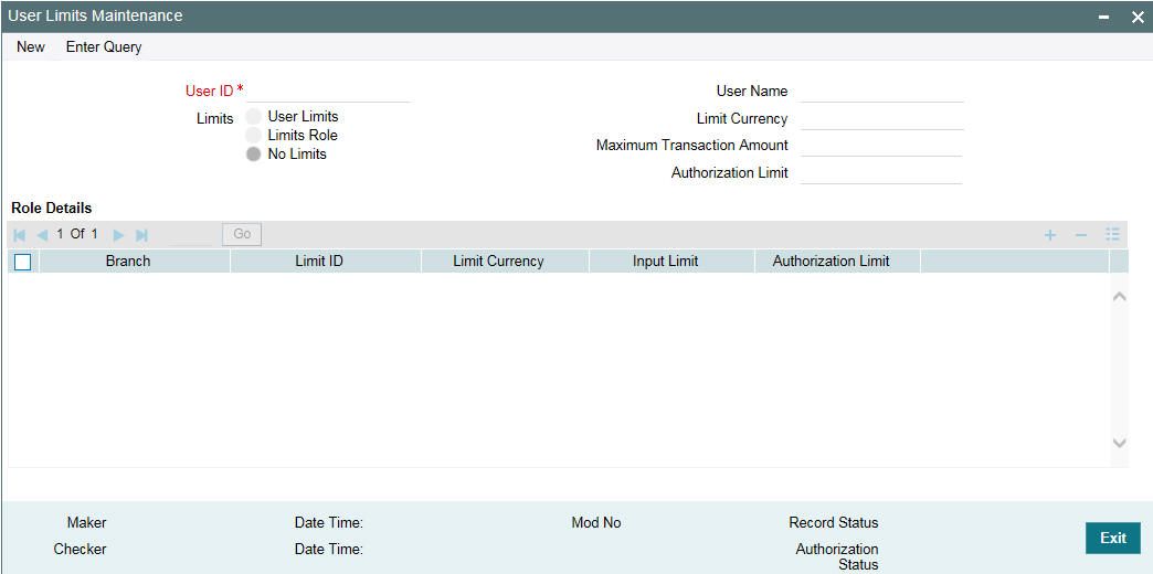

2.15.3 User Limits Maintenance
You can invoke the ‘User Limits Maintenance’ screen by typing ‘OLDUSRLM’ in the field at the top right corner of the Application tool bar and clicking the adjoining arrow button.
User ID
Specify the user id from adjoining LOV for which user limit to be maintained
Limits
Limits are of three types, which is specified below, select one of the following:
Limit Currency
This is applicable only when user limits selected, select the currency from the adjoining LOV.
Maximum Transaction Amount
Specify the maximum transaction amount allowed for the user.
Authorization Limit
Specify the Authorization limit for the user.
Role Details
This is applicable only if limits role option is selected.
Branch
Specify the branch for which limit role is used.
Limit ID
You have to select the limit ID from the corresponding LOV
Limit Currency, Input Limit and Authorization
The system fetches the corresponding limit ID details when limit ID is selected.
