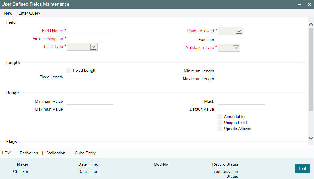

While working with Oracle Lending, there are additional fields that you would like to use either for your convenience or to suit the requirements of your bank. Adding to its flexibility, Oracle Lending now provides you the option to add fields based on your specifications to meet your needs.
Based on your requirement and the nature of the field, you can specify default values and validations for the field. Oracle Lending validates all entries made to the field with the validations you define for a field. You can invoke the ‘User Defined Fields Maintenance’ screen by typing ‘UDDUDFMT’ in the field at the top right corner of the Application tool bar and clicking on the adjoining arrow button.
A field that you have created becomes operational in Oracle Lending only after it is authorized. A user bearing a different Login ID can authorize a field definition record that you have created.
Field Name and Description
You can identify a field that you create with a unique identifier, and a brief description.
Each field that you define in Oracle Lending should be assigned a unique code. You can briefly describe the field in Description field. The description is for your information only. Itis not be printed on any customer correspondence.
Field Type
The type of field that you can create in Oracle Lending can be of the following formats:
Marking a Field as Mandatory
You can make entry to a field mandatory. To do so, select the Mandatory option. You are forced to make an entry to the field. Leave it deselected to indicate that the field is not mandatory.

To define a numeric field, choose the number option at the Field Type field. You can set up validation rules for a numeric field. The validation types applicable to a numeric field are:
You can indicate your preference at the Validation type field of this screen. Choose None to indicate that no validation should be performed on entries made to this field.
Validation Type — Range
You can specify the range validation type only for Numeric fields. In this case the entry to the field should be within a permissible range.
On choosing this validation type, you should indicate either the maximum or minimum values or both values allowed for the field. Any valid entry to the field should be within the range that you specify.
Validation Type — Length
For a numeric field you can indicate that the entry should be of a certain length. You have the option to indicate,
Depending on the option you select, indicate the fixed field length or indicate the maximum and minimum length for valid entries to the field.

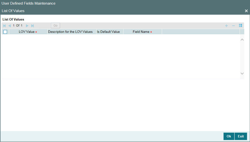

Choose LOV to indicate that the entry to this field can be chosen from a predefined list. On choosing this option you can define the items that should be displayed on this list.
Click ‘LOV’ button and define the list of values and their description. The items that you define for the list are displayed whenever the field is used in Oracle Lending.
To define a text field, choose the text option at the Field Type field. A text field can contain alphabets of the English language or a combination of alphabets and numeric values.
You can specify validation rules for a text field. The validation types applicable to a text field include:
For a text field you can indicate that a valid entry to the field should be of a certain length. You have the option to indicate,
Depending on the option that you select, indicate the fixed field length or indicate the maximum and minimum length of entries made to the field.
Validation Type — Mask
To indicate a field as a masked field, choose Mask as the field type. This option allows you to define a broad field structure to which all entries to the field should conform.
The mask structure can consist solely of ‘a’ or ‘n’ or a combination of these. An ‘a’ would indicate an alphabet of the English language and ‘n’ a numeric value.
All entries made to the fieldis validated with the format that you specify for the mask.
Choose LOV to indicate that the entry to this field can be chosen from a predefined list. On choosing this option you can define the items to be displayed on this list.

To define a date field, choose Date as the Field Type. For a date field, you can indicate validations like whether back and future dates can be entered into the field and the back or future period applicable to the field.
You can specify the validation type for a date field. The validation types applicable to a date field include:
If you indicate LOV then an entry to the field can be made only from the predefined list that you maintain for the field. Choose None to indicate that no validation should be made for the field.
Back/Future Date Allowed
For a date field you can indicate whether back or future dates can be entered. Select the relevant options to indicate your preference.
If you choose the back or future date options, you should also indicate a future or back period permissible for the field. The back or future period should be represented as a number.
For example, if you indicate ‘3’ as the back date period, the field accept dates upto three days before the current system date as a valid entry.
Note
If you do not choose any of these options, the field only accept the current system date as a valid entry.
Select ‘Unique’ if the field that is being defined has to be unique. Consequently,
You can specify a default value for a user-defined field. The option list positioned next to this field is enabled only if the field is a cube entity. Otherwise, the option list is disabled.
For example, assume that your bank wants to capture an additional currency field for processing certain transactions and the default value for this additional field has to be USD. Therefore, your selections are as follows:
The option list in the ‘Default Value’ field displays all the currencies maintained at your bank. Select USD. Consequently, in the UDF screen of the Contract Input or Function Id screen, USD is displayed as the default currency.

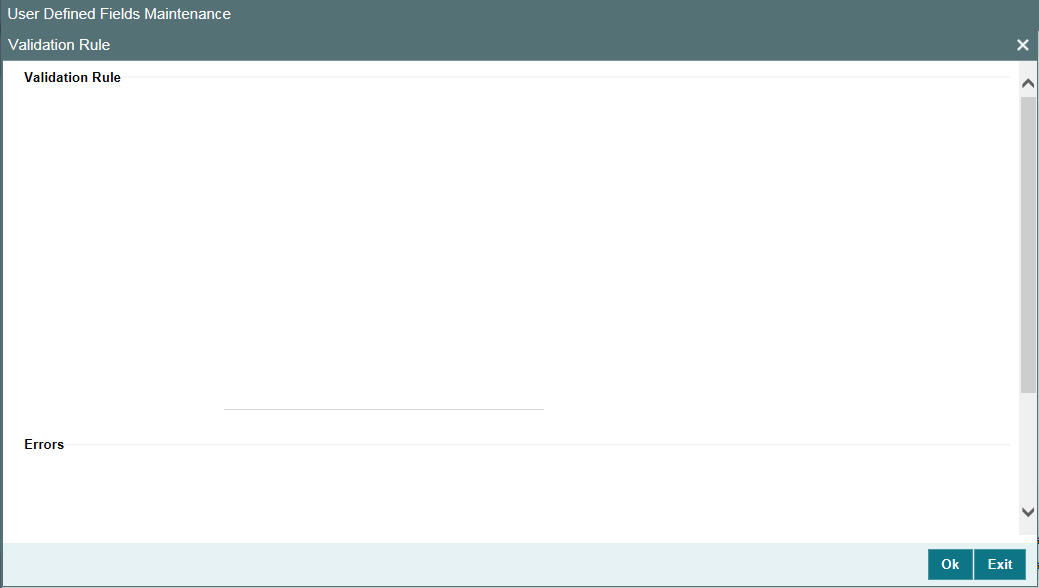

Apart from specifying the validation type for a field, you can specify additional validation rules to meet the requirements of the bank.
To indicate that additional validations are required for a particular user defined field, select ‘Validation Allowed’. This allows you to write a code to validate the value in the new field. Click ‘Validation’ button to write the validation code.
This is the PL/SQL validation code based on which the system check the value of the new field and validates at the time of transaction processing. Entry to this field is mandatory if you have selected ‘Validation Allowed’ option.
For example, at the time of processing a contract for a customer, the bank wants to add a new field to enter the first nominee that the customer has specified in his account. The names of the nominees of a customer are maintained in the ‘Customer Accounts Maintenance’ screen. The bank wants the system to check that the name of the nominee that is entered in the new field and the name of the first nominee that is maintained in the Customer Accounts Maintenance screen are same.
To do this, you need to:

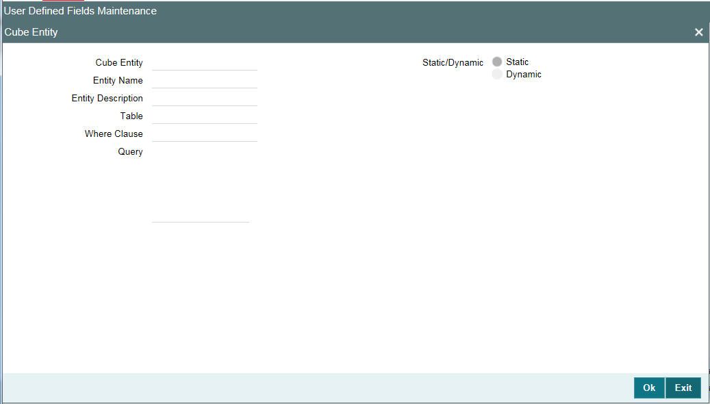

If the field that you are creating is of the type Cube Entity, indicate the entity that is applicable to the field. You can select a Cube Entity from the option list positioned next to this field. This contains the following Cube Entities:
For instance, you need to capture details of an additional customer for a transaction. You can choose the Cube Entity field type and select the Customer field. The list of customers maintained for your bank are made available at the field as in any other Customer field in Oracle Lending.
Method for Populating the Cube Entity Values
If the field type is ‘Cube Entity’, the values of a field can be selected from Oracle Lending tables. If you select the field type as ‘Cube Entity’, the ‘Cube Entity’ screen is displayed.
In the ‘Cube Entity’ screen, you need to specify the method by which the values have to be populated. The options available are:
Note
At the time of installation, the implementer writes the PL/SQL code for the derivation rule, validation rule and also the query for fetching a cube entity according to the requirements of the bank.
Table
Depending on your selection in the ‘Cube Entity’ field, system displays the table name in which the selected cube entity is located. The value of the column (which is specified in the previous field) from this table is picked up to populate the values of the new field.
Description
After you enter the cube entity, you may enter a brief description of the cube entity. This description is used for information retrieval.
Where Clause
Enter the condition based on which the values from the specified column and table, the values of the new field should be picked up. Enter the condition in this field if you have indicated ‘Static’ method for populating the values of the cube entity.
Query
This is the code, based on which the values of the new field is picked up.
The query has to be written if the option ‘Dynamic’ is selected.

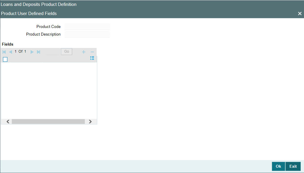

At the time of creating a product click ‘Fields’ button from the ‘Product Definition’ screen. From this list of all the fields that you created, you can choose specific fields and make them applicable to the product.
In this screen, you can link the user-defined fields to the product that you are defining. Oracle Lending allows you to link up to two hundred fields to a product.
To link a user-defined field, click add icon. A list of all the user-defined fields for which the Usage Allowed is ‘Product’ is displayed. Select the fields that have to be included in the Contract Input screen for the contracts processed under the product that is being defined.
When a contract is processed under that product, the fields associated with the product are available in the Contract Input screen.

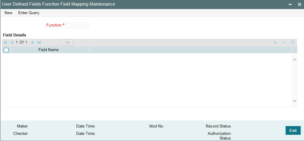

After saving and authorizing the record in the ‘User Defined Fields Maintenance’ screen, go to ‘User Defined Fields Function Field Key Mapping Maintenance’ screen.
You can invoke the ‘User Defined Fields Function Field Key Mapping Maintenance’ screen by typing ‘UDDFFLMT’ in the field at the top right corner of the Application tool bar and clicking on the adjoining arrow button.
In this screen, you must identify the function ID to which you need to link user-defined fields.
Select the Function Id from the adjoining option list. For instance, if you want to include the user defined fields in the ‘Chart Of Accounts- Detailed’ screen, select the function Id GLDCHACT. After selecting the Function Id, click ‘Add’ icon to select the fields that have to be included in the selected Function Id screen. A list of all function Id ‘s for which the Usage Allowed is specified as ‘Function Id’ will be displayed. Select the appropriate fields that have to be included from the list. Oracle Lending allows you to link up to two hundred fields to a Function ID.
After you save and authorize the record, the user defined fields will be included in the specified Function Id screen.

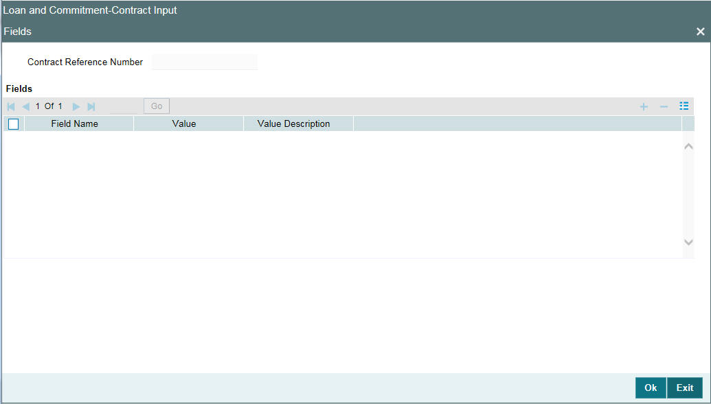

The defaulted or derived values of the UDF linked at the product level are populated in the Contract Input screen at the time of processing contracts under a particular product. Similarly, the values of the UDF’s linked to a function Id are populated in the function Id screen.
The UDF’s linked to a particular product are available when a contract is processed under that product. In the Contract Input screen, click ‘Fields’ button to invoke the ‘User Defined Fields’ screen.
In this screen, all the user defined fields associated with the product under which you are processing the contract are displayed.
According to your specifications at the time of defining the user defined fields, system may derive the values of the UDF from:
You are not allowed to change the values of the fields for which you have not allowed amendment (if the option ‘Amendable is unchecked at the time of defining an UDF) and derivation is allowed (Option ‘Derivation Allowed’ is checked).
Enter the values for the fields, for which the values are not derived by the system.
You can change the value of a UDF after the system has derived the value from the derivation logic. But it might so happen that the derivation logic of another UDF might use the value of the UDF that you have changed. Consequently, if you change the value of the UDF whose value is used in another UDF, the value of that UDF will also change.
For example, let us assume that you have defined a user defined field UDF1 to display the Euro equivalent of the contract currency.
The derivation logic of another user defined field (UDF2) utilizes the values of UDF1 to arrive at the value of UDF2. Assume that in the derivation logic written for UDF2, you have specified that the value of UDF2= 2 UDF1.
At the contract level, system converts the contract currency into Euro equivalent and displays the value of UDF1, as 220.00. According to this value of UDF2 will be 444.00. However, if you change the value of UDF1 to 250.00, it effects on the value of UDF2 also (it becomes 500.00).
If the change in the UDF value has effected any other UDF, system will display an override informing you about the UDF whose value will be changed. Select ‘Ok’ button if you want the system to re-calculate the value of the UDF based on the modified UDF value.
