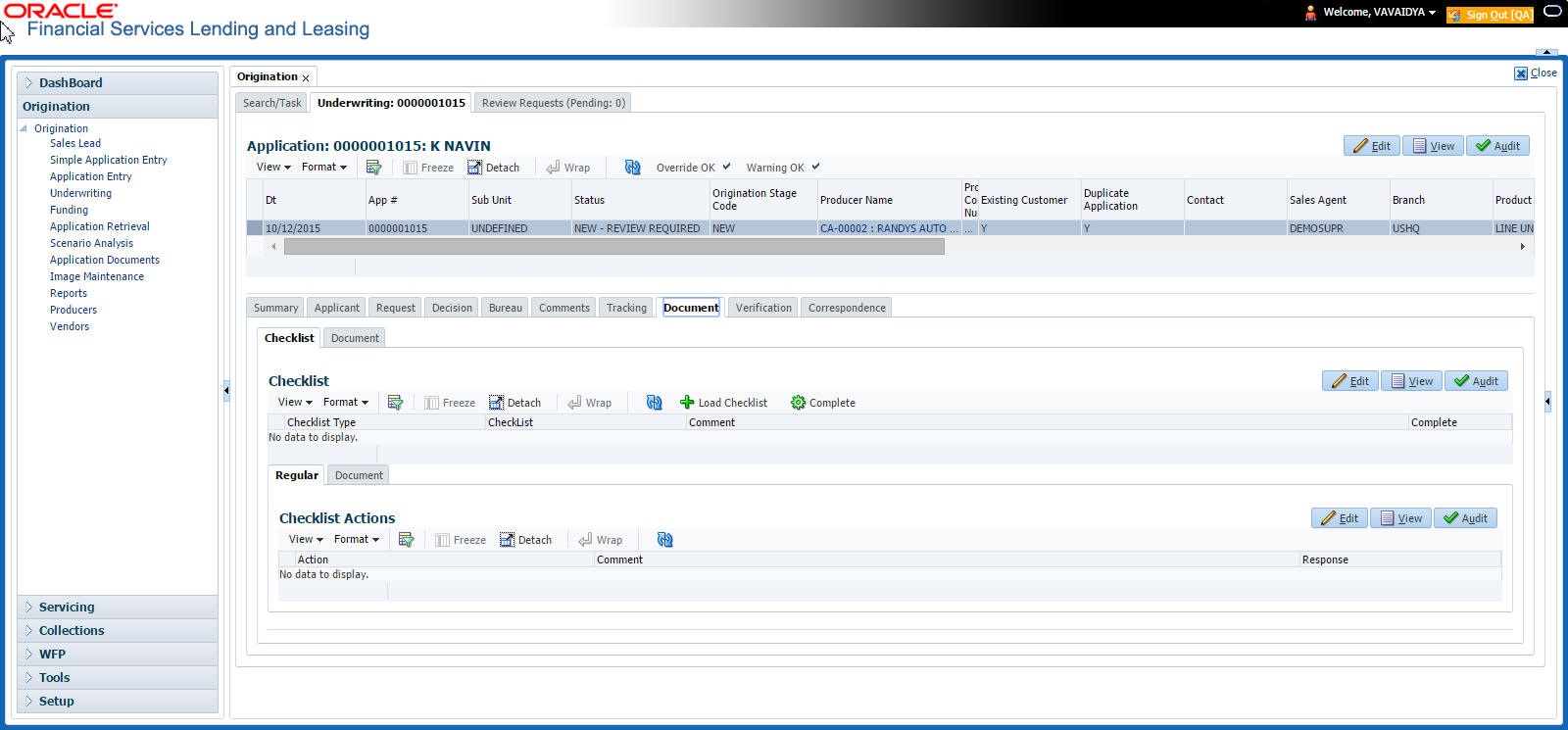

7.3 Loading an Application on the Underwriting screen
The first step in the underwriting process is to load the application you want to work with. For details about using the Loading an application, refer Searching for an Application in the chapter Search Function.
7.3.1 Applications
The Underwriting screen’s Applications section appears at the top of the screen opened from Underwriting master tab. The screen displays the application number and name on the header and contains information such as application purpose, product and producer.
In this section, you can perform any of the Basic Operations mentioned in Navigation chapter
A brief description of the fields is given below:

  1. Perform any of the Basic Actions mentioned in Navigation chapter.
7.3.2 Changing the Status of the Application
You can use underwriting screen’s Applications master screen to change the status and sub status of the application.
To change the status of the application
  1. On the Underwriting form’s Application master screen, change the status of application to either Approved, conditioned, or Rejected in the Status field and click Save.

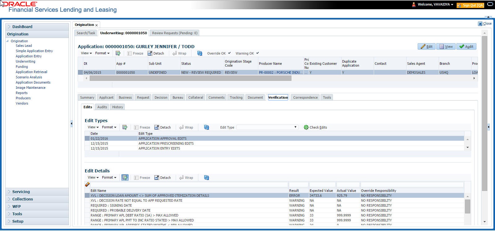

The system checks the information on the Underwriting form using guidelines established during implementation.
The system finds an error based on these guidelines, a Warning message appears stating “Validation Error exist, Unable to Change the status. Please check the Edits.”
  1. Click the Verification link and begin verifying edits on the Edits screen (For more information, see the Verification link section in this chapter.)
During status change:
During status change, if there is a warning in the edit, the system displays an error message as ‘Warning Exists. Do you want to continue?’.

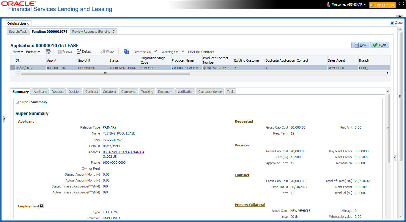

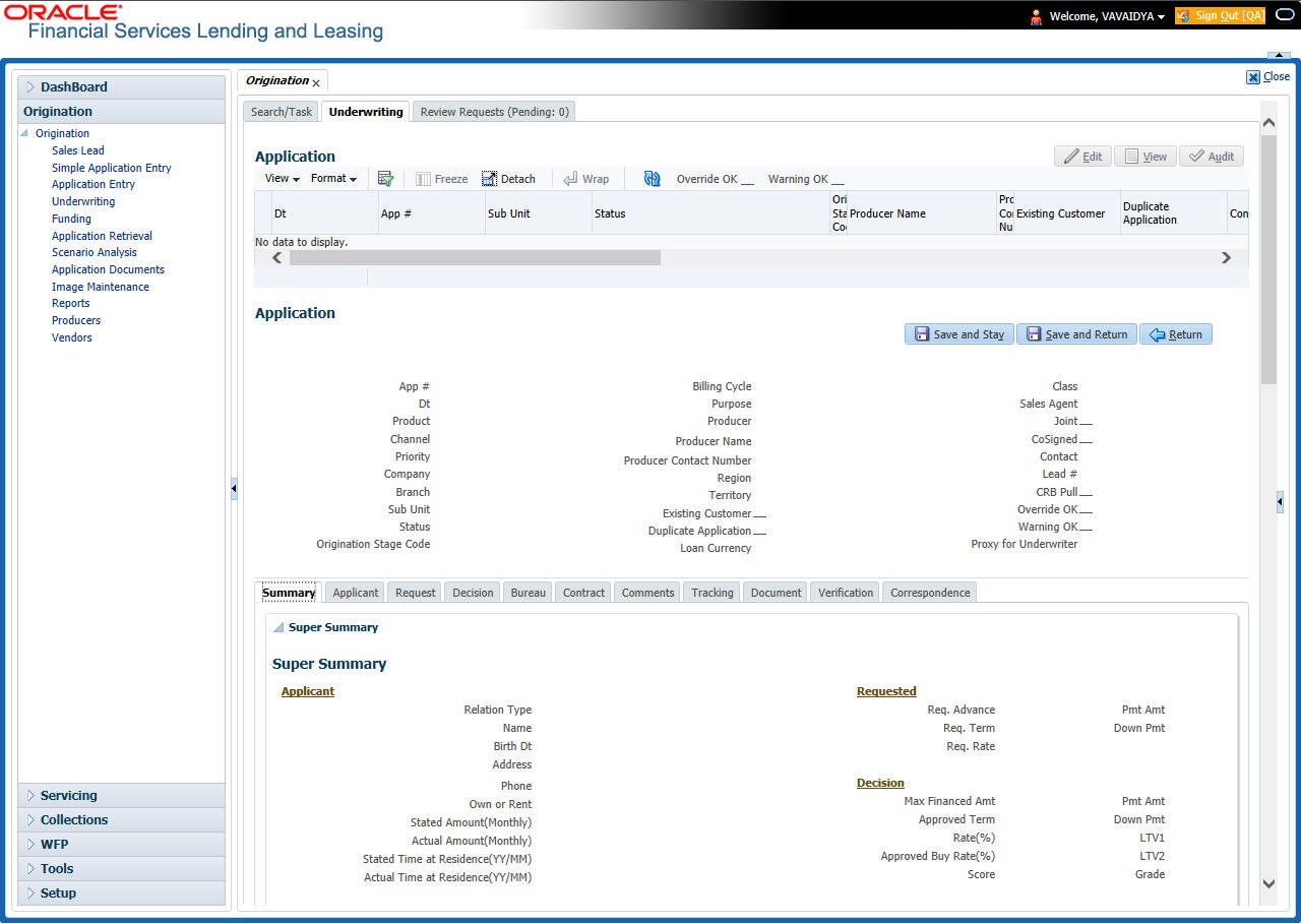

7.4 Summary Tab
The summary screen provides a unified view of the application details without navigating to the respective screens/ sub-tabs.
Using this screen, you can view the following details in their respective sections:
To view the Super Summary
  1. Open the Underwriting screen and load the application you want to work with.
  2. Click Summary tab. By default the system opens the summary tab. Expand the Super Summary section.
The Super Summary tab provides a snapshot of all relevant details in a single screen and contains details of Applicant, Employment, Ratios, Bureau, Requested financials, Decision updates, Contract updates and Primary Collateral details. You need not have to navigate to each of these tabs for specific information on the application. Also clicking on the hyperlinks of Address, Employment, Ratios, and Trade-In helps you to directly navigate to respective tab(s),
During the Underwriting and Funding stages, 'verified' button is displayed just below the address and employment details for each of the applicants. This would be enabled only when the Verified by and Verified Dt in the respective tabs are blank. You can verify the details from the Super Summary tab. Clicking on Verified will do the following:
  1. System will copy the stated values to Actual values.
  2. System will stamp the “Verified By” as 'User Name' and 'Verified Date' as 'Current GL Date' for the respective applicant.
  3. If 'Verified Details' are already updated in tab or if the details are stamped, this button will be disabled.
  4. 'Verified' button will be available when 'Actual Amount' equal to ZERO or 'Verified By' or 'Verified Date' is NULL.
You need not navigate to Address and Employment tab for verifying applicant details.
Decision details will be displayed when application has Origination Stage as “Review, Decisioned, Contract or Funded”. In case an application is Rehashed, only Decision information will be displayed and Contract information will not be displayed. Contract details will be displayed when application has Origination Stage as “Contract or Funded”.
The system displays the collateral details maintained in the collateral tab on click of navigation button under the headings Primary Collateral and Secondary Collateral. Collateral details for Unsecured loan also will be displayed if they are maintained.
All the trade-in details, if any, maintained in the application would be displayed on click of Navigation button.

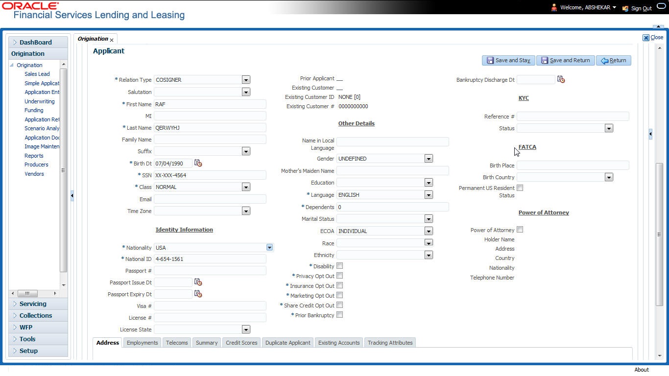

7.5 Applicant Tab
Having selected and loaded an application, you can view the information about applicant in the Applicants tab. This is information that was recorded on the Application Entry screen or gathered during the credit pull. You can edit data from the Application Entry screen at anytime in the following steps. Remember to save your work with each change. Information from the credit bureau pull is available to view only.
Using the information supplied on the application, complete the Applicants tab details and the following sub tab details:
Primary Applicant details are required for SME applications also. The system uses information on the Financial and Liabilities sub tabs in determining the applicant’s net worth. The system uses information on the Employments screen and Other Incomes sub screen to calculate the applicant’s debt-to-income ratio.
To verify applicant information on the Underwriting screen
  1. Open the Underwriting screen and load the underwriting application you want to work with.
  2. Click Applicants tab.
  3. In this section, you can perform any of the Basic Operations mentioned in Navigation chapter
Field
Do this
Relation Type
Select the relationship type from the adjoining drop-down list. For example, primary, spouse, secondary, or cosigner.
Salutation
Select the salutation from the adjoining drop-down list.
First Name
Specify the applicant’s first name.
MI
Specify the applicant’s middle name.
Last Name
Specify the applicant’s last name.
Family Name
Specify the applicant’s family name.
Suffix
Select the name suffix/generation from the adjoining drop-down list.
Birth Dt
Specify the applicant’s date of birth.
SSN
Specify the applicant’s social security number.
Class
Select the classification of the applicant from the adjoining drop-down list. For example, normal or employee. The system uses this information to restrict access to the database by recognizing employ­ees as ‘secured applications’.
You can create a SME (Small Medium Enterprise) application by selecting Small business. When you select small business and save your entry, the Business Applicants link on the Applicants link is available. (required).
Email
Specify the personal Email ID of the applicant.
Time Zone
Specify the time zone to which the applicant belongs. This information appears when you enter and save the zip code for the primary appli­cant’s current home address on the Address sub screen. You can also manually complete this field.
Identity Information Section
Nationality
Select the applicant’s nationality from the adjoining drop-down list.
National ID
Specify the national identification number.
Passport #
Specify the passport number.
Passport Issue Dt
Select the date on which passport was issued.
Passport Expiry Dt
Select the passport’s expiration date.
Visa #
Specify the applicant’s visa number.
License #
Specify the applicant’s license number.
License State
Select the state where the license was issued, from the adjoining drop-down list.
Prior Appli­cant
Check this box to indicate that the customer is an existing customer.
Existing Cus­tomer
Check this box to indicate that this applicant has a previous account.
Existing Cus­tomer ID
Specify the customer ID if the applicant is an existing customer.
Existing Cus­tomer #
Specify the customer number if the applicant is an existing customer.
On saving the applicant details, the data in ‘Existing Customer #’ is displayed as a link in ‘Applicant’ section header and clicking on the same will display the customer details in Search Results section of Servicing module.
Update Cus­tomer Info
Check this box to indicate if system can override the existing cus­tomer information and create the record with latest address and com­munication details of the customer.
Other Details section
Name in Local Language
Specify the applicant’s name in local language.
Gender
Select the gender of the applicant from the adjoining drop-down list.
Mother’s Maiden Name
Specify the mother’s maiden name.
Education
Select the education of the applicant from the adjoining drop-down list.
Language
Select the applicant’s native language from the adjoining drop-down list.
Dependents
Specify the number of dependents.
Marital Status
Select the marital status of the applicant from the adjoining drop-down list.
ECOA
Select the ECOA (Equal Credit Opportunity Act) code, from the adjoining drop-down list. This defines the various possibilities on who is liable; individual, joint, cosigner and so on.
Race
Select the applicant’s race from the adjoining drop-down list.
Ethnicity
Select the applicant’s ethnicity from the adjoining drop-down list. This is the information the Home Mortgage Disclosure Act requires to be reported.
Disability
Check this box if the application has a disability.
Privacy Opt Out
Check this box to indicate that the applicant has elected to refrain from the non-public sharing of information.
Insurance Opt Out
Check this box to indicate that the applicant has elected to refrain from insurance related inquiries.
Marketing Opt Out
Check this box to indicate that the applicant has elected to refrain from marketing related inquiries.
Share Credit Opt Out
Check this box to indicate that the applicant has elected to refrain from financial information and share credit related inquiries.
Prior Bank­ruptcy
Check this box if prior bankruptcy exists.
Bankruptcy Discharge Dt
Enter the discharge date of prior bankruptcy (if one exists).
KYC Section
Reference #
Specify the reference number.
Status
Select the status of the applicant from the adjoining drop-down list.
FATCA Section
Birth Place
Specify the birth place of the applicant.
Birth Country
Select the country of birth of the applicant.
Permanent US Resident Sta­tus
Check this box if the applicant has permanent US resident status.
Power of Attorney Section
Power of Attorney
Check this box if you hold a power of attorney.
Holder Name
Specify the holder name of the power of attorney.
Address
Specify the address of the holder.
Country
Specify the country of the power of attorney holder.
Nationality
Specify the nationality of the power of attorney holder.
Telephone Number
Specify the telephone number of the power of attorney holder.

7.5.1 Address Sub Tab
You can specify more than one address for each applicant, such as a home address, second home address, and vacation home address. However, at least one must be marked as current. Also, only one address can be selected as the mailing address, and that address must be marked as current. Finally, while you can have more than one Home type address, only one can be marked as current.
To complete the Address sub tab
  1. Click Address sub tab.
  2. In this section, you can perform any of the Basic Operations mentioned in Navigation chapter.
Based on the country chosen in the address tab, the fields for capturing the address will vary.
Field
Do this
Address Type
Select the type of address from the adjoining option list.
Current
Check this box if this is a current address.
The mailing address must be marked as current.
Confirmed
Check this box if the address is the confirmed one
Mailing
Check this box if this is the mailing address. Only one address entry can be marked as the mailing address.
Permission to Call
Check this box if customer has provided permission to contact through the specified phone number.
Atleast one phone number per application should have the permis­sion to call (flagged as 'Y') for the successful pre-qualification of the application. Else, an error message is displayed.
Permission to Text
Check this box if customer has provided permission to contact through text message.
Country
Select the country of mailing address from the adjoining drop-down list.
Address Details section
Postal Type
Select the postal address type from the adjoining drop-down list.
Address #
Specify the address number of the mailing address
Street Pre
Select the street prefix (directional) from the adjoining drop-down list.
Street Name
Specify street name.
Street Type
Select the street type from the adjoining drop-down list.
Street Post
Select the street postfix (directional) from the adjoining drop-down list.
Apt #
Specify the apartment number.
Address Line 1
Specify the first address line.
Address Line 2
Specify the second address line.
Address Line 3
Specify the third address line.
Zip
Select the zip code from the adjoining drop-down list.
For non US country, you have to enter zip code.
Zip Extn
Specify the extension of the zip code.
City
Specify the city of the mailing address.
State
Select the state of the mailing address, from the adjoining drop-down list.
Phone
Specify the phone number.
Additional Information section
Own / Rent
Select the ownership type from the adjoining drop-down list.
Landlord
Specify the landlord’s name.
Landlord Phone
Specify the landlord’s phone number.
Contact
Specify the person contacted on behalf of landlord.
Contact Title
Specify title of the person contacted on behalf of landlord.
Contact Phone
Specify phone number of the person contacted on behalf of landlord.
Extn
Specify the extension of the phone of the person contacted on behalf of landlord.
Census Tract/BNA code
Specify census tract/BNA (block numbering area). These are defined by the US Census Bureau code.
MSA Code
Specify the metropolitan statistical area (MSA) code. These are sim­ilar in concept to a zip code, but used mostly on government reports.
Comment
Specify a comment.
Address Rent Mortgage Stated section
Years
Specify the stated number of years at residence.
Months
Specify the stated number of months at residence.
Currency
Select the currency code of payment amount, from the adjoining drop-down list.
Pmt Amount
Specify the stated payment amount.
Frequency
Specify the stated payment frequency.
Rent/Mortgage
The system displays the rent or mortgage amount.
Address Rent Mortgage Actual section
Years
Specify the Actual number of years at residence.
Months
Specify the Actual number of months at residence.
Pmt Amount
Specify the Actual payment amount.
Frequency
Specify the Actual payment frequency.
Rent/Mortgage
Verified Section
Verified By
The name of the verifier.
Verified Dt
The date of verification.
  2. If there are more than one addresses associated with the applicant, click Save And Add on the Address sub screen and add address details.

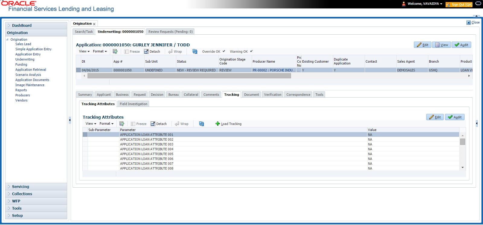

7.5.8 Tracking Attributes Sub Tab
You can add tracking attribute information to an application at any time in the underwriting process by using the Tracking Attribute tab.
The Tracking tab enables you to record further information associated with the application. What items you choose to track are setup during implementation.
To track attributes
  1. Click Tracking Attributes sub tab.
  2. Select the item you want to track.
  3. Click Edit to edit the following information:
    Field
    Do this
    Sub-Parameter
    View the sub-parameter
    Parameter
    View the parameter.
    Value
    Specify the information about the corresponding Value field.
  4. Save changes you made to the account.
7.5.8.1 Create Tracking
  1. Click Create Tracking, the system loads the tracking parameters.
  1. Specify the requested parameter in the Value field and click Save.

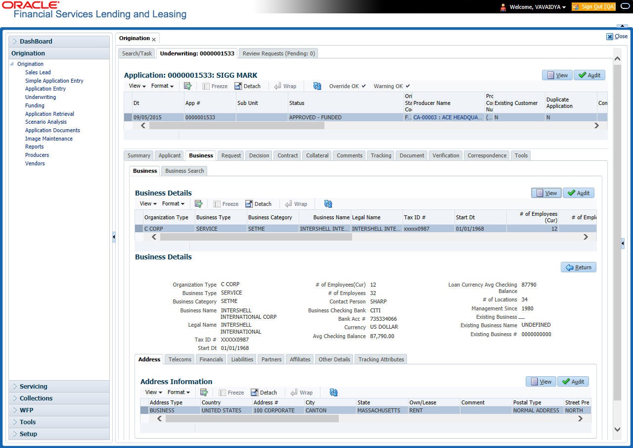

7.6 Business Tab
Oracle Financial Services Lending and Leasing can record SME business related financial information and business partners on the Business section to assist in approving the Lease application during underwriting. The Business Applicant screen is available and contains the following sub screens:
If there are no business information associated with the application, the Business Applicant tab is unavailable.
To complete the Business tab
  1. If SME business information is included on the application, select small business in the Class field on the Applications section and click Save.
The Business tab appears on the Underwriting screen.
  1. Click BusinessTab .
  2. Perform any of the Basic Operations mentioned in Navigation chapter.
Field:
Do this:
Organization Type
Select the organization type.
Business Type
Select the type of the business.
Business Name
Specify the name of the business.
Legal Name
Specify the legal name of the business.
Tax ID
Specify the tax identification.
Start Date
Specify the business start date.
# of Employees (Cur)
Specify the current number of employees at the business.
# of Employees
Specify the number of employees at the business after financing.
Contact Person
Specify the contact person at the business.
Business Checking Bank
Specify the bank name of the business’s checking account.
Bank Acc #
Specify the bank account number.
Avg Checking Balance
Specify the average checking balance.
# of Locations
Specify the number of locations of the business.
Management Since
Specify the year the current management was established.

7.6.6 Affiliates Sub Tab
You can enter more than one affiliate for the business.
To complete the Affiliates sub tab
  1. Choose Affiliates sub tab.
Field:
Do this:
Organization Type
Select the affiliate’s organization type
Legal Name
Specify the affiliate’s legal name
Business Name
Specify the affiliate’s business name
Tax ID
Specify the affiliate’s tax identification
Ownership (%)
Specify the affiliate’s percentage of ownership
# of Employees
Specify the affiliate’s number of employees
NAICS CODE
Specify the affiliate’s North American Industry Classification System code.
Country
Select the affiliate’s country code.
Address #
Specify the affiliate’s address number.
Address Line 1
Specify the affiliate’s first address line.
Address Line 2
Specify the affiliate’s second address line.
Zip
Select the affiliate’s zip code.
Zip Extension
Specify the affiliate’s zip extension.
City
Specify the affiliate’s city.
State
Select the affiliate’s state.

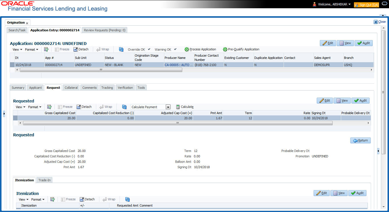

7.7 Request Tab
In the Request tab you can define the required Lease parameters and calculate Payment, Interest Rate, Term and Lease Amount using the quick calculator. By default, system calculates for monthly repayment term basis. The payment frequency can be changed only in the Underwriting tab during decisioning.
To complete Request section:
  1. On the Application Entry tab, click Request tab.
A brief description of the fields are given below:
Field
Do this
Gross Capitalized Cost
Specify the value of gross capitalized cost.
Capitalized Cost Reduction (-)
Specify the value of capitalized cost reduction which is the advance amount.
Adjusted Cap Cost (=)
View the adjusted capitalized cost which is calcu­lated as Gross Capitalized Cost - Capitalized Cost Reduction.
Pmt Amt
Specify the requested payment amount.
Term
Specify the requested term (number of payments).
Rate
Specify the requested Rate.
Balloon Amt
Specify the balloon amount (if exist).
Note: This field is displayed only if the lease calcu­lation method is ‘Interest Rate’.
Signing Dt
Specify the signing date
Probable Delivery Dt
Specify the probable delivery date.
Promotion
Select the promotion type from the drop-down list.
  2. In the ‘Requested’ section, there is a drop-down list adjacent to the ‘Calculate’ button with following options to auto calculate different Lease parameters based on the data provided. Select the record you want to work with and from the drop-down option, select the option you want system to calculate:
    Lease Type
    Calculate Option
    Rent Factor
    Calculate Payment
    Calculate Gross Capitalized Cost
    Interest Rate
    Calculate Payment
    Calculate Interest Rate
    Calculate Term
    Calculate Lease Amount
  3. Click Calculate. The system displays the requested calculation in the respective field.
7.7.1 Itemization Sub Tab
The Itemizations sub tab enables you to add or verify any itemized amounts associated with the application. The list of itemizations is determined by the product you select in the master screen during the application entry process. The Itemizations sub screen displays an itemization record of the amount financed, such as the cash price, cash down payment, trade-in, unpaid cash price balance and so on. Information that was entered on the Itemization sub screen during the application entry process will appear in the Requested Amt column. Information that you enter as an underwriter in the Approved Amt column will appear in the Itemizations sub tab on the Underwriting screen.
Application request details need to be essentially entered in the itemization sub tab for pre-screening to be successful. Else, the system displays error and application would not proceed to the next level in work flow. The details of down payment, trade-in, insurance, fees etc. and the total sale price are recorded under itemization.
To add or view itemizations
  2. Click Request > Itemizations sub tab.
  3. Perform any of the Basic Operations mentioned in Navigation chapter.
Field:
Do this:
Itemization
View the itemization.
View whether the itemized amount is added or subtracted from the Lease amount.
Requested Amt
Specify the requested amount.
Comment
Specify a comment.

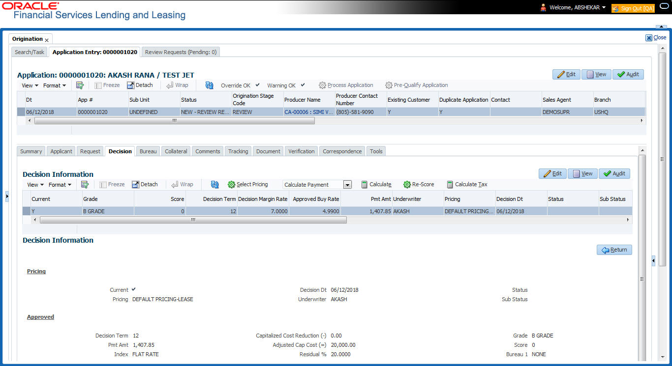

7.8 Decision Tab
If the application was initially approved automatically, the system displays its recommendations on the Decision tab’s Approved section.
If the application was initially rejected automatically, the system displays its reasons on the Decision link’s Stipulation sub tab.
If you choose to approve or reject the Lease manually, you must manually select the pricing (rule) set by the portfolio company for a specific product. The system validates this pricing against the information in the System Recommendation sections. The information in the Requested section comes from the application entry process and can be edited.
You can use the quick calculator provided with the drop-down list adjacent to the ‘Calculate’ button to calculate the required Lease parameters. You can also use the calculator available in Tools section for completing this step. For detailed information on using the Calculator tools, refer “Tools” chapter in the document.
To verify the application decision data
  2. Click Decision tab.
    • A brief description of the fields is given below:
      Field:
      Do this:
      Pricing section
      Current
      Check this box to indicate that this is the current deci­sion.
      Pricing
      View the pricing.
      Decision Dt
      View the decision date.
      Underwriter
      View the underwriter id.
      Status
      View the application status.
      Sub Status
      View the application sub-status.
      Approved section
      Decision Term
      Specify the approved decision term.
      Pmt Amt
      Specify the approved payment amount.
      Note: If the system parameter ‘Auto Calculate PMT’ is set to ‘Y’ in Setup > Administration > System > System Parameter screen, the system auto calculates the pay­ment amount whenever there is a change in Decision Term or Decision Rate or Max Financed Amount fields.
      Note: Once the payment amount is approved, it will be copied on to the What if Payment field in the Summary sub screen of the Applicants Details screen.
      Index
      Select the applicable index type from drop-down list.
      Index Rate
      Specify the approved index rate.
      Decision Margin Rate
      Specify the approved decision margin rate.
      Pricing Buy Rate
      View the pricing buy rate.
      Approved Buy Rate
      View the approved buy rate which is by default the Pric­ing Buy Rate displayed above. You can also specify the required approved buy rate.
      Rent Factor
      Specify the rent factor.
      Note: This field is displayed only if the lease calculation method is ‘Rent Factor’.
      Buy Rent Factor
      View the buy rent factor.
      View the adjusted capitalized cost which is calculated as Gross Capitalized Cost - Capitalized Cost Reduc­tion.
      Residual %
      Specify the residual percentage.
      Maturity Index
      Select the approved maturity index.
      Note: This field is displayed only if the lease calculation method is ‘Interest Rate’.
      Maturity Margin Rt
      Specify the maturity margin rate.
  2. Click Select Pricing.
The system determines the best pricing match of all enabled Lease pricing strings in the Setup menu and displays the results in the Pricing and Approved sections.
  1. Quick Calculate
In the ‘Decision Information’ section, there is a drop-down list adjacent to the ‘Calculate’ button with following options to auto calculate different Lease decision parameters based on the data provided. Select the required option from the drop-down list and click ‘Calculate’:
Lease Type
Calculate Option
Rent Factor
Calculate Payment
Calculate Residual Percent
Interest Rate
Calculate Payment
Calculate Term
  1. Re-Score
A 'Re-Score' button is available next to 'Calculate'. Whenever any sensitive Financial or Collateral information is amended in the Application, OFSLL displays a warning message 'Scoring sensitive information is changed. Re-score the application'. You need to click on Re-Score to re-validate the grade and pricing accordingly.
The display of the warning message to Re-score the application can be controlled using the respective System parameter. If the defined System Parameter is flagged 'Y', only then the message is displayed.
If you are underwriting a Lease, record the following information on the Decision tab:
  1. If you are approving the application, complete the Approved section with the values you want to approve as an underwriter. You can update the default values that appeared when you selected the pricing string in step 3. (The system calculator may be of use when completing this section. For more information, refer the Tools chapter.)
  2. Click Calculate Tax. System calculates the ‘Lease Sales and Usage tax’ for upfront category which is billed during application funding. For more details, refer to Sales Tax Calculation at Origination section in Appendix chapter.

  1. Make any necessary changes in the Approved Buy Rate and Maximum Financed Amount fields in the Decision tab.
  2. Click Calculate.
The system displays the details and amounts for this compensation plan.

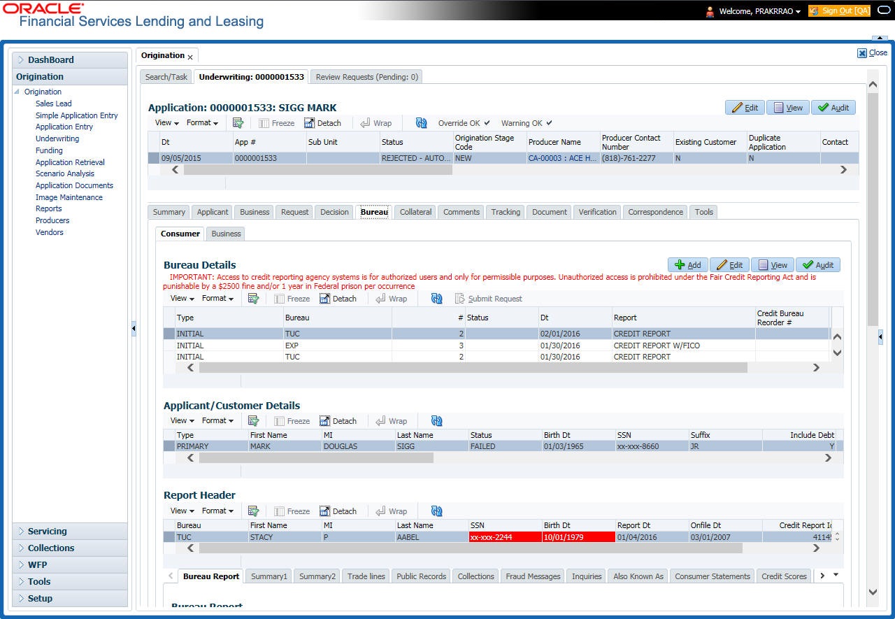

To verify the credit bureau data using the Bureau tab
  2. Click Bureau.
  3. In the Bureau Details section, view the following information:
    Field:

  5. In the Report Header section, view the following information:
    Field:
    View:
    Bureau
    The bureau.
    First Name
    The first name.
    MI
    The middle initial.
    Last Name
    The last name.
    SSN
    The social security number.
    Note: If the organizational parameter UIX_HIDE_RESTRICTED_­DATA is set to Y, this appears as a masked number; for example, XXX-XX-1234.
    Birth Dt
    The birth date.
    Note: The SSN and Birth Dt fields in Report Header section are displayed in red if there is a mismatch in the respective data present in the above Applicant/Customer Details section.
    Report Dt
    The report date.
    Onfile Dt
    The on file date.
    Credit Report Id
    The credit report id.
    Best Match
    The best match.
  6. Click Bureau Report.
The system parcels out the details from the credit bureau report in the Bureau screen’s sub tabs (Summary 1, Summary 2, Tradelines, Public Records, Collections, Fraud Messages, Inquiries, Also Known As, Consumer Statements, and Credit Scores).

To print the credit bureau data as a text or PDF report
  2. In the Underwriting screen, click Bureau.
  3. In the Bureau Report tab, the system displays the report in text format. You can also view the report in PDF format by selecting ‘PDF’ option as View Report.
Note
Google Chrome does not support search functionality in the PDF format of the report. Hence you have to enable the ad-hoc plug-in in chrome to use the search facility.
  1. In the Print Report section, click Print Report to send the information to the default printer.
7.11.2 Requesting a Credit Bureau Report Manually
The Credit Bureau Summary screen enables you to manually request a credit pull. Information from a manual credit pull can be used to validate an application.
To manually request a credit bureau report
  2. Click Bureau tab.
  3. In the Bureau Details section click Add.
  4. Specify the following information:
    Field:
    Do this:
    Applicant
    Select the applicant.
    Spouse
    Select the applicant’s spouse (if applicable).
    Bureau
    Select the credit bureau.
    Report
    Select the credit bureau report type.
  5. Click Create Request.
The system displays this information in the Bureau Details section.
Note
If you are requesting a report from Experian Credit Bureau for Premier Attribute Consumer report, you can do so without impacting the consumer FICO score. To facilitate the same, the ‘Soft Pull’ check box is to be selected in Bureau Details section. This option is available only when the system parameter ‘EXP_PA_SOFT_PULL_IND’ is enabled in the System Parameters screen and Bureau is selected as ‘EXP’ with Report as ‘PREMIER ATTRIB­UTE’ in the Bureau Details section.
  1. Select Include Debt and Populate Debt in the Applicant/Customer Detail section to populate the Liability section on the Applicants link’s Summary sub screen with data from the credit bureau pull.
  2. If you want to receive a copy of a previously pulled credit bureau report, enter the credit bureau reorder number in the Credit Bureau Reorder # field on the Bureau Details section. This enables you to receive a previously pulled credit report.
  3. In the New Request section, click Submit Request.
The system displays the latest status of the currently requested bureau report in the Bureau Details section. When the report pull process is complete, the Status field in the Bureau Details section changes from pending to Completed.

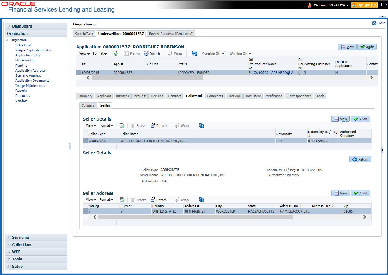

7.12 Collateral Tab
Having selected and loaded an application, you can view the information about the collateral of the Lease.
The Collateral link opens screens with information regarding any collateral associated with an application. Depending on the type of Lease, collateral can be a vehicle, home or something such as major household appliances. The Collateral tab is unavailable if this is an unsecured Lease.
To verify information about the collateral
  1. Open the Underwriting screen and load the application you want to verify.
  2. Click the Collateral tab.
Depending on the type of collateral, information about the vehicle, home, or other type of collateral appears.
If you are entering an unsecured Lease, the Collateral link is present but inactive; in which case, skip this step.
  1. In the Collateral Details section (This is information that was recorded during the application entry process or gathered during the credit pull.)
To enter collateral information
  1. On the Underwriting screen, click Collateral. If the collateral is a vehicle, the Collateral link displays information about the vehicle.

7.12.3 Seller Tab
The Collateral link’s Seller Details tab enables you to enter the seller details of the collateral of the Lease.
To enter the Seller details
  1. Click the Seller Details tab.
Field:
Do this
Seller Information section
Seller Type
Select the seller type.
Seller Name
Specify the seller name
Nationality
Select the seller’s nationality.
National ID/Reg #
Specify the national identification number or registration number.
Authorized Signatory
Specify the authorized signatory of the seller.
Seller Address section
Mailing
Select if this is the mailing address. Only one address entry can be marked as the mailing address.
Current
Select if this is a current address. The mailing address must be marked as current.
Country
Select the country code.
Address #
Specify the address number.
Address Line 1
Address Line 2
State
Select the state.
Zip
Select the zip code.
Zip Extn
Select the zip extension.
City
Specify the city.
Phone
Specify the telephone number.
Extn
Select the telephone extension.

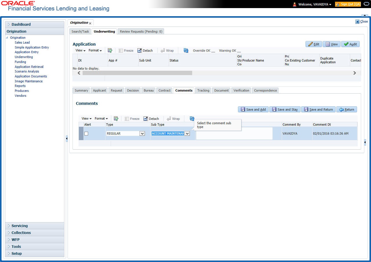

7.13 Comments Tab
When using the Underwriting screen, you can add/delete comments to an application at any time in the underwriting process by using the Comments screen.
Whenever an application is decisioned by a proxy user, a system generated comment with timestamp is inserted in the comments tab in the format ‘<User 1> actioned as proxy for Underwriter <User2>’. Here, User 1 refers to the logged in user who has acted on behalf of User2, who is the concerned Underwriter. The concerned Underwriter’s name will also be selected in Application section > 'Proxy for Underwriter' field.
To add comments
  1. Click Comments tab.
Field:
Do this:
Alert
Check this box to make the comment appear on the Customer Service screen Alert section
Type
Select the type of comment you are adding.
Sub Type
Select the sub type of comment you are adding.
Comment
Specify your comment.
Comment By
The system displays your user ID.
Comment Dt
The system displays commented date and time stamp.
7.13.0.1 Deleting Comment(s)
You can delete ‘REGULAR’ type comments displayed in the Comments sub tab.
To delete a comment
  1. Select the row which consists of the comment and click Delete from the actions.
  2. Click ‘Yes’ to confirm delete in the warning message displayed.
7.14 Tracking Tab
When using the Underwriting screen, you can add tracking attribute information to an application at any time in the underwriting process by using the Tracking Attributes screen.
To enter the tracking attributes
  1. Click Tracking tab.
  2. On the Tracking Attributes screen, click Load Tracking to load the tracking attributes.
  3. Select the item you want to track.
  4. Click Edit to edit the following information:
    Field
    Do this
    Sub-Parameter
    Parameter
    View the parameter.
    Value
  5. Save changes you made to the account.

7.15.1 Checklist Sub Tab
The Checklist sub tab enables you to view tasks performed during the underwriting process.
To view the underwriting Checklist screen
  1. Click Document > Checklist.
  2. If the Checklist section is empty, click Load Checklist in the Checklist section.
  3. In the Checklist Actions section, click Regular sub tab.
  4. In Checklist Actions section, complete the tasks listed in the Checklist Action column.
  5. Use the Yes/No/NA buttons in the Yes No NA column to indicate whether you completed the task or not.
  6. Use the Comment field to add remarks regarding any of the tasks, if you choose.
  7. When you are finished completing the tasks, choose Complete in the Checklist section.
  8. Click Save.
  9. In the Checklist Actions section, click the Documents sub tab
  10. In the Documents section, select the record you want to work with and click View in the Details column.
  11. In the Documents section, view the following information:
    Field:
    Do this:
    Action
    View the action to be performed.
    Document Type
    View the document type.
    Document Sub Type
    View the document sub type.
    Status
    Select the status of the action.
    Response
    Use the Yes/No/NA buttons to indicate whether or not you completed the task.
    Comment
    Specify comment.
7.16 Verification Tab
The system can be configured to automatically validate portions of an application when you attempt to change its status. The results of this data check appear on the Verification link’s Edit screen as an Error, a Warning, or an Override.
If it is an Error, the system will not allow you change the application’s status and approve the Lease until you fix all the errors.
If it is a Warning, the system enables you to change an application’s status without correcting the matter. While you should still investigate the problem, Warning messages are of a lesser importance than Error messages.
If it is an Override, the system displays a dialog box informing you that an override is needed; your responsibility level does not have the authority required to process this step. (Choose Yes on the dialog box to move the application to the queue of the user with the required authority.)
The system can be configured to verify different sets of information; for example, the system could check one set of data when checking application entries for completeness and another when approving auto Lease. Each one of these ‘edit types’ has its own set of ‘edit details’.
Note
The Edit Details section’s errors and warnings are created during the setup process.
7.16.1 Edit Sub Tab
To complete the Edits section
  2. Click Verification > Edits.
  3. In the Edits screen’s Edit Type section, select the type of edit you want to verify.
  4. Click Check Edits.
The system checks the data for the verification process selected in the Edit Type section and displays the results in the Edit Details section.
The Edit Details section contains the following display only information:
Field:
View this:
Edit Name

  1. In the Edit Details section, view the verification results and begin making corrections on the Underwriting screen. Remember, edits resulting in Error must be corrected. Edits resulting in warning can be by passed.
The system begins processing the credit application.

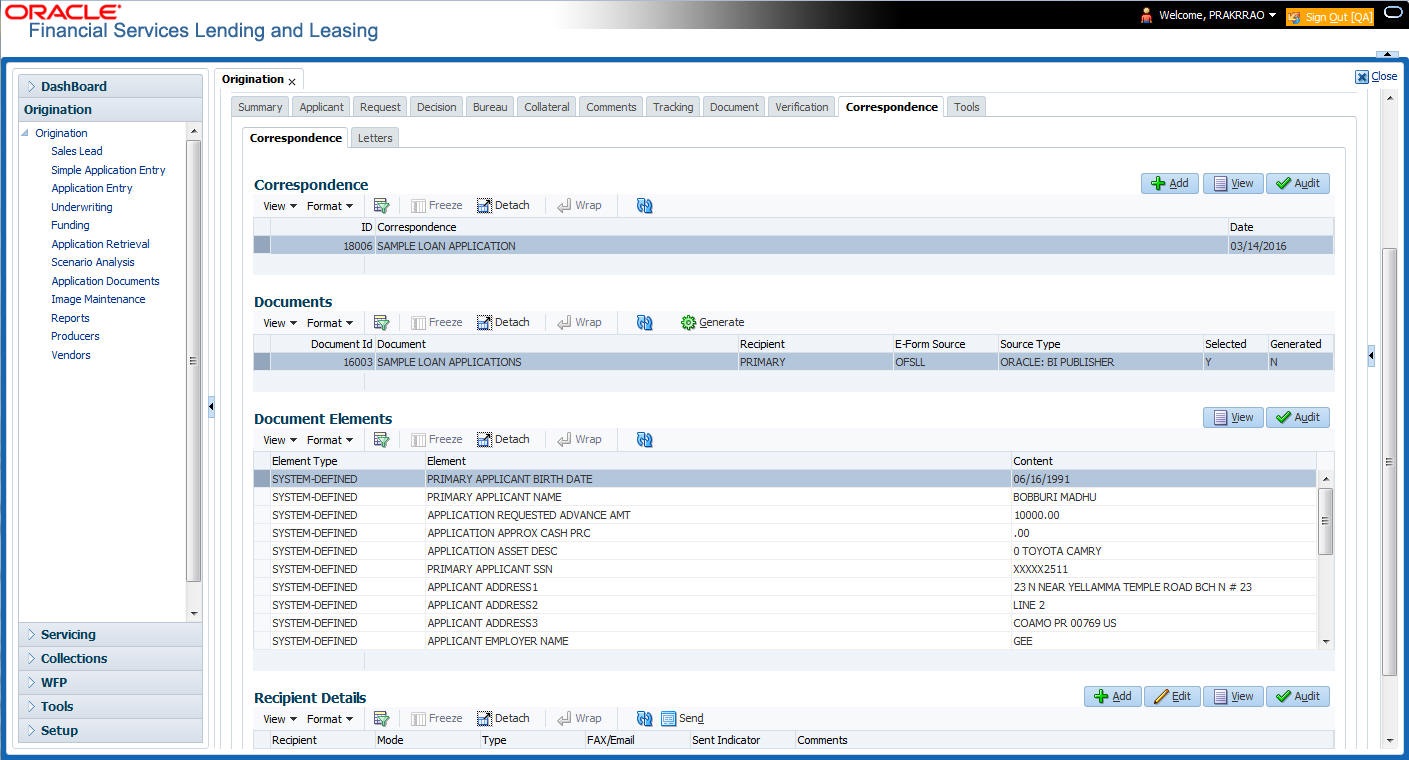

7.17 Correspondence Tab
Ad-hoc correspondence enables you to include information from applications in document templates you create yourself without manually transferring the data. Ad-hoc documents can be generated as either Microsoft Word or PDF files.
Ad-hoc correspondence can be viewed on the Correspondence link’s Correspondence screen when you have opened an account. The screen enables you to generate a new letter or view a previously generated letter.
7.17.1 Correspondence Sub Tab
To generate an ad hoc correspondence
  2. Click Correspondence > Correspondence.
Field:
Do this:
Correspondence
Select the correspondence you want to generated.
ID
System displays the correspondence ID.
Date
System displays the correspondence generation date.
The Documents section displays all the types of documents available for the type of correspondence you selected.
  1. In the Documents section, view the following information for each document:
    Field:
    View this:
    Document ID
    The document ID.
    Document
    The document description.
    Recipient
    The recipient description.
    E-Form Source
    The e-form source.
    Source Type
    The source type.
    Selected
    If selected, indicates that this document is selected to be included in the correspondence.
    Generated
    If selected, indicates that the system generated the document.
  2. In the Documents section, select the correspondence you want to view.
  3. The Document Elements section displays the elements the system used to generate the correspondence. You view the following information:
    Field:
    Do this:
    Element Type
    View the element type.
    Element
    View the element description.
    Content
    Specify/view the value of the element.
- or -
  1. In the Document Elements section, click User Defined and complete the Content fields for the Document Element fields you want to include in the correspondence.
  2. In the Document Elements section, click Save.
  3. In the Documents section, click Generate.
The system ‘locks’ the information included in the correspondence and prevents it from being changed.
  1. In the Document Elements section, click View.
The system displays a PDF of the ad hoc correspondence.

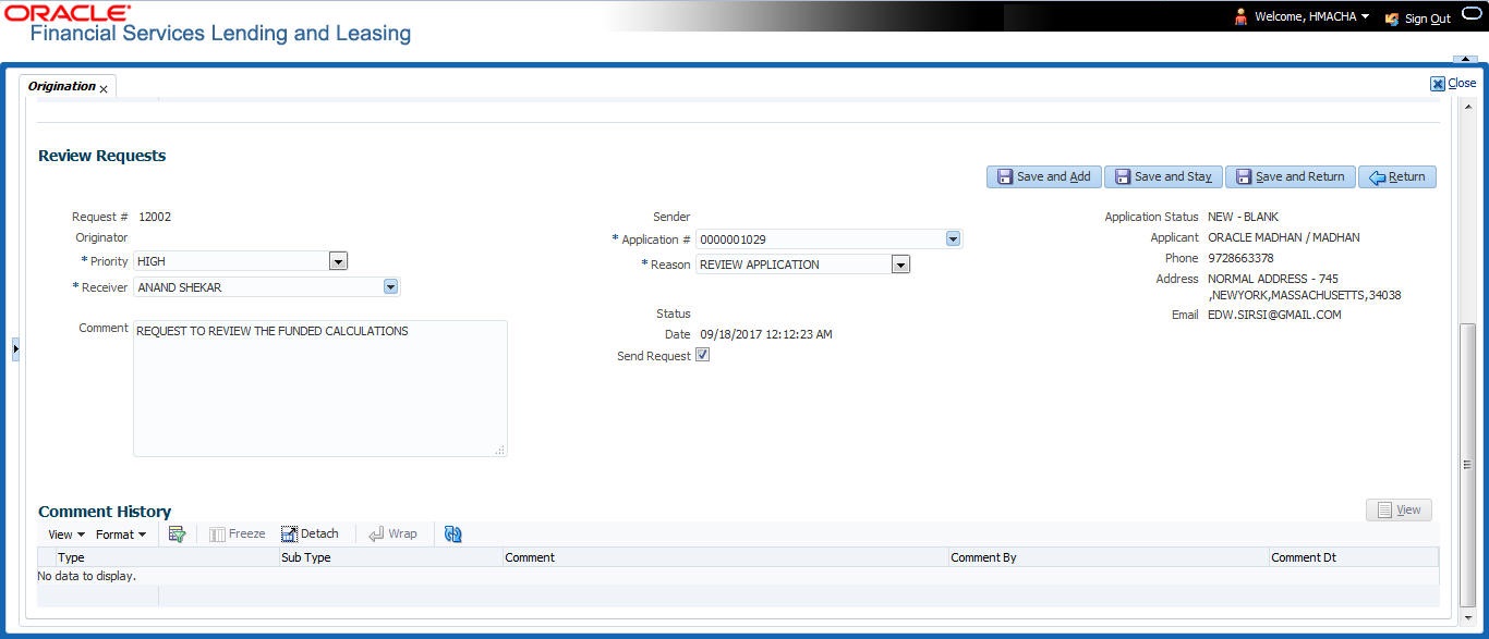

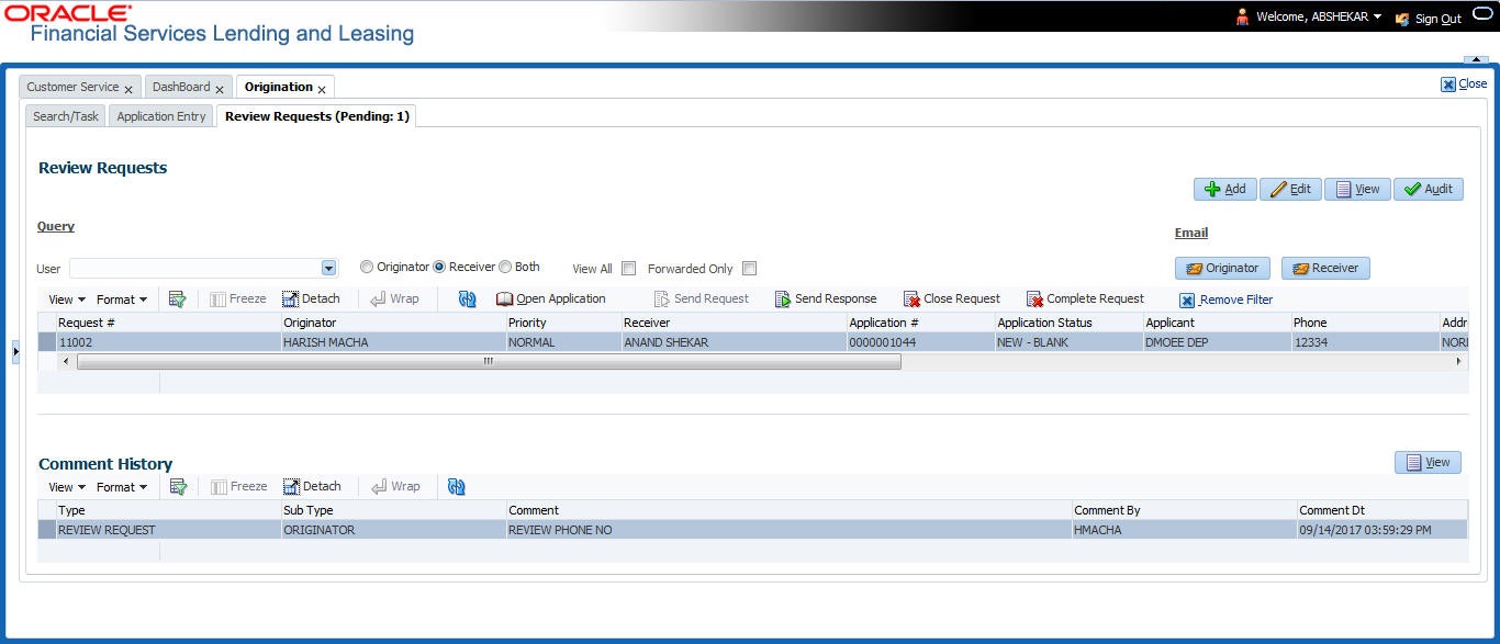

7.19 Review Request
The Review Requests screen is primarily a work flow tool used to flag an Application for the attention of another Oracle Financial Services Lending and Leasing user and ask for review / feedback. It allows the system users to send and receive requests (including e-mail) commenting on a specific Application. The Review Request tab supports iterative review of selected Application and also to process the review with multiple reviewers.
In this chapter, you will learn how to compete the following tasks:
Note
To complete the above mentioned tasks for an Application Review Request, use Review Request tab available in the Origination (Application Entry, Underwriting and Funding) screens.
7.19.1 Filter and View Review Requests
The Review Requests tab contains the following sections:
Query Section
The Query section enables you to filter records based on User and type of review requests using any of the following options:
The ‘User’ drop-down lists your User ID along with your Supervisor ID if the same has been defined in User Definition screen (Setup > Administration > User > Users). If you are the supervisor, you can view all your subordinates User ID’s along with yours for selection.
On selecting a particular User ID from the list, system displays all the requests which are created, reviewed, closed and completed by that user.
You can further filter the review request based on the following:
Query Options
Descriptions
Originator
Displays the records of all the active review requests created by the selected User.
Receiver
Displays the records of all the active review requests received by the selected User.
Both
Displays all the review requests records created as well as reviewed by the selected User with the status other than ‘CLOSED’ and ‘COM­PLETED’.
View All
Displays all the review requests records created as well as reviewed by the selected User with all the statuses.
Forwarded Only
Displays all the review requests records which are forwarded by the selected User to another user for review.
Action Section
The Action section enables you to Send (create), Respond, Close, or Complete the review request.
Action Options
Descriptions
Open Applica­tion
Displays the Application Entry screen with the Application details assigned for review.
Send Request
Sends a review request to another Oracle Financial Services Lend­ing and Leasing user.
Send Response
Sends a response to a review request received from another Ora­cle Financial Services Lending and Leasing user.
Close Request
Changes the status of review request to CLOSED and can be viewed by selecting ‘View All’ option in the ‘Query’ section.
Complete Request
Changes the status of review request to COMPLETED and can be viewed by selecting ‘View All’ option in the ‘Query’ section.
Remove Filter
Removes the selected filters applied to narrow the view of review request. The option is available when a review request is accessed from DashBoard > My Pending Review Requests section.
Email Section
The Email section enables you to send an email to either originator or receiver of the review request if an email setup is configured. However, note that a review request cannot be responded or replied back from email recipient.
Email Options
Descriptions
Originator
Sends an email of review request information to the person listed in the Originator column on Review Request page.
Receiver
Sends an email of review request to the person listed in the Receiver column on Review Request page.
The ‘Review Requests’ section in Origination screen displays the following information for each record:
Fields
Descriptions
Request #
View the system generated review request number. The same can be used to query and track the review requests.
Originator
The user id of the review request originator.
Priority
The request priority: HIGH, NORMAL, or LOW.
Receiver
The recipient of the review request.
Application #
The Application number which needs review.
Application Status
The Application status of the request being reviewed.
Applicant
Applicant’s name in the review request.
Phone
Applicant’s phone number in the review request.
Address
Applicant’s address in the review request.
Email
Applicant’s email in the review request.
Reason
Stated reason in the review request.
Status
The current status of review request. Following status are tracked in this column:
WAITING FOR RESPONSE - when request is sent to reviewer
RETURN TO ORIGINATOR - when reviewer has responded to request
CLOSED - when the request is closed
COMPLETED - when the request is completed
Date
The date and time when the review request was created.
Comment History
The ‘Comment History’ section displays the log of comments or additional information added by originator or receiver while creating or reviewing a request.
During an iterative review, where there are multiple trails of communication exchanged between originator and receiver, the ‘Comment History’ section tracks all the updates as individual records for reference.
The Comment History section also allows you to know the actually reviewer when an Application review request is forwarded to multiple reviewers and is reviewed or completed by second or third person other than the one assigned by originator.
In the Comment History section, you can view the following details of the selected review request:
Comments From
Descriptions
Type
View the type of request and is indicated as REVIEW REQUEST by default as maintained in ‘COMMENT_TYPE_CD’ lookup code.
Sub Type
View the sub type of request which can be ORIGINATOR, RECEIVER, or SYSTEM GENERATED as maintained in COM­MENT_SUB_TYPE_CD lookup code.
Note: The sub type ‘SYSTEM GENERATED’ is automatically posted by the system when the review request is forwarded to another user by the assigned reviewer. The same is also updated with a com­ment in the next column.

7.19.2 Create and Send Review Request
The review request tab primarily allows you to flag an Application for the attention of another OFSLL user through a request asking for review / feedback. While doing so, you can either choose to send it to the reviewer immediately on creating the request or only create the request and later send for review.
To Create and Send Review Request
  1. On the Oracle Financial Services Lending and Leasing Application home page, click Origination > Simple Application Entry / Application Entry / Underwriting / Funding screen and select ‘Review Requests’ tab.
  2. In the Review Requests section, select ‘Originator’.
  3. Click ‘ADD’. You can also perform any of the Basic Operations mentioned in Navigation chapter. A brief description of the fields are given below:
    In this field:
    View this:
    Request #
    View the system generated request number.
    Originator
    View the requester’s user ID auto generated by system upon creating the request.
    Priority
    Select the priority of review request as High, Normal, or Low from the drop-down list. This helps the reviewer to prioritize the request while responding but does not affect the order in which messages are sent or received.
    Receiver
    Select the user ID of the reviewer from the drop-down list.
    Comment
    Specify additional details for review (if any) which can be sent to the reviewer along with the review request.
    Sender
    View the user ID of previous reviewer, if a request has been forwarded to another reviewer.
    Note: A forwarded review request can only be viewed in the review request tab by filtering user ID of previous reviewer and selecting ‘Forwarded only’ check box.
    Application #
    Select the Application to be reviewed from the drop-down list. The following fields are auto-populated based on selection:
    Application Status
    Applicant
    Phone
    Address
    Email
    Reason
    Select the purpose for request from drop-down list.
    Status
    View the status of review request auto updated by system upon creating the request.
    Date
    View the date and time when the request was created. Sys­tem appends the current date by default.
    Send Request
    (Optional) Select this check box to send it to reviewer immedi­ately on creating the request.
    However, if the request still need changes, retain the check box unselected and proceed to create the request. The same can later be sent for review by selecting ‘Send Request’ option from the action section.
  4. Perform any of the Basic Actions mentioned in Navigation chapter.
The review request(s) appear on the recipient’s ‘My Pending Review Request’ window in DashBoard and also on the ‘Review Request’ tab header with (Pending: <count of unseen requests>). The status of request is updated as WAITING FOR RESPONSE.
