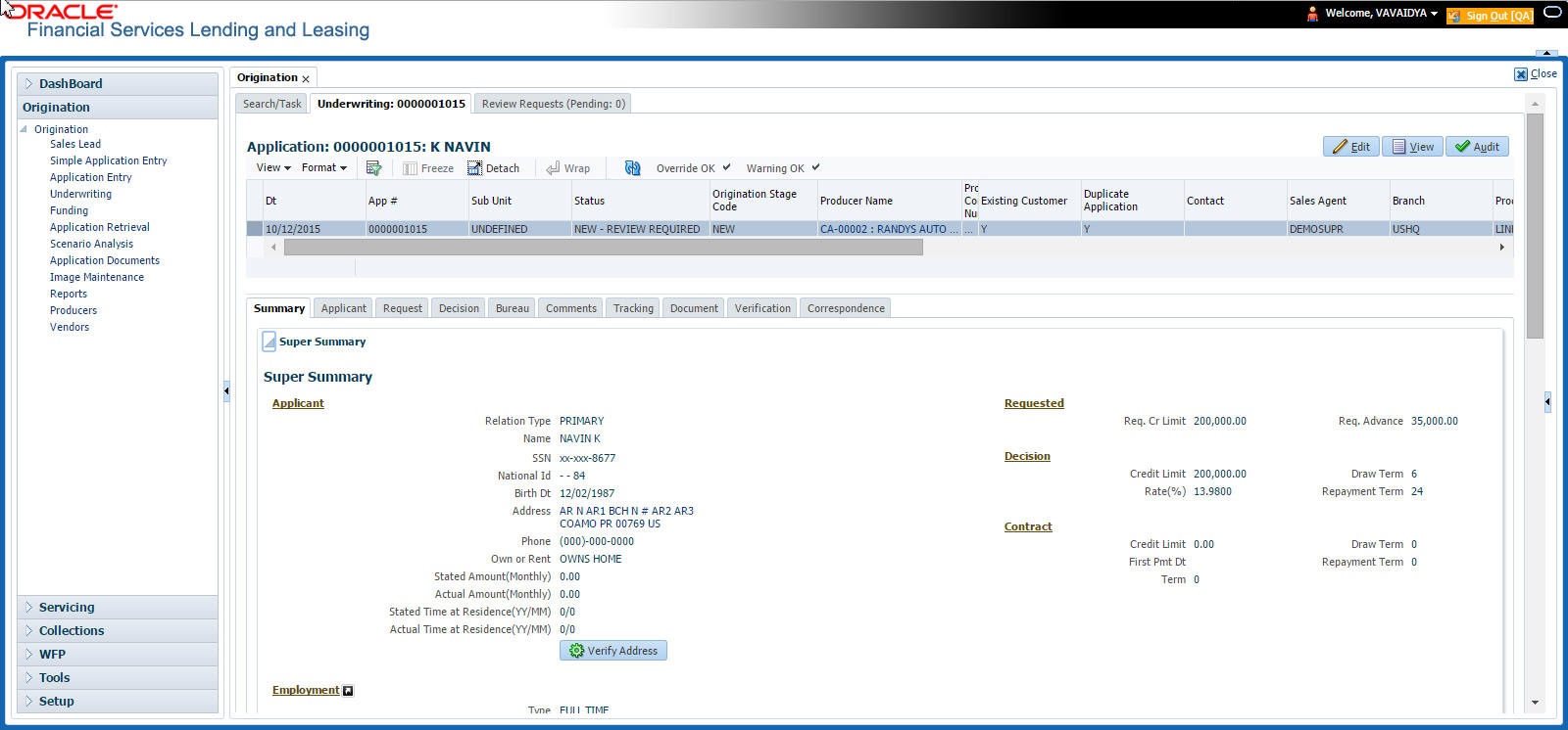

7.4 Summary Tab
The summary screen provides a unified view of the application details without navigating to the respective screens/ sub-tabs.
Using this screen, you can view the following details in their respective sections:
To view the Super Summary
  1. Open the Underwriting screen and load the application you want to work with.
  2. Click Summary tab. By default the system opens the summary tab. Expand the Super Summary section.
The Super Summary tab provides a snapshot of all relevant details in a single screen and contains details of Applicant, Employment, Ratios, Bureau, Requested financials, Decision updates, Contract updates and Primary Collateral details. You need not have to navigate to each of these tabs for specific information on the application. Also clicking on the hyperlinks of Address, Employment, Ratios, and Trade-In helps you to directly navigate to respective tab(s),
During the Underwriting and Funding stages, 'verified' button is displayed just below the address and employment details for each of the applicants. This would be enabled only when the Verified by and Verified Dt in the respective tabs are blank. You can verify the details from the Super Summary tab. Clicking on Verified will do the following:
  1. System will copy the stated values to Actual values.
  2. System will stamp the “Verified By” as 'User Name' and 'Verified Date' as 'Current GL Date' for the respective applicant.
  3. If 'Verified Details' are already updated in tab or if the details are stamped, this button will be disabled.
  4. 'Verified' button will be available when 'Actual Amount' equal to ZERO or 'Verified By' or 'Verified Date' is NULL.
You need not navigate to Address and Employment tab for verifying applicant details.
Decision details will be displayed when application has Origination Stage as “Review, Decisioned, Contract or Funded”. In case an application is Rehashed, only Decision information will be displayed and Contract information will not be displayed. Contract details will be displayed when application has Origination Stage as “Contract or Funded”.
The system displays the collateral details maintained in the collateral tab on click of navigation button under the headings Primary Collateral and Secondary Collateral. Collateral details for Unsecured loan also will be displayed if they are maintained.
All the trade-in details, if any, maintained in the application would be displayed on click of Navigation button.

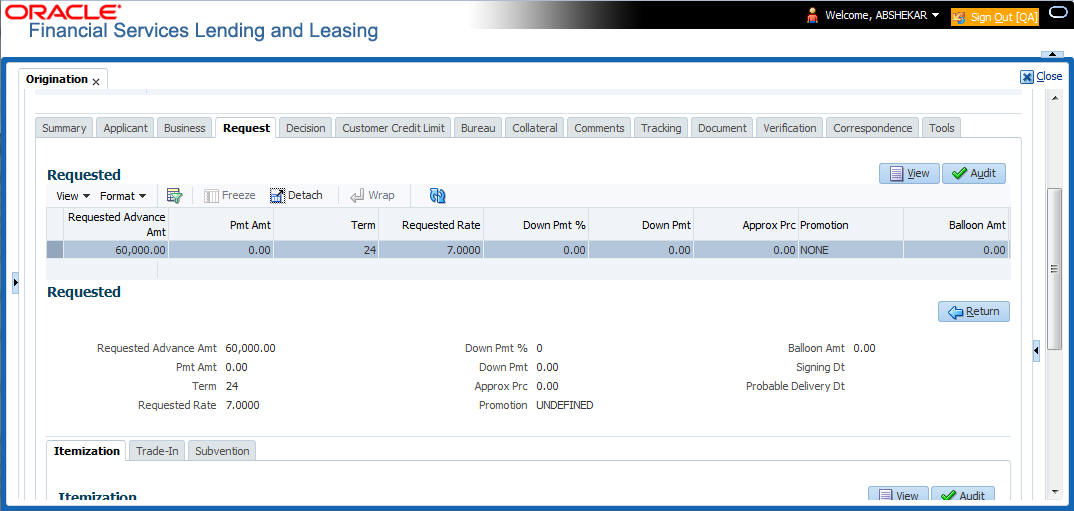

7.7 Request Tab
In the Request tab you can define the required Loan parameters and calculate Payment, Interest Rate, Term and Loan Amount using the quick calculator. By default, system calculates for monthly repayment term basis. The payment frequency can be changed only in the Underwriting tab during decisioning.
To complete Request section:
  1. On the Application Entry tab, click Request tab.
  2. Perform any of the Basic Operations mentioned in Navigation chapter.
A brief description of the fields are given below:
Field
Do this
Requested Advance Amt
Specify the requested advance amount
Pmt Amt
Specify the requested payment amount.
Term
Specify the requested term (number of payments).
Requested Rate
Specify the requested rate of interest.
Down Pmt%
Specify the down payment percentage
Down Pmt
Specify the down payment amount
Approx Prc
Specify the approximate cash price
Promotion
Select the promotion type from the drop-down list.
Balloon Amt
Specify the balloon amount.
Signing Dt
Specify the signing date
Probable Delivery Dt
Specify the probable delivery date.
  1. Perform any of the Basic Actions mentioned in Navigation chapter.
  2. In the ‘Requested’ section, there is a drop-down list adjacent to the ‘Calculate’ button with following options to auto calculate different Loan parameters based on the data provided. Select the record you want to work with and from the drop-down option, select the option you want system to calculate:
    • Calculate Payment
    • Calculate Interest Rate
    • Calculate Term
    • Calculate Loan Amount
  1. Click Calculate. The system displays the requested calculation in the respective field.

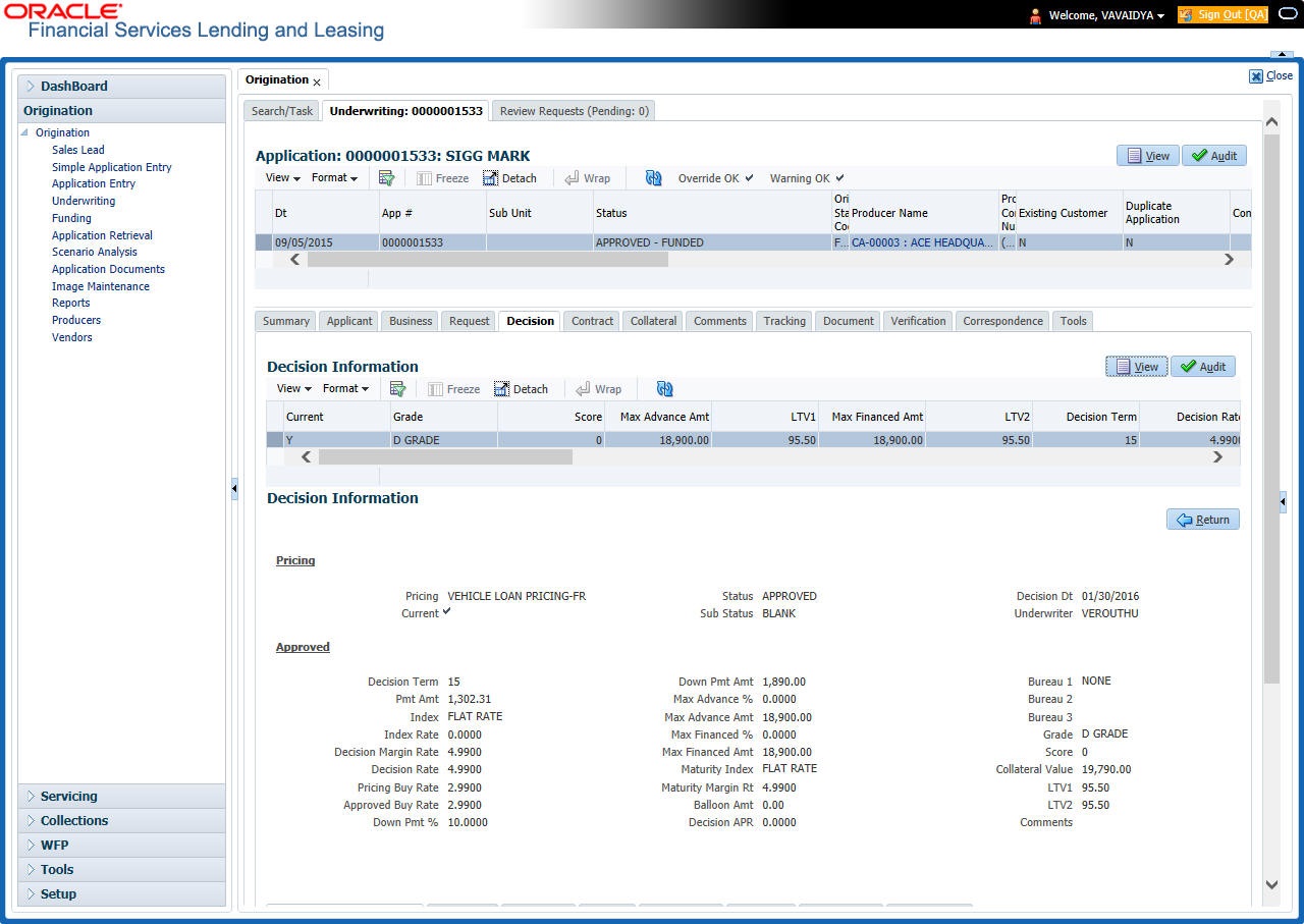

7.8 Decision Tab
If the application was initially approved automatically, the system displays its recommendations on the Decision tab’s Approved section.
If the application was initially rejected automatically, the system displays its reasons on the Decision link’s Stipulation sub tab.
If you choose to approve or reject the Loan manually, you must manually select the pricing (rule) set by the portfolio company for a specific product. The system validates this pricing against the information in the System Recommendation sections. The information in the Requested section comes from the application entry process and can be edited.
You can use the quick calculator provided with the drop-down list adjacent to the ‘Calculate’ button to calculate the required Loan parameters. You can also use the calculator available in Tools section for completing this step. For detailed information on using the Calculator tools, refer “Tools” chapter in the document.
To verify the application decision data
  1. Open the Underwriting screen and load the underwriting application you want to work with.
  2. Click Decision tab.
  3. Perform any of the Basic Operations mentioned in Navigation chapter.
    • A brief description of the fields is given below:
      Field:
      Do this:
      Pricing section
      Current
      Check this box to indicate that this is the current deci­sion.
      Pricing
      View the pricing.
      Decision Dt
      View the decision date.
      Underwriter
      View the underwriter id.
      Status
      View the application status.
      Sub Status
      View the application sub-status.
      Approved section
      Decision Term
      Specify the approved decision term.
      Pmt Amt
      Specify the approved payment amount.
      Index
      Specify the index type.
      Index Rate
      Specify the approved index rate.
      Decision Margin Rate
      Specify the approved decision margin rate.
      Decision Rate
      Specify the approved decision rate.
      Note: For Islamic products this field is displayed as ‘Profit Rate’.
      Pricing Buy Rate
      View the pricing buy rate.
      Approved Buy Rate
      View the approved buy rate which is by default the Pric­ing Buy Rate displayed above. You can also specify the required approved buy rate.
      Down Pmt %
      Specify the approved down payment percentage.
      Down Pmt Amt
      Specify the approved down payment amount.
      Max Advance %
      Specify the approved advance percentage.
      Max Advance Amt
      Specify the approved advance amount.
      Max Financed %
      Specify the maximum amount financed percentage.
      Max Financed Amt
      Specify the maximum amount financed.
      Maturity Index
      Select the approved post maturity index.
      Maturity Margin Rt
      Specify the maturity rate.
      Balloon Amt
      Decision APR
      Specify the decision APR.
      Bureau 1
      Specify the Bureau 1.
      Bureau 2
      Specify the Bureau 2.
      Bureau 3
      Specify the Bureau 3.
      Grade
      Select the credit grade.
      Score
      Specify the credit score.
      Collateral Value
      View the collateral value.
      LTV1
      View the loan to value ratio.
      LTV2
      Comments
      Specify comments, if any.
  2. Click Select Pricing.
The system determines the best pricing match of all enabled Loan pricing strings in the Setup menu and displays the results in the Pricing and Approved sections.
  1. Quick Calculate
In the ‘Decision Information’ section, there is a drop-down list adjacent to the ‘Calculate’ button with following options to auto calculate different Loan decision parameters based on the data provided. Select the required option from the drop-down list and click ‘Calculate’:
    • Calculate Payment
    • Calculate Term
  1. Re-Score
A 'Re-Score' button is available next to 'Calculate'. Whenever any sensitive Financial or Collateral information is amended in the Application, OFSLL displays a warning message 'Scoring sensitive information is changed. Re-score the application'. You need to click on Re-Score to re-validate the grade and pricing accordingly.
The display of the warning message to Re-score the application can be controlled using the respective System parameter. If the defined System Parameter is flagged 'Y', only then the message is displayed.
If you are underwriting a Loan, record the following information on the Decision tab:
  1. If you are approving the application, complete the Approved section with the values you want to approve as an underwriter. You can update the default values that appeared when you selected the pricing string in step 3. (The system calculator may be of use when completing this section. For more information, refer the Tools chapter.)
  2. Click Calculate. The system displays the decision calculation in the respective field.

A brief description of the fields in Requested section are given below:
Field
Do this
View the requested advance amount
Pmt Amt
View the requested payment amount.
Term
View the requested term (number of payments).
Requested Rate
View the requested rate of interest.
Down Pmt%
View the down payment percentage
Down Pmt
View the down payment amount
Approx Prc
View the approximate cash price
Promotion
View the promotion type from the drop-down list.
Balloon Amt
View the balloon amount.
Signing Dt
View the signing date
View the probable delivery date.
