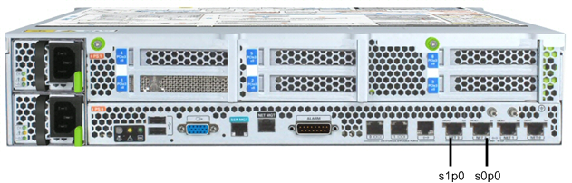

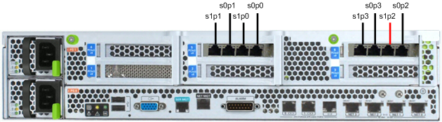

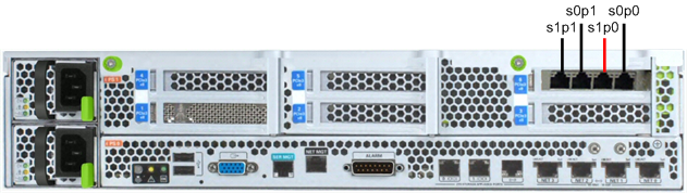

The following procedure explains how to cable the media and signaling ports. These ports accept copper GigE connectors.
Regardless of configuration, media ports support 10/100/1000BASE-T only. Do not attempt to connect 10GBASE-T equipment to the signaling and media ports.
Perform all cabling procedures according to the established standards for your organization.Prerequisites:
- Category 6 (or better) Ethernet cables with RJ-45 jacks
