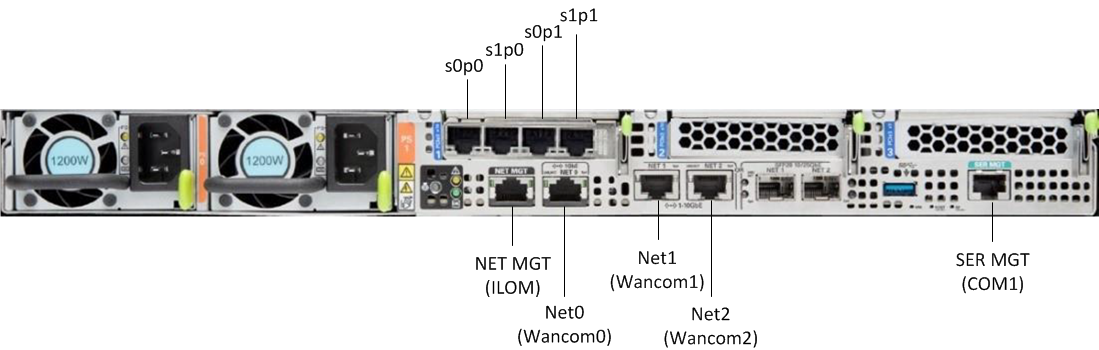

The 10/25GbE SFP+ Ethernet ports (NET 1 and NET 2) are the dedicated HA ports for the server. When using an SFP+ port, network connectivity is disabled on the 10GBASE-T RJ-45 GbE (NET 1 and NET 2) Ethernet ports.Figure 1-11 Oracle X7-2 Configuration A (4x10 GigE NIC)
Figure 1-12 Oracle X7-2 Configuration B (Two 4x10 GigE NICs)
Figure 1-13 Oracle X7-2 Configuration B (One QSFP and One 4x10 GigE NICs)
