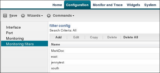

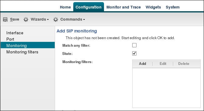

SIP Monitor and Trace Filter Configuration
The SIP Monitor and Trace function allows you to monitor SIP sessions for notable events and display the results in the Oracle Enterprise Communications Broker (OECB) SIP Notable Events summary. Such information may help you perform troubleshooting. For more targeted monitoring, you can configure filters on particular users and addresses on the OECB, and on a specific agent.
- The SIP Interface
configuration page displays the
Monitoring
filters object in the navigation pane, which you use to configure
individual filters.
- The
Monitoring object on
the SIP interface configuration page displays the
Monitoring
filters element in the dialog. Use it to apply filters to the
OECB.

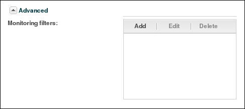

- The Add Agents configuration
page displays theMonitoring filters
configuration element to the Advanced section. Use it to apply filters to an
agent.
After the P-CZ2.0.0m4 release, the system does not support the former "Enable SIP Monitor and Trace" setting. You must re-configure SNMP event traps through the dialogs described in this topic.
- Create one or more filters in the Monitoring Filters object. You may use an asterisk character as a filter, if you want to monitor all session data.
- Add one or more filters to the Monitoring object.
- (Optional) Add one or more monitoring filters to an agent that you want to monitor.

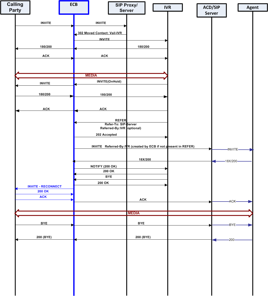

The following ladder diagram shows an example of call flow for an unattended call transfer:

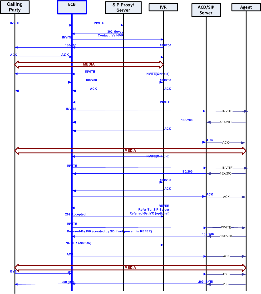

The following ladder diagram shows an example call flow of an attended call transfer:

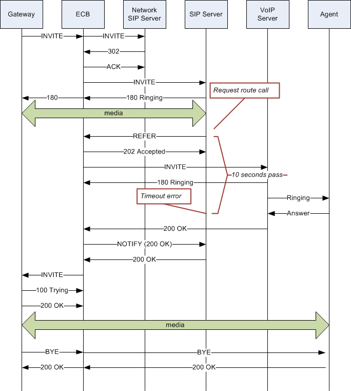

180 and 100 NOTIFY in REFER Call Transfers for the ECB
When you configure the Oracle Enterprise Communications Broker (OECB) to support REFER call transfers, you can enable it to send a NOTIFY message after it has sent either a 202 Accepted or sent a 180 Ringing message. If your network contains elements that comply with RFC 5589, and so expect the NOTIFY message after the 202 Accepted and each provisional 180 Ringing, you want to set the Send NOTIFY messages for REFER Provisional Responses to either initial or all, according to your needs.
Without this parameter changed from its default (none), the OECB does not return send the NOTIFY until it receives the 200 OK response from the agent being called. If the time between the REFER and the NOTIFY exceeds time limits, this sequencing can cause the OECB’s NOTIFY to go undetected by devices compliant with RFC 5589. Failures during the routing process can result.
The following ladder diagram shows how a sample call flow times out when the Send NOTIFY messages for REFER Provisional Responses parameter is not set.

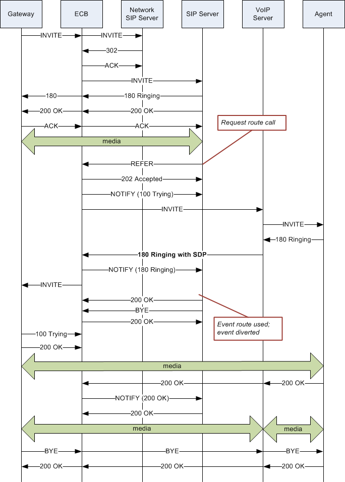

When you compare the call flow above to the following one depicting the scenario when the OECB has the Send NOTIFY messages for REFER Provisional Responses changed from its default, the difference is that the OECB now responds with a NOTIFY in response to the 202 Accepted and it sends another one after the 180 Ringing. This prevents the time out and allows the event to be diverted successfully.
