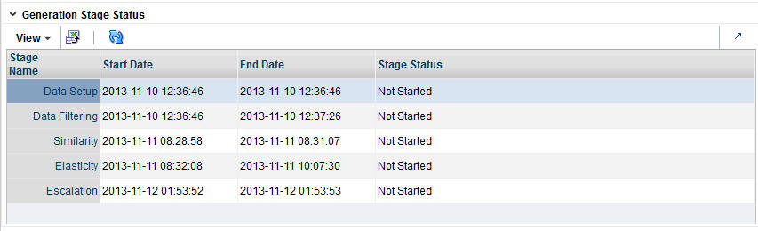

Generation Stage Status
The Generation Stage Status table displays the current status of each of the DT stages.
Click the Refresh icon to update the fields and see the latest status for each stage.
Figure 3-1 DT Generation Stage Status
Description of Figure 3-1 follows
Description of ''Figure 3-1 DT Generation Stage Status''
You can use the status information to monitor the progress of each stage. It contains the following fields, which can be arranged and viewed, but not modified.
Table 3-1 Generation Stage Status Fields
Field Name Description
Stage Name
A row exists in the table for each DT stage that provides detailed status information. The five stages are Data Setup, Data Filtering, Similarity, Elasticity, and Escalation.
Start Date
The date and time when a run for the stage most recently started.
End Date
The date and time when a run for the stage most recently ended.
Stage Status
The current status of the stage: Not Started, Not Started (Scheduled for Later), Processing, Completed Successfully, Stopped/Paused, Cancelled, or Failed.
The following table provides an explanation of the different values for the status of a stage.

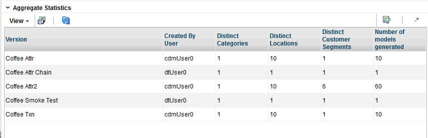

Aggregate Statistics
The Aggregate Statistics table displays statistical details about the existing DT model versions.
Click the Refresh icon to update the fields and see the latest information in this table.
Figure 3-2 DT Aggregate Statistics
Description of Figure 3-2 follows
Description of ''Figure 3-2 DT Aggregate Statistics''
Each existing version has a row in the table. The table contains the following fields, which can be arranged and viewed but not modified.
Table 3-3 Aggregate Statistics Fields
Version
User-created name that uniquely identifies this DT model version
Created By User
The user name of the person who created this version.
Distinct Categories
The number of categories associated with this version.
Distinct Locations
The number of locations associated with this version.
Distinct Customer Segments
The number of customer segments associated with this version.
Number of Models Generated
The number of DT models that have been calculated for this version.

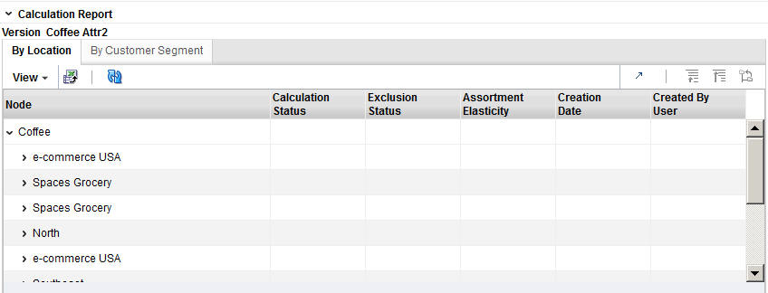

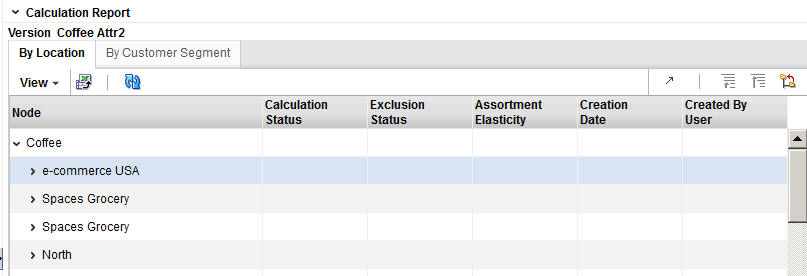

Calculation Report
The Calculation Report displays the DT model results from the last successful run, if one has occurred.
Here you can review information by Location or by Customer Segment.
Figure 3-3 DT Calculation Report
Description of Figure 3-3 follows
Description of ''Figure 3-3 DT Calculation Report''
The Calculation Report contains the following fields:
Table 3-4 DT Calculation Report Fields
Node
Identifies the node name.
Calculation Status
Yes indicates that the calculation is complete. No indicates that the calculation is not complete.
Exclusion Status
Yes indicates that data has been pruned. No indicates that data has not been pruned.
Assortment Elasticity
A number calculated by the application that is a parameter in the DT model. A larger magnitude indicates larger overall transference.
Creation Date
The date when the version whose data is displayed was created.
Created By User
The login name of the person who created the version.

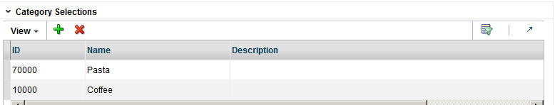

Category Selections
Use this table to add categories you want to include in the DT model calculation or delete categories that you want to remove from the DT model calculation.
Figure 3-4 DT Category Selections
Description of Figure 3-4 follows
Description of ''Figure 3-4 DT Category Selections''

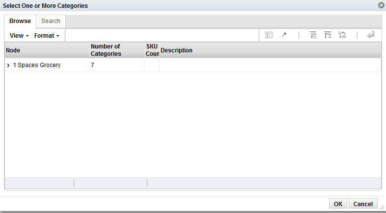

To display a list of available nodes and the categories included in those nodes, click the Add icon. You see the Select One or More Categories dialog box, which contains two tabs, Browse and Search. You can use either tab to find the categories you are looking for.
Figure 3-5 DT Browse Categories
Description of Figure 3-5 follows
Description of ''Figure 3-5 DT Browse Categories''
The Browse tab displays a table with the following fields:
Table 3-6 Category Selections: Browse
Node
The node tree structure can be expanded in order to view its categories.
Number of Categories
The number of categories within the node that has been selected. The number can help you understand the amount of processing required for the calculation.
SKU Count
The number of SKUs in a category. A category with too few SKUs may not produce good DT models.
Description
A description that provides additional information about the category.

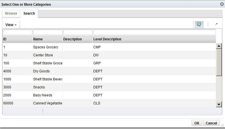

Select the category or categories within the node that you want to be part of the DT model and click OK.
Figure 3-6 DT Search Categories
Description of Figure 3-6 follows
Description of ''Figure 3-6 DT Search Categories''
The Search tab displays a table with the following fields:
Table 3-7 Category Selections: Search
Field Name Field Description
ID
An external code used to identify the category in other systems such as CMPO.
Name
The category name.
Short Description
Level Description
A description of the level of the merchandise hierarchy that the node belongs to.
Your selections are displayed in the Category Selections table.

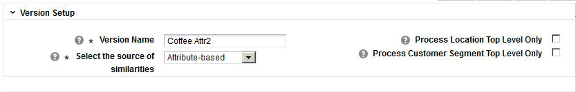

Version Setup
At the top of this stage you see two text boxes and two check boxes that you use to configure the parameters for the calculation.
Table 3-11 Version Setup: Fields
Version Name
Assign a name to each version of a DT model calculation. This allows you to create and save more than one version of a DT model. The version name you assign here is used in the Calculation Report, Aggregate Statistics table, and in the Manage DTs tab. Version names can be re-used; however, if the version name in question has active DT models, then you will see a warning that the active DT models will be removed from the version if you do re-use the version name.
Select the Source of Similarities
Use this option to define the type of data used in the calculation: transaction data or attribute data. Transaction-based data uses similarities calculated by Customer Decision Tree using transaction-based data. Attribute-based data calculates similarities within DT based on the attribute values associated with every SKU in the category.
Process Location Top Level Only
Check this option if you want DT models to be calculated for the Location Chain only. You can select this option in order to decrease the amount of time it takes the system to perform the calculation.
Process Customer Segment Top Level Only
Check this option if you want DT models to be calculated for the Customer Segment Chain only. You can select this option in order to decrease the amount of time it takes the system to perform the calculation.

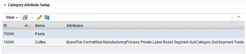

Category Attribute Setup
The application, using historical data, determines a specific weight for the category attributes. You can optionally change this weight and assign your own weight to the attributes for a category.
The weights indicate the importance of the attribute to the customers when they are making purchasing decisions. The attribute with the highest weight is the one the customer considers first when making a purchase. The system-generated weights are determined by the application from historical sales data. However, if a user disagrees with those weights, the user can override them. For example, in the case of coffee, the system may assign a weight of 0.7 to brand and 0.2 to size. This indicates that brand is historically more important to the customer than size when purchasing coffee. If the user disagrees with this analysis and thinks that brand and size are actually much closer together, the user can assign a weight of 0.5 to brand and 0.4 to size.
The Category Attribute Setup table displays the following:
Figure 3-11 DT Category Attribute Setup
Description of Figure 3-11 follows
Description of ''Figure 3-11 DT Category Attribute Setup''
Highlight the category you want to adjust the weights for and click the Edit icon. You see the Category Attributes Setup dialog box.
Figure 3-12 DT Category Attribute Setup
Description of Figure 3-12 follows
Description of ''Figure 3-12 DT Category Attribute Setup''

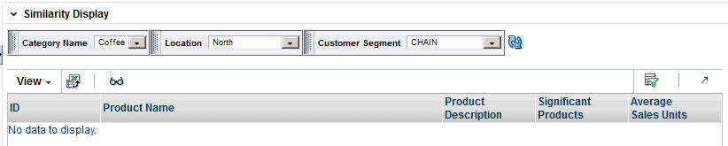

Similarity Display
The Similarity Display table shows the list of SKUs for which similarities have been calculated so that you can sort and analyze the results. You can search through the list of results by Category Name, Location, or Customer Segment.
Figure 3-13 DT Similarity Display
Description of Figure 3-13 follows
Description of ''Figure 3-13 DT Similarity Display''

Calculation Report
The Calculation Report lists the status of the elasticity calculation and the exclusion, either by Location or by Customer Segment. An assortment elasticity is calculated for each category/location/segment combination selected during the Data Setup stage and the Calculation stage. The numerical result of the calculation, an output of DT generation, is used by Manage Models to calculate substitutable demand percentages.
Figure 3-14 DT Calculation Report
Description of Figure 3-14 follows
Description of ''Figure 3-14 DT Calculation Report''
The Calculation Report has two tabs: By Location and By Customer Segment. Each tab has the following fields:
Table 3-17 Calculation Report Fields
Field Description
Node
Calculation Status
Indicates whether or not (Yes/No) the elasticity calculation has occurred.
Exclusion Status
Indicates whether or not (Yes/No) pruning has occurred.
Creation Date
Created By User

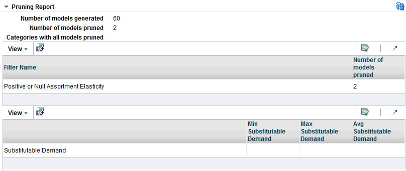

Pruning Report
The Pruning Report displays statistics about the results of data pruning.
Figure 3-15 DT Pruning Report
Description of Figure 3-15 follows
Description of ''Figure 3-15 DT Pruning Report''
The Pruning Report contains the following fields:
Table 3-18 Pruning Report Fields
Field Description
The number of DT models produced by the calculation.
Number of Models Pruned
The number of DT models pruned by the calculation.
Categories with All Models Pruned
The names of the categories for which all DT models have been pruned.
Positive or Null Assortment Elasticity
The Assortment Elasticity (AE) value is a negative number used in calculating substitutable demand percentages and demand transference effects. A positive AE value may be produced as a result of missing or unreliable input data for some partitions. Such meaningless transference effects must be pruned. In addition, if a null AE value is generated, it must also be pruned.
Substitutable Demand
Substitutable demand is a measure of how much demand is retained by the rest of the assortment when an item that is removed. When the item is removed, a portion of its demand is transferred to the remainder of items in the assortment. These values are populated when you set up the time intervals in the Manage Models tab and run the calculation there.

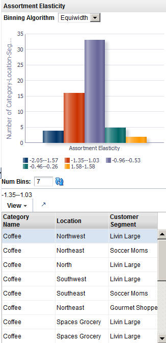

Assortment Elasticity Histogram
Figure 3-16 DT Assortment Elasticity Histogram
Description of Figure 3-16 follows
Description of ''Figure 3-16 DT Assortment Elasticity Histogram''

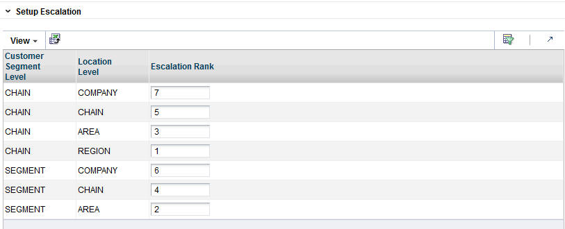

Setup Escalation
Escalation occurs along the customer segment hierarchy and the location hierarchy. Here is an example of an escalation path:
Figure 3-17 DT Setup Escalation
Description of Figure 3-17 follows
Description of ''Figure 3-17 DT Setup Escalation''
The following fields are required to set up the escalation.
Table 3-19 Setup Escalation
Field Description
Customer Segment Level
Identifies the customer segment level in the escalation.
Location Level
Identifies the location level in the escalation.
Escalation Rank
Used to assign the ranks for the escalation, which determines the order in which the escalation occurs.
Here is an example of an escalation path.
Table 3-20 Example of Escalation Path
Segment Level Location Level Escalation Rank
Segment chain
Location chain
8
Segment chain
Region
7
Segment chain
Location area
6
Segment chain
Store cluster
5
Segments
Location chain
4
Segments
Region
3
Segments
Location area
2
Segments
Store cluster
1
You fill in the order of numbers. Every row must have an ordering number, and no ordering number can be re-used.The escalation path is specific to the user and the current version that the user is working on.The default ordering is to go up the location hierarchy first, and then up the segment hierarchy, as shown in the example above. The reason is that the segment hierarchy has only two levels, and so its top level is very general.

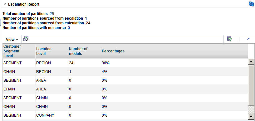

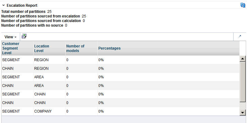

Escalation Report
The Escalation Report breaks down the numbers to provide counts for the number of positions filled with higher-level DT models and the number of partitions that have not been changed by escalation. In addition, the fraction of DT models for each partition is displayed.
Figure 3-18 DT Escalation Report
Description of Figure 3-18 follows
Description of ''Figure 3-18 DT Escalation Report''
Table 3-21 Escalation Report
Total Number of Partitions
The number of partitions in the version.
Number of Partitions Sourced from Escalation
The number of partitions removed during escalation.
Number of Partitions Sourced from Calculation
The number of partitions removed during calculation.
Number of Partitions with No Source
A partition that does not have a model assigned to it because all models related to the partition have been pruned.
Identifies the customer segment level.
Location Level
Identifies the location level.
Number of Models
The number of partitions that are trying to have a model assigned. This is generally the number of customer segments by the number of locations.
Percentages
The percentage of partitions that have been assigned a model from a given escalation level.

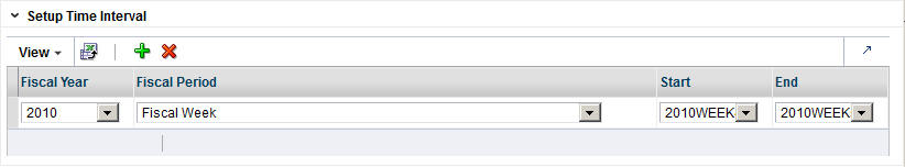

Time Interval Setup
The time interval defines the span of time for the sales history to be used to determine the amount of history that is retained when SKUs are dropped. A group of intervals can be defined. Gaps between intervals are permitted; however, intervals cannot overlap.
Figure 3-19 DT Setup Time Interval
Description of Figure 3-19 follows
Description of ''Figure 3-19 DT Setup Time Interval''
You should select a time interval for which the historical assortments are reasonably representative of the assortments that will be used in the CMPO application. Because the time interval is used to calculate the substitutable demand information, selecting a representative interval provides substitutable demand information that is highly relevant to the actual application of demand transference in CMPO. Typically, the most representative time period is a recent time interval, since that is generally when assortments are most similar to the current assortments. If you use a time period that is not recent, you run the risk of using assortments that are not as similar to the current ones. You should also make sure not to select an interval that is too large, because a large interval necessarily includes several assortment changes within that interval. An interval size of approximately four weeks is recommended.
The fields that define a time interval are:
Table 3-22 Setup Time Interval: Fields

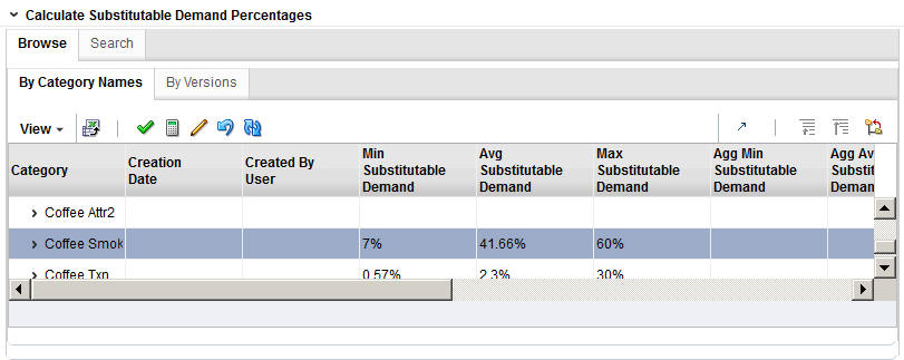

Calculate Substitutable Demand Percentages
You can vary the value for the maximum substitutable demand percentage and see the impact on selected categories or versions.
Figure 3-20 DT Calculate Substitutable Demand Percentages
Description of Figure 3-20 follows
Description of ''Figure 3-20 DT Calculate Substitutable Demand Percentages''

Agg Min Substitutable Demand
The aggregated value for the minimum substitutable demand.
Agg Avg Substitutable Demand
The aggregated value for the average substitutable demand.
Agg Max Substitutable Demand
The aggregated value for the maximum substitutable demand.
Calculation Status
Indication of whether or not (Yes/No) the calculation is complete.
Completion Status
Indication of whether or not (Yes/No) the status is active.
Completion Date
The date when the status became active.
Completion User
The user name of the person who activated the version.
Once you have made a selection, click the Edit icon and enter an override value between 0% and 100% for the Maximum Substitutable Demand Percent. Click the Calculate icon to initiate the calculation. To revert the calculation, click the Revert icon.
Once you have determined the substitutable demand value you want, you can click the Complete icon to make the version active.
Escalation Report
Figure 3-21 DT Escalation Report
Description of Figure 3-21 follows
Description of ''Figure 3-21 DT Escalation Report''
Table 3-24 Escalation Report
Location Level
Number of Models
Percentages
Histogram
The Substitutable Demand Distribution histogram displays the distribution of the substitutable demand values for SKU/stores.
