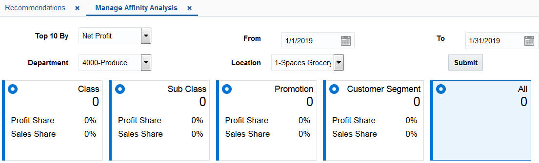

Regardless of which screen you are viewing, a set of global prompts determines the data displayed throughout the application.
On first accessing the application, you make selections from the prompts and click on the Submit button, which will load the remaining application screens based on your selections. Modifying and submitting the prompt values after that time will refresh the screens with new data.
Table 7-1 AA Global Prompts
| Prompt Name | Description |
Top 10 By |
Select the primary metric used to rank the market basket results in all places where affinity rules are displayed. |
Fiscal Week From |
Select the starting week from which results must be displayed. The values displayed are the week of the Fiscal Calendar. |
To |
Select the ending week that results must be displayed for. |
Department |
Select the department from the merchandise hierarchy that results must be displayed for. All of the classes or subclasses on the THEN side of an affinity rule will be from the selected Department. |
Location |
Select the location from the location hierarchy that results should be displayed for. |
The Top 10 By prompt allows you to select from the following metrics, which are used to determine which affinity rules are displayed and how to sort the results that are shown.
Table 7-2 Top 10 By Options
| Metric Name | Description |
Net Sales |
Chooses the top N rules in each screen, based on the net sales retail amount (e.g., Avg Sales from If Items) |
Net Quantity |
Chooses the top N rules in each screen, based on the net sales quantity (e.g., Avg Sales Quantity from If Items) |
Net Profit |
Chooses the top N rules in each screen, based on the net sales profit (e.g., Avg Profit from If Items) |
Although this prompt indicates "Top 10", you have the ability to select more than 10 results by changing the Top selection in the Market Basket Filters area of the screen, as discussed later in this chapter.
The Fiscal Week From and To prompts allow you to select a range of dates for which the results are returned. Market basket affinity rules may change over time as new sales transactions are processed, so selecting the weeks to review ensures that only the rules that are applicable for that period of time are displayed.
The Department prompt displays a list of departments from the merchandise hierarchy. Selecting a department will limit the data in all screens such that the consequent (or THEN components) of an affinity rule will be from that department.
After all selections are made and the Submit button is clicked, the interface will refresh and display results. Each section of the application is organized under an informational tile that describes the purpose of the screen, along with summarization metrics.

Clicking on any info tile's title or primary metric will display the associated data in the lower section of the screen. The data shown in each tile in the application is described in Table 7-4.
Table 7-4 Info Tile Metrics
| Tile Name | Primary Metric Description | Secondary Metric Description |
Assortment Rec |
The number of assortment recommendations available for the selected global prompt values. |
For the assortments in the department, the percentage the sales amount changed and the amount the sales changed. |
Class |
The number of class level market basket affinity rules available for the selected global prompt values. |
The share of sales profit and sales amount that is represented by all discovered association rules out of the total sales profit and sales amount processed. |
Sub Class |
The number of subclass level market basket affinity rules available for the selected global prompt values. |
Promotion |
The number of promoted subclass level market basket affinity rules available for the selected global prompt values. |
Customer Segment |
The number of customer segment promoted subclass level market basket affinity rules available for the selected global prompt values. |
All |
The total number of market basket affinity rules available for the selected global prompt values. |
The last date that market basket insights were executed on. |

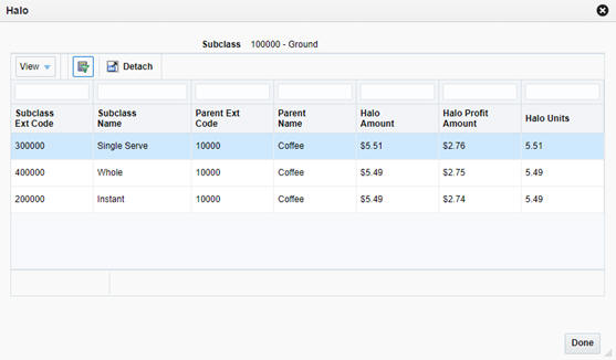

If you want to analyze the recommendations further, the system provides pop-up windows displaying Halo and Cannibalization effects relating to the selected item from the Optimized Assortment table. Select a row in the table, and then click the Halo or Cannibalization buttons on the task bar to review the data.
Table 7-7 Halo Effects
| Field Name | Description |
Subclass Ext Code |
The numeric identifier for a subclass with a halo effect from the SKU. |
Subclass Name |
The descriptive name for a subclass with a halo effect from the SKU. |
Parent Ext Code |
The numeric identifier of the parent class for a subclass. |
Parent Name |
The descriptive name for the parent class for a subclass. |
Halo Amount |
The calculated halo effect on the subclass's sales amount. |
Halo Profit Amount |
The calculated halo effect on the subclass's sales profit. |
Halo Units |
The calculated halo effect on the subclass's sales units. |
The Halo pop-up window provides insights into the secondary effect of a SKU on other products. Products with strong market basket affinities may generate large halo effects and thus be good candidates for your assortment.

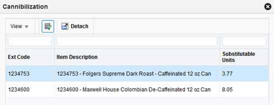

When evaluating the additions and removals on your assortment, it can also be helpful to understand cannibalization effects. These effects are based on the product similarities and assortment elasticities obtained from Demand Transference. Products that are very similar to each other tend to split up the customer demand for this kind of product, since the customer is not likely to buy two similar products. Conversely, products that are not very similar will not have as much overlapping demand. The Cannibalization pop-up window provides some of these insights.
Figure 7-4 Cannibalization Effect Pop-Up
Table 7-8 Cannibalization Effects
Ext Code |
The numeric identifier for a SKU that is cannibalized by the selected assortment SKU. |
Item Description |
The descriptive value for the SKU. |
Substitutable Units |
The calculated number of sales units that can be cannibalized from other SKUs when the assortment SKU is added, or the number of units transferred to these SKUs when the assortment SKU is dropped. |

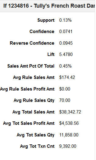

The purpose of these summary metrics is to provide a quick view of the sales and profitability of the market baskets described by each rule. Even though a market basket affinity is present in a large number of baskets, it may not generate much profit or be of particular interest to the business user at this time. The summary metrics allow the user to quickly identify market basket affinities that are worth analyzing in more detail. Once the user has selected a rule to investigate, clicking that row in the table generates additional information about it in a panel to the right side of the screen.
Figure 7-8 Market Basket Affinity Details
Table 7-13 Market Basket Affinity Details

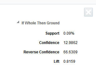

Support |
The percent of market baskets that contain items from the IF and THEN components of the rule. Written as a formula: Rule Transaction Count/Total Transaction Count |
Confidence |
The ratio of the number of transactions where the entire rule is present, compared to all transactions containing IF items. Written as a formula: Rule Transaction Count/Total IF Transaction Count |
Reverse Confidence |
The ratio of the number of transactions where the entire rule is present, compared to all transactions containing THEN items. If a rule has a higher Reverse Confidence than its own Confidence value, then it indicates that the rule is better represented by the reversal of the IF and THEN components. Written as a formula: Rule Transaction Count / Total THEN Transaction Count |
Lift |
A statistical measure of how strong the product affinity is, as compared to random chance for the rule (higher is better). Written as a formula: Rule Transaction Count * Total Transaction Count / Total IF Transaction Count/Total THEN Transaction Count |
Sales Amt Pct Of Total |
The percent of total sales retail amount that the rule represents. Written as a formula: Rule Sales Amount/Average Weekly Total Sales |
Avg Rule Sales Amt |
The average weekly sales retail amount across all transactions containing the rule. |
Avg Rule Sales Profit Amt |
The average weekly sales profit across all transactions containing the rule. |
Avg Rule Sales Qty |
The average weekly sales units across all transactions containing the rule. |
Avg Total Sales Amt |
The average weekly sales retail amount across all transactions. |
Avg Tot Sales Profit Amt |
The average weekly sales profit across all transactions. |
Avg Tot Sales Qty |
The average weekly sales units across all transactions. |
Avg Tot Txn Cnt |
The average weekly transaction count across all transactions. |
The detailed metrics for a rule provide more ways to evaluate if the rule is going to be useful for your business purpose. For example, a rule that has both high support and high confidence represents a strong product affinity that is purchased by many of your customers. Any action taken on the categories in such a rule, such as promoting a subclass on the IF side of the rule, can have significant benefits for the THEN components of the rule. Another way to use these metrics is to consider the average sales or profit that a rule brings in relative to total sales over the same period. Rules that represent a significant profit amount may be a more valuable target for your efforts than rules with lower profitability.

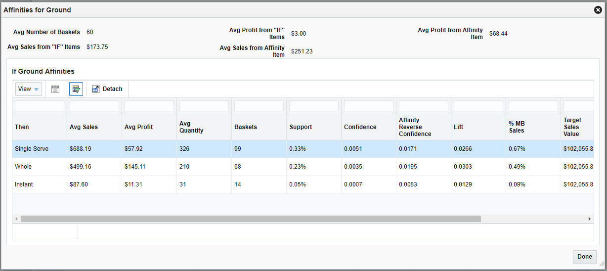

Another way to view the market basket affinities is to click the button found to the left of each row in the data table. This button displays a pop-up window with all of the product affinities that have been found for the IF components of the rule. This can be especially useful when your goal is to find any relationships with a specific product category, rather than seeing all of the relationships between different products.
Figure 7-9 Targeted Product Affinities Pop-Up
This screen is split into two main sections: the top section displays summary metrics for all rules associated with the IF components, and the bottom section displays all of the product affinities found for the IF components and a selection of detailed metrics for them.
Table 7-14 Targeted Product Affinities Summary Metrics
Avg Number of Baskets |
The average number of baskets found on a rule containing the IF items. |
Avg Sales from IF Items |
The average sales retail amount for the IF items in the rules. |
Avg Profit from IF Items |
The average sales profit for the IF items in the rules. |
Avg Sales from Affinity Item |
The average sales retail amount for the THEN items in the rules. |
Avg Profit from Affinity Item |
The average sales profit for the THEN items in the rules. |
Table 7-15 Targeted Product Affinities Detail Metrics
Then |
Displays the class or subclass that was found to have an affinity with the IF components of the market basket rule. |
Avg Sales |
The average weekly sales retail amount for the IF and THEN items in the rules. |
Avg Profit |
The average weekly sales profit for the IF and THEN items in the rules. |
Avg Quantity |
The average weekly sales units for the IF and THEN items in the rules. |
Baskets |
The number of market baskets that contain items from the IF and THEN components of the rule. |
Support |
The percent of market baskets that contain items from the IF and THEN components of the rule. |
Confidence |
The ratio of the number of transactions where the entire rule is present, compared to all transactions containing IF items. |
Affinity Reverse Confidence |
The ratio of the number of transactions where the entire rule is present, compared to all transactions containing THEN items. |
Lift |
A statistical measure of how strong the product affinity is, as compared to random chance for the rule (higher is better). |
% MB Sales |
The percent of total sales retail amount that the rule represents. |
Target Sales Value |
The average weekly total sales retail amount across all transactions in the selected periods. |
Target Profit |
The average weekly total sales profit across all transactions in the selected periods. |
Target Sales Quantity |
The average weekly total sales units across all transactions in the selected periods. |

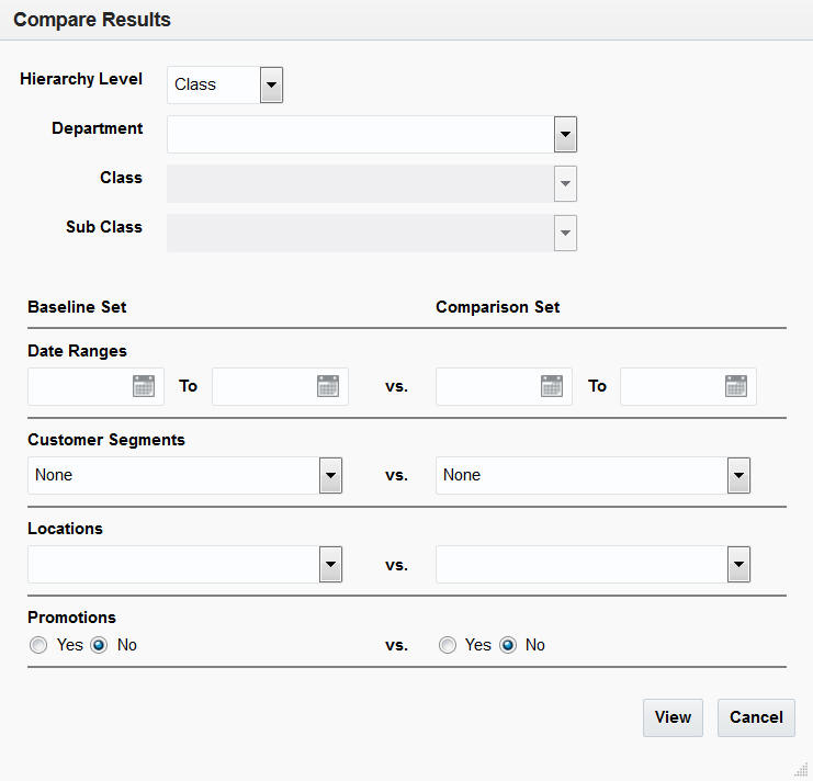

Two types of comparison are available: Compare Runs and Compare Results.
Use Compare Runs to select specific runs to compare. This comparison is useful for straightforward runs such as comparing the results of two different months.
Use Compare Results to compare system runs only, with specified dates and other filters. In this case, take care in selecting runs that overlap, as some runs may be represented in the results more than once.

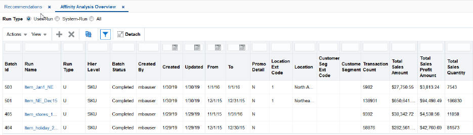

The Affinity Analysis Overview screen provides the tools shown in Figure 7-10. In addition to the standard application functionality, you can also

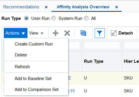

Select from the following functionality using the Action drop-down menu:

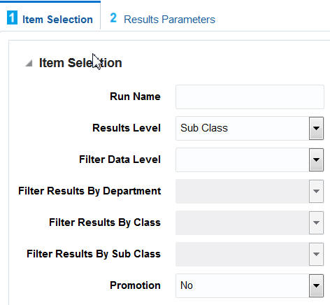

Create Custom run
Delete
Refresh
Add to Baseline Set
Add to Comparison Set
Select the type of run to view in this screen: User-Run, System-Run, or all runs.
Figure 7-10 Affinity Analysis Overview Functionality
The Affinity Analysis Overview table, shown in Figure 7-11, displays the list of completed runs and contains the following fields.
Figure 7-11 Affinity Analysis Overview Table
Table 7-16 Affinity Analysis
Batch ID |
Identifies the run. |
Run Name |
User-provided name for the run. |
Run Type |
U = User -Run; S = System-Run. |
Hier Level |
Hierarchy level. |
Batch Status |
Indicates the status of the run. Helps to determine if the run has completed, encountered any errors, or has not yet completed. |
Created By |
User name of person who created the run. |
Created |
Date when run created. |
Updated |
Date when run last updated. |
From |
Beginning date for run data collection. |
To |
Ending date for run data collection. |
Promo Detail |
Y indicates that the market basket affinities between different subclasses are displayed when the antecedent (if) components are promoted and the consequent (then) components are not promoted. N indicates that no consideration is given to whether or not the items are promoted. |
Location Ext Code |
The numeric identifier for the location. |
Location |
The external identifier for the location. |
Customer Seg Ext Code |
The external identifier for the customer segment. |
Customer Segment |
The name of the customer segment which the results are for. Values include Soccer Mom, Simply Seniors, Value Seekers, Gourmet Shoppers, Livin Large. |
Transaction Count |
Total number of transactions processed for this run. |
Total Sales Amount |
Total sales amount processed for this run. |
Total Sales Profit Amount |
Total sales profit amount processed for this run. |
Total Sales Quantity |
Total sales quantity processed for this run. |

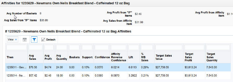

Click the right-hand icon for a specific row in the Results table to see If/Then Affinities for...pop-up. The pop-up shows all the other rules that have been discovered for the same If item. You can use this to compare the rules. In this way, you may discover another product with a stronger affinity for the item.
The pop-up has the following fields.
Table 7-19 Affinities For
| Field | Description |
The average number of baskets across the runs for the combination of the If and Then items. |
Avg Sales from "If" Items |
The average sales retail amount from items belonging to the IF classes or subclasses. |
Avg Profit from "If" Items |
The average sales profit from items belonging to the IF classes or subclasses. |
The average sales retail amount from item belonging to the THEN class or subclass. |

To compare results, select the two runs you want to compare. Highlight one run and click Add to Baseline Set. Highlight the second run and click Add to Comparison Set. You see these selections in the Compare Results right panel.
Click View to see the comparison. the View Results pop-up displays, which can be filtered by a combination of Department Item, Class, Top Results By, Subclass, and Top Results Displayed.
The results are displayed as a pair of rows for each item, a baseline row followed by a comparison row.

To create a custom run, select Create Custom Run from the Action drop-down. You see the Create Custom Run pop-up with two pages - Item Selection and Results Parameters. Need more info about recommendations to create a run.
Use the Item Selection page to select the items to include in the results, including the level of the results and the hierarchy nodes to include.
Provide a meaningful name for the Run Name that can help identify the run.
The Results Level defines the level of the hierarchy that the data is created for. Lower levels can required lower thresholds on the Results Parameters page (in order to find results), while higher levels can include too many results if the settings are not increased on the Results Parameters page.
The Filter Data Level is used to define rules regarding how to filter data. For example, if the results are only required for specific departments, then select Departments as the level and then select the departments.
A Promotion value of Yes only includes results in which the If component was on a promotion. A value of No is used when there is no concern about whether a promotion was present or not.
After entering item criteria, click Add Item Selection. The bottom section of the screen is populated with the results of the selection. You can also see this information in the right panel.

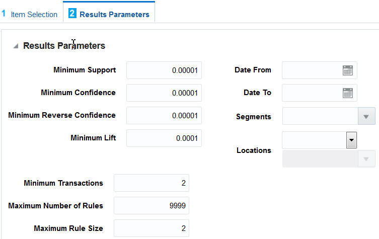

The Results Parameters page, which is shown in Figure 7-19, is displayed in the right panel. The minimum value for transactions are used to prevent a situation in which there are too many results because so many transactions have been used in the calculations.
Table 7-21 explains how to interpret these values.
Table 7-21 Results Parameters
Minimum Support |
The minimum percent of total transactions required to have this rule expressed as a decimal value. (0 - 1 range) |
Minimum Confidence |
The minimum confidence ratio required for a rule expressed as a decimal value. (0 - 1 range) |
Minimum Reverse Confidence |
The minimum confidence ratio required for the reverse rule definition, expressed as a decimal value. (0 - 1 range) |
Minimum Lift |
The minimum lift value required for a rule. |
Minimum Transactions |
The minimum value for transactions are used to prevent a situation in which there are too many results because too many transactions have been used in the calculations. This value also helps ensure some consistency if the transaction volume varies enough for Minimum Support to be used. |
Maximum Number of Rules |
The limit on the top number of rules to be saved from the results. Used to reduce data volume and remove the less significant rules. |
Maximum Rule Size |
The number of components to be included in a rule. The value of 2 is only supported for rules that include promotion or item results; otherwise, the value of 3 is supported. The additional components are always on the If side of the rule. |
Dates From and To |
The date range for processing sales data. This value must not span an excessive length of time, as the amount of data processed can become too large to manage reasonably. |
Segments |
Select any customer segments that should be included when determining the sales transactions to process. |
Location |
Limit the locations that should be included when determining the sales transactions to process. This can be done by selecting any hierarchy level and then multi-selecting any locations at that level. |
Use the Manage Affinity Analysis screen to view the results from all system created runs. Set the filters, select a range of calendar dates, and click Submit. The Info Tiles are displayed.
Figure 7-20 Manage Affinity Analysis Filters
Info Tiles
The Info Tiles display the results from all system runs. Once you specify the filters to indicate what runs you want to use, the Info tiles display an aggregate view of the results for different hierarchy levels and the types of processing that were executed during the run. Select an Info Tile and use the filters below the tiles to view the affinities for your selection.
Each tile has specific filters. Here is an example of the filters for the All tile.
You can use Compare Results to compare system runs only, using the dates and filters you specify, as shown in Figure 7-23.
Click View. Table 7-20 describes the results of the Compare Results functionality.
