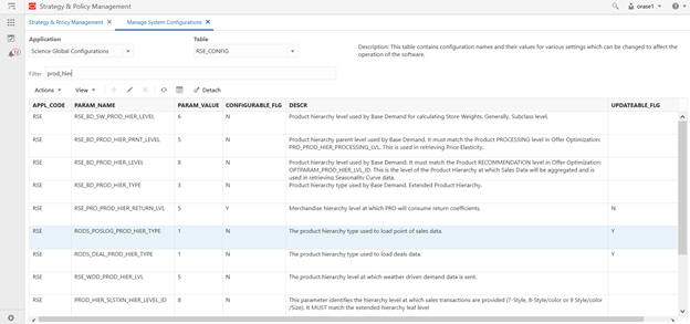

In Strategy & Policy Management, a user can edit the configurations of different applications via the Manage System Configurations functionality. In this screen, the tables can be filtered by applications.
To edit a row in any table, click the row and click the Edit icon. You can override the values for the columns that are editable.

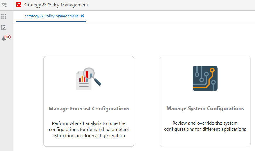

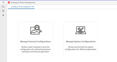

Use the Manage Forecast Configurations to set up, manage, and configure the demand forecasting runs for different applications such as Offer Optimization (OO) and Inventory Optimization (OO).
Figure 13-2 Strategy & Policy Management Dashboard
Figure 13-3 Manage System Configurations
This section describes the work flow and screens in Manage Forecast Configurations. With this functionality, you can set up and manage the forecast run types and forecast runs for different applications.
You can access Manage Forecast Configurations from the Strategy & Policy Management dashboard under the Control & Tactical Center.

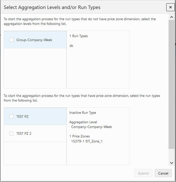

After you create a run type, you can see the aggregation status in the run type overview table. If the new run type has the same merchandise-location-calendar intersection as an existing run type, the aggregation status will be shown as complete as soon as you create the new run type because the data aggregation at that intersection has already been completed. This is applicable only for the run types that do not have a price zone and/or customer segment dimension. For the run types that do have a price zone and/or customer segment dimension, data aggregation must be done for each run type separately.
If any run type has an aggregation status of Not Started, click the Start Data Aggregation button above the run type overview table. This opens a pop-up where you can see a list of run types for which the aggregation process has not yet started, as shown in Figure 13-7. You can select one or multiple run types from the top and/or bottom section in the pop-up and click Submit to start data aggregation.
Select one or multiple rows in the run type overview table, as shown in Figure 13-7, and click the X icon above the table to delete the run types. If a run type is activated or if a run type has a run that is in progress, it cannot be deleted.
Figure 13-7 Select Aggregation Levels and Run Types

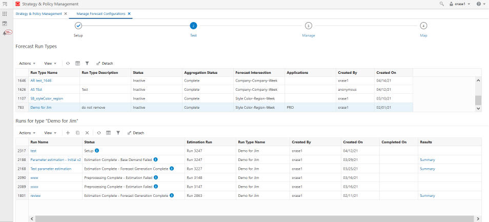

After run types are created and aggregation is complete, you can create and submit what-if runs and review the summary of the runs in the Test screen in train stop 2, as shown in Figure 13-8. Performing what-if analysis is an optional step that can help you to tune the various configuration parameters. In addition, you can see the batch runs associated with each run type in this screen.
In the Test screen, the top table shows all the run types that have complete aggregation. This table shows the same information as the run type table in the Setup screen. The bottom table shows all the what-if runs and batch runs associated with the selected run type in the top table. In addition to Run Name, Created On, Created By and Complete On, the table shows the following information about the run.
Run Status
The Status column in the run overview table shows the progress of the run by showing the status of the different stages of estimation and forecasting.

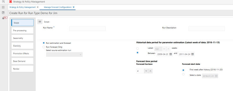

To create a what-if run, first select a run type by selecting a row in the top table. Then, click the + (plus) icon in the bottom table to open the Create Run pop-up, as shown in Figure 13-9.
The menu on the left shows the different stages of estimation and forecasting. These stages can be different, depending on the forecast method that was selected for the run type.
You can set the scope of the run, the run name, and the description in the first tab. In the left side of the Scope tab, select Run estimation and forecast to execute the end-to-end process for estimating demand parameters and generating the forecast. Alternatively, you can select Run Forecast Only and then select an estimation run from the list of previously completed estimation runs. If no such run exists, this option will be disabled.
In the right side of the Scope screen, you can select the period of historical data that should be included in the estimation process. This part will be enabled only if Run estimation and forecast is selected. You can either select a period by specifying the start and end date or by specifying the number of weeks to be used from historical data. In the Scope tab, you can also specify the time period for the forecast generation by selecting a start date for forecast period and a forecast horizon.

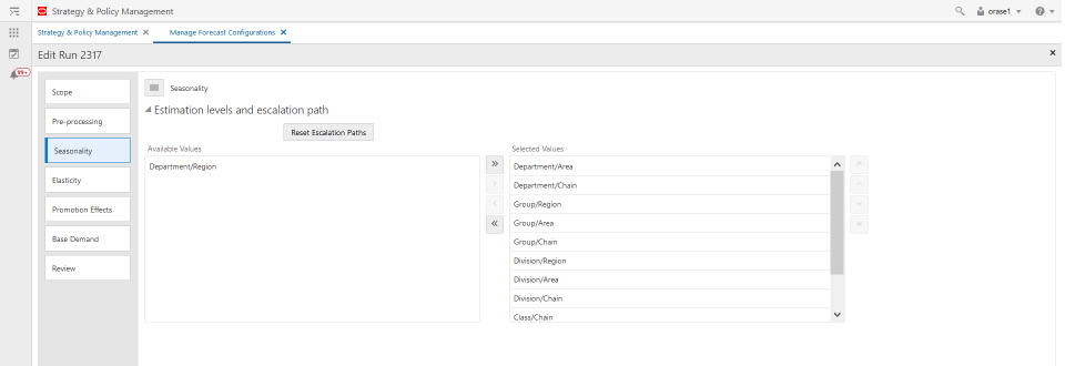

In the other tabs on the left menu, you can review and override the configuration parameters for each stage of the estimation and forecast. To override a parameter, select the row in the table and click the Edit icon above the table. In the Seasonality tab, in addition to the configuration parameters, you can also modify the escalation path by selecting or un-selecting the merchandise-location intersections that will be used during escalation process.
In the Review tab, you can see all the parameters that were overridden and submit the run for the execution.

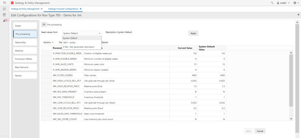

In the Manage screen in train stop 3 you can set the value of configuration parameters for the run type. These values will be used when creating and executing batch runs for each run type. In this screen, you can also activate or inactivate run types by selecting a row and clicking the Activate button above the table. Active run types become part of the weekly batch process, and a new batch run is created and executed for each active run type.
To review and override the value of configuration parameters for a run type, select a row and click Edit Configuration Parameters above the table. This button will be disabled if the run type is in active status. The Edit configuration pop-up is similar to the Create Run pop-up and has a tab for each stage of estimation and forecast. In each tab, you can do one of the following, as shown in Figure 13-11.
Set the values of all configuration parameters in that stage, based on the system default for the run type. To do this, select System Default from the drop-down menu and click Apply.
Set the values of all configuration parameters in that stage based on the values that were previously set in one of the what-if runs. To do this, select the desired run from the drop-down menu and click Apply.
Override the value of a certain configuration parameter. To do this, select a row and click the Edit icon above the table.

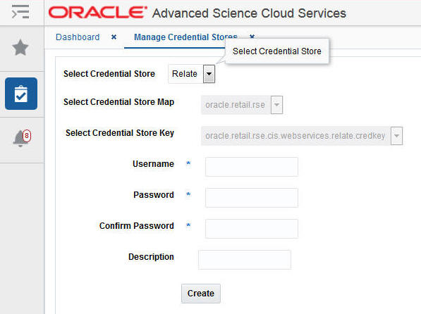

Oracle Customer Engagement web service-related credentials are managed in the credential stores using the interface shown in Figure 13-13. The administrator can use this screen to configure the name and password. This information is used to generate the authentication key that is sent as part of the message to Oracle Customer Engagement.
The Credential Stores dialog box requires the following information:
Label - describes the credential store map and key
Username - user name provided by Oracle Customer Engagement
Password - password provided by Oracle Customer Engagement
Confirm Password - prompt to confirm user password
Description - used by the administrator to describe the credential store used for Customer Segment integration with Oracle Customer Engagement.
