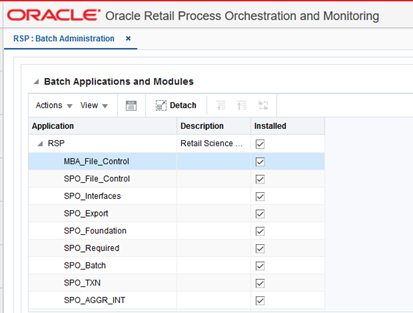

Using the Batch Administration functionality, shown in Figure 21-1, the user can enable and disable application-specific batch processes as a whole or enable and disable individual batch processes at the job level. Any modifications made will become effective with the next scheduler day load (except batch throttling configurations). The execution of application batch processes can be controlled by selecting or deselecting the check box.
To access Batch Administration, select: Schedule > Administration > Batch Administration.

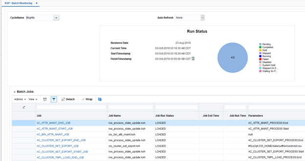

Using Batch Monitoring, shown in Figure 21-2, the user can monitor the current status of different batch processes at cycle level including nightly, ad hoc, and hourly. This screen displays a pie chart section that provides a summary view of the current cycle execution. A job can have eight different job statuses: Pending, Completed, Hold, Skipped, Running, Failed, Disabled, and System Held.
To access Batch Monitoring, select: Schedule > Monitoring > Batch Monitoring
To create a new scheduler day.
Access Batch Monitoring.
Click Create Schedule, then click Yes to confirm. A new scheduler day will be created.
From the Monitoring Cycle list box, select the Nightly/Ad hoc/Hourly cycle. Note that the individual nightly batch job with its run status is loaded.
A pie chart displays the summary view of the current cycle execution.

After triggering the process from Postman, the user can view the progress of the batch execution and the state of the batch process (either pass or fail) in the POAM UI. In the POAM UI, open the Batch Monitoring screen and select Nightly in the drop-down menu. Refresh the scheduler day you created. The batch schedule status can be viewed in the displayed graph; if Auto Refresh is set, then the graph is automatically updated.
The Job status is listed in the Batch Jobs tab.

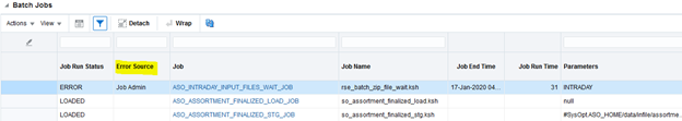

A batch process can fail because of the following:
An actual batch process failure.
A failure as a result of the loss of communication between POAM JOS components.
'The Error Source column lists the source of error. If the source is POAM, it is generally a connection issue.
If the source of the error is Job Admin, it can be either a connection failure or an actual job failure. This can be determined by examining the logs for JOS JOB ADMIN.
JOS JOB ADMIN
.Log into JOS JOB ADMIN using a valid user name and password.
Navigate to System Logs.
Select the name of the JOB that failed. The log will be displayed at the bottom of the screen.
