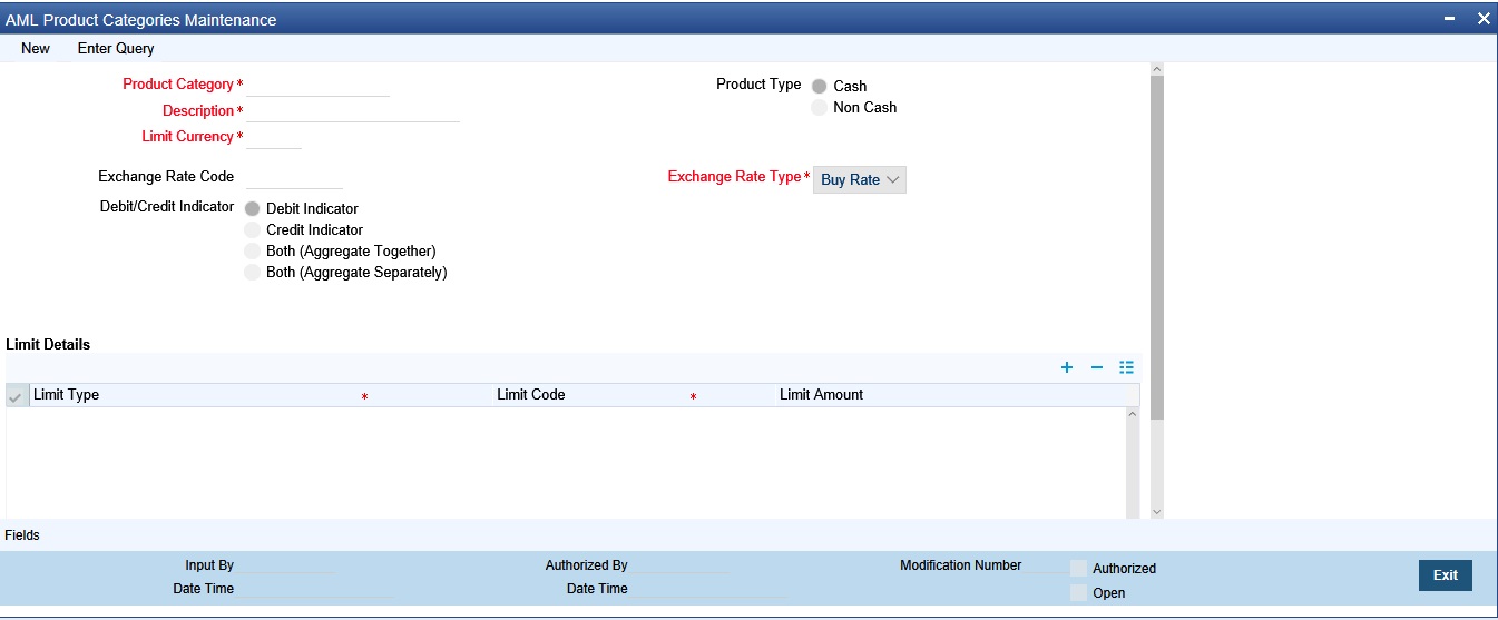

You have to create product categories in Oracle FLEXCUBE, for the purpose of grouping common transactions. A product is a specific service that you offer your customers. Each transaction that you process in Oracle FLEXCUBE should be linked to a product. By maintaining amount limits at the product level, each time you link a transaction with a product the system verifies the amount limit maintained for the product. If the transaction amount exceeds the amount maintained at the product level the system intimates you with an override.
You can invoke the ‘AML Product Categories Maintenance’ screen by typing ‘CSDAMLPC’ in the field at the top right corner of the Application tool bar and clicking the adjoining arrow button.
Product Category
You should identify each product category with an identification code by giving it a unique name.
Description
With each product category you have to associate a brief description. This description is meant for information purposes and will not be used for any processing.
Limit Currency
You have to identify the currency in which limits have to be tracked for transactions associated with the product category.
A list of all the currencies maintained in Oracle FLEXCUBE is available in the option list positioned next to this field. You can select the appropriate.
Product Type
Transactions grouped under a product can either be cash based or non-cash based. Therefore, you would have created products catering to cash based and non-cash based transactions.
While creating a product category, you have to indicate whether the products grouped under the respective category cater to cash based or non-cash based transactions. You can select the appropriate option.
Exchange Rate Code and Rate Type
The rate associated with this rate code will be used to derive the exchange rate when the currency of the transaction is different from the limit currency of the product category.
Similarly, you have to select the Rate Type that is to be associated with the rate code. The options available are as follows:
The rate code along with the rate type will determine the exchange rate that is to be used.
Debit/Credit Indicator
As part of Anti-Money Laundering you can indicate the manner in which the system should track the Debit and Credit turnover limits for any of the limit types, for the product category. The options available are:
Limit Code and Limit Amount
At the product category level, you can specify the limit amount that should be associated with each limit code for a limit type.
A list of all the limit codes maintained for the specific limit type (Online, Individual, Daily turnover Batch, Daily turnover Online and Monthly turnover), in the Limit Codes Maintenance screen, will be displayed in the option list positioned next to this field. You can select the appropriate limit code and specify the limit amount that is to be linked with the code.
