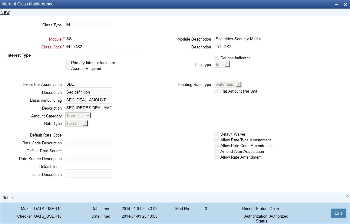

2.3 Interest Class Maintenance
2.3.1 Invoking Interest Class Maintenance
You need to maintain an Interest class specific to the Securities module. For instance, for a Security, you can build an interest class with the attributes of a specific type of coupon, the quarterly coupon paid on the current face value.
This section explains how interest classes are built and how attributes are defined for Securities and Derivatives products and contracts.
You can define the attributes of an interest class, in the ‘Interest Class Maintenance’ screen, invoked from the Application Browser. You can invoke the ‘Interest Class Maintenance’ screen by typing ‘CFDINTCE’ in the field at the top right corner of the Application tool bar and clicking the adjoining arrow button.
Before defining the attributes of an interest class, you should assign the class a unique identifier, called the Class Code and briefly describe the class. A description would help you easily identify a class.
Module
An interest class is built for use in a specific module. This is because; an interest component would be applied on different basis amounts, in different modules.
Note
The Basis Amount Tags available would depend on the module for which you build the class.
Interest Type
While building an Interest Class, you can define two kinds of interest:
Events and the Basis Amount
The term Event can be explained with reference to a deal. A deal goes through different stages in its life cycle, such as:
Each stage is referred to as an Event in Oracle FLEXCUBE.
The event at which you would like to associate the interest component, being defined, to a contract is referred to as the Association Event.
The basis on which an interest is calculated is referred to as the Basis Amount. For instance, a coupon can be on the basis of the current face value of a security. When building an interest class, you have to specify the tag associated with the Basis Amount.
The attributes defined for an interest class, will default to all products with which you associate the class. When maintaining interest details for a product, you can change these default attributes. Contracts maintained under a product will acquire the attributes defined for the securities product.
Accrual Required
You can choose to accrue the interests due on a contract. To accrue the interest payable on a contract, choose the ‘Accrual Required’ option.
The accrual details that you define for an interest class will default to all products with which you associate the class. When maintaining interest accrual details for a product, you can change these default details. Contracts maintained under a product will acquire the accrual details defined for the product. However, you can define unique accrual details for a contract.
Rate Type
The interests paid on contracts can be at a Fixed Rate, or on the basis of a Floating Rate. If you indicate that interests should be calculated on the basis of a Floating Rate, you must specify the ‘Periodic’ Floating Rate Type.
For all contracts maintained under products, associated with a class, the interest will be by default calculated using the specified Rate type.
Default Rate Code
Interest payable on contracts would be calculated at specific rates. When building an interest component, you have to specify the rate at which the interest should be computed. When associating a rate code (that you have maintained in the Rate Codes Maintenance screen) with the interest component that you are building, the rates corresponding to the code will be used to compute interest.
The details defined for an interest class will default to all products with which the class is associated. When maintaining interest details for a product, you can change this default information. Contracts maintained under a product will acquire the interest details defined for the contract product. However, you can define unique interest details specific to a contract.
When maintaining a contract, you can choose to waive the rate code altogether or amend the properties of the code to suit the security.
If you allow amendment of a rate code, you can specify if you would like to allow rate code amendment after the association event.
You can also allow the amendment of the rate value (corresponding to a rate code).
Default Tenor
Each rate code is associated with a tenor. For instance you have a Rate Code ‘LIBOR’. You can link any number of tenor codes to the same rate code.
Tenor Code
Description
1W
One week rate
2W
Two week rate
2M
Two months rate
6M
Six months rate
1Y
One year rate
When building an interest component, you can specify a Tenor Code that you would like to associate, with the Floating Interest Rate Code. Interests for contracts (maintained under a product with which you associate the class) will be calculated using the rate corresponding to the Rate Code and the Tenor Code.
2.3.2 Rate Button
Click ‘Rate’ button and invoke the ‘Interest Limits’ screen.

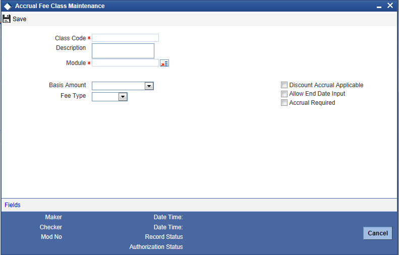

2.4 Accrual Fee Class Maintenance
2.4.1 Invoking Accrual Fee Class Maintenance Screen
You need to define the attributes of an accrual fee class in the ‘Accrual Fee Class Maintenance’ screen, invoked from the Application Browser. You can invoke this screen by typing ‘CFDXACFC’ in the field at the top right corner of the Application tool bar and clicking the adjoining arrow button.
Here you can specify the following details:
Class Code
Specify a unique code to identify the class.
Class Description
Specify a brief description for the class.
Module
Specify the module to which the class should be applicable. The adjoining option list displays all module codes available in the system. You can choose the appropriate one.
Basis Amount
Select the basis amount from the adjoining drop-down list:
Fee Type
Select the fee type from the adjoining drop-down list:
Allow End Date Input
Check this box to indicate that the end date for accrual can be entered at the time of entering the fee details for a particular class. Otherwise, the maturity date of the associated contract will get defaulted as the end date for accrual.
Accrual Required
Check this box to indicate that accrual of fees is required.
Consider as Discount
Check this box to indicate that the fee component should be considered as part of discount accrual.

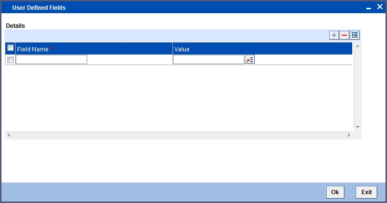

2.4.2 Fields Button
You can capture user-defined fields (UDFs) in the ‘User Defined Fields’ screen. Click ‘Fields’ button and invoke the following screen.
Field Name
The system displays the UDFs.
Value
Specify the value for each UDF.

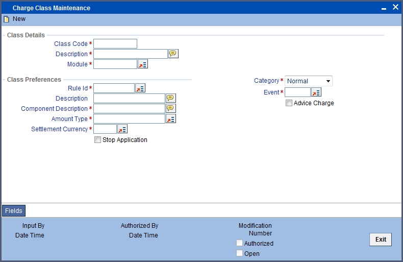

2.5 Charge Class
2.5.1 Maintaining Charge Class
You have to build a charge class, for instance, with the attributes of a specific type of charge, such as ‘Charges for amending the terms of a transaction’, or ‘Charges for provision of services’. To recall, a charge rule is built to calculate a specific type of charge component.
Once such a rule is built, you can define attributes like what should be the basis amount on which the charge rule is applied, when the charge should be associated to the contract and when the charge should be calculated and collected.
When building a charge class, you define certain attributes such as:
You can define the attributes of a charge class in the ‘Charge Class Maintenance’ screen, invoked from the Application Browser. You can invoke this screen by typing ‘CFDCHGCE’ in the field at the top right corner of the Application tool bar and clicking the adjoining arrow button.
The following are the features of the Charge Class Maintenance screen.
Class Code
Before defining the attributes of a charge class, you should assign the class a unique identifier, called the Class Code and briefly describe the class. A description would help you easily identify the class.
Module
A charge class is built for use in a specific module. As a charge component would be applied on different basis amounts, in different modules. In the Letters of Credit module, for instance, you would apply a flat processing charge or fee on all LCs. In the Securities module, you could levy a flat charge or fee on portfolios that you maintain on behalf of a customer. The basis on which the component is applied is different, in these two cases.
Note
Charge Type
Charges can be collected from the counter party or from a third party. You can select one of the following values from the adjoining drop-down list:
The charges or fee that you levy will be recovered, typically, from the counterparty involved. Therefore, when building a charge class, you may indicate the charge to be of ‘Counterparty’ type.
Third Party Type
If a charge component that you associate with a product is of ‘third party’ type, specify the party type.
Debit /Credit
Choose the Debit option in this field, if the charge component associated with the product is to be debited to the customer. If you would bear the charge component, choose the ‘Credit’ option.
The following example illustrates how a charge could be of a ‘Credit’ type.
Propagation Required
Check this option to indicate that the charge collected from the borrower must be passed on to the participants of the contract.
Net Consideration
The sum of the different components of a contract determines the net value of the contract. You can indicate that a charge component should be taken into account when determining the net value of a contract by choosing the Net Consideration option.
Note
The Net Consideration option is applicable if you are defining a charge class for Securities module.
Add/Subtract
If you choose to include the charge component in the net value, you should indicate if the charge component is to be added, while calculating the net consideration amount, or subtracted.
SWIFT Qualifier
You can report the charge component of a contract in the SWIFT messages that you generate. To do this, identify the component, when building it in the ‘Charge Class Maintenance’ screen, with the appropriate SWIFT code.
Events
A contract goes through different stages in its life cycle, such as:
Each of these stages is referred to as an ‘Event’ in Oracle FLEXCUBE.
At any of these events, you can choose to apply a charge or fee. When defining a charge class, you should specify:
The event at which you would like to associate a charge component to a contract is referred to as the Association Event. At this event, no accounting entry (for the charge component) is passed.
The event at which the charge component is actually calculated is referred to as the Application Event. At this event, no accounting entry (for the charge component) is passed. The charge or fee is liquidated at the Liquidation event that you specify.

2.6 Old Charges Class Maintenance
2.6.1 Invoking Charge Class Maintenance Screen
You have to define a charge class for transactions in FT, FX and SI modules using the ‘Charge Class Maintenance’ screen, invoked from the Application Browser. You can invoke this screen by typing ‘CFDOCHCL’ in the field at the top right corner of the Application tool bar and clicking the adjoining arrow button.
Class Details
Indicate the following basic details.
Class Code
Class Description
Module
Class Preferences
Specify the following class preferences:
Rule Identification
Specify the rule that should be linked to the class. The adjoining option list displays all valid rules maintained in the system. You can choose the appropriate one.
Description
The system displays the description based on the rule chosen.
Component Description
Define a component here for the rule. Based on this component, six corresponding accounting roles will be generated by the system.
Amount Type
Specify the basis amount type for collection of charge. The adjoining option list displays all valid basis amount types available in the system. You can choose the appropriate one.
Settlement Currency
Specify the currency for collection of the charge. The adjoining option list displays all valid currency codes maintained in the system. You can choose the appropriate one.
Stop Application
Check this box to indicate that collection should stop for the charge component.
Category
Select ‘Normal’ as the category of the basis amount on which charge should be collected.
Event
Specify the event at which collection of the charge should be triggered, The adjoining option list displays all events available in the system for the module specified. You can choose the appropriate one.
Advice Charge
Check this box to indicate that charge should be collected for dispatching the customer advice.
2.6.2 Fields Button
Field Name
Value

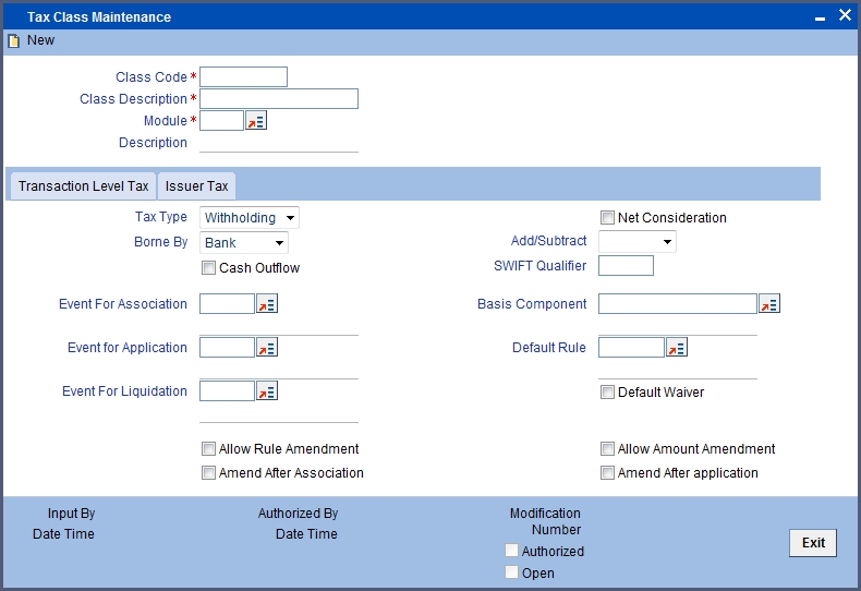

2.7 Tax Class Maintenance
2.7.1 Invoking Tax Class Maintenance Screen
You can define the attributes of a transaction level tax under the corresponding section of the ‘Tax Class Maintenance’ screen. You can invoke this screen by typing ‘TADTAXCL’ in the field at the top right corner of the Application tool bar and clicking the adjoining arrow button.
Before defining the attributes of a Transaction Tax Class, assign the class a unique identifier, called the Class Code, and briefly describe the class. A description would help easily identify a class.
Module
A tax class is built for use in a specific module. This is because the basis amounts on which the tax is applied could vary with the modules. In the Foreign Exchange module, for instance, you might want to levy tax on the brokerage paid. In the Securities module, you might have to pay a tax on the value of a security that you purchase. The basis on which the tax component is calculated is different in these two cases.
Note
The Basis Amount Tags available, in this screen, would depend on the module for which you build the class.
Tax
The type of tax indicates who bears the tax, whether the bank or the customer.
Withholding
Withholding type tax is borne by the beneficiary on an income (either the bank or the customer). For example, the tax on the brokerage paid would be borne by the broker. You withhold this component in a Tax Payable account, by debiting the customer account (since brokers are defined as Customers in Oracle FLEXCUBE) and later paying the tax to the government on behalf of the broker.
Expense Type
If you choose to bear the tax that is payable on brokerage, you would define it as an expense type of tax. The tax entries, in this case, would be posted to an Expense account.
If you bear the tax, there could either be an immediate cash Outflow or payment, or a mere crediting of it to a Tax Payable account. In the latter case, there would not be an immediate Outflow. The tax would be paid at a later date, from the Tax Payable account.
The sum of the different components of a contract determines the net value of the contract. To indicate that a transaction level tax component should be taken into account when determining the net value of a contract, choose the Net Consideration option.
If you choose to include the tax component in the net value of the contract, you should also indicate if the tax component is to be added or subtracted, while calculating the net consideration amount.
Defining the Events and the Basis Amount
Each contract that your bank enters into goes through different stages, each of which is referred to as an Event in Oracle FLEXCUBE.
A securities deal, for instance, goes through different stages in its life cycle, such as:
Each of these stages is referred to as an Event in Oracle FLEXCUBE.
The following are examples of the events for a portfolio that you maintain:
At any of these events, you can choose to apply a tax. The event at which you would like to associate a tax component, is referred to as the Association Event. At this event, no accounting entry (for the tax component) is passed.
The event at which the tax component is actually computed is referred to as the Application Event. The tax is liquidated at the Liquidation Event.
The basis on which a tax is calculated is referred to as the Basis Amount. A tax can be on the basis of the principal, the brokerage paid and so on. When building a tax class, you have to specify the tag associated with the Basis Amount.
Choosing the Default Tax Rule
A tax rule can be linked to the tax component that you are building. When you link a rule to a component, the attributes that you have defined for the rule, will default to the component.
A tax rule identifies the method in which tax, is to be calculated. A rule is built with attributes such as the following:
The tax component to which you link a rule acquires ITS properties. Tax for the contracts with which you associate a tax component will, by default, be calculated according to the rule linked to the component. However, when processing a contract, you can choose to waive the rule.
When building a tax class, you can choose to allow the amendment of the rule linked to it, under the following conditions:
Including a Component in SWIFT Messages
To report a component of a contract in the SWIFT messages that you generate, identify the component with the appropriate SWIFT code. You can identify a tax component with its SWIFT code when building the component.

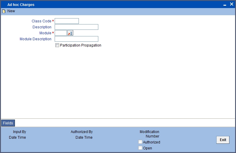

2.8 Adhoc Fee Class
2.8.1 Maintaining Adhoc Fee Class
You can define the attributes of an adhoc fee class in the ‘Adhoc Charges’ screen, invoked from the Application Browser. You can invoke this screen by typing ‘CFDXADFE’ in the field at the top right corner of the Application tool bar and clicking the adjoining arrow button.
Here you can maintain the following details.
Class Code
Specify a unique identifier for the class.
Description
Specify a description for the class code.
Report Module
Module Description
The system displays a brief description of the chosen module.
Participation Propagation
Check this box to indicate that the charge collected should be propagated to all participants of the transaction.

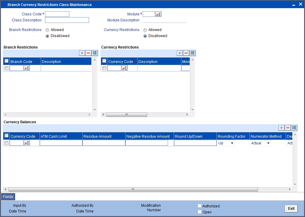

2.9 Branch Currency Restriction Class
2.9.1 Maintaining Branch Currency Restriction Class
You can define the attributes of a branch and currency restriction class in the ‘Branch Currency Restrictions Class Maintenance’ screen, invoked from the Application Browser. You can invoke this screen by typing ‘CSDCBRCL’ in the field at the top right corner of the Application tool bar and clicking the adjoining arrow button.
Class Code
Class Description
Module
Module Description
Branch Restrictions
Indicate whether you want to create a list of allowed branches or disallowed branches by choosing one of the following options:
Indicate whether you want to create a list of allowed currencies or disallowed currencies by choosing one of the following options:
Branch Restrictions
Specify the following details:
Branch Code
Specify the branch that should be included in the allowed or disallowed list. The adjoining option list displays all branch codes available in the system. You can choose the appropriate one.
Description
The system displays a brief description of the branch code.
You can choose multiple branches.
Currency Code
Specify the currency that should be included in the allowed or disallowed list. The adjoining option list displays all currency codes available in the system. You can choose the appropriate one.
Description
The system displays a brief description of the currency code.
You can choose multiple currencies.

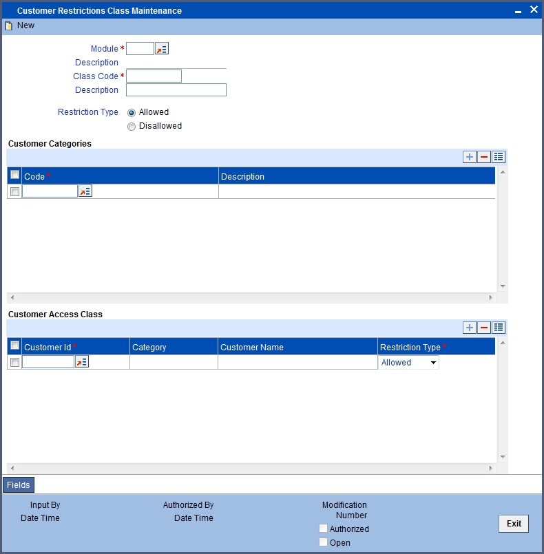

2.10 Customer Restriction Class
2.10.1 Maintaining Customer Restriction Class
You can define the attributes of a customer category and customer restriction class in the ‘Branch Currency Restrictions Class Maintenance’ screen, invoked from the Application Browser. You can invoke this screen by typing ‘CSDCUCCL’ in the field at the top right corner of the Application tool bar and clicking the adjoining arrow button.
Module
Module Description
Class Code
Class Description
Restriction Type
Indicate whether you want to create a list of allowed customers or disallowed customers by choosing one of the following options:
Customer Categories
Code
Specify the customer category code that should be included in the allowed or disallowed list. The adjoining option list displays all customer category codes available in the system. You can choose the appropriate one.
Description
You can choose multiple customer categories.
Customer Access Class
You can exclude certain customers belonging to the allowed/disallowed category from being part of the list.
Customer ID
Specify the customer ID that you want to exclude from the allowed/disallowed list. The adjoining option list displays all customer identification number (CIF) available in the system. You can choose the appropriate one.
Category
The system displays the category to which the customer belongs.
Customer Name
The system displays the name of the customer.
Restriction Type
If you have maintained an allowed list, choose the option ‘Disallowed’ and vice-versa.

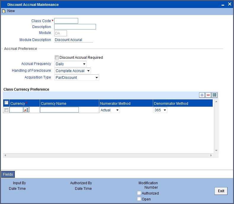

2.11 Discount Accrual Class
2.11.1 Maintaining Discount Accrual Class
A discount accrual fee class specifies the accrual parameters for interest, charges and fees.
Before defining the attributes of a discount accrual fee class, you should assign the class a unique identifier, called the Class Code and briefly describe the class. A description would help you easily identify the class.
When building a discount accrual fee class, you define certain attributes such as:
You can define the attributes of a discount accrual fee class in the ‘Discount Accrual Class Maintenance’ screen. You can invoke this screen by typing ‘DADACRCL’ in the field at the top right corner of the Application tool bar and clicking the adjoining arrow button.
You can specify the following details.
Class Code
Class Description
Module
Module Description
Accrual Preference
Discount Accrual Required
Check this box to indicate that discount accrual is required.
Accrual Frequency
If you check the box ‘Accrual Required’, you will have to select the accrual frequency from the adjoining drop-down list:
Handling of Foreclosure
Select the method of handling foreclosure from the adjoining drop-down list:
Acquisition Type
The Acquisition Type is determined by the cash flows of Interest, charges and fees for which 'Consider as Discount' option is checked. The drop down list comprises of the following values:
If the incoming cash flows of all the above components are greater than outgoing cash flows considering Incoming flow as Positive (In case of Loans) then acquisition type is considered as Discount.
If the incoming cash flows of all the above components are less than outgoing cash flows considering Incoming flow as Positive (In case of Loan) then acquisition type is considered as Premium.
If the incoming cash flows of all the above components are equal to outgoing cash flows considering Incoming flow as Positive (In case of Loan) then acquisition type is considered as Par.
Class Currency Preference
Currency
Specify the currency code. The adjoining option list displays all currency codes available in the system. You can choose the appropriate one.
Currency Name
The system displays the name of the currency.
Numerator Method
Specify the numerator method.
Denominator Method
Specify the denominator method.
You can maintain multiple currency codes.

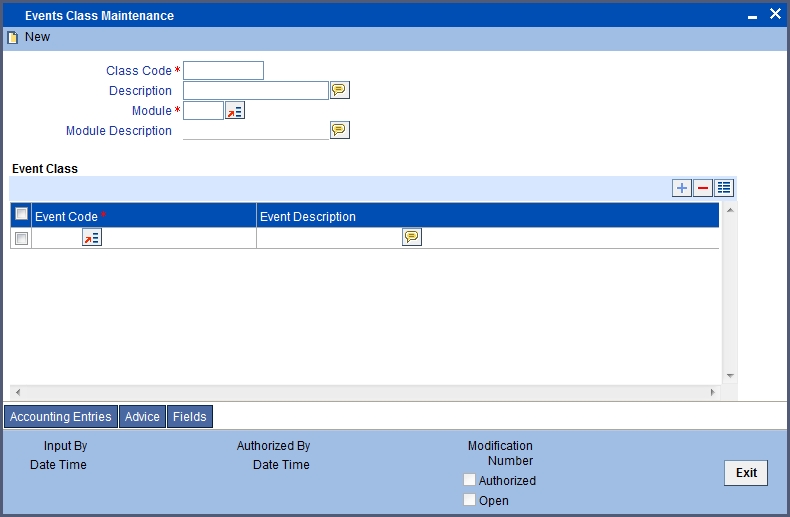

2.12 Events Class Maintenance
2.12.1 Invoking Event Class Maintenance Screen
You can build a charge class, for instance, with the attributes of a specific type of charge, such as Charges for provision of services. Similarly, you can build an event class with the attributes of a specific type of events, such as a Booking a Transaction, Collecting Charges, Cancellation and so on.
You can identify an Events Class with a unique Code and Description. When you define an Events Class, you choose, first of all, the set of events that would belong to the class. Events are, typically, unique to a module.
You can build the events that you would like to include in an Events Class in the ‘Events Class Maintenance’ screen. You can invoke this screen by typing ‘CSDACTCL’ in the field at the top right corner of the Application tool bar and clicking on the adjoining arrow button.
Module
Specify the module to which the class should be applicable. The adjoining option list displays all module codes available in the system. You can choose the appropriate one. Based on the module chose, the corresponding events will be available for selection.
Module Description
Class Code
Class Description
Event Class
You can specify the evnt class code and the event class description.

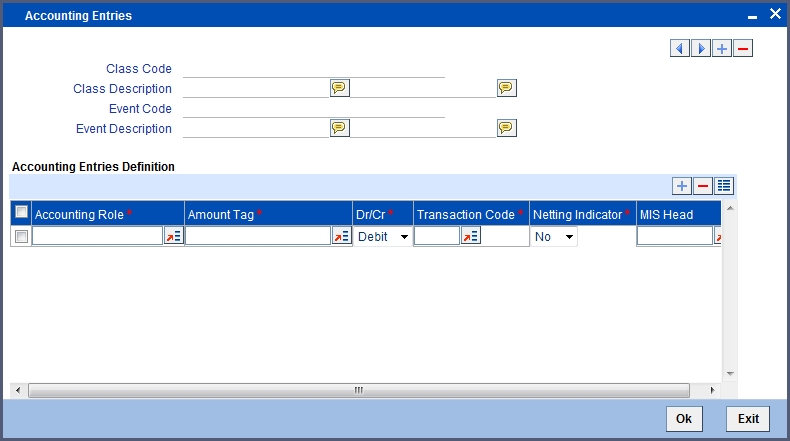

2.12.2 Accounting Entries Button
For every event constituting the class that you are building, you have to specify the accounting entries that should be passed (if any), and the advices that should be generated. You can do this through the ‘Accounting Entries’ screen.

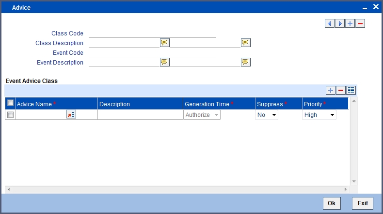

2.12.3 Advices Button
At an event, you can opt to generate an advice if the accounting entry involves a customer account. Click ‘Advices’ button to define the advices that should be generated for an event.
The system displays the following details from the main screen:
Event Advice Class
You need to specify the following details:
Advice Name
Specify the advices that you would like to generate. The adjoining option list displays all advices that can be generated at an event. You can choose the appropriate one.
Description
The system displays a brief description of the advice.
Generation Time
Specify the time of generation.
Suppress
Select this option to suppress this message.
Priority
You can indicate the order of importance in the Priority field.
2.12.4 Fields Button
Field Name
Specify the UDF that should be linked to the class. The adjoining option list displays all valid UDFs maintained in the system. You can choose the appropriate one.
Value
Specify the value for each UDF. You can maintain multiple UDFs.
2.12.5 Maintaining Event Class for Account Initial Funding
You can create an event class to define accounting entries that should be posted for initial funding on a customer account. Similarly, you can also define accounting entries for charges that should be collected on account opening. For this, you need to invoke the ‘Events Class Maintenance’ screen.
Specify the following values.
Class Code
Specify a unique identifier for the class code.
Description
Give a brief description to identify the class code.
Module
Specify ‘DE’ as the module code for the event class.
Module Description
The system displays the description as ‘Data Entry’ on specifying ‘DE’ as the module.
Event Class
Specify the following events.
Event Code
Specify ‘INIT’.
Click ‘Accounting Entries’ button and invoke the following screen.
You need to maintain the following accounting entries.
Accounting Role
Amount Tag
Dr/Cr
Description
OFS_ACC
TXN_AMT
Debit
Offset Account
OFS_ACC_USER
TXN_AMT
Credit
Customer Account
CHARGEINC
CHG-AMT
Credit
Charge Income
OFS_ACC_USER
CHG-AMT
Debit
Customer Account.
Click ‘Advices’ button and invoke the following screen.
You need to associate the message ‘ACC_OPADV’ to the event ‘INIT’.
Refer the section’ Maintaining Message Type for Account Opening’ in the chapter titled ‘Maintaining Messaging Branch Preferences’ in the Messaging System User Manual for details about maintaining messages.
