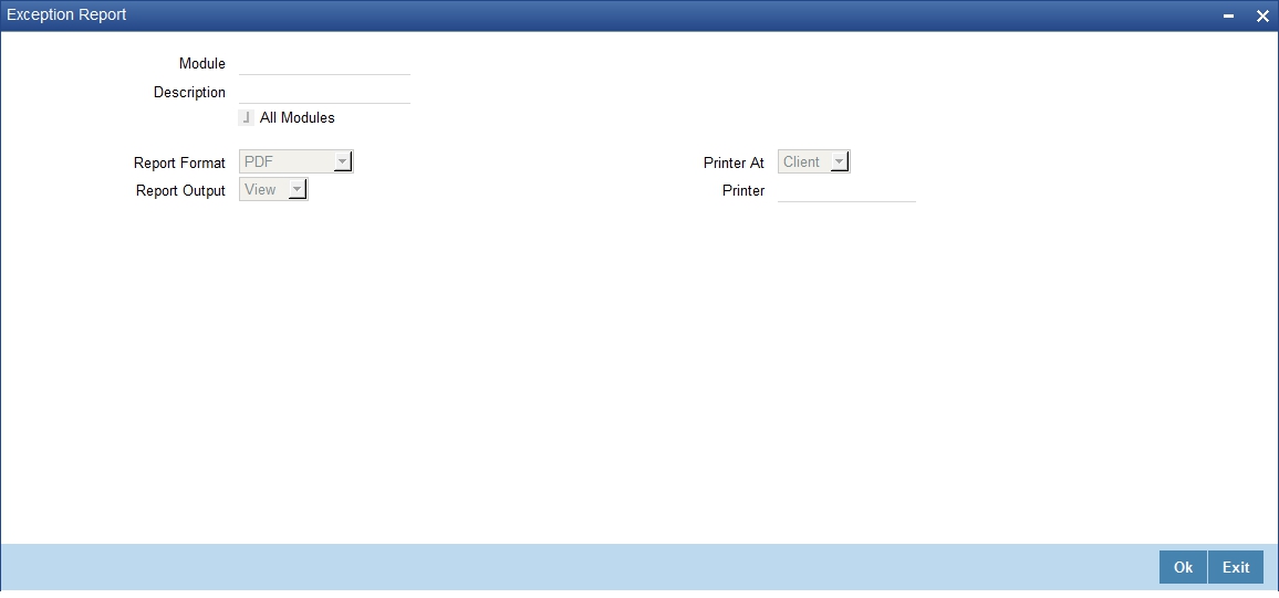

The report gives details of overrides accepted during transaction processing.(for example, Available Balance * for * is less than the Min balance for the A/c Class, Signature Verification not done, etc. You can specify the period for which you require the report when you invoke the report function. In the Application Browser, this report is available under the Signature Verification module.
To invoke this screen type ‘SVROV in the field at top right corner of the Application tool bar and click the adjoining arrow button.
