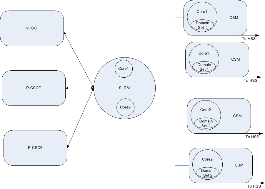

The SLRM supports any number of cores. In the diagram below, the SLRM services both Core1 and Core2. There are 2 Oracle Communications Core Session Managers for each core. The SLRM load balances registrations from P-CSCFs for Core1 between the Oracle Communications Core Session Managers at the top of the diagram and those for Core2 between the bottom.
