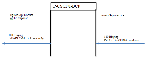

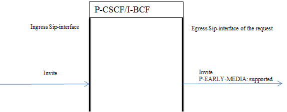

The following illustrations show the ingress and egress sip-interface configuration.
Figure 4-1 180 RINGING Specifying p-early-media Support
