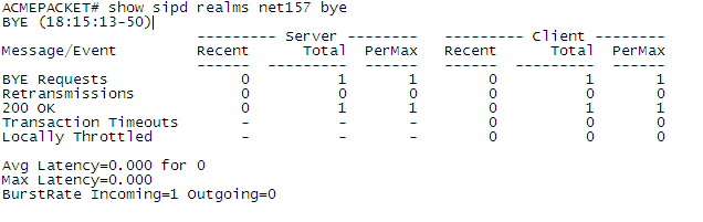

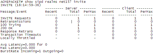

When you set extra-method-stats to disabled in the global SIP configuration, the system displays the per-method statistics for the Access Session Border Controller (A-SBC) public transcoding-realm.
ACLI output for the show sipd realms command, with extra-method-stats disabled. ACLI output for the show sipd realms command, with extra-method-stats disabled.
